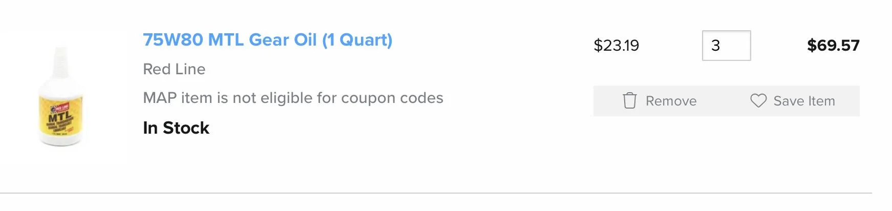

This was the one I was looking at

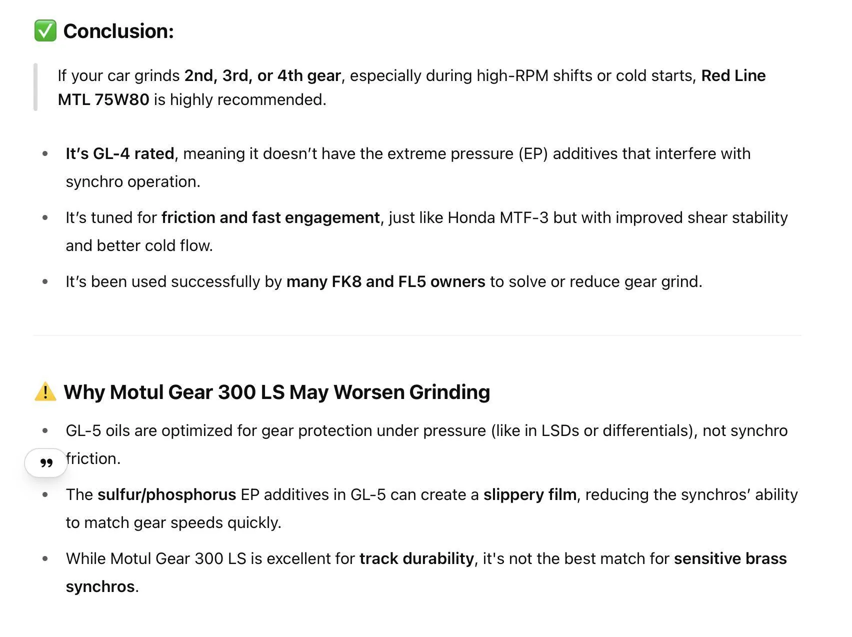

11th Gen Honda Civic FL5 Transmission Fluid recommendation Screenshot 2025-05-25 at 12.39.59 AM
Yes — your Honda Civic Type R FL5 uses carbon-lined synchronizers in its 6-speed manual transmission, at least for 1st and 2nd gear. This is consistent with the previous FK8 generation, which also utilized carbon synchros for improved durability and smoother shifting.
Carbon synchros are known for their high heat resistance and reduced wear compared to traditional brass synchros, making them ideal for performance applications.
Given the presence of carbon synchros, it's crucial to use GL-4 rated transmission fluids that are compatible with carbon materials. Fluids with excessive slipperiness, such as certain GL-5 oils, can impair synchronizer function and lead to shifting issues.Dream Automotive
For optimal performance and longevity of your transmission, consider using high-quality GL-4 fluids like:
  • Red Line MT-85 75W85 GL-4 Gear Oil: Offers smooth shifting and is specifically designed for synchronized manual transmissions.
  • Amsoil 75W-90 Manual Transmission & Transaxle Gear Lube: Provides excellent wear protection and performance in both high and low temperatures.
  • Motul Gear 300 75W-90: Known for its high thermal stability and performance in extreme conditions.
11th Gen Honda Civic FL5 Transmission Fluid recommendation Screenshot 2025-05-25 at 12.41.32 AM

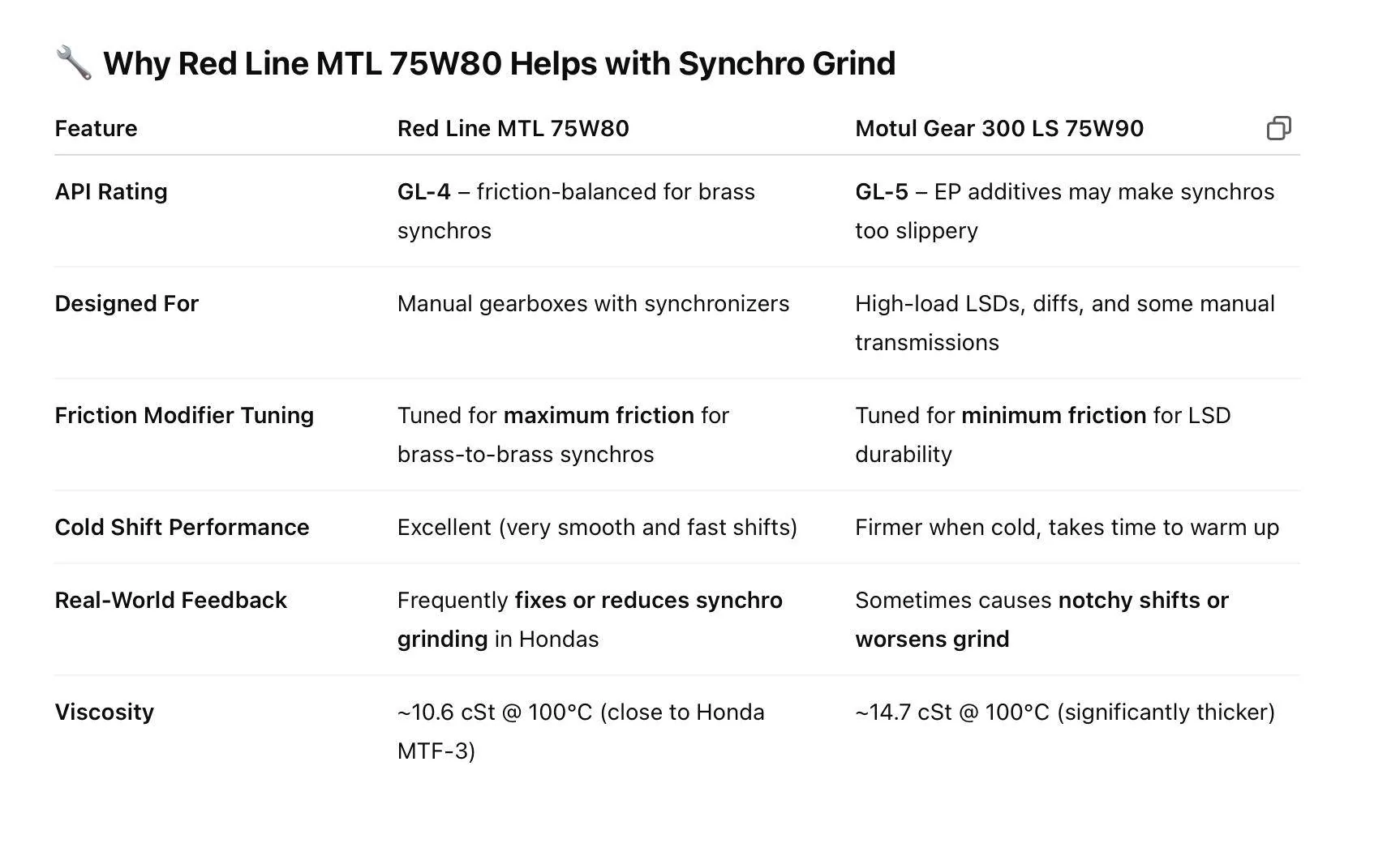

11th Gen Honda Civic FL5 Transmission Fluid recommendation Screenshot 2025-05-25 at 12.42.06 AM

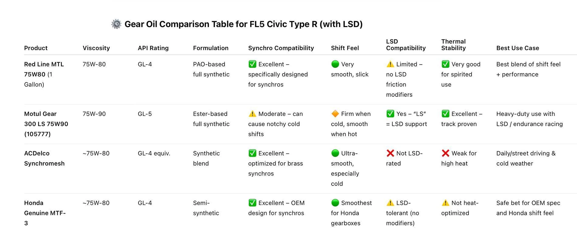

11th Gen Honda Civic FL5 Transmission Fluid recommendation Screenshot 2025-05-25 at 12.43.10 AM

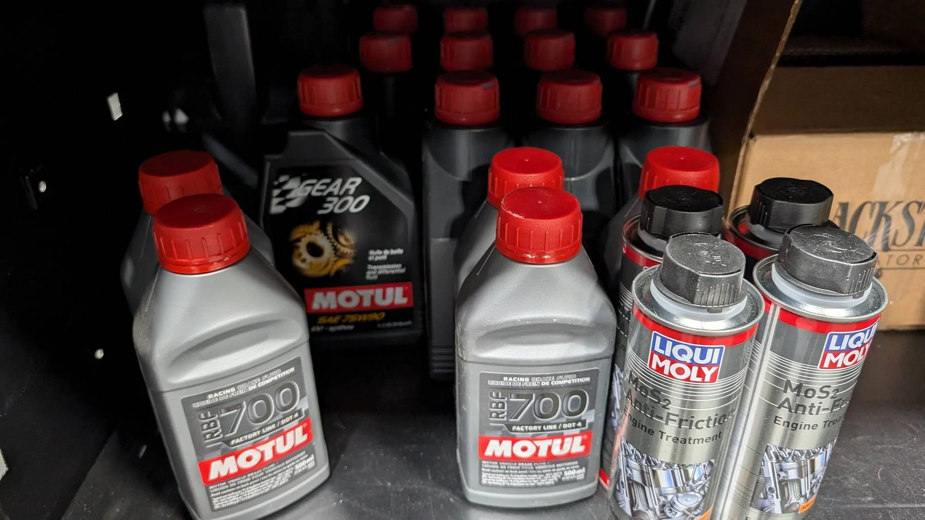

We've never had an issue with any Motul Gear 300 75W90 fluid (LS version or not).
And that article doesnt make sense. It lists Motul Gear 300 75W90 as a GL4 at the very end, but then says its GL5 above it (re: LS version). I feel this is AI generated (reads like one) and not accurate. Motul Gear 300 75W90 (what you see in my pic) is GL5. Again, havent had any issues through the years regarding GL5 and syncros, brass or not.
11th Gen Honda Civic FL5 Transmission Fluid recommendation PXL_20250524_234725364
