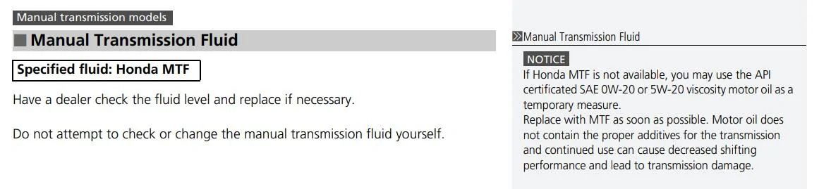

The owner's manual recommends "Honda MTF" which (see below) is equivalent to a 70W or 75W.

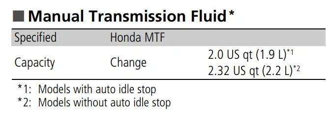

From page 805:
Our cars would be the ones "without auto idle stop" that require 2.32 quarts or 2.2 liters.
And from page 716:
Note on the left how it says that motor oil of 0W-20 or 5W-20 can be temporarily substituted? Well, 70 to 75W gear oil is equivalent-ish to 5W-20 motor oil.
