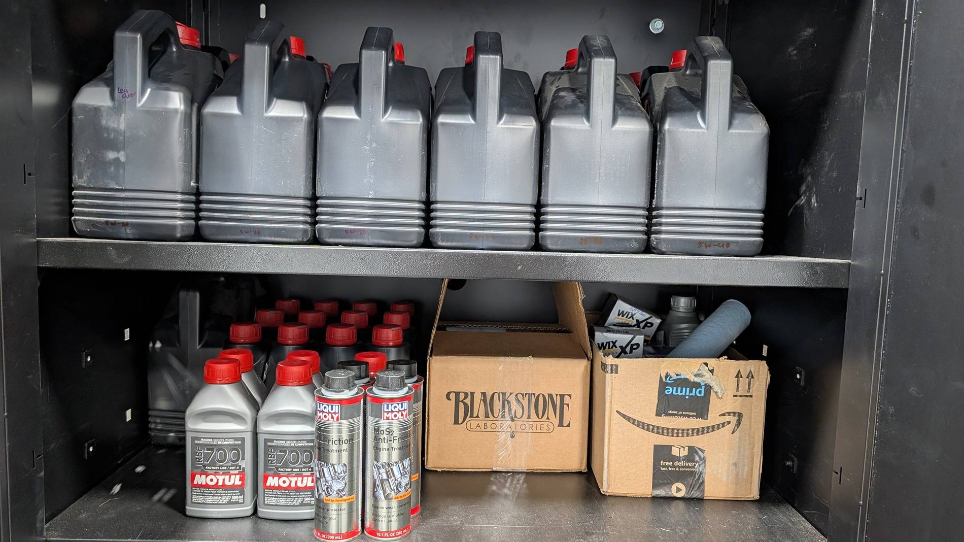

No I am going to use the Amsoil Severe gear oil not the Amsoil MTF. I used the MTF on the s2000 but the type R requires a heavier oil.
For your '24 CTR, what trans fluid are you going with? I think I'm going to go the Amsoil route. Severe Gear 75W-90. I have plenty of that on hand. Either that or perhaps the Redline MTL
Have either of you used the Amsoil severe gear oil? I have access to plenty of it and want to move away from the stock fluid.
