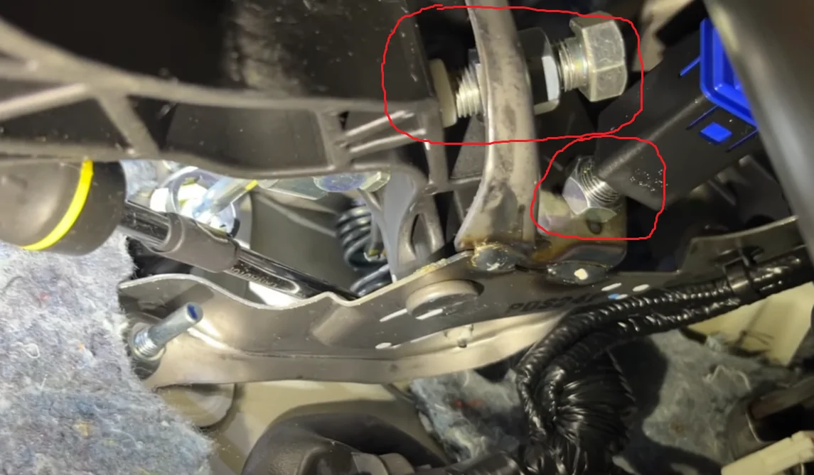

Also make sure to adjust your clutch pedal, it takes a minute to do and definitely helps
https://www.civicx.com/forum/threads/clutch-pedal-adjustment-gear-grind-fix.42528/

If I'm not mistaken, the factory clutch setup can be adjusted a bit to lower the pedal and thus eliminate some of the over-engagement.
11th Gen Honda Civic Grinding in 2nd? 1758739132635-r
I've considered doing this myself. Adjusting the fork on the rod going into the master all the way in, then adjusting the stop and the sensor to match. Then obviously test to make sure the clutch isn't grabbing with the pedal fully depressed, but I don't think mine would since it grabs in the top half of travel.
That should work fine as far as I know, just make sure to leave a little free play so there’s no resting pressure on the master cylinder. I’m sure you’ll be able to feel if it doesn’t disengage enough.
The first thing I would do (and this applies to pretty much any clutch work including replacing slave cylinders etc.) is put the shifter in neutral, start the car up, then hold the clutch in and wait while it's running briefly. Then try to select 1st gear. If you feel the synchro working, you know the clutch is dragging at least a little bit because the synchro is having to slow the input shaft down when it should already be stationary.
