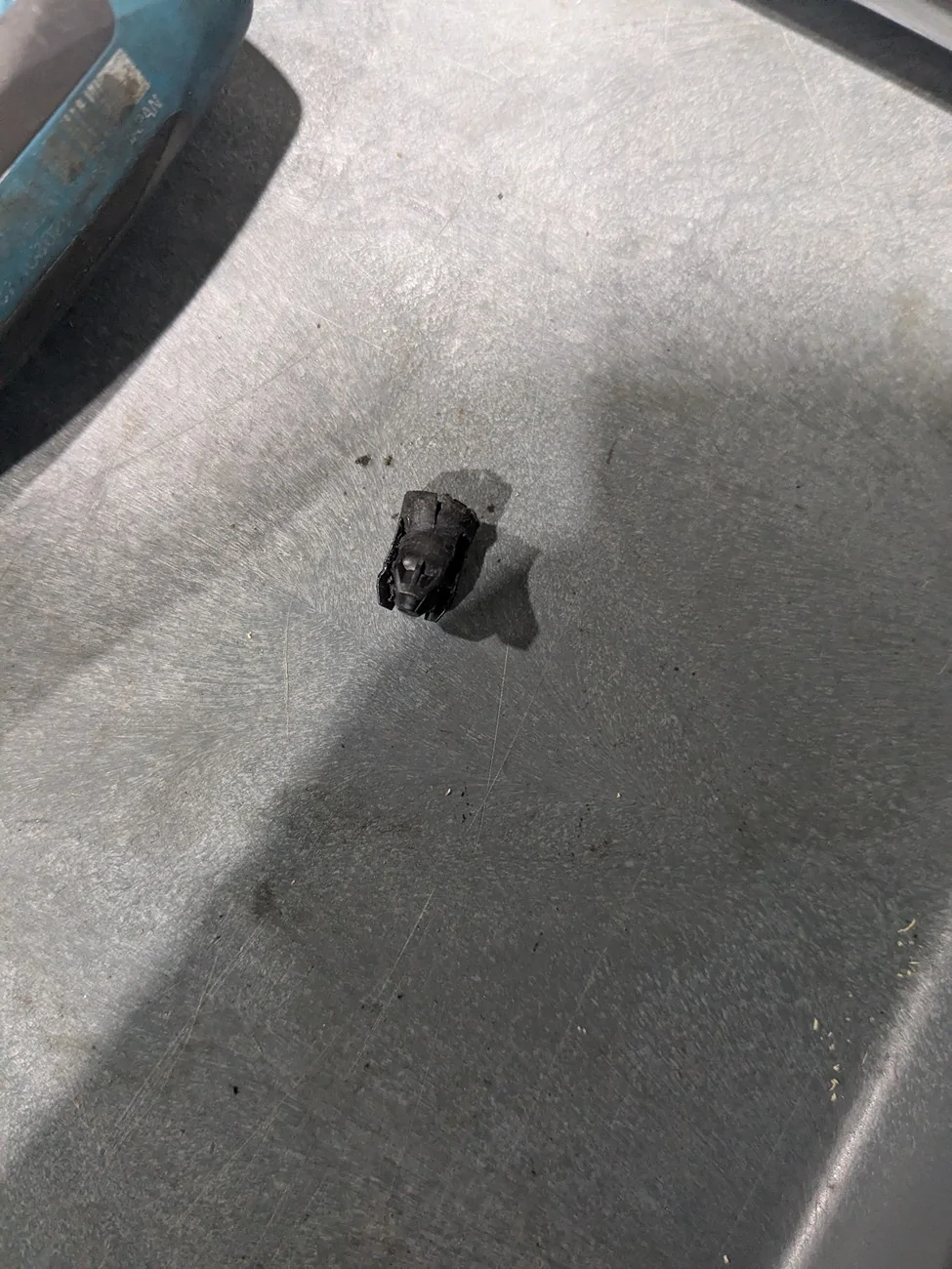

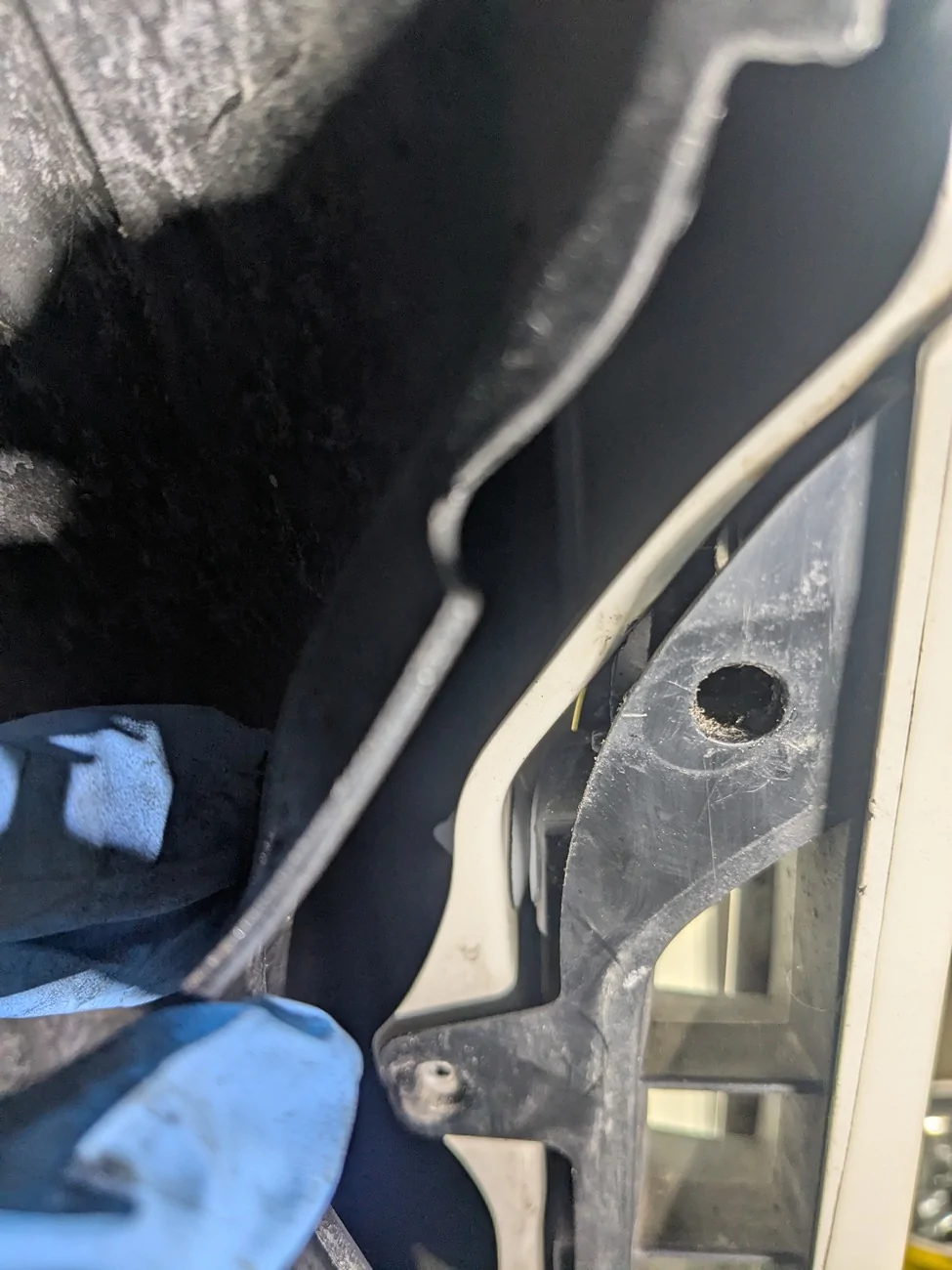

So I ended up throwing the car on the lift and pulling out the broken pin, actually much easier than I expected.
Just peel back the fender liner a little after removing the 3 screws and the 2 clips, then pick out the broken price from the exposed edges.
