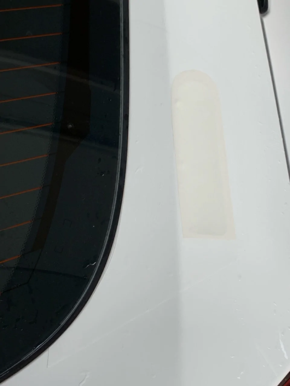

Is the vinyl just floating over the hollow cavity? Or did you vinyl wrap the mounts? It's really hard to see in your photos.
Yeah, the vinyl is just floating over the cavity.
The best way to so this would be to 3D print something that fits in the hole and bolts with some sort of gasket so water does not go in.
Agreed. Hail or debris can certainly perforate the vinyl. I didn't start making a cavity blank since matching its surface with the hatch will take some effort. This is an expedient first pass inspired by a similar method from my FK8 wing delete using 3M Pro PPF that held up for 5 years without leaks.

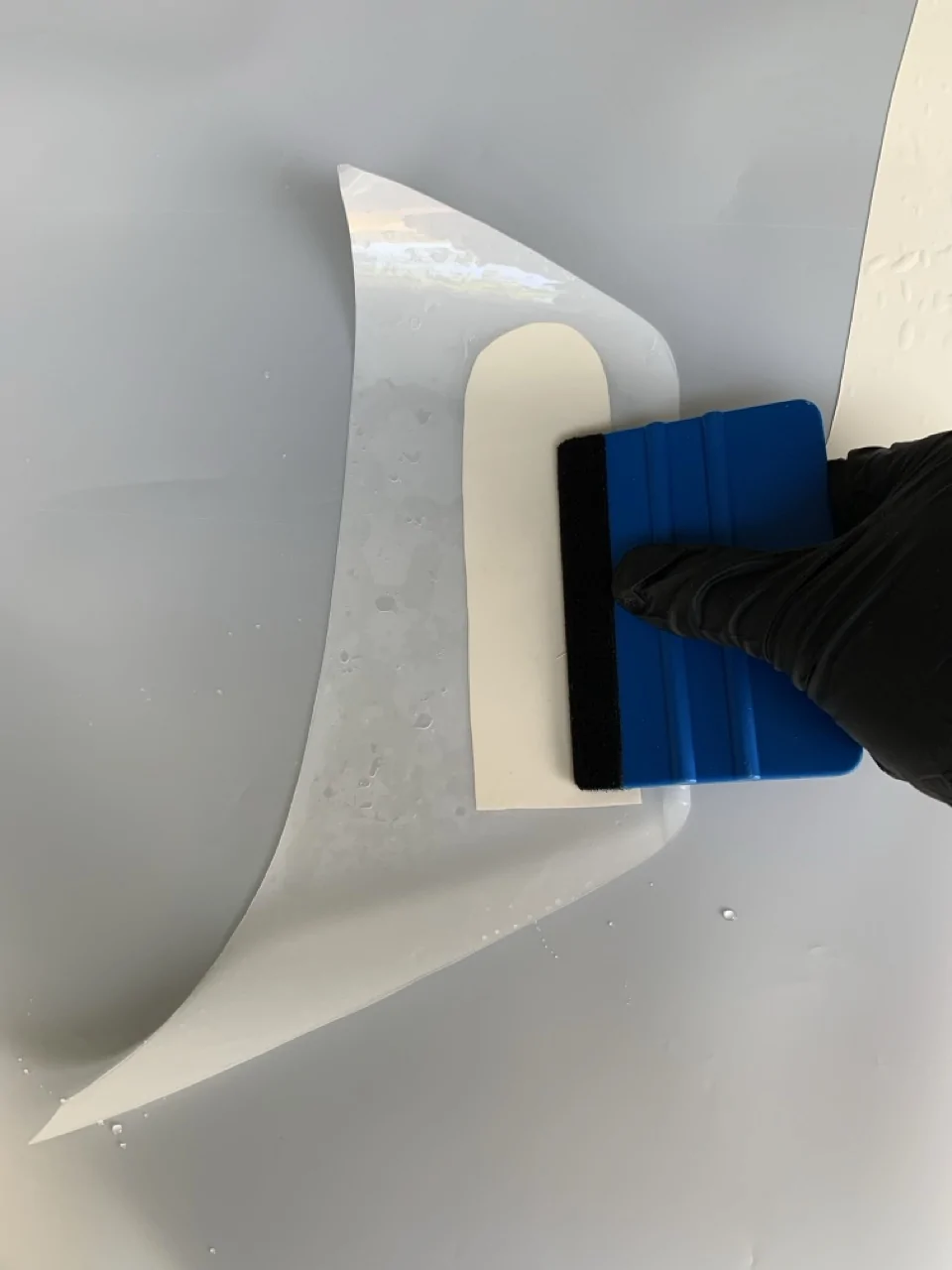

INSTRUCTIONS:
1) Use my previous template to cut out PPF. Also cut out white vinyl in shape of the wing mount cavity. Peel off the backing of the PPF and vinyl, spray with slip solution and apply the adhesive side of the vinyl to the adhesive side of the PPF.

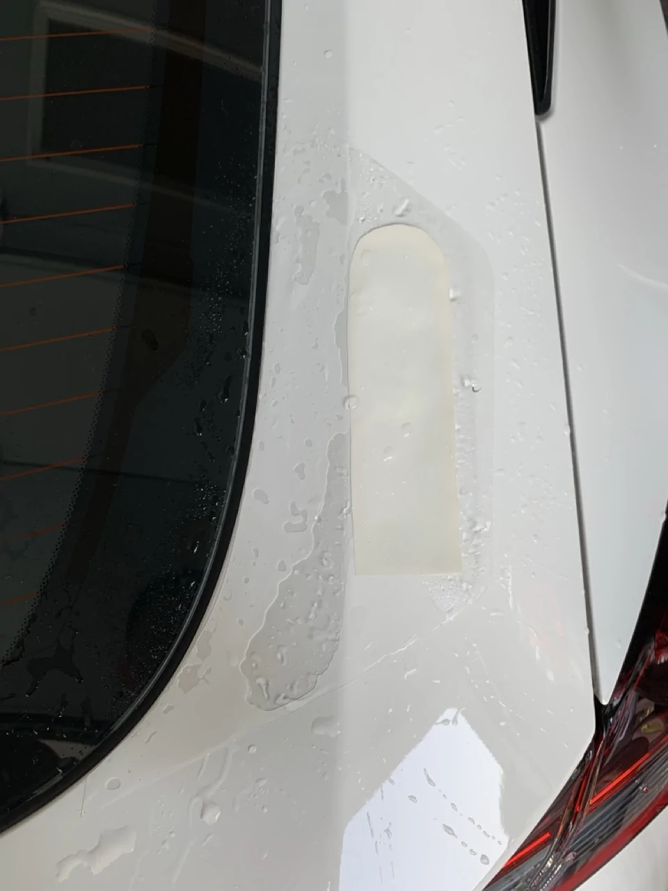

2) Apply PPF + Vinyl to the hatch so the vinyl covers the wing mount cavity.
