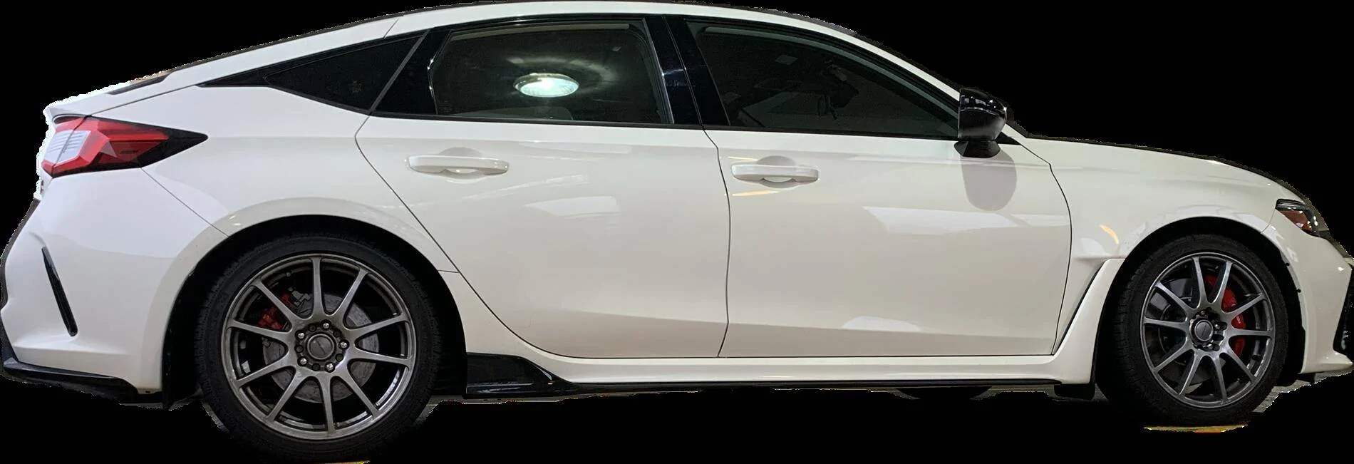

Hilarious! It’s not for everyone, but my invisibility goal was achieved. The FK8 got too much attention even in PMM + wing delete.

Not my thing but man, if the hatch was higher aka station wagon type R, it would have looked really freaking good.

I would pull the engine out now and then wire up a bunch of car batteries in series/parallel under the hood and see what she'll do! :dunno: You might need that wing back on there. :headbang:

At first I didn't like the wing and thought it made the car look like a 'speed racer' wanna be.... BUT it's grown on me and is part of the Honda vibe.
Still, it would be a sleeper to a degree without it. :dunno:

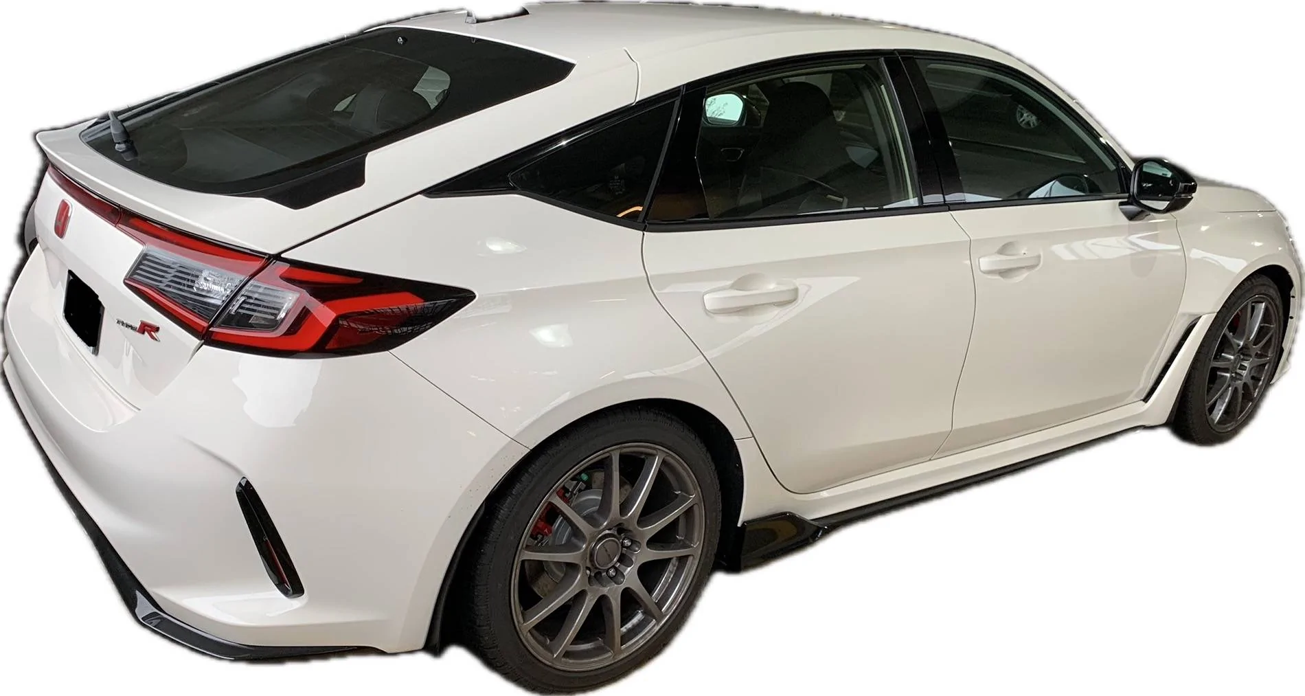

For those who are interested, I just covered the wing mounts with black vinyl hand cut to blend into the hatch glass.
Meta can you explain how you did this more? What type of vynil did you use and where did you buy it? I don't get it, is it just a thin sheet of vynil or some sort of block of the stuff?
I want to neuter my type R also but I don't understand waht vynil you used.

  1. Order at least two 1 ft x 1 ft sheets of vinyl since each piece is 7 in x 11.5 in. I used black gloss 3M 2080 series from a store like Rvinyl on Amazon.
  2. Remove wing (see wing install videos). or
    • I recommend shoving a plastic bag into the hatch cavity before removing the wing bolts to prevent them from falling into the cavity if they slip off the socket.
  3. Clean the hatch.
  4. Cut out a sheet of translucent paper at least 12x8" (gift wrap or baking parchment) and place it over the corner of the hatch.
  5. Draw a shape on the paper you want the vinyl to look like. I attached the template I made for reference. With the 3M logo facing up, it is for the drivers side. You can print it out in actual size if your printer has a borderless 8.5x14" legal paper mode.
  6. Cut the template out.
  7. Trace the template's outline onto the backing of the vinyl to make the wrap for the driver side.
  8. Flip the template over and trace another outline on the back sheet of the vinyl to make the piece for the passenger side of the hatch.
  9. Cut the two vinyl pieces out.
  10. Clean the hatch area that will receive the vinyl with alcohol to promote adhesion.
  11. Squeegee the vinyl down to the hatch around the glass first and then stretch it over the wing support cavity and try to minimize wrinkle over the cavity.
  12. Apply heat gun or hair dryer over any wrinkles over the hatch cavity to shrink the wrap down.

The best way to so this would be to 3D print something that fits in the hole and bolts with some sort of gasket so water does not go in.
