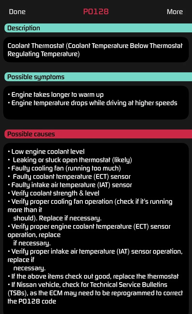

Spoon thermostat installed caused a P0128 check engine CL light. Flashpro manager solved

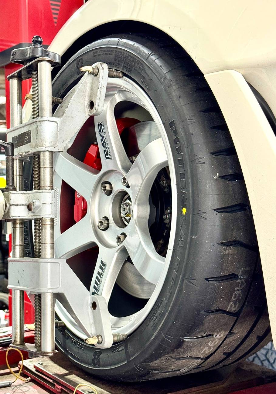

June 2025 - Wheels/Tires/Suspension
TE37 +38
RE-71RS 275
RSR best-i Active
SPC Rear Camber Arm Aluminum (not pictured)
EVS Front Offset Camber Joints (not pictured)
Chasing JS Titanium Open Ended (Short 28mm) Ghost-Raw Color

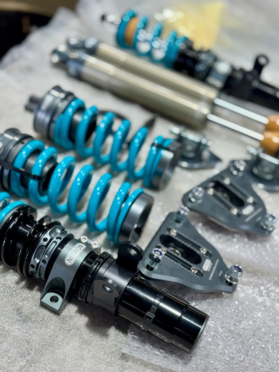

I also so your F/S thread, looking forward to your review of the Nitrons!
How did you fix your P0128 problem?

Nice build! What size tires did you go with?

Thank you so much!
275/35/18
P0128 - Fixed through Flashpro Manager (un-clicked a checkmark LOL)

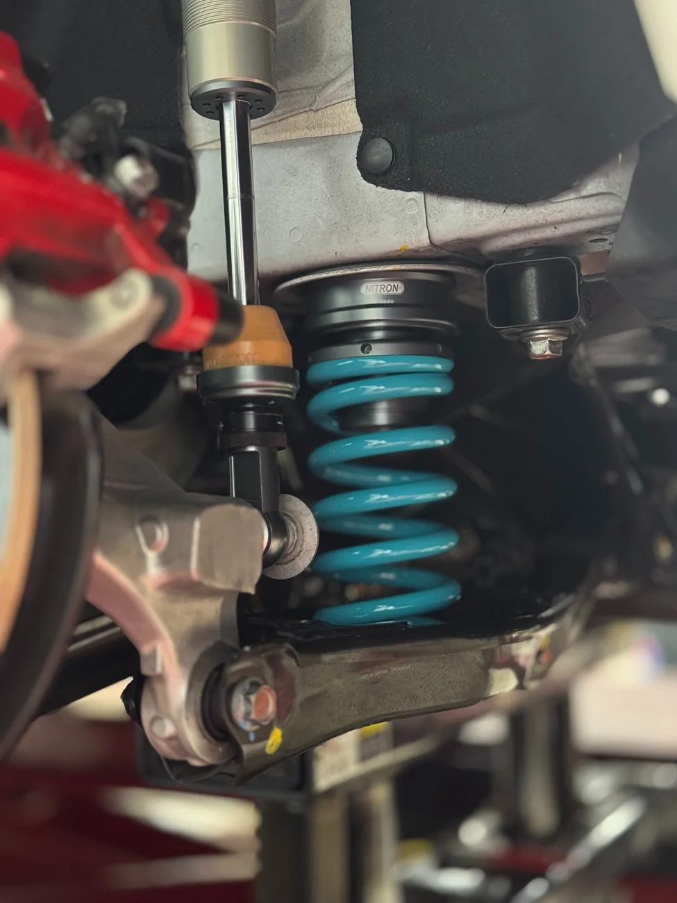

The drive home from the shop felt promising, Headed to spring mountain this Friday and Streets of Willow on the 31st. I don't DD the car anymore so I went with a higher spring rate.

Sweet I bought similar wheels and need to determine what width to go with.
I look forward to seeing your Nitron on track review! I thought maybe you would go for the electrons though.

What offset are you running?
