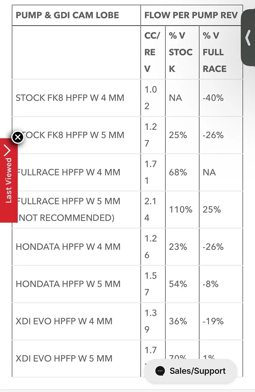

how do you feel about the base Hondata fuel system without the cam? I'm looking to upgrade but just a fun daily driver, not a track monster. Have the CanFlex and intake and inlet. FMIC and intercooler next and then fuel system and turbo (Kuro or MHI).
So the standard fuel system will work very well. It just depends on how much you want to spend. With a bigger turbo you want as much headroom as possible if you are planning on running heavy ethanol mixes and don’t want to limit boost so much.
This is pulled straight from the TSP website. So you can decide what you want.
