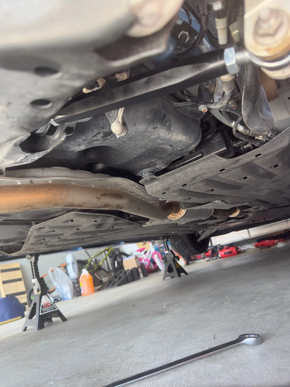

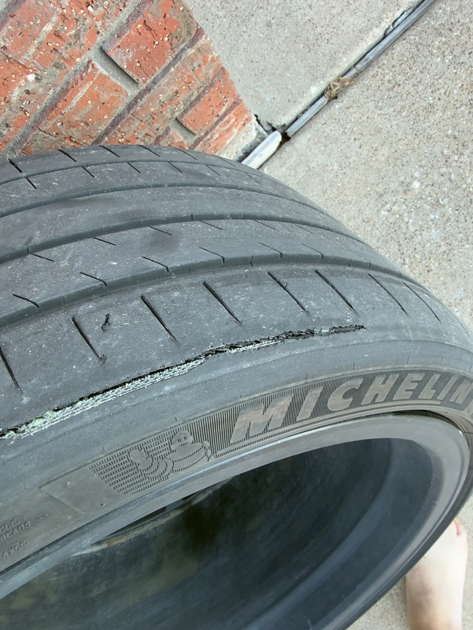

You meant to say you need to have 2' (minute) of angle less to make it 0*18' (0 degree and 18minutes) - same as OE? 2 degree of toe is A LOT. 2 minutes of toe is a small amount. 26 degree of toe would literally look like this /\ pigeon toe!
This is what I meant I just want to have less of whatever is there. It was the main reason my previous set of tires got ruined. They were PS4s with 35k miles, and they were still measuring 7/32 at the time I replaced them, but they were cracked open. Don’t have the picture of the other alignment but the number on the rear that says 26 says 18 but they used civic si on the information don’t know or don’t think will be a difference there.

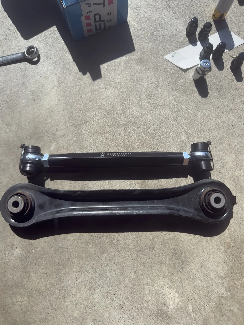

Yesterday, I received the Wunderladen camber arms, and the quality looks superb. I’m really pleased with how easy the work was compared to dealing with the suspension šŸ˜‚.
I also installed the PRL rigid collars, which turned out to be a simple enough job to tackle in the garage by myself. On the insurance side, Progressive gave me a better quote than Geico, even though I’ve been with them for 8 or 9 years. We’ll see how that goes.
Today will also be the first long run after installing everything on the car, so I’m curious to see if the setup is adequate. Next on the list is the DSC module because I don’t want to cause premature wear or damage to the OE struts and shocks. After that, I’ll decide which exhaust to install. I really want the Spoon, but the new Greddy is tempting.

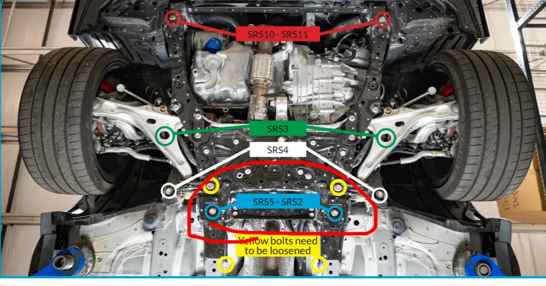

what was the worst part about the rigid collars? ive been debating and definitely want to plan it around any other things that might require an alignment lol..

The worst part and I couldn’t say it was that bad were the rear ones. They’re, the ones marked on the picture as SRS5 and SRS2. But if you keep playing with the other bolts and use a pry bar, with just a little pressure, you can make them fit.

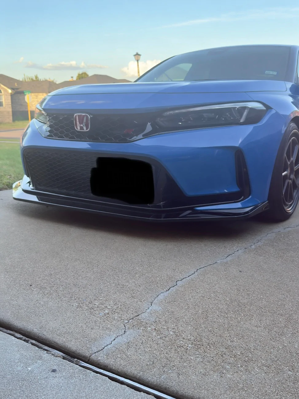

I think I found the AFD lip on Amazon. It was probably from one of the vendors, and I decided to pull the trigger because it was sold as a one-piece. But when I received it, it turned out to be the same thing—a three-piece.
I used the threaded rivet nuts that have rubber around them (I don’t know the exact name šŸ˜‚). The fit is tight and it uses a couple of the OE locations, plus I added Gorilla double-sided tape.
It looks alright for daily use. Let’s see if it lasts longer than the one before!

So, I-35 got the best of my lip, and it didn’t last long. A pick-up truck dropped something, and I tried to avoid it. It hit the lip but thankfully missed the bumper. I completely forgot about the Anointed Aero lip until I saw on the FB Type R group that it was ready for production. Since it was going to fit my daily driver and I wouldn't have to wait long, I decided to go with this first batch of carbon and was lucky enough to secure one. He is making products for this platform, and I will always support people on this side of the pond over the JDM counterpart.
Also, I will be painting it in NH-547 to match the black on the car or get an idea to match the color of the car. It isn’t mean I don’t like the carbon look, but I don’t have anything and have no plans for it.
