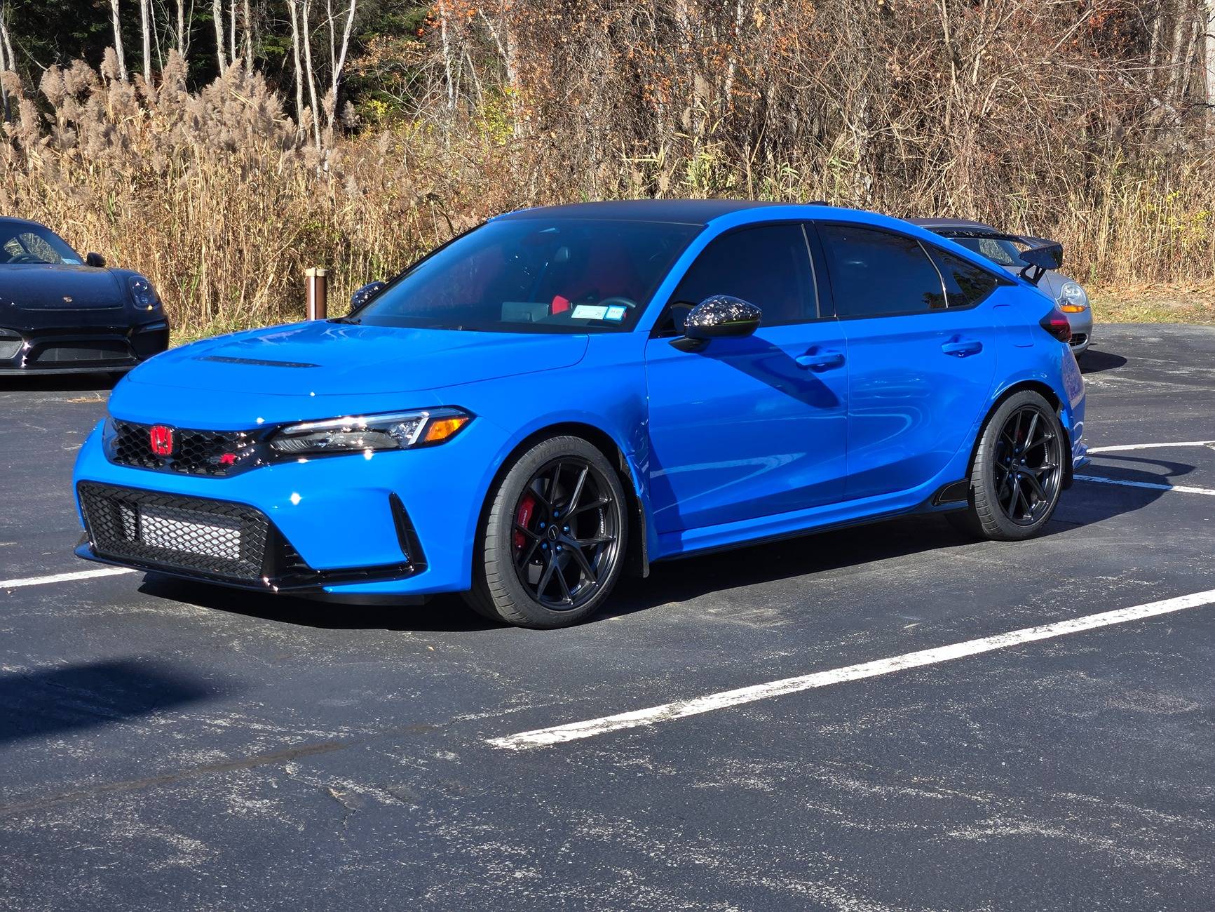

Anybody know what offset these are?
It was in the post above.
Unity Performance said:
Oh hey, that's our new FL5! Haven't had a chance to talk about it much on the forum yet, will introduce it soon
Specs are 18x9.5 +38 Superspeed RF05RR with 255/35R18 Michelin X-ice Snow Tires. Lowered on Swift's, no rubbing. Also swapped over to the DE5 ADS Module

I have +38 and mine are not tucked in like that.
