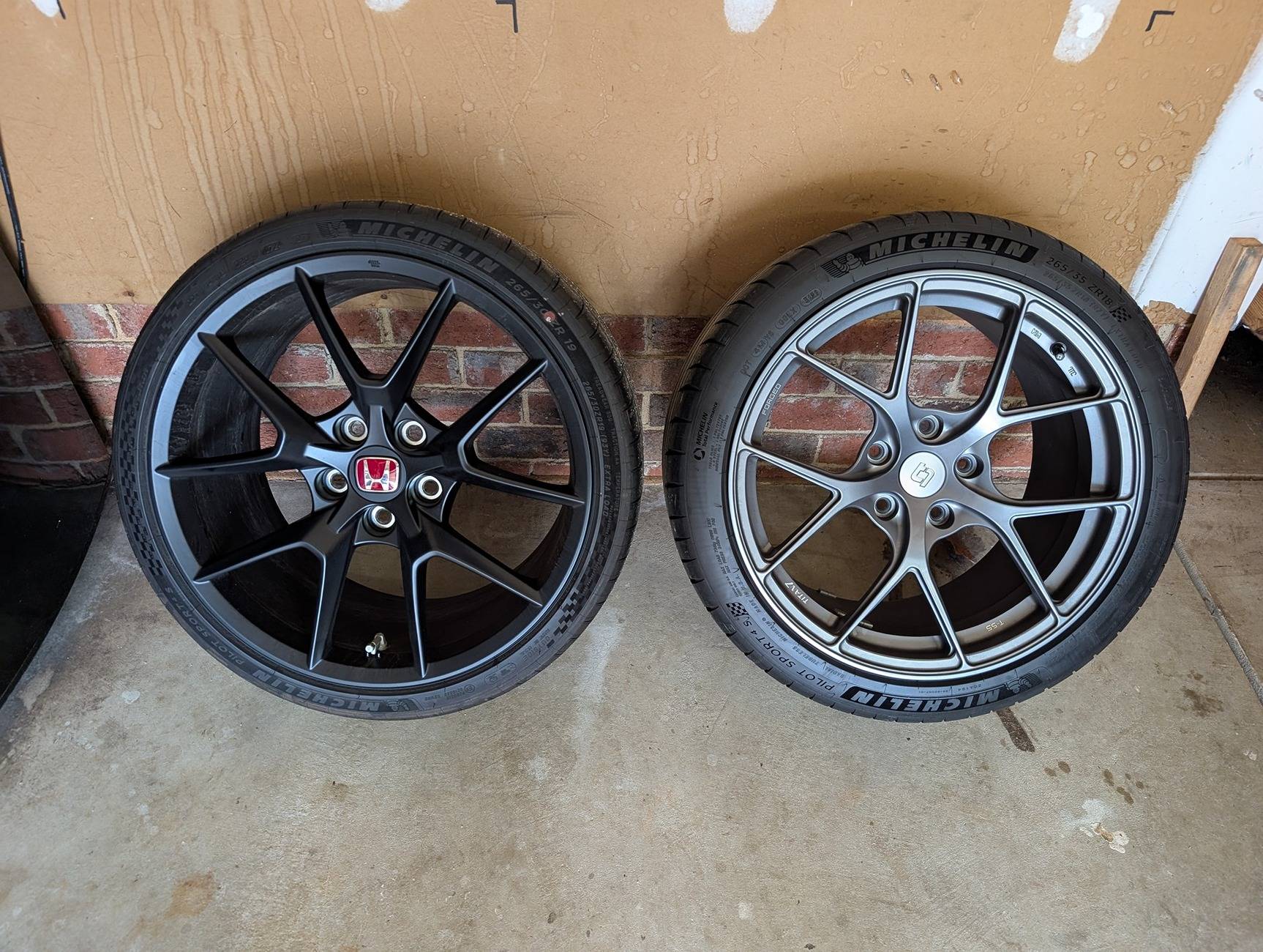

Its always been my opinion that the Titan7 forged T-S5 looks near identical to the stock FL5 wheels and the 18" version save about 7lbs over stock w/ tires. (Stock = 52lbs., T-S5 = 45lbs.)
11th Gen Honda Civic Lighter wheel, looks stock, same specs? titan T-S5 vs stock FL5

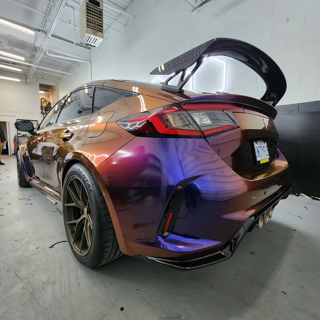

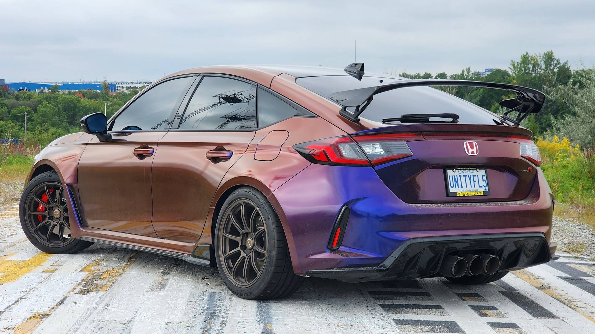

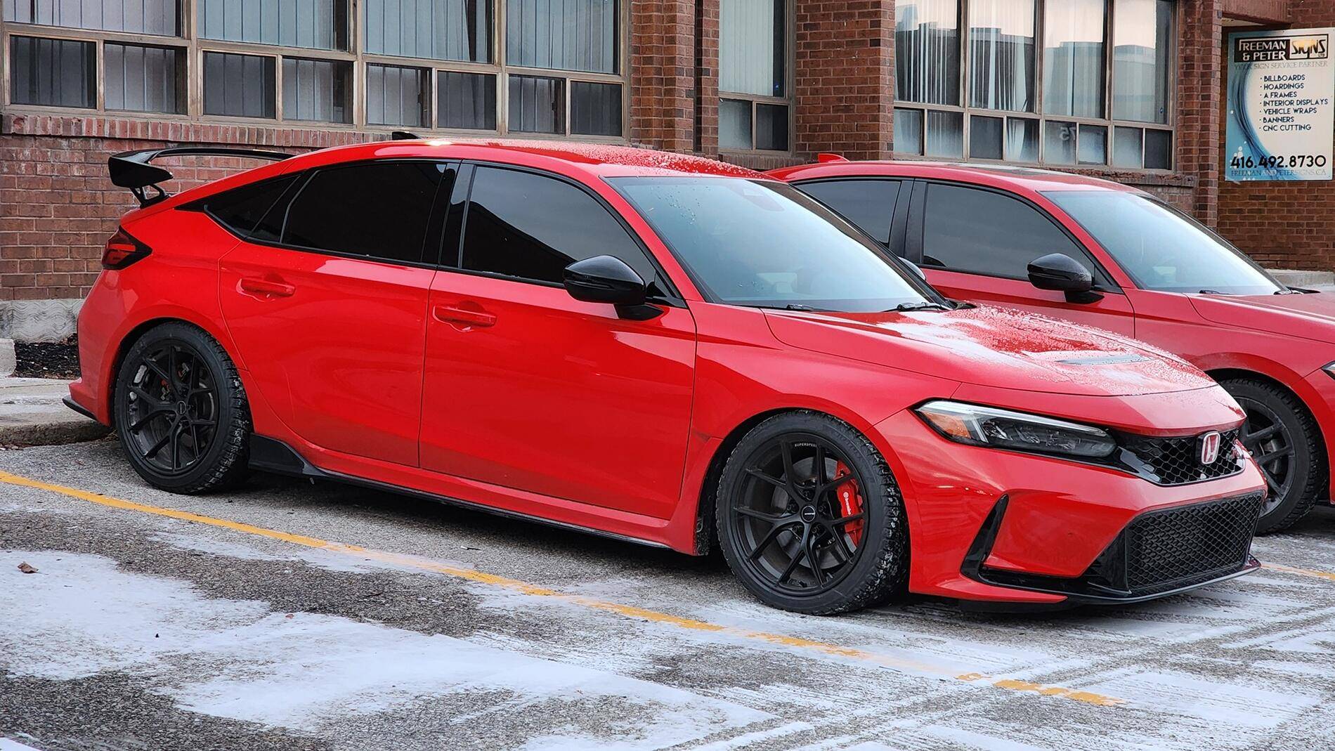

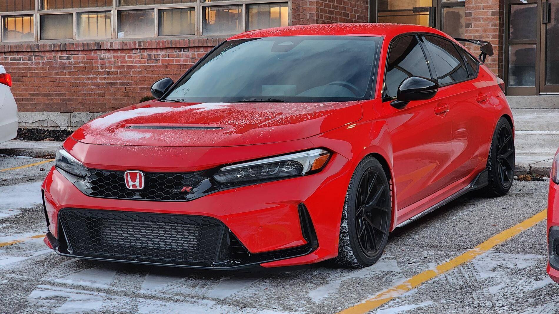

Here are the superspeeds on an FL5
Oh hey, that's our new FL5! Haven't had a chance to talk about it much on the forum yet, will introduce it soon
Specs are 18x9.5 +38 Superspeed RF05RR with 255/35R18 Michelin X-ice Snow Tires. Lowered on Swift's, no rubbing. Also swapped over to the DE5 ADS Module

Nice. Would you run 265 in summer?
Will clear 265's with ease, and we've seen others run 275's on the same wheel and suspension setup. Although I'd leave it at 265 as a fully loaded car with passengers and/or luggage may rub.
Briefly we ran the same wheel and spec with 265/40 on our first FL5 (not lowered at the time), which filled up the wheel gap quite well. When we lowered the first car on Spoon Springs we did 18x9.5 +45 with 275/35R18.
