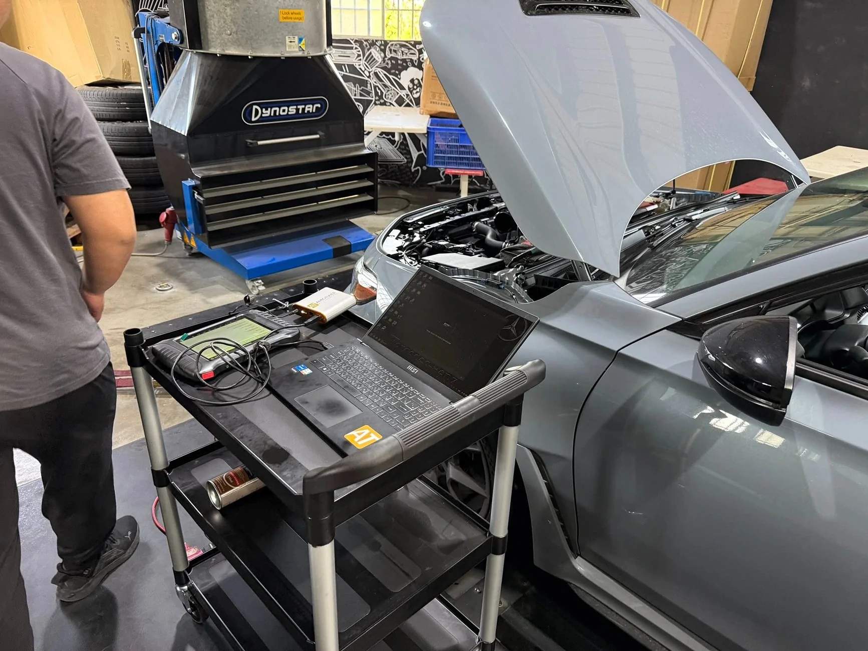

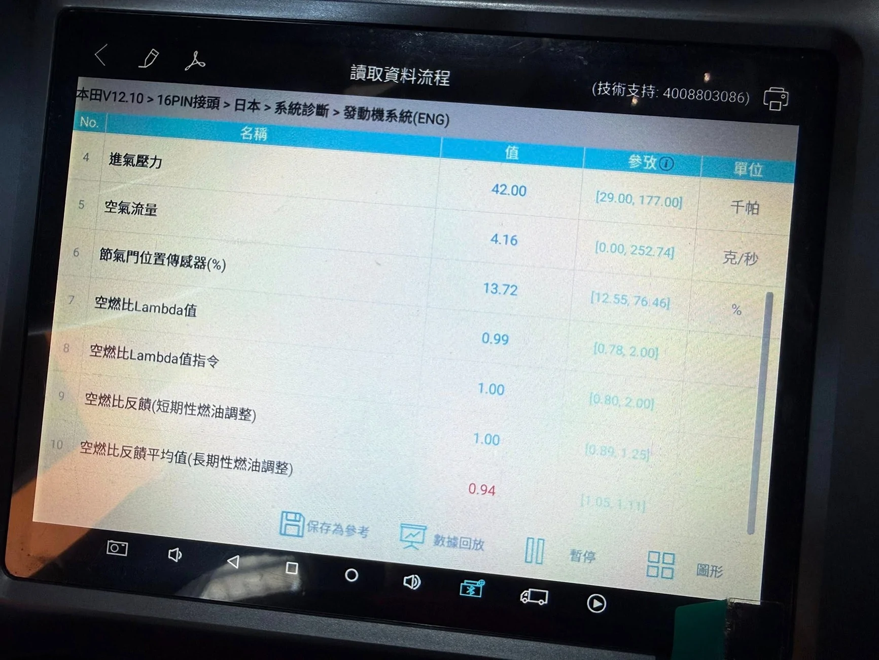

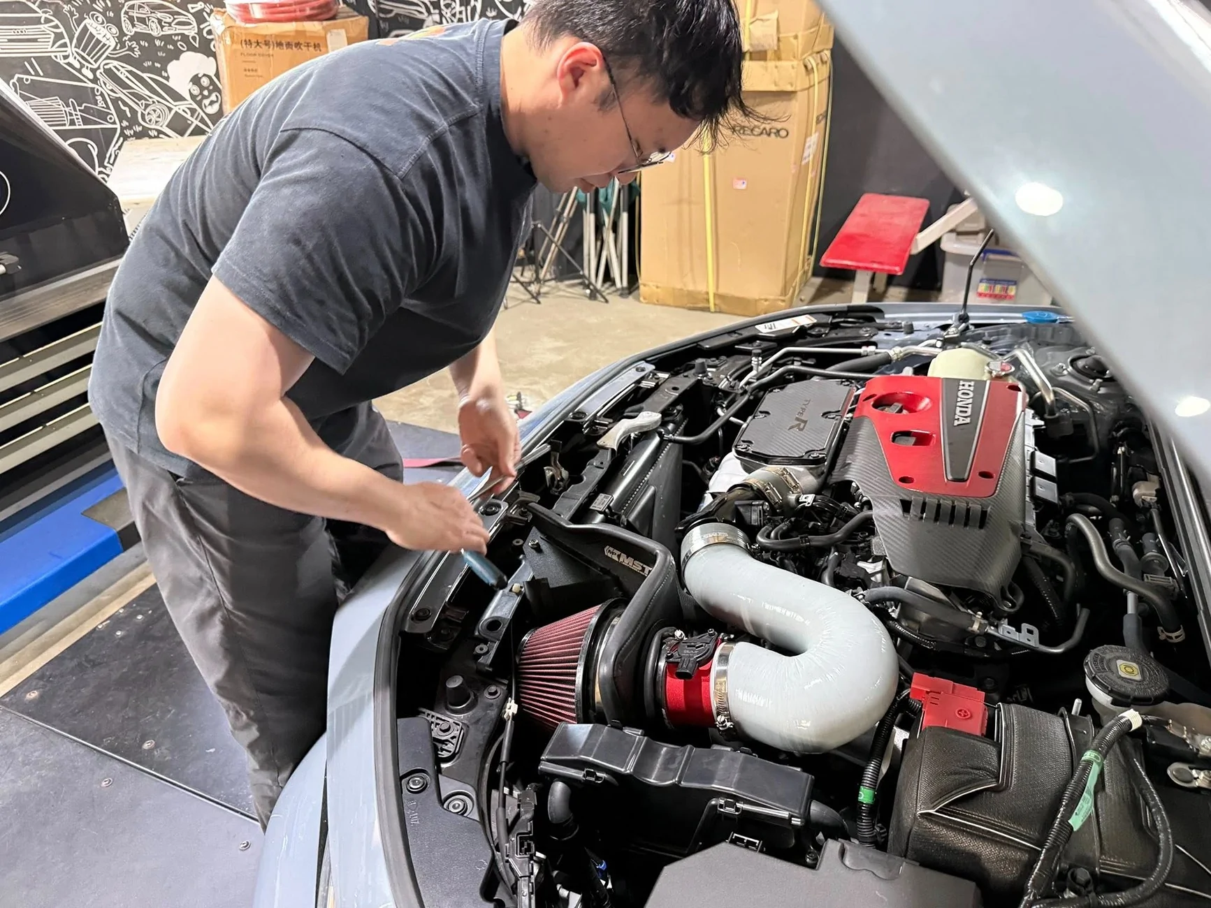

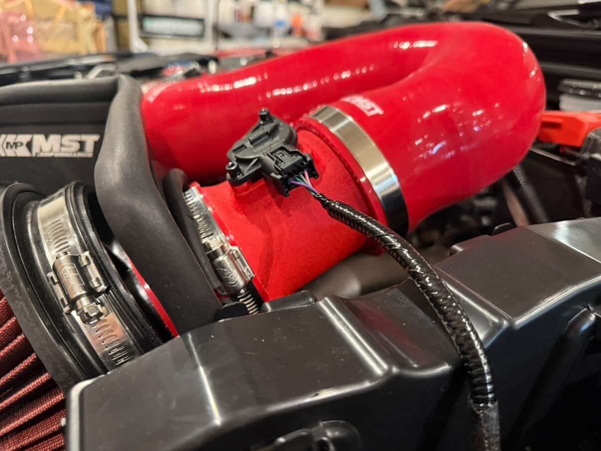

it was not the problem that we thought but because of the everyday customer we all made a better product (pending further tests of course) They figuredit out pretty quickly and working OT this weekend to keep running tests to confirm even more. I will update when I am allowed to they are going to make it up to everyone and send something free and also send the part to replace. Photos of them testing the issue. Fuel trims are now close to stock but they are going to keep testing

Thank you so much I do think if MST or someone can please post fuel trims we would be at ease versus some of the misinformation that was being put out regarding wonky trims.
I do understand some people having the wonky fuel trims could have been due to having the faulty intakes.
Even if any of your customers are being tuned by Vega and he can provide the data log showing the trims.

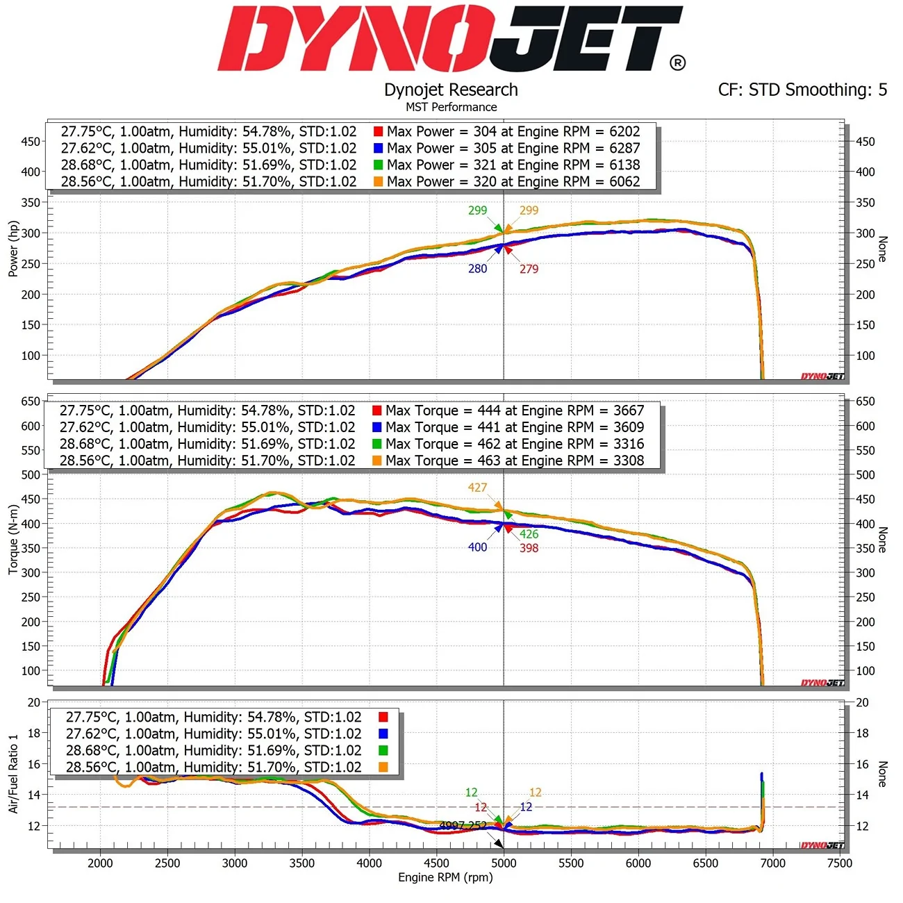

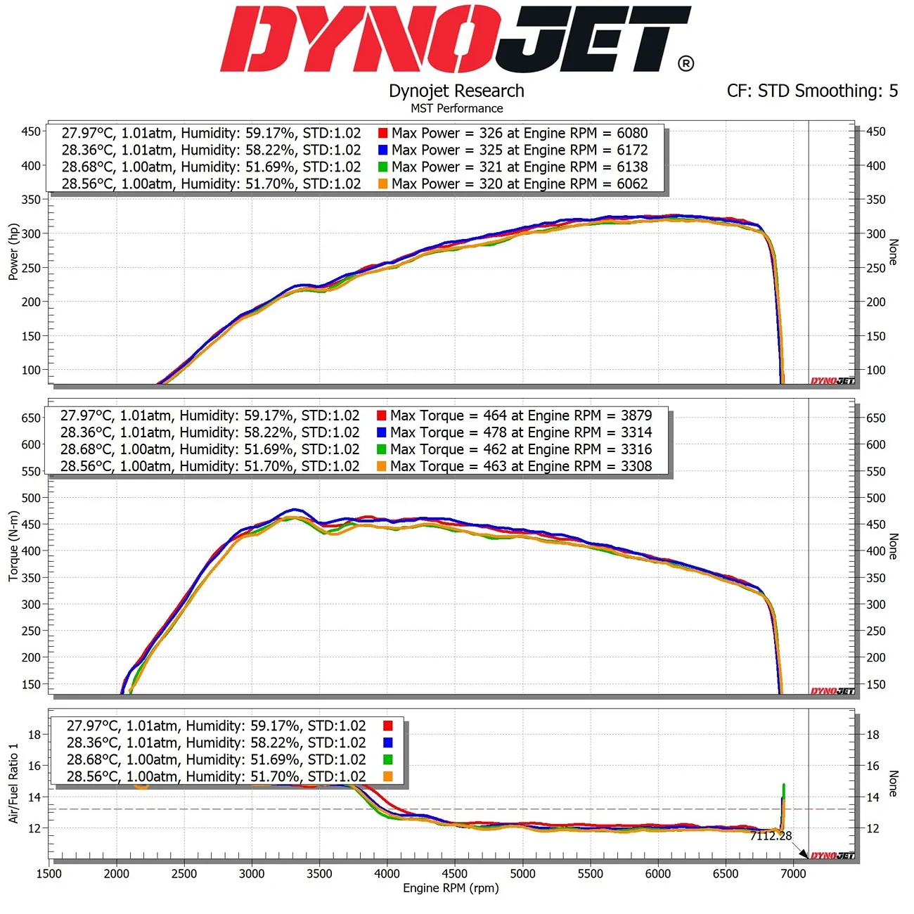

With the new housing they are designing this is the latest dyno chart. Will keep you updated they are making new maf housings the other ones were 1mm off on some new fuel trims are stock like

MST has identified the cause of the fuel trim / CEL issues that occurred on some units. The MAF tube diameter with the aluminum sleeve installed was approximately 1mm larger than stock, which caused air to flow at a slightly different speed and affected the MAF sensor readings.
For vehicles that are tuned, this generally has less impact, but many people chose this intake specifically so they wouldn’t need a tune, so getting this corrected was important.
Credit where it’s due the issue was identified by members of this group, and MST responded quickly and began working on the solution immediately the next morning. This is exactly what I hoped this community would be about: openly discussing things good or bad, and working with manufacturers to improve products. I’m glad to see MST listening and jumping on a solution right away.
MST has revised the design, and the corrected MAF tubes are currently in production.

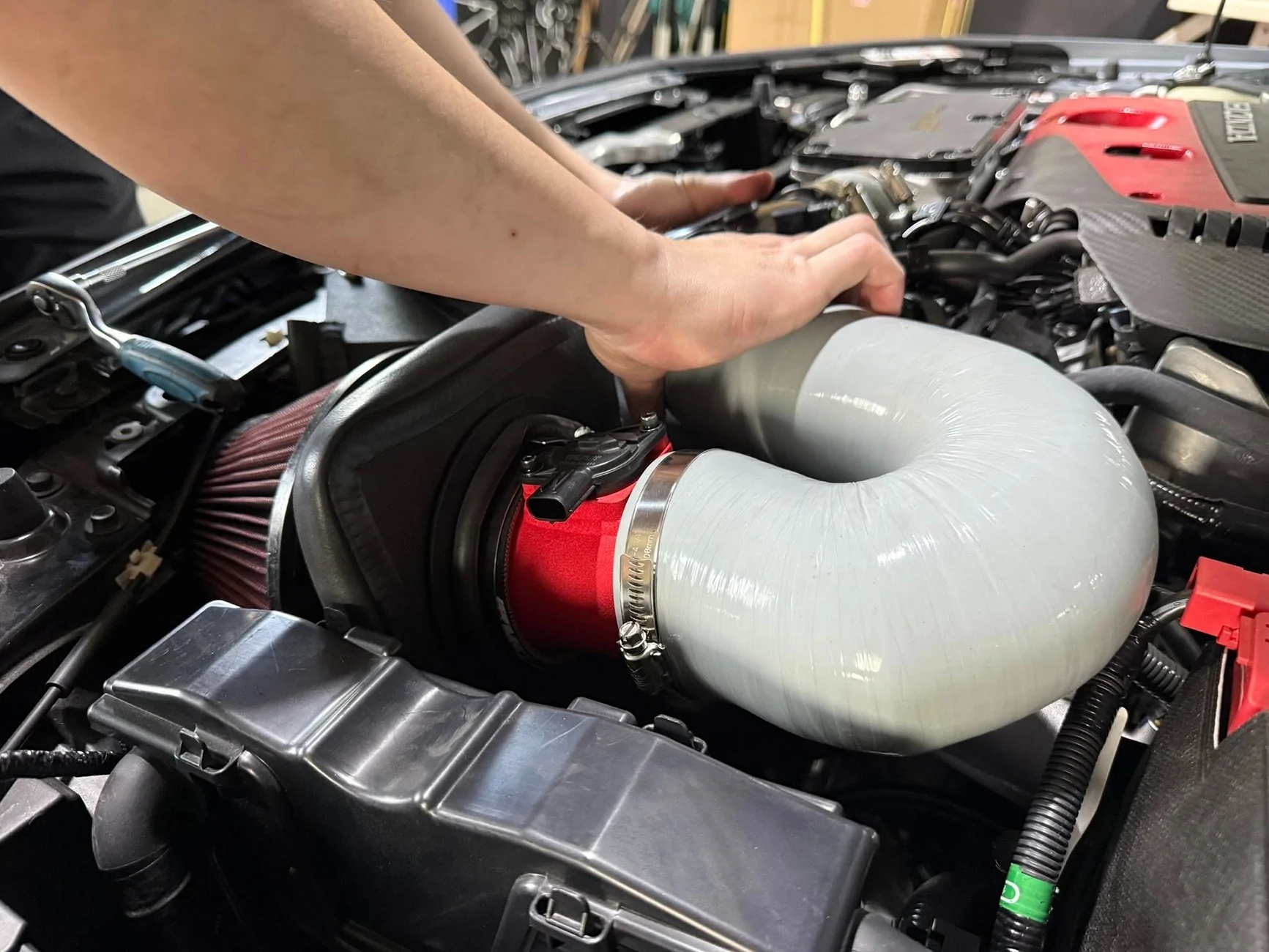

Below the red is the tested new design "not final". Fuel trims were close and hitting stock numbers with this one during their tests. Again thank you Dennis Smith John Vega phearable.net for the research and idea to look into it thats what I want in this group not just people talking bad without any input on how to fix it.
The dyno is the new numbers they got during testing. Slightly less peak but look at the mid range

Dam yes. Ill take less power, but stable fuel trims.
So are they now close to stock? Hard for me to read the chart.
Thank you again for the continued updates and working with them, especially as a vendor and fellow FL5 owner. You went above and beyond and won another customer.
Appreciate the support! They are not the only ones that had issues upon release of an intake I am just happy they are willing to work with us and listen to the customer base! They are really hard workers had the issue figured out in the morning the next day. Not many companies listen they could have just left it and let tuning take care of the fuel trims but they want this for the people that do not want a tune. Power is still there with the new housing its awesome! I rather have a nice sounding intake with proper fuel trims over power thats bad for the engine. They will also be protoyping a 82mm housing for the big power guys which I would use for my build. DM me anytime for questions!

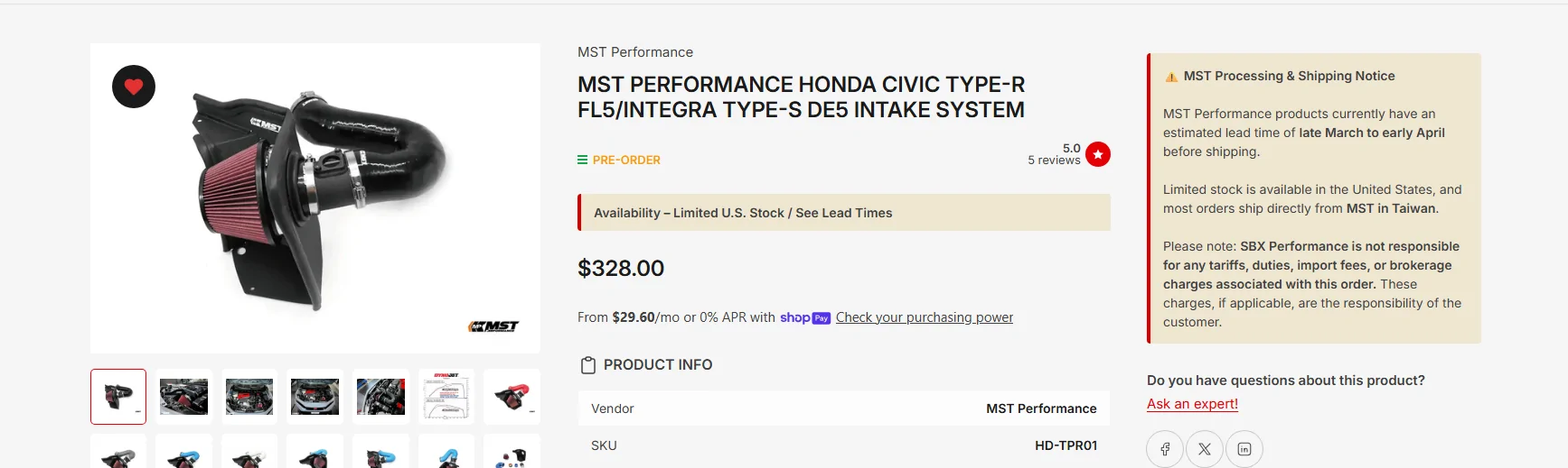

Please keep us posted when they are available for order and one last question obviously I see we have to pay shipping do I have to pay the tariffs as well? Or is that included?
I am actually impressed how fast they solved the issue for us. Next morning they were on it. New trims from their test FL5 looks perfect! I am covering half shipping from tawain its actually double that and yes you pay tarriffs. I was doing pre pay tarriffsbut they keep changing the rates on tarriffs its impossible to follow lol Don't worry people are ready to take it back and test the trims when they send them replacement housings soon.
