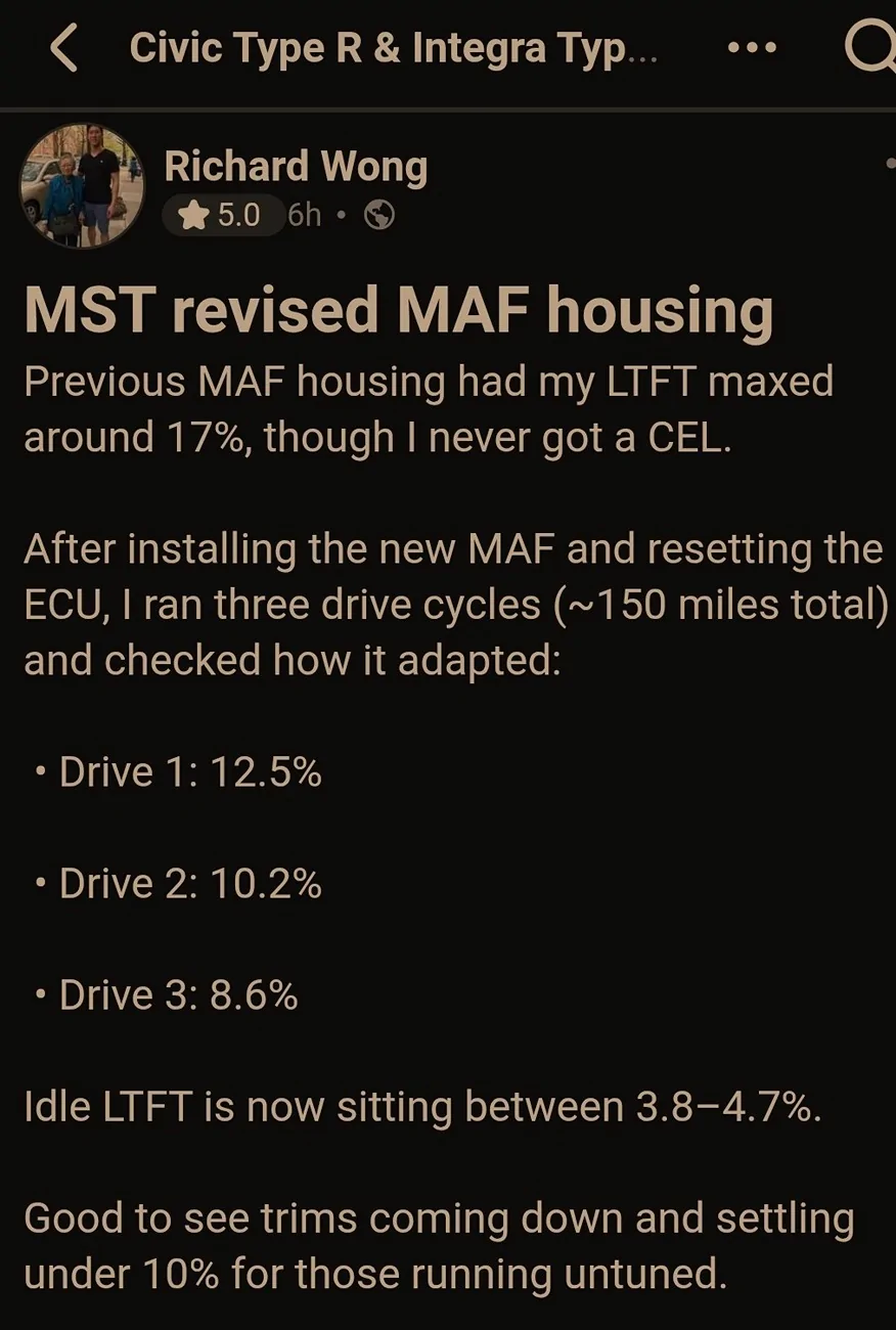

I definitely think if some of the users are now able to post their logs or their fuel trims, it'll definitely help prove that they've improved or fixed the issue which I definitely believe they have.

I ran my trims on a drive that was about 20 minutes long. I have a 1 minute video showing my Short & Long terms. I cant get it to post here but if you DM on IG ill send it. @chad_hannan
to summarize, both look stable as short hardly ever goes over 10% and then immediately drops, and long hasnt gone above 8%

People just need to put some more miles on them and the fuel trims will start to show the improvement. Half my customers are tuned and half are running this as their first mod, so the results will vary a little but they'll comeI am interested also obviously. They showed me their data and it looked good on their car over there. People just need to do 200+ miles then check and also make sure to reset the ECU.

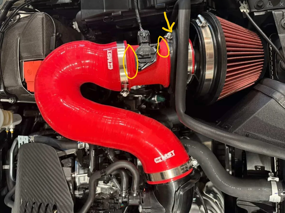

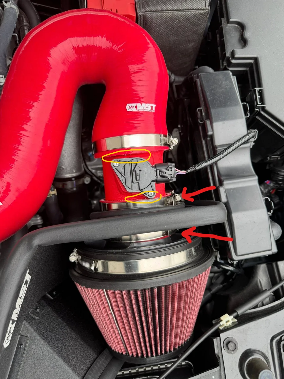

Just installed the intake with the updated red MAF tube. Has anyone else had issues trying to get the MAF tube and velocity stack aligned?
There's two clamps that secure the silicone hose to the MAF tube and velocity stack. The issue I encountered is that there's not much space, and the clamps get squished against the rubber opening on the heat shield. It kinda throws the entire intake alignment off, and makes it difficult to seat everything properly. For me, the MAF side clamp isn't really clamping anything because it's resting on the narrow section of the MAF tube (since it has a taper). I assume I just need to keep adjusting my setup to make it align better. Look at the two pictures below and notice the gap/clearance:
