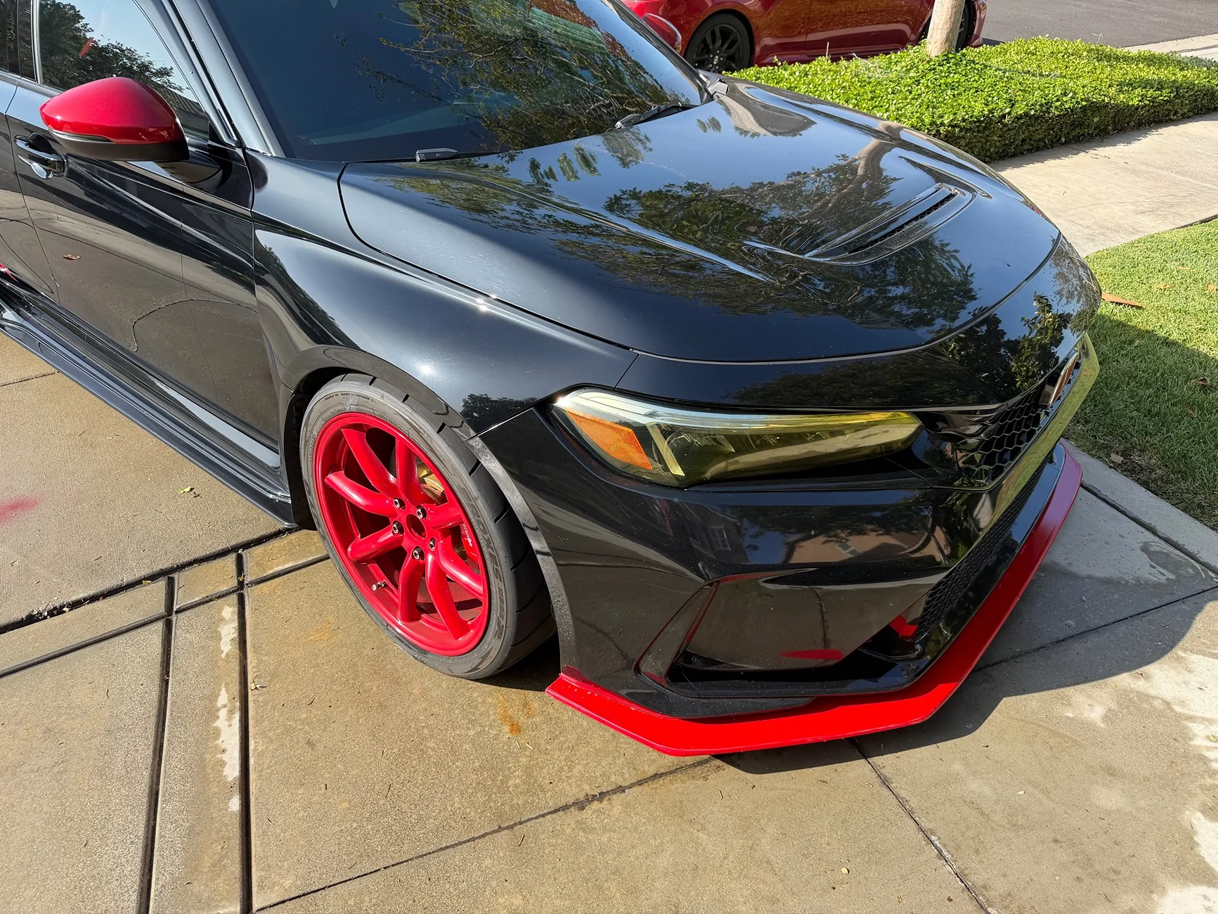

I don't know.
Sometimes less is more, and sometimes moar is more.
Those agressive side vent canards are definitely moar, and probably a bit too much for me. Like @Evox787 said, however, maybe it's just due to the red vs black contrast...? I dunno.
Then there's the anxiety vs peace of mind in knowing how well the vent canards are attached ... or not.
?) Do they plug into the wheel well at any point, or are they just 3M slabbadabbed onto the fender?
?) If they are not really truly secure, then are they gonna slip off the car at an inopportune time, which is any time that you are not intentionally removing them yourself?
?) Without the aggro vent canards, will your car be "Kustum E-Nuff"?
Life's questions persist.
My vote is for peace of mind knowing that if the canards are not even installed, then there is no risk of losing them. Kinda lame, I know, but that's how I see it.
Plus, I think the front end looks good without the canards and with just the lip installed.

To me, it looks good! If people put on the HKS, it’s basically the same concept, but the JDM purity somehow makes it feel better. I’m not a fan of the red, but your car looks great because of the way you’re customizing it, it really matches your vibe. It looks good the way you’re doing it! You are absolutely right why gate keep like some others that talk on having bespoke wheels or parts made just for them!🤡🤷‍♂️🤦‍♂️
Thanks EVO... The red is a bit bright, but i call this the playful stage. Where I experiment w/ a style seldom done. I struggle with sameness. Everyone literally builds their car the same, I don't mind pushing that envelope. From day one, this car was always going to be a spoon build for me. But, I know it's been done, and will be done, time immemorial. While waiting on parts i decided..... let's play. starting w/ my bespoke made wheels. HAHAHA so while I feel attacked, I dont. it's no secret if people ask.
Edit: in summary, and for a lack of better words, at the time - what I meant to say, is, I didn’t expect to see “sameness” so soon, on such a new chassis. If that makes sense.

Yes, everything is mounted. However, that's one of the problems. The company chose to stop being creative after the initial splitter mount design. The main splitter is secured. The side splitter is secured via the provided tab that mounts to an existing screw on the bumper.
where the concets falls short... the side spacers are a "press fit" plastic that mounts to the upright canard/splitter (yes, I've already lost a spacer), with 3m foam in between the bumper and spacer (wiggle room)..... The side canard/splitter is then screwed into the main splitter from the bottom. Problem is, this durable yet tender material strips easily, at 9mm thick, there's not much material to bite into, giving you that secure feel. You strip a hole? Side pieces are no longer secure. You hit a screw hard enough on the pavement, and the side splitter is gone my friend. My fix, was not bulletproof either, but the side splitter would have left the chat long ago if I had used the provided screws.
In the end, I've decided to leave it off. Thank you guys for the input. There were just too many variables to fix at this time. I do appreciate the uninterrupted lines of the front end without them. 😅

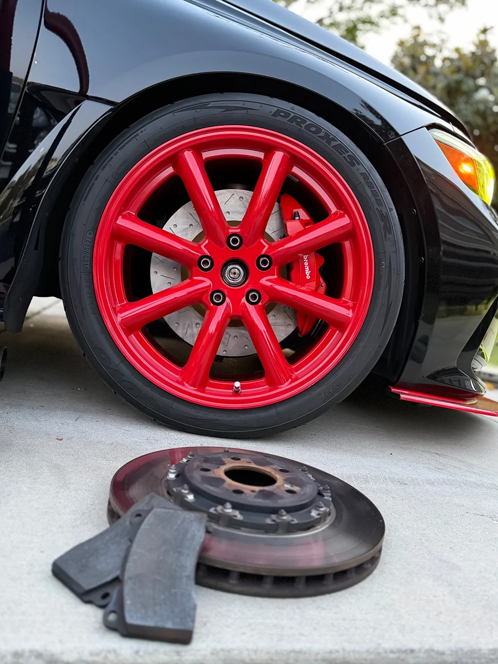

Car washed.... DFC Rotor + Akebono Pads installed today and performed my kirkland special oil change. :nixon:

They are two pieces? I’m for replacing my rotors on the next one or two oil changes. Because I think I need to replace pads also 🤣 need to check the car is on jackstands and I don’t even know!

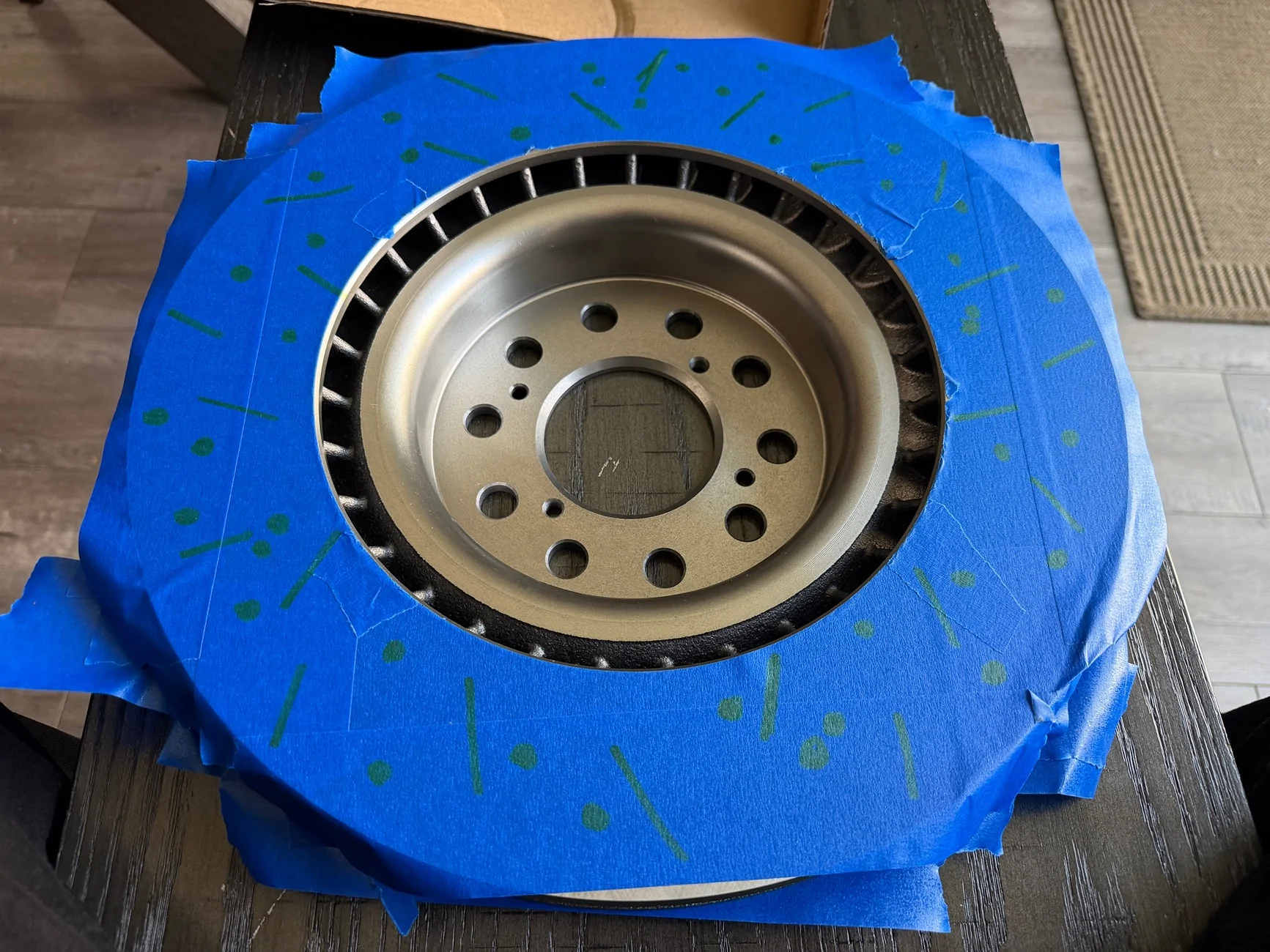

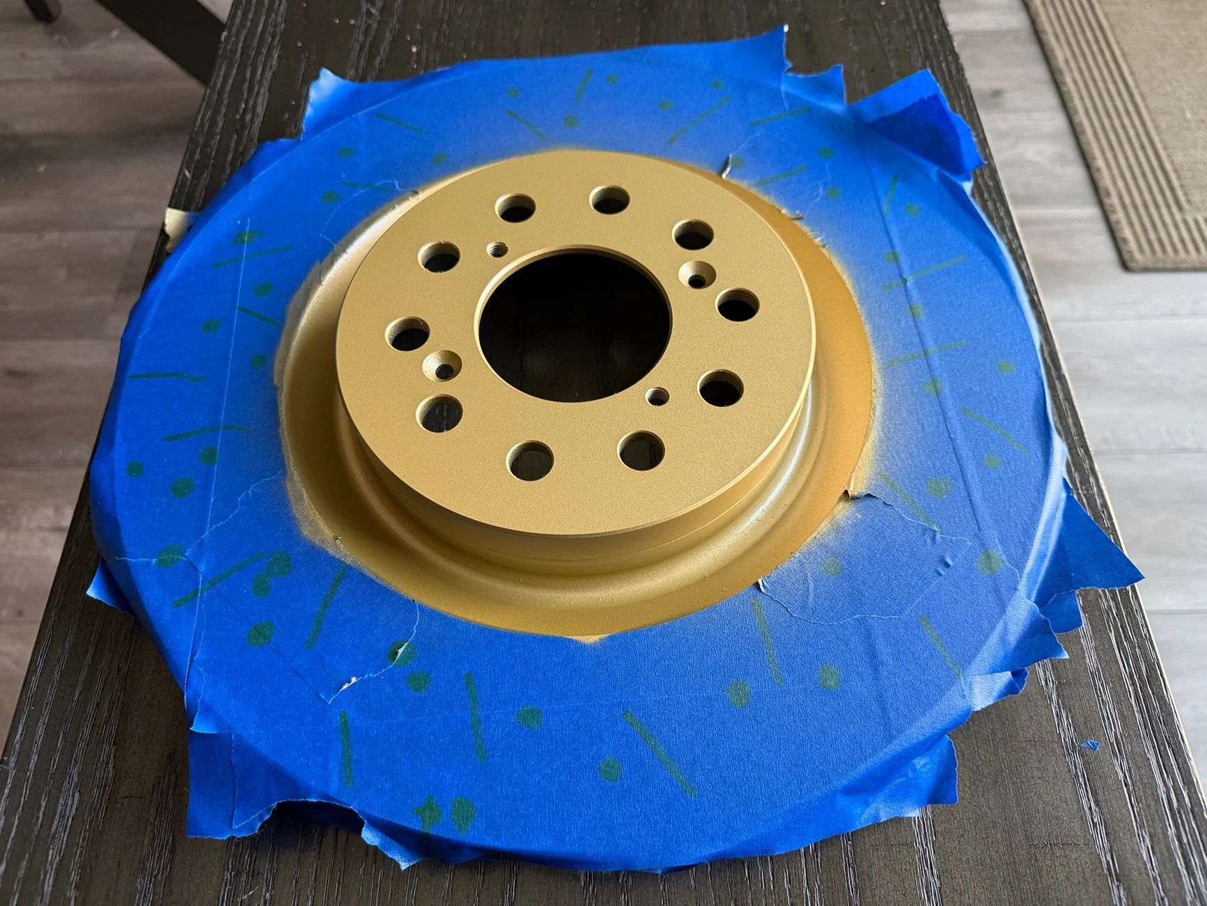

They’re a single pc rotor and blank. If I didn’t shatter my scale, I would have had weight measurements for you guys. Hand check, they are a few lbs heavier, not much but slightly noticeable.
Painted the hats to prevent rust, and did the customizations myself.

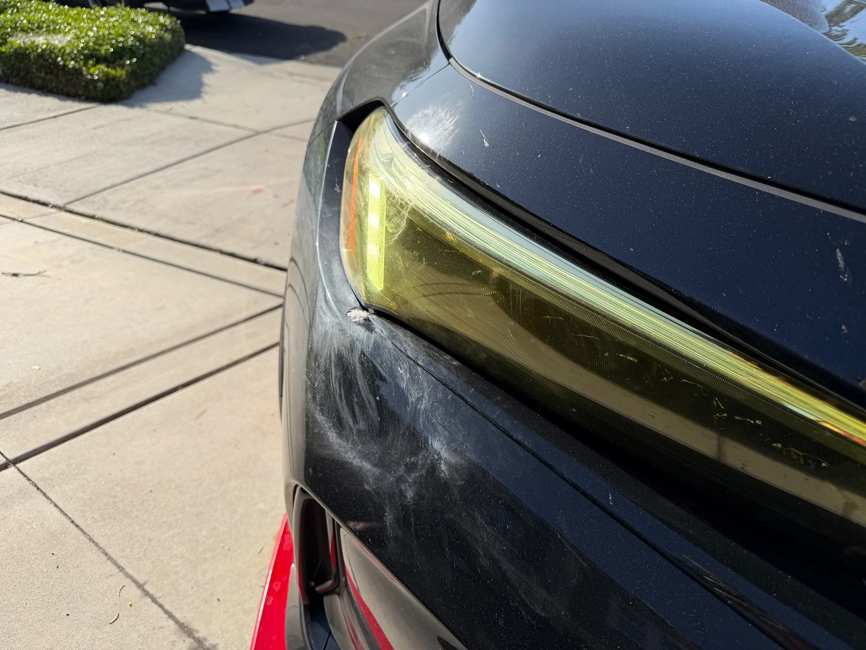

Played some golf after work this morning…. Hit a birdie. 😅 Hoping, that wasn’t the cause of the poop on the mirror, ‘cuz ouch.
No better time than the present, to try out the fantik e power washer.

If that’s a bird poop the bird was just mesmerized on how amazing the car looks so he said I need to do something to make him work! 🤣
