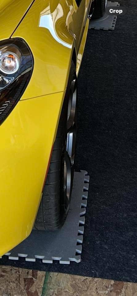

Got discussion going Sunday night cruise group in Winnipeg; guy suggested this :
Pump the tires up to 50psi and place some interlocking mats underneath. Just drive on. The tires will sink in and leave the thread pattern indented.
I have ps4s also but do it for all my cars.
Oh I have those, that's easy! Thanks for that.
