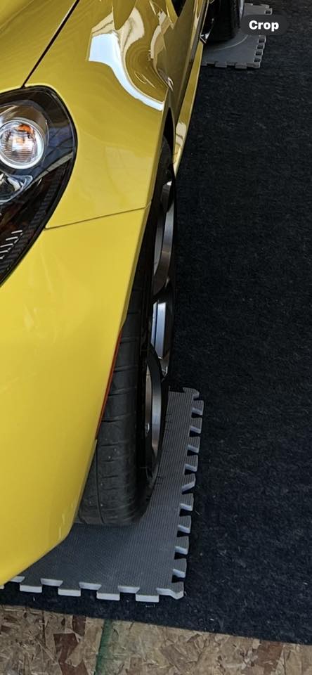

I am part of the Wpg. cruise FB group. One person with same tires said (which is interesting)
"Pump the tires up to 50psi and place some interlocking mats underneath. Just drive on. The tires will sink in and leave the thread pattern indented. I have ps4s also but do it for all my cars."
Thoughts? Seems to be working for him. Easy to drive on too!

Yes, over-inflation to 45-50 psi is a good idea. These cars ship with their tires over-inflated to 45-50 psi from the factory (to help prevent flat spots during shipping).
In that pic, it looks like he’s using more than foam/rubber mats. He’s got an insulating layer of particle board (great idea) and some kind of cloth mat too (also good idea). Those rubber/foam mats probably won’t help as much as the Flat Stoppers, but appear to perform the task similarly.
Looks like he has the right idea : Get the tires up off the cold concrete, use insulating layers of materials between the tires and the floor, use a compliant material to “cradle” the tires so they aren’t completely resting on a flat surface.

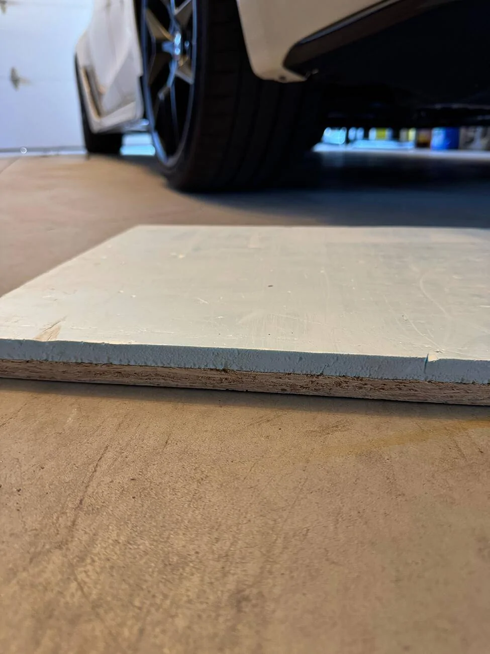

Good points. In the past I've used a smart battery tender on the installed battery. I heard it is better for the battery and you don't lose electronic memory from computers in the car. I still haven't decided what to do about tires, but have found 1/2" foam adhered to plywood pieces that would insulate and spread the contact patch of the tire more. No snow yet so havent parked it yet.
