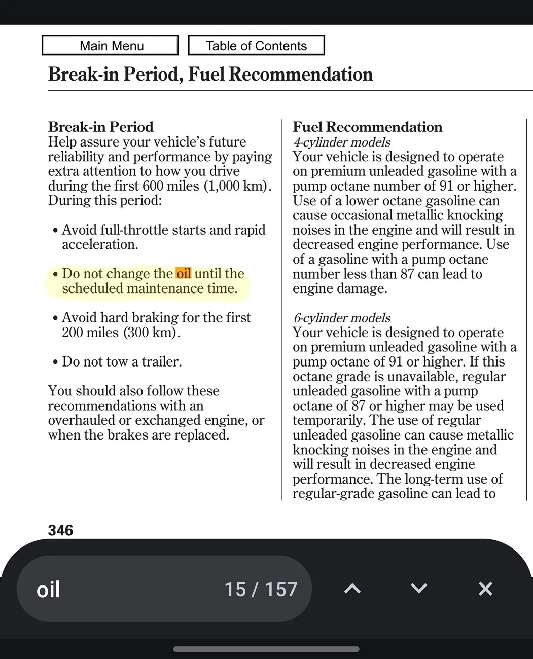

The Honda break-in oil blend at factory was a thing back in the day. The way I know is it specifically stated in my owners manual under the Break-In Period....not to change the oil until the scheduled maintenance time.
This was well over 15 years ago. I did just that for the first oil change, still have the car today. But I obviously do the oil changes more frequently after that.
The owners manual for the FL5 and other recent honda/acuras dont say anything about when to do the first oil change. If it was special break in oil, they would have put it in there. I dont wait for the MM on these cars, ever. But thats just me! 😀
Here is a pic of the owners manual from over 15 years ago.
