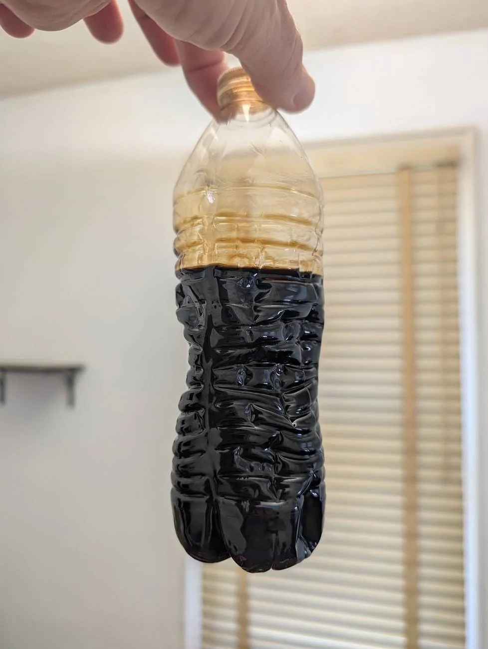

Ordered my kit but, this is what it looks like at 4,930 miles. I did the recall today too. My buddy who's the dealers master mechanic did the recall fix and the oil change in about 40 minutes.

That looks yucky

Start changing more frequently for sure!
I mostly travel to work on the highway but, I live in a city so short trips happen as well, and my guess would be that's what's doing it is the short trips. I let it warm up for about a minute, drive easy until she warms up, I'll see what blackstone says eventually. I just ordered their kit. I should've ordered it when you said something.

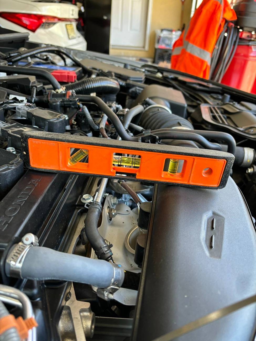

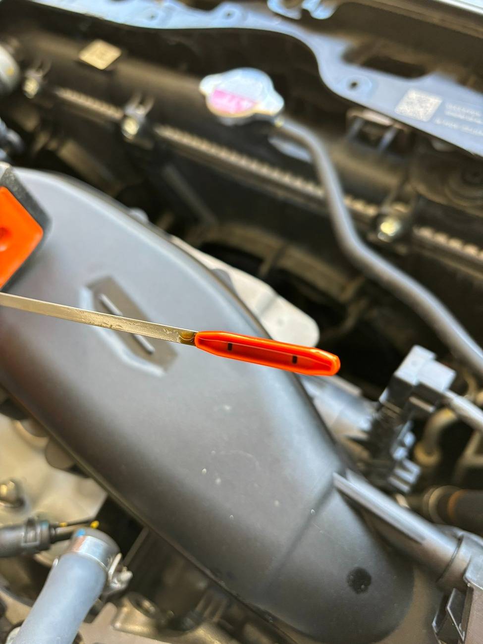

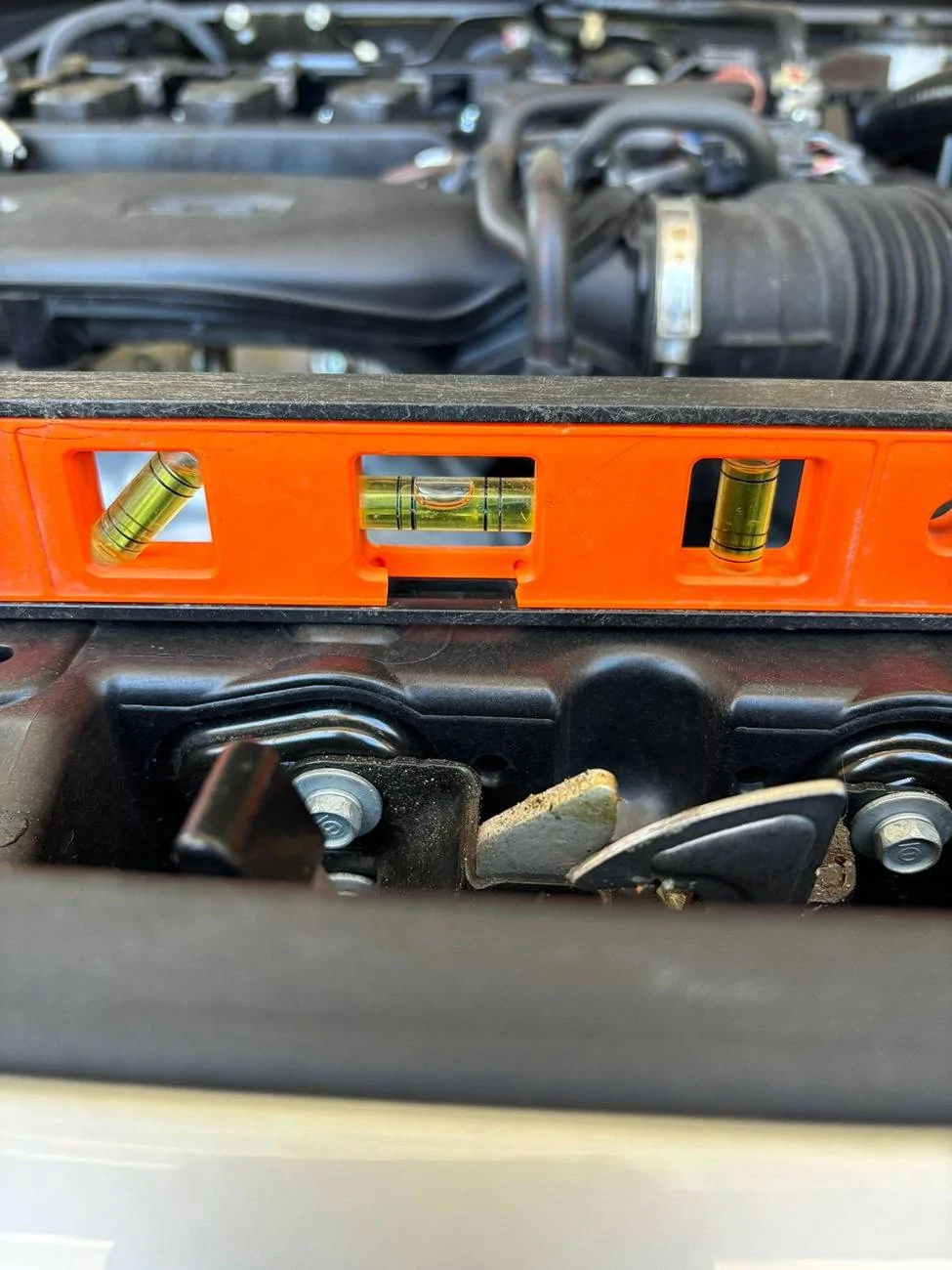

I wanted to update everyone on the 2024 Honda Civic 1.5 Turbo.
Originally, I had changed the oil at 2,339 miles as part of a break-in. New oil and filter, and exactly 3.7 quarts, and that is what came out. No oil smell or even a surplus after the drain.
Skip ahead to 6,749 miles, or 4,410 miles later, I had the dealer change the oil under the free oil change.
Now, the winter rolls around, and then into spring, with some time constraints on changing the oil. So I waited until the 20% mark and went in for another free oil change (last one), which was 7,676 miles later and at 14,425.
Given that the oil was dark, I checked the level and it appeared to me high on the dipstick, and also a smell of gas. I asked the dealer, and the tech stated that because of the cold weather, the ECM compensates for something. Their take was that they made sure that it had been filled to 3.7 quarts, and that is it.
THE RECEIPT: The receipt from the Hond Dealer had shown 5 BULKOW20 BULK OIL OW20 & I remember calling them. The service department stated that that is what they write. It could have been overfilled to more than 4 quarts, and they billed out 5 quarts. The 2.0, I believe, takes a little north of 4 quarts or right around there? It was hard to check the dipstick with the orange color and clean oil.
Question: Can I go 5,000 miles between oil changes, or should I limit to 4,000 miles? The cost associated with the oil changes is negligible and right around $30. The dealer would be almost $80-$90 (not sure). I want to keep this car for as long as possible.
I do not want to wait until I reach 20% to change the oil, or 7,500 +/- miles. If I wait too long, I may not have time to change it, which will put me in the 8,000 to 9,000 mile range. Given my driving habits are 90% highway and long, so there should not be an oil dilution issue (I think?).
Thoughts? Thank you in advance.

Would not at all worry about fuel dilution until you can objectively see it on a oil report (dont use Blackstone) I believe the standard is to have 2.4% or less of fuel in oil for most cars anything above that is a problem.
For oil I would say to use Mobil-1 ESP because it is specifically formulated to reduce carbon buildup and fuel dilution in modern GDI engines.
Lowering your oil change interval is always better.
