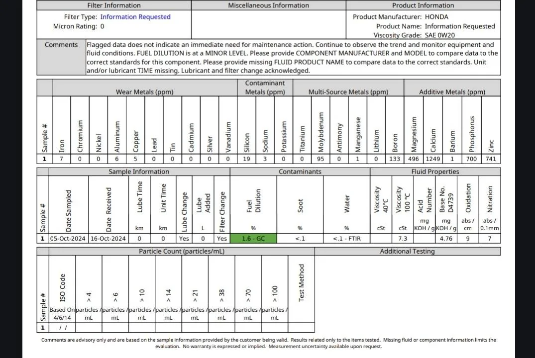

Here's ones I just got done. The car had just under 12000kms and it was it's third oil change...2500, 7000 and about 12000...Honda oil and filters...
this is the Cdn lab that amsoil uses and the report came back a couple of days after I mailed the sample...
I'm not an oil geek so I'd appreciate any feedback
