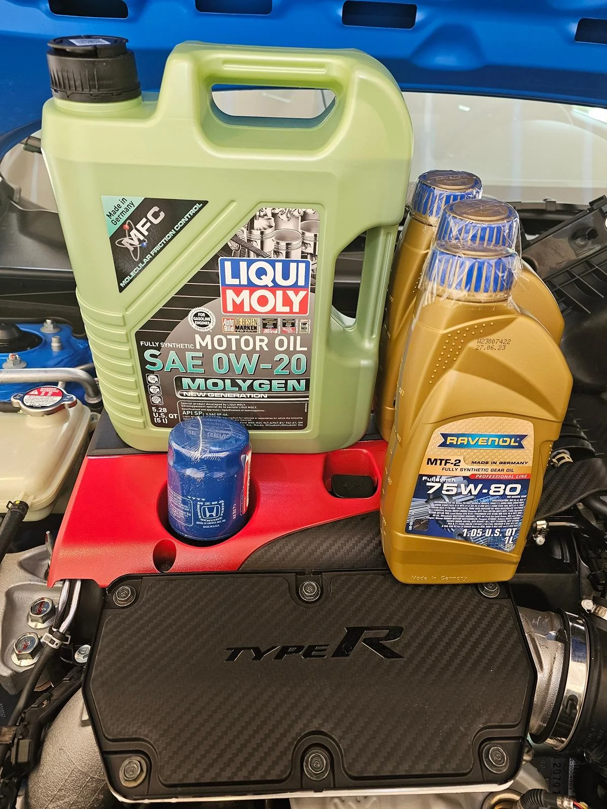

I'm a fan of amsoil and the SS definitely exceeds the specs required. I'm also a liqui moly fan and run that between routine service visits. Keep up your service visits and run what you want in the mean time.
