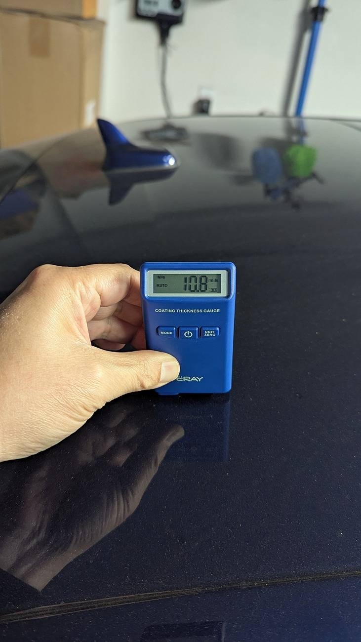

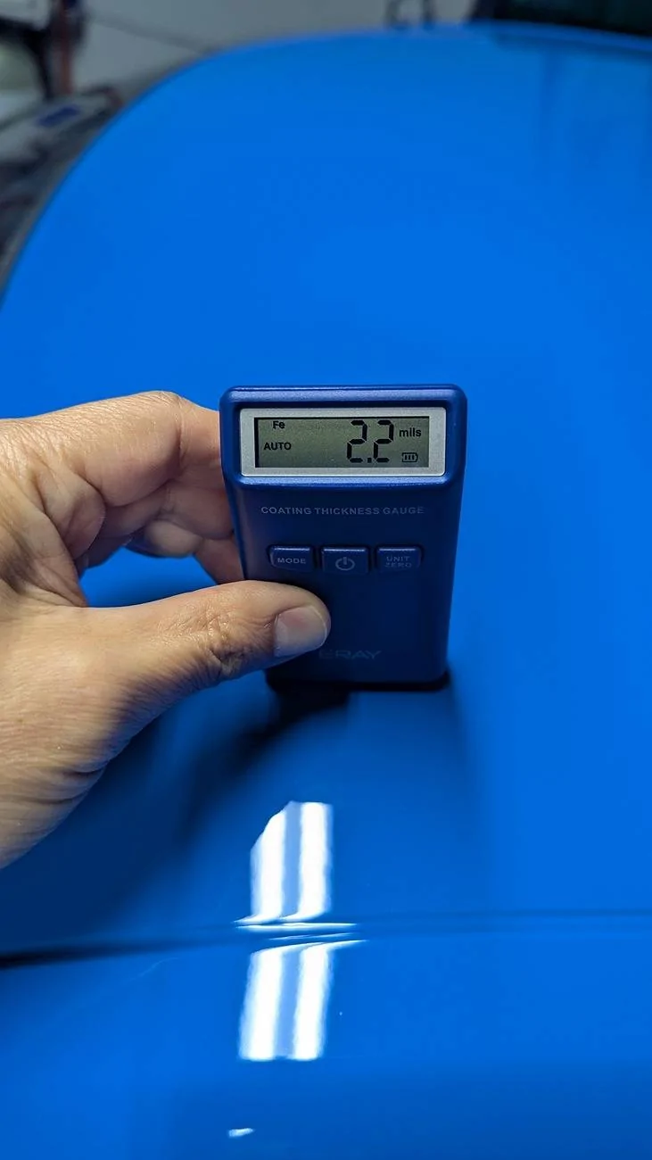

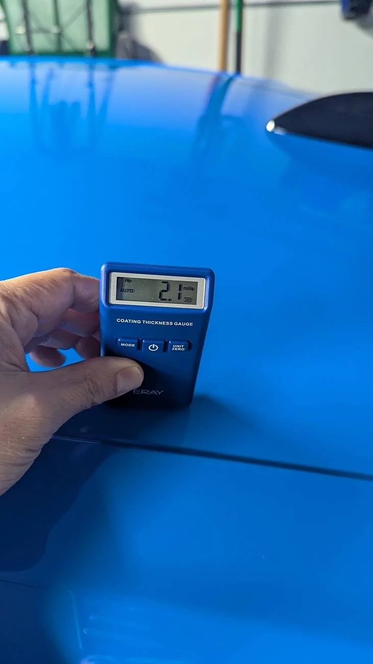

Since I have a paint depth gauge, I decided to do some measurements on the paint just for kicks. This revealed another cost cutting surprise. I got readings between 2-4 mils. Most panels are around 2 mils, which is super thin! As a comparison, my wife's Audi S3 got readings between 8-10 mils. Both of our BMWs also have readings between 8-10 mils. I guessed I now understand why people are complaining about their CTR's paint gets chips and ding up so easily? I wasn't going to ceramic coat the car, but now am really rethinking that maybe I should? :hmm:

Ceramic coating will not protect from chips, its to make the surface more hydrophobic to help repel water and dirt and make it easier to clean your car. PPF would be the way to go if you want to protect the paint from chips.

I understand that I can't compare "most" Hondas to a "Luxury" brand like Audi or BMW, but the CTR cost more than the Audi that I was referencing! I mean, the Audi S3 you can buy off the lot today is the same if not less than what you would pay for the CTR! Maybe my expectation was a bit high? I sure wasn't expecting the paint to be 8-10 mils thick like the Germans, but I was expecting at least 4 mils throughout the car, which I thought was industry standard?

Upvoted for having actual data to support the "thin paint" claim.

I've owned several German cars and yes the paint looked great, but increased thickness doesn't mean more durable. I found the rock chips harder to fill in, because the paint was much thicker.
Years of painting experience tells me the thinner coats to get full coverage are better than thicker coats. I'm not using abrasives on my cars, so no danger of wearing through the finish.

I used to have a 93 Civic Hatchback, engine bay definitely did not have a clear coat, but the door jams were cleared. I also had a 2007 Civic that was the same as well as my current Sport Touring. The back side of the door though is matte, the rest has a clear, but the clear and paint for sure was always on the thinner side just like you have shown with your depth gauge. I don't know what to tell you with yours though, that really sucks that they didn't get those parts that should normally have had a clear coat.

I don't mind having thin base coats as long as coverages are good. I'm just worried about the thin top/clear coat, which is where most of the protection comes from.
