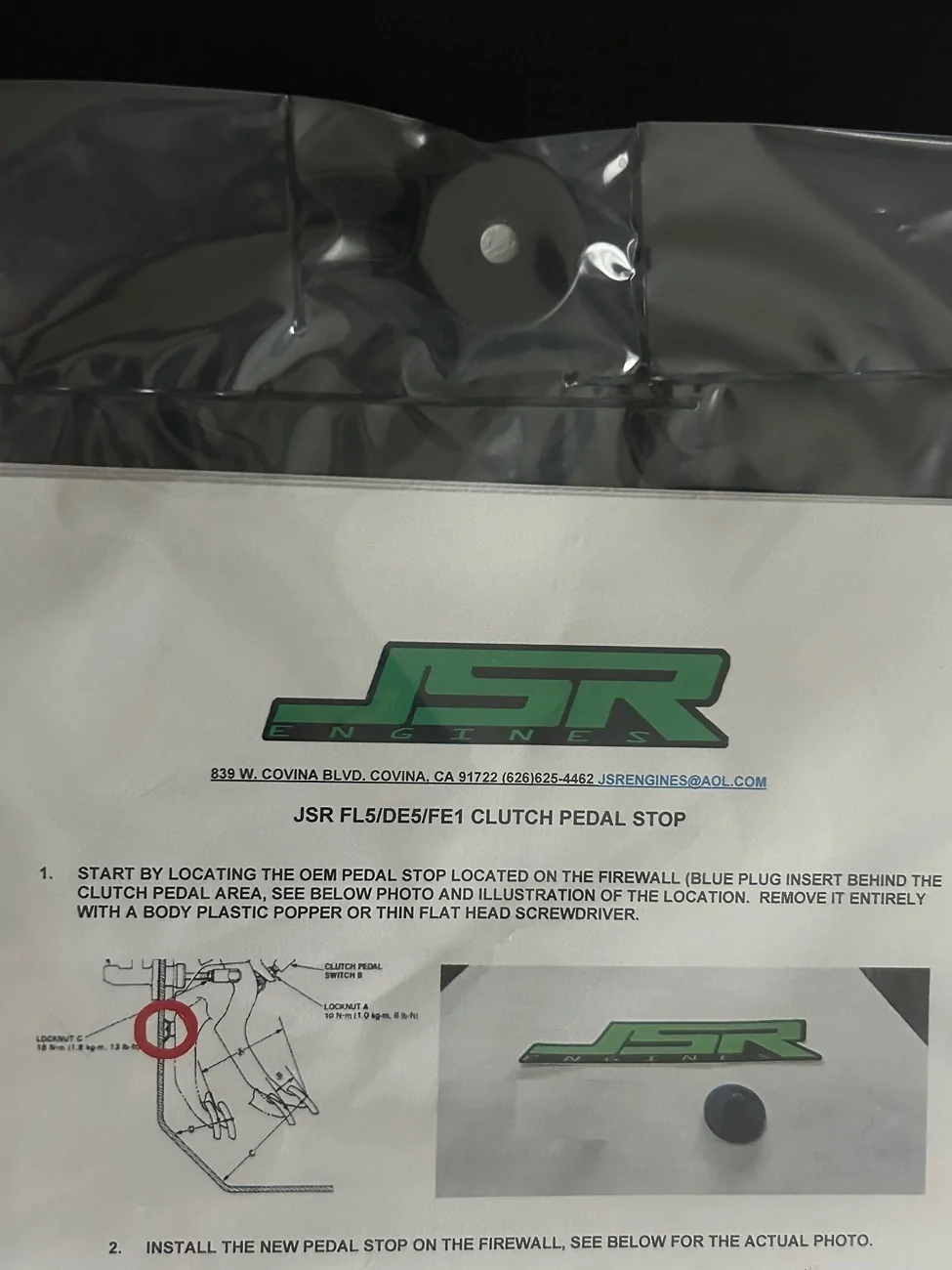

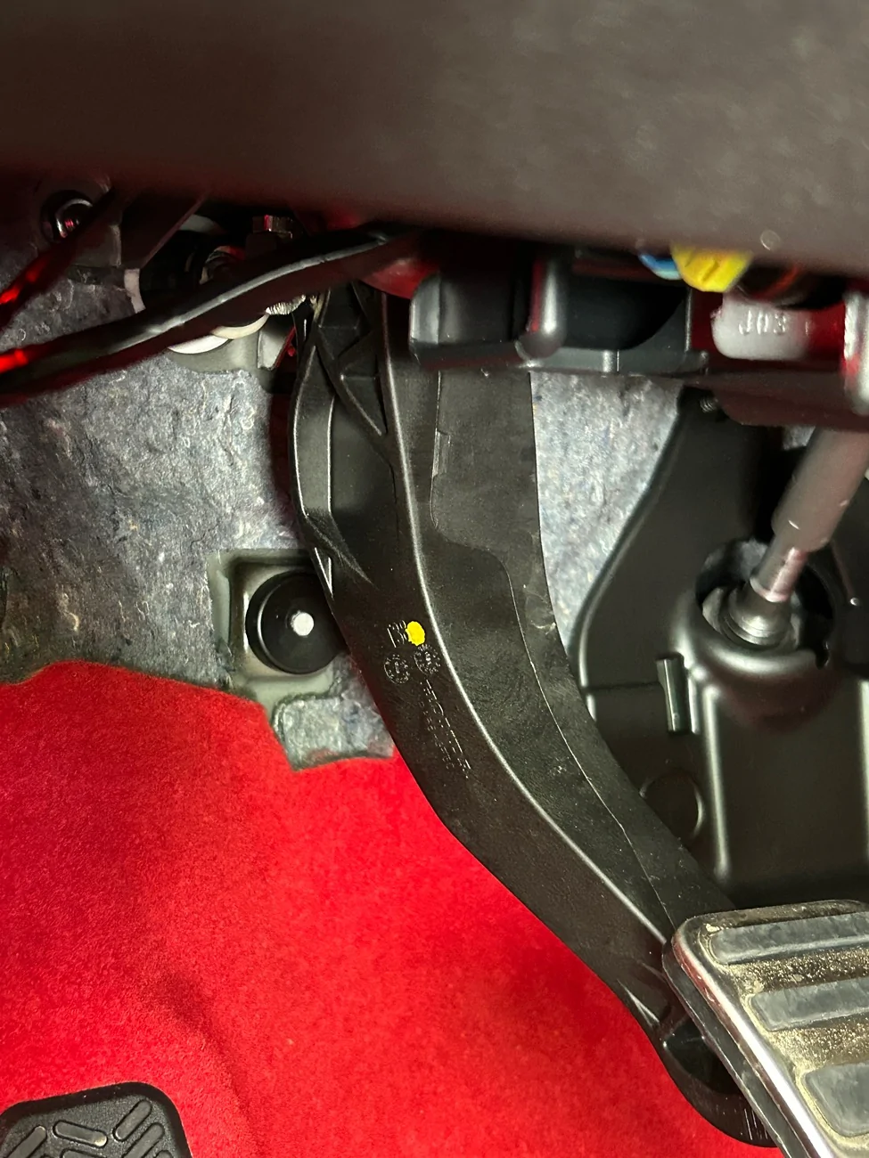

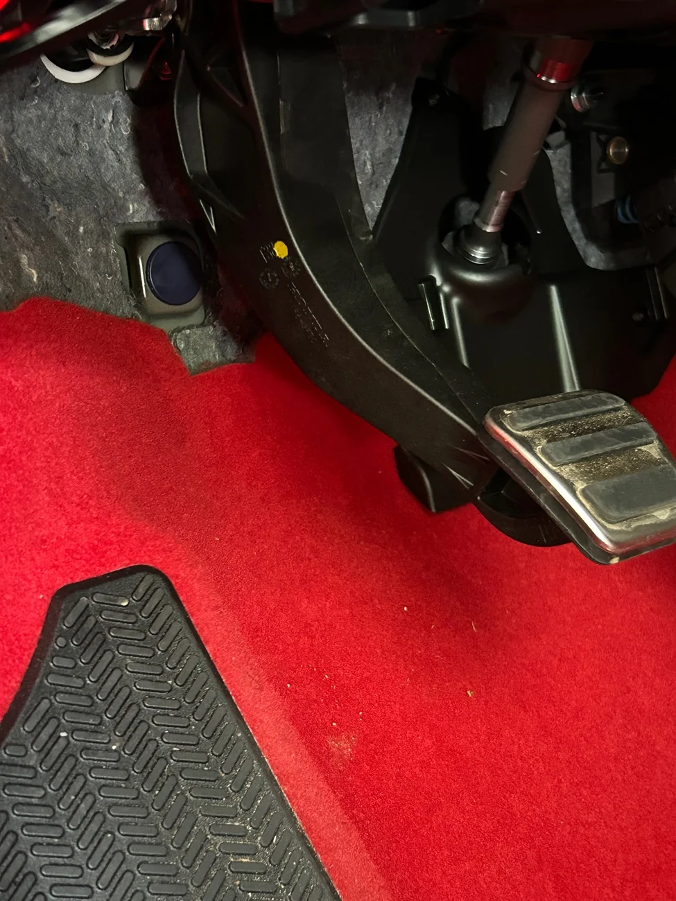

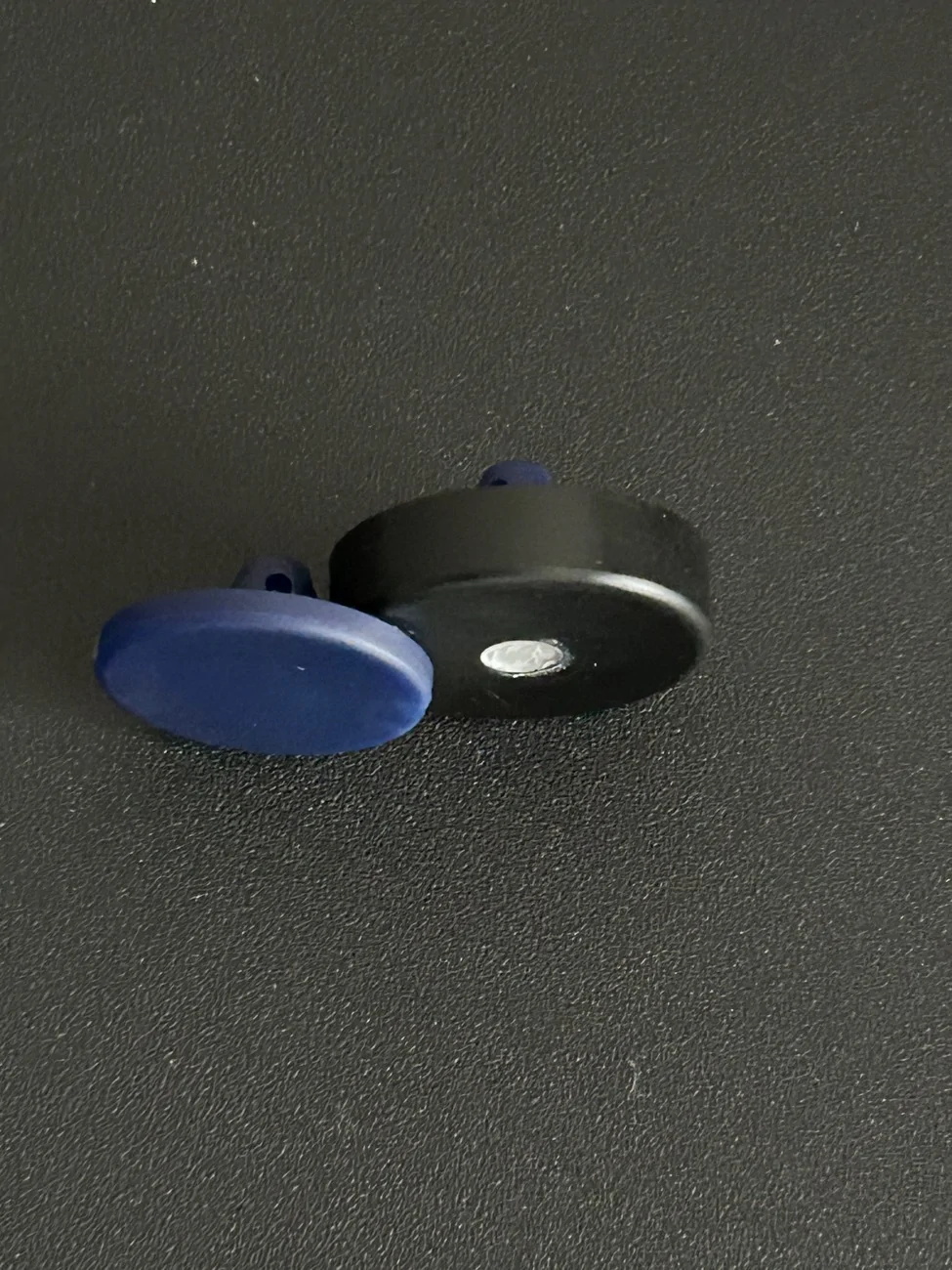

I have the same issue, the perfect distance for throttle and brake is too far back to comfortably push the clutch pedal to the floor for starting. Although the two clutch pedal stop buttons mentioned appear almost identical and JSR is significantly more expensive, I still went with JSR (California) rather than BlackHawk due to greater shipping cost and uncertain tariff fees from ordering directly from Japan. Final JSR charges: $45 for button (+2 freebie Now&Later candies:)), $12.50 shipping, $4.74 tax.
https://www.jsrengines.com/product/jsr-fl5-de5-clutch-pedal-stop-kit
The OEM clutch pedal stop button is 3 mm thick and the JSR is 8 mm. I just installed and this extra width allowed me to move the seat back a notch and the car starts like normal without adjustment to the clutch pedal itself so far!
as received

comparo
11th Gen Honda Civic Pedal Adjustments comparo
before
11th Gen Honda Civic Pedal Adjustments befor
after
11th Gen Honda Civic Pedal Adjustments after
