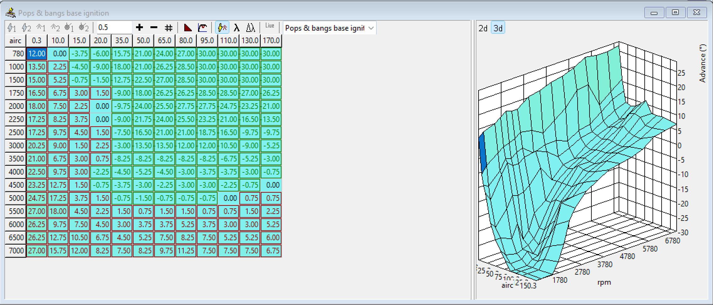

Base Ignition - the burn limit minimum timing by air charge and rpm.
Example: If the base ignition is 5 degrees and the retard is -20 degrees then the timing will be -15 degrees.
11th Gen Honda Civic Pops & Bangs In FL5 Type R & Integra Type S | Hondata FlashPro Manager Latest Feature Screenshot 2024-01-05 164154
