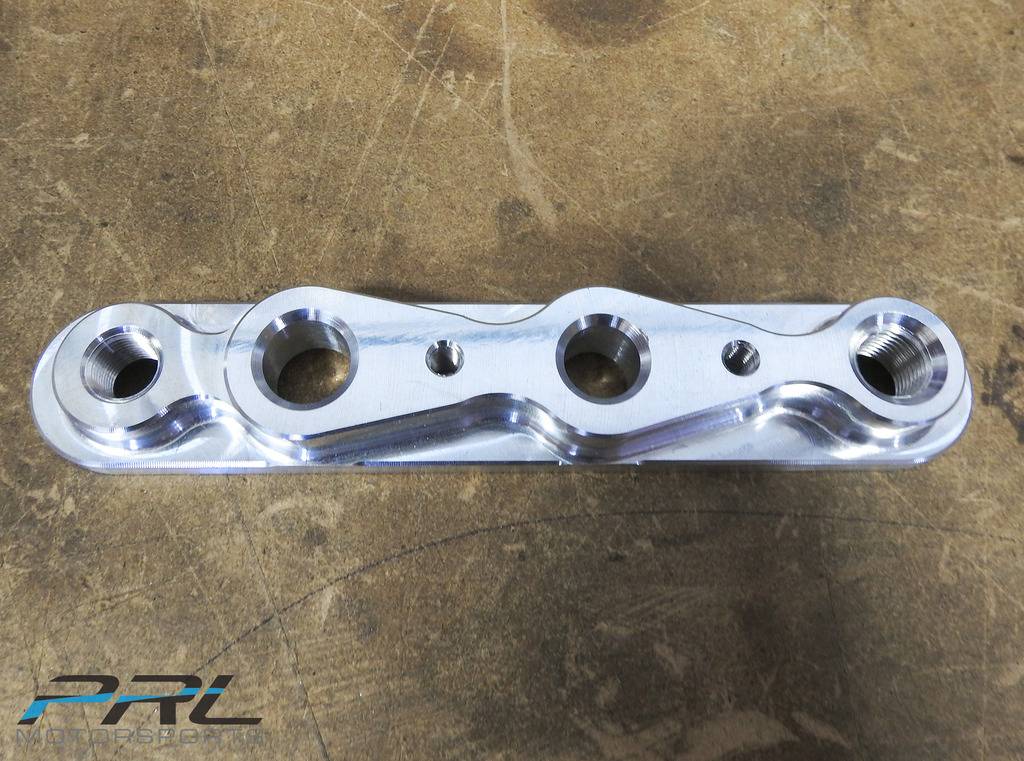

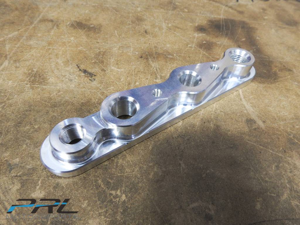

Aluminum bends for charge piping is here awaiting final fitment and welding with our billet aluminum flange/bung. This flange/bung also adds a 1/8" NPT threaded hole for misc uses. Once welded and bead-rolled the piping will head out to receive a textured wrinkle black powdercoat. 4-ply silicone couplers are entering final production and will be fastened with 304 SS Breeze liner clamps.

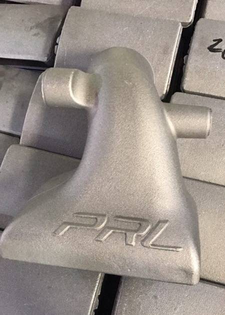

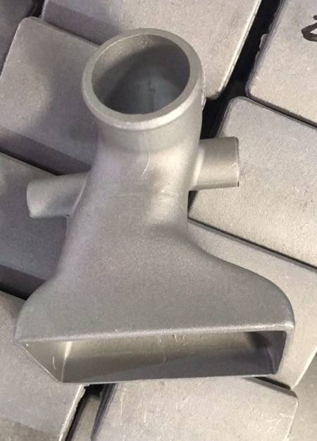

Here's a little sneak peak of our end tanks getting ready to be machined before they get welded!
11th Gen Honda Civic PRL Motorsports 1.5T FMIC Kit Development End%20Tank%201_zps9gcajkz5
11th Gen Honda Civic PRL Motorsports 1.5T FMIC Kit Development End%20Tank%202_zpsmbtca5sn

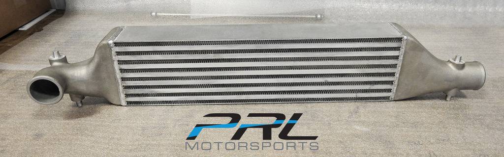

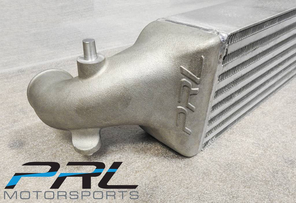

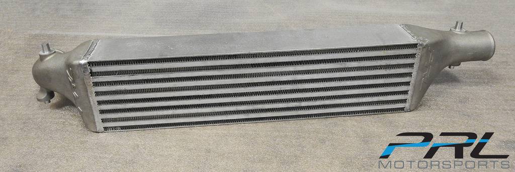

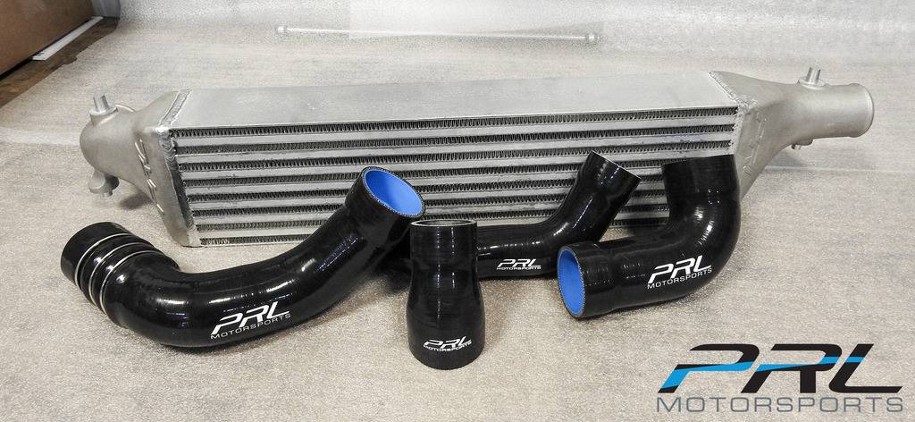

Ask and you shall receive!
11th Gen Honda Civic PRL Motorsports 1.5T FMIC Kit Development FMIC%20Si%20Teaser%20Front_zpsppmloz1
11th Gen Honda Civic PRL Motorsports 1.5T FMIC Kit Development FMIC%20Si%20Teaser%20End%20Tank_zpspabrmhdn
11th Gen Honda Civic PRL Motorsports 1.5T FMIC Kit Development FMIC%20Si%20Teaser%20Rear_zpssmyr9abb
11th Gen Honda Civic PRL Motorsports 1.5T FMIC Kit Development FMIC%20Teaser%20Si%20Silicone_zpszxeivjb
We've got two prototype intercoolers that we have used to check casting quality and fitment for production. The intercooler assembly fitment has passed with flying colors, so final production has begun. :headbang:
...However, we did run into one little speed bump :( One of our mandrel bends for the intercooler piping were slightly off, causing tight (too close for comfort) fitment. This isn't the end of the world, though, as we will have the bends fixed so we can weld and send to powdercoating! :) We will have news for an ETA hopefully next week!

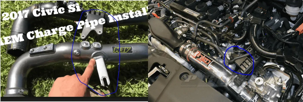

I have a question about the FMIC
I could see in the original charge pipe and also in AEM a piece that generates a union between the intercooler pipe and the engine block; This support has not been seen in the FMIC design.
11th Gen Honda Civic PRL Motorsports 1.5T FMIC Kit Development upload_2017-12-25_22-40-59
This piece is not necessary?
