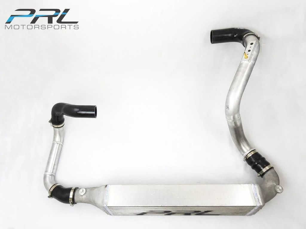

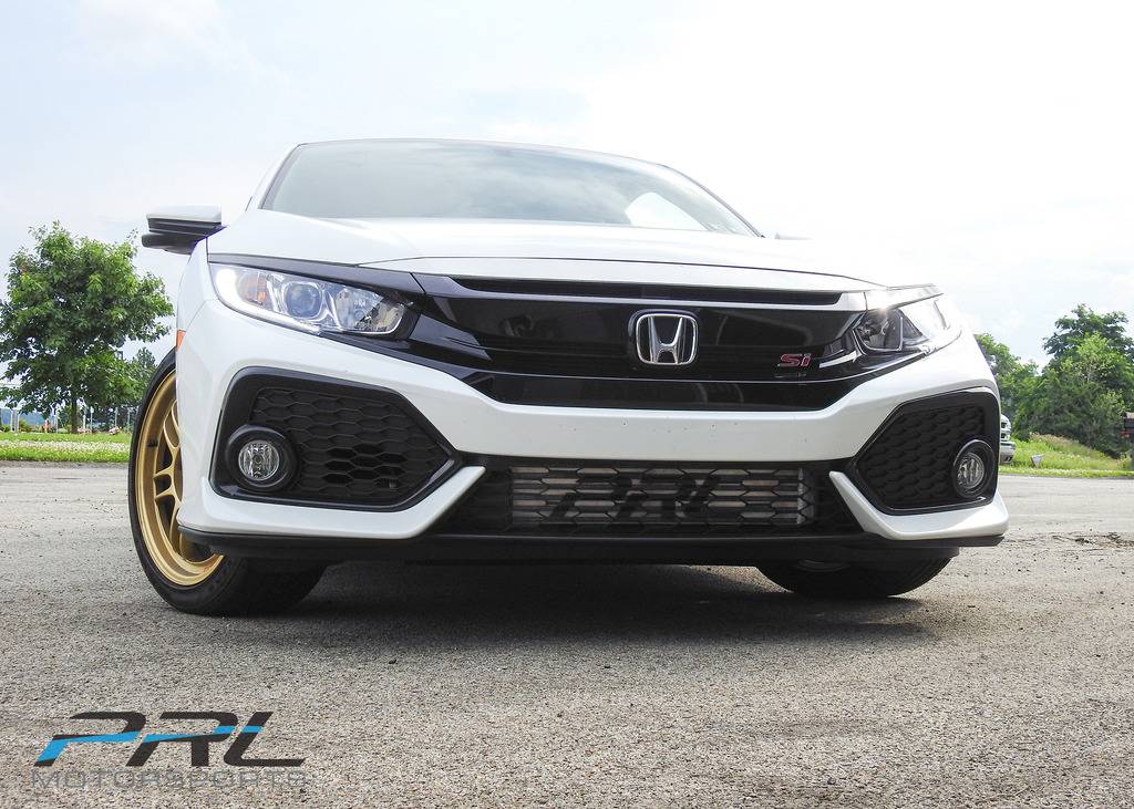

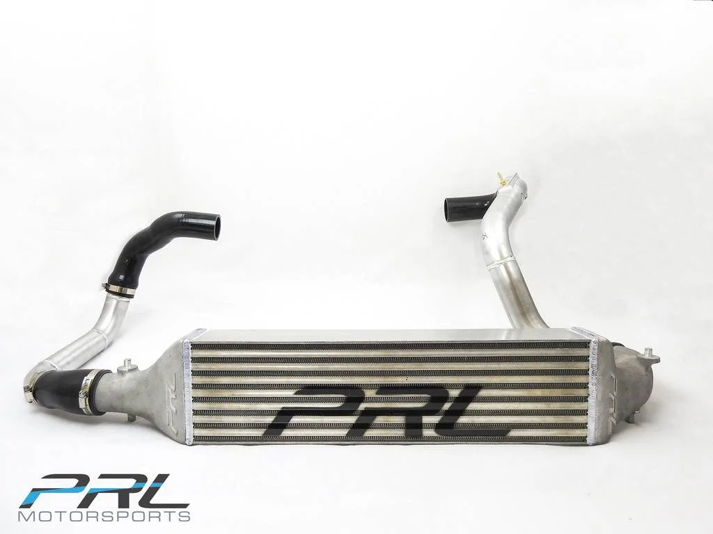

More updates! Our prototype is complete! We will be testing next week! All piping will come standard powdercoated textured black.

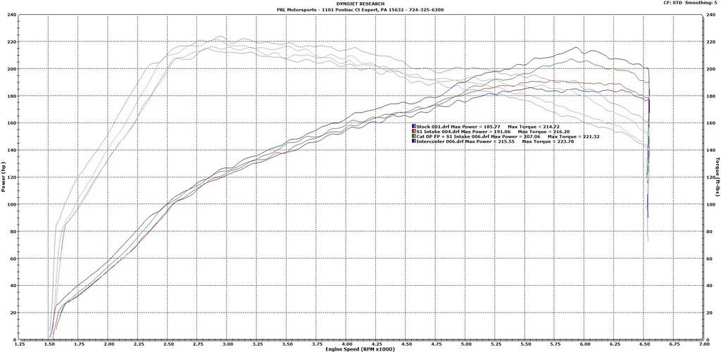

FMIC Friday? Finally we have some dyno testing and data for you guys!
11th Gen Honda Civic PRL Motorsports 1.5T FMIC Kit Development Civic%20X%20PRL%20IC%20Cat%20DP%20FP%20S1_zpstjxj5gn
Here is an overall comparison from what we have gathered thus far with our 2017 Civic Si in terms of gains. We chose the dyno runs to compare because these are all 4th gear pulls with identical coolant temps and knock values (~55%). All of these pulls are untuned and using the factory Honda ECU mapping.
  • 100% Stock Civic Si Baseline: 186 hp & 215 ft/lbs tq
  • 100% Stock Civic Si + Stage 1 Intake: 191 hp & 216 ft/lbs tq
  • 100% Stock Civic Si + Stage 1 Intake + Catted DP/FP Combo: 207 hp & 221 ft/lbs tq
  • 100% Stock Civic Si + Stage 1 Intake + Catted DP/FP Combo + FMIC Kit: 216 hp & 224 ft/lbs tq
In other words we gained 9 hp and 3 ft/lbs tq by simply bolting on our FMIC kit in comparison to the factory intercooler setup.

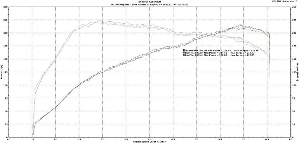

11th Gen Honda Civic PRL Motorsports 1.5T FMIC Kit Development Civic%20X%20PRL%20IC_zpstlk82td
Here are three back-to-back (all runs within 2 minutes of each other) 4th gear pulls of the same car, but with our FMIC kit added. The car responded MUCH better to repeated abuse and testing; heatsoak was drastically reduced.
Run 6:
  • Knock Value 55%
  • Coolant Temp: 181 F Start / 201 F End
  • IAT Pre IC: 96 F Start / 96 F End
  • IAT Post IC: 90 F Start / 99 F End
Run 7:
  • Knock Value 55%
  • Coolant Temp: 196 F Start / 217 F End
  • IAT Pre IC: 100 F Start / 102 F End
  • IAT Post IC: 95 F Start / 104 F End
Run 8:
  • Knock Value 55%
  • Coolant Temp: 199 F Start / 218 F End
  • IAT Pre IC: 105 F Start / 99 F End
  • IAT Post IC: 96 F Start / 106 F End
All dyno testing was performed on the same day. We saw as much as a 50 degree drop or an average of 36 degrees in post intercooler intake air temps on stock ECU mapping by simply swapping out intercooler setups. These results will only be amplified when running more boost via ECU tuning. More boost out of a tiny turbocharger = higher temps. Higher temps = increased chances of knock/detonation, thus limiting power and reliability.
