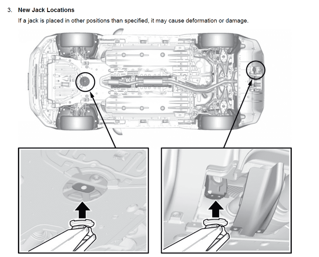

There are six jacking points on the fl5:

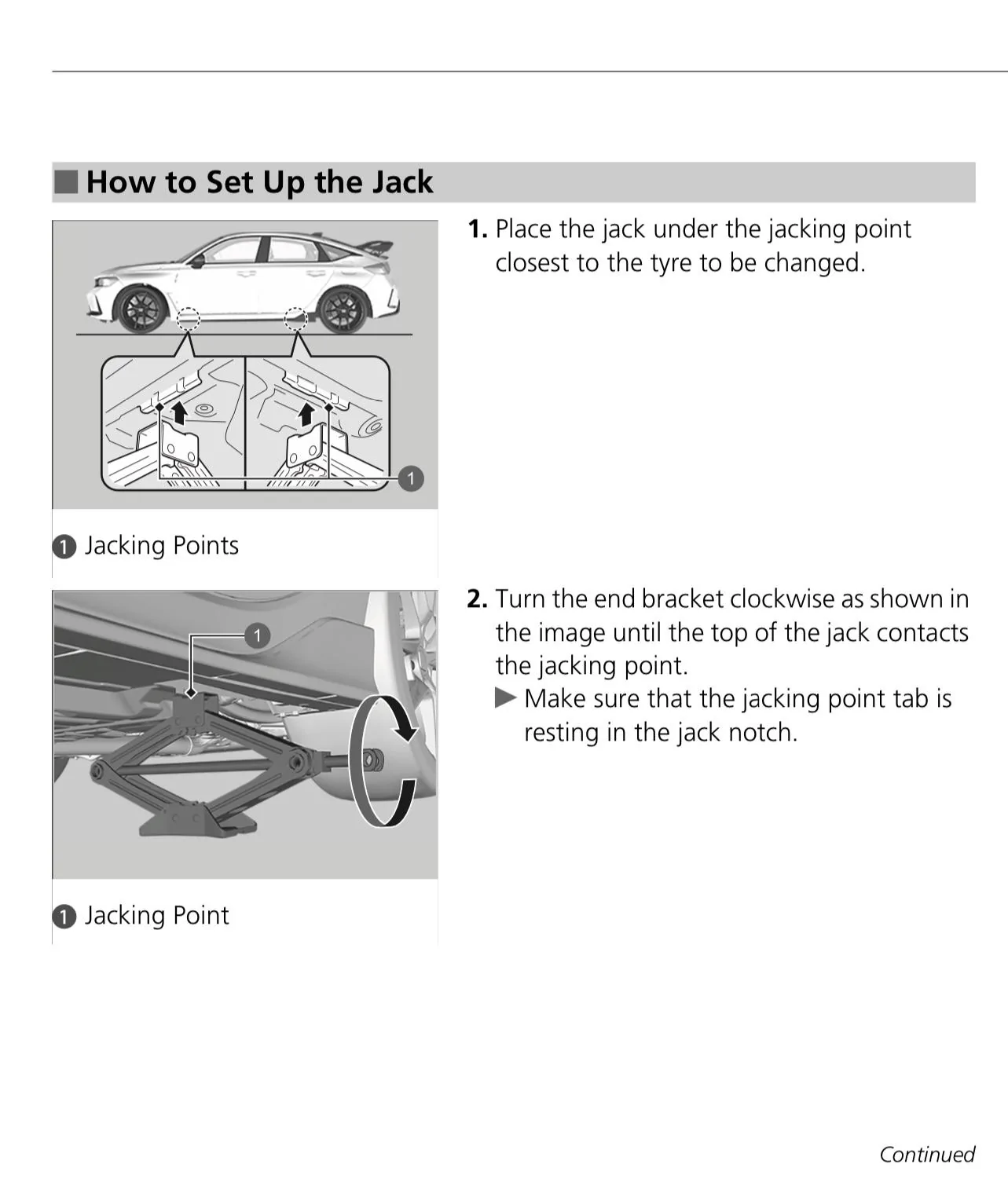

1-4: The reinforced sections of the pinch welds immediately ahead of the rear wheels and immediately behind the fronts (see image below from the owners manual). Those are where the pinch is thicker with an added right angled plate welded on the pinch weld. Do not use the pinch weld at any other point or you will bend it or worse. These points are for your usual flat tire/wheel stuff. Can also be used with jack stands for general maintenance. If you use the front pinch weld jacking point it will also lift the rear wheel - I used this method to rotate the tires recently
11th Gen Honda Civic Question about jacking/lifting FL5 IMG_5945
5,6: front and rear jack points - those are essentially for lifting both front wheels or both back wheels (then dropping the car on jack stands at the pinch weld lift points):
11th Gen Honda Civic Question about jacking/lifting FL5 IMG_5462
The rear point is accessible by removing a small plastic section of the diffuser. It’s easy - it’s held on with 2 or 3 clips (better to use a plastic trim tool).
The front one is very deep - you need a very long reach low profile jack ($$$) or use the two jacks method:
I use that to lift the car on jack stands when I’m doing an oil change or brake work: lift the car a bit from one of the front pitch weld jack points, so you can reach with a second jack to the middle front point and lift the whole car, then drop it onto 2 jack stands at the pinch weld points.

Where did u get the image of the pinch weld locations that uses the Type R specific car graphic? That looks different from the manual I downloaded from Honda.

There you go, 6 safe spots. You can use those jacking points confidently to lift the car and not worry.
Given the poster's location, and the spelling of "tyre", I'm going to say it's a non-US version of the manual.
