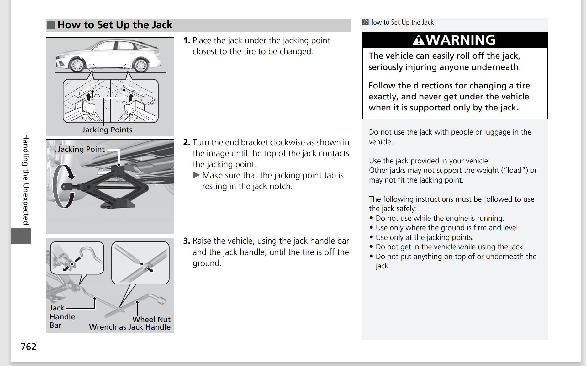

I have to ask, though, where are you seeing that Honda doesn't recommend using a jack on the pinch welds? I checked in the owners manual (PDF version) and it seems to show the use of a jack on the pinch weld for tire changes. (Granted, this seems to be a universal manual for all 2023 Civics so I guess the Type R might be different?)

The pinch welds are a perfectly acceptable place to jack up the car. As stated above in the owner manual.
Our owner’s manuals leave a lot to be desired. They don’t even list the break-in procedure, while EU manuals do. I wouldn’t trust what’s shown here for use with the FL5, but that’s just me. It’s in a section called “Handling the Unexpected” and is citing the use of specific tools (including the spare) that come with other Civics. To me, this means this section of the manual doesn’t apply to the FL5, but I am not an expert.

No issue with using the pinch welds to jack up the car. Since the pinch welds are present on lesser Civics and can be used to lift the car, it stands to reason you can do the same on the FL5. The spare tire kit is optional for the FL5 - how else would you use the scissor jack to swap out the wheel? That would be a senseless design flaw otherwise. Plus, you're only lifting up a percentage of the car's total weight. To me, that diagram in that other link is just ignoring the obvious, since many cars have jack points inboard of the wheels. The two points that are explicitly shown may differ among cars in their locations, hence the indication.
If the manual doesn't distinguish models, it is for all models in the book.
