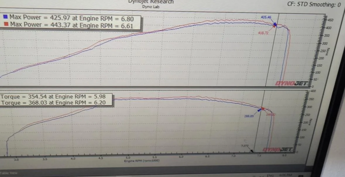

To OP, I have 443 whp on 93 octane fuel. Use it as DD and also have tracked it a total of eight 20min heats and drove it like it ain’t mine. Car is great. Pulls insane from from 5-7.5k rpm, lost a little bit of low end torque.
I have PRL I/C and P700 turbo, Hondata with tuning by RedStarMotoring, Catless DP and FP by Innovatig, drop in K&N filter.
I’m having PRL inlet and AWE exhaust installed next week which should squeeze maybe 15-20whp at best.
Pending would be HVI and that would be full bolt on. You can go higher with methanol kits, etc.

Thanks for sharing! Great data point for this thread and OP's inquiry. What was the stock baseline? What is target boost set at and at what RPM are you seeing it on the street (3rd/4th gear)? Are you revving to 7,500 RPM on stock valvetrain?

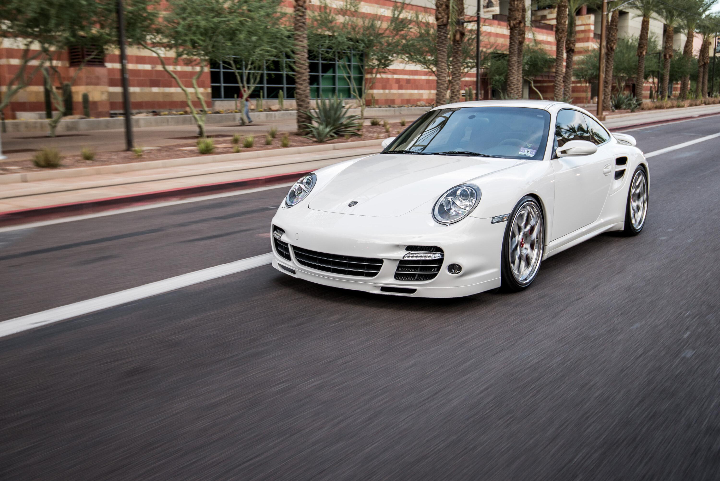

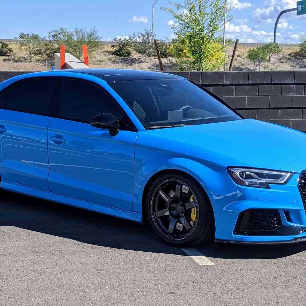

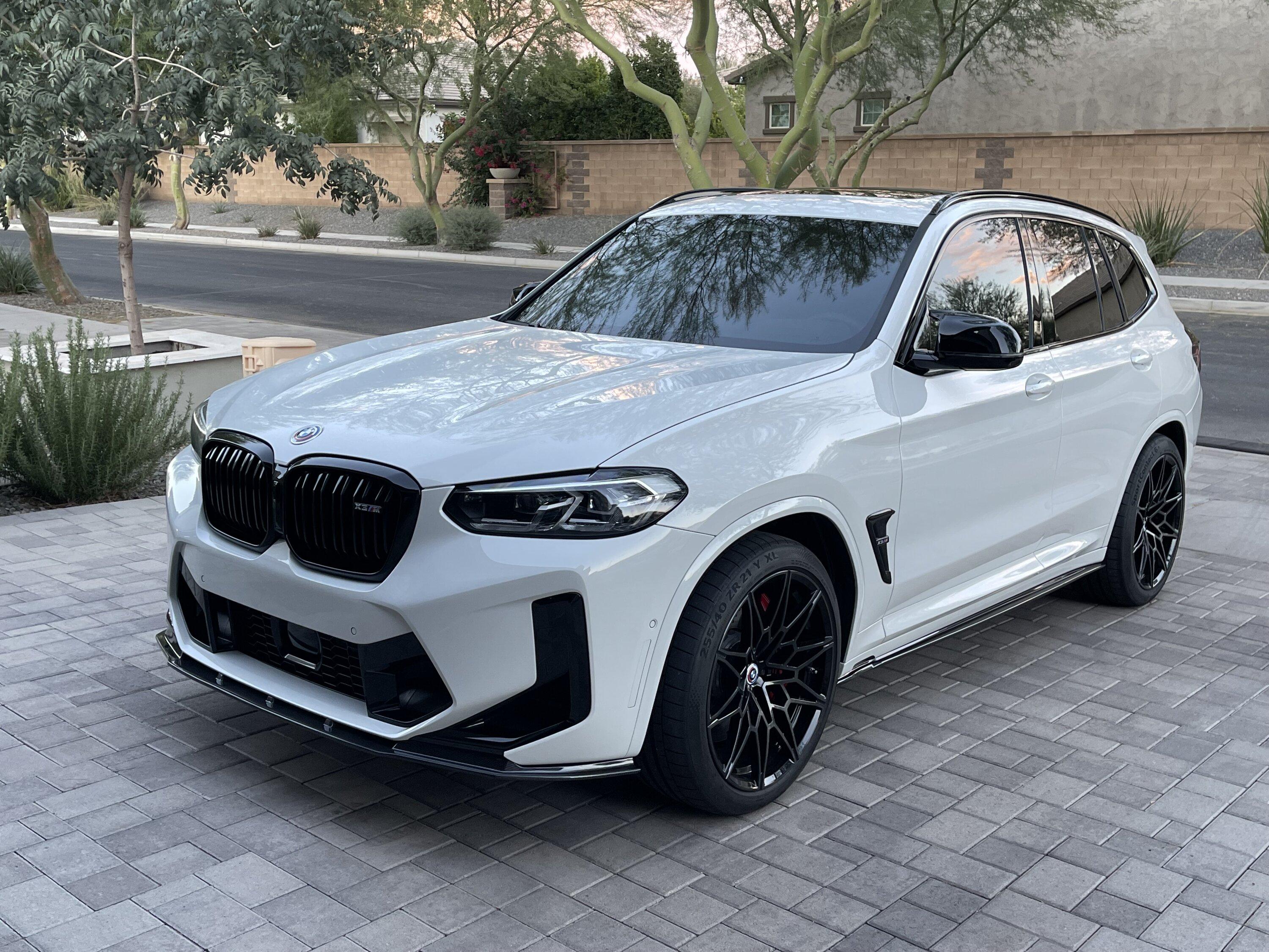

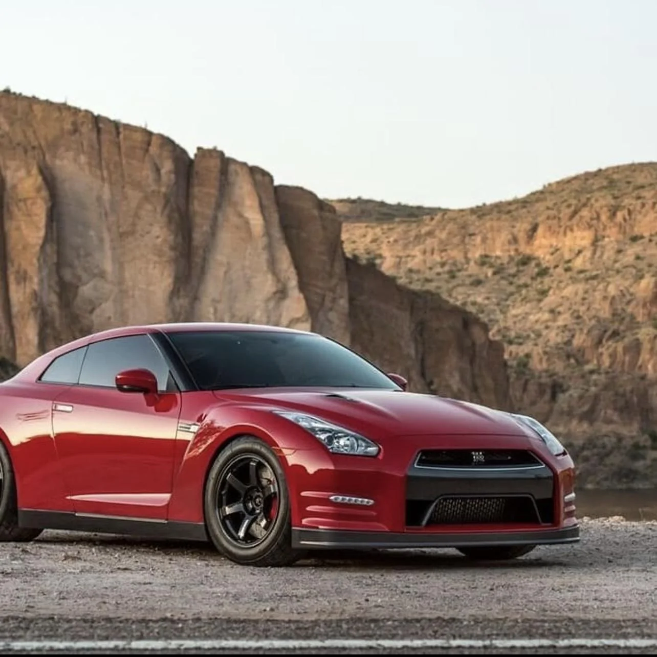

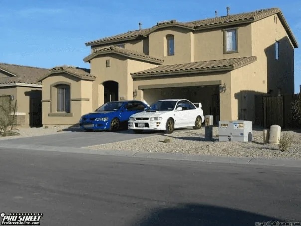

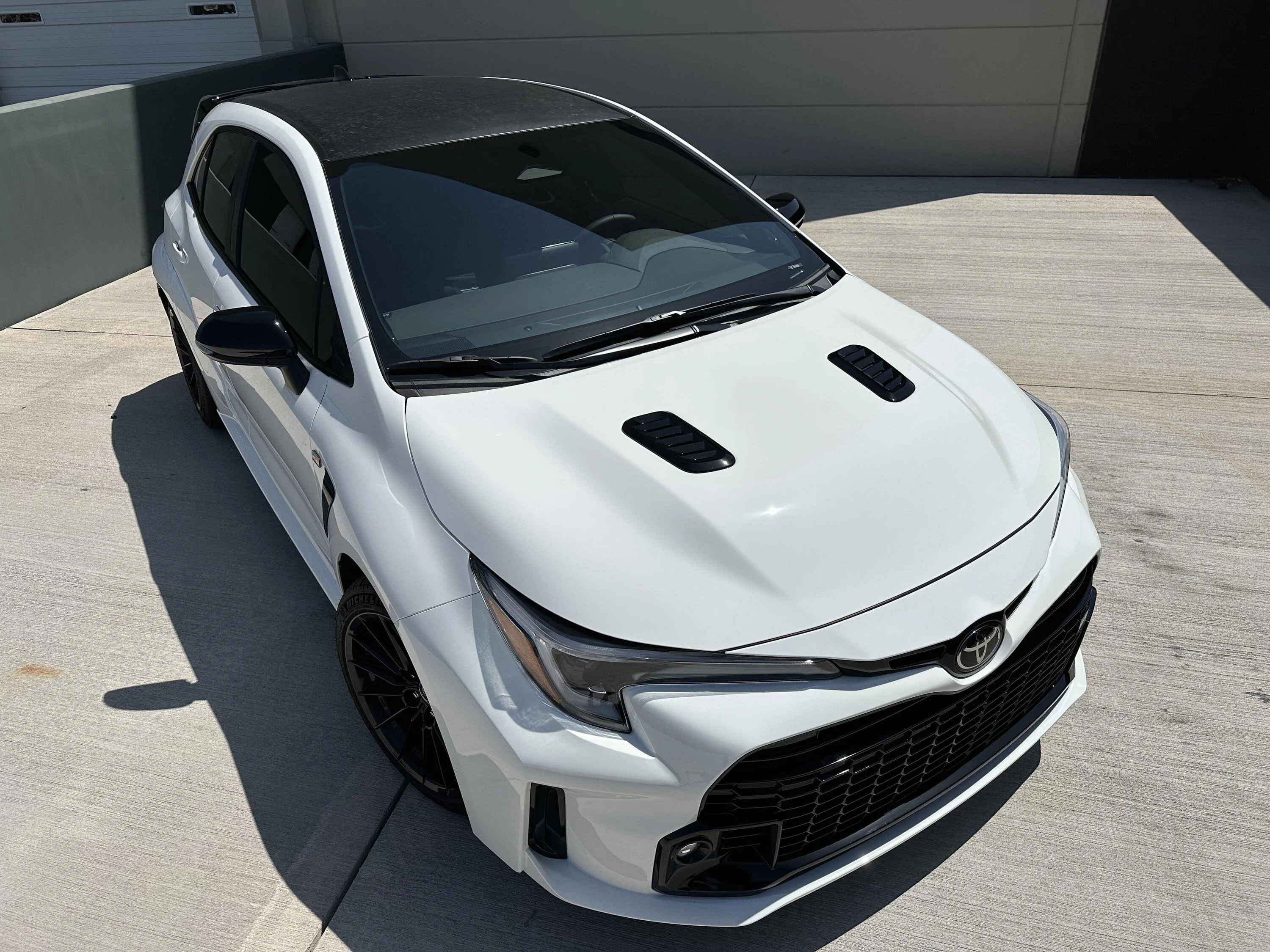

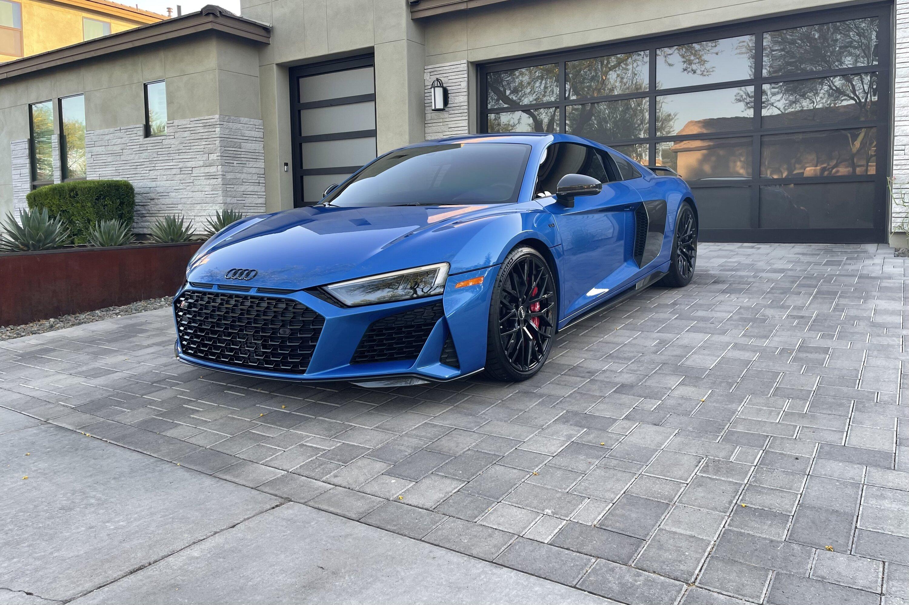

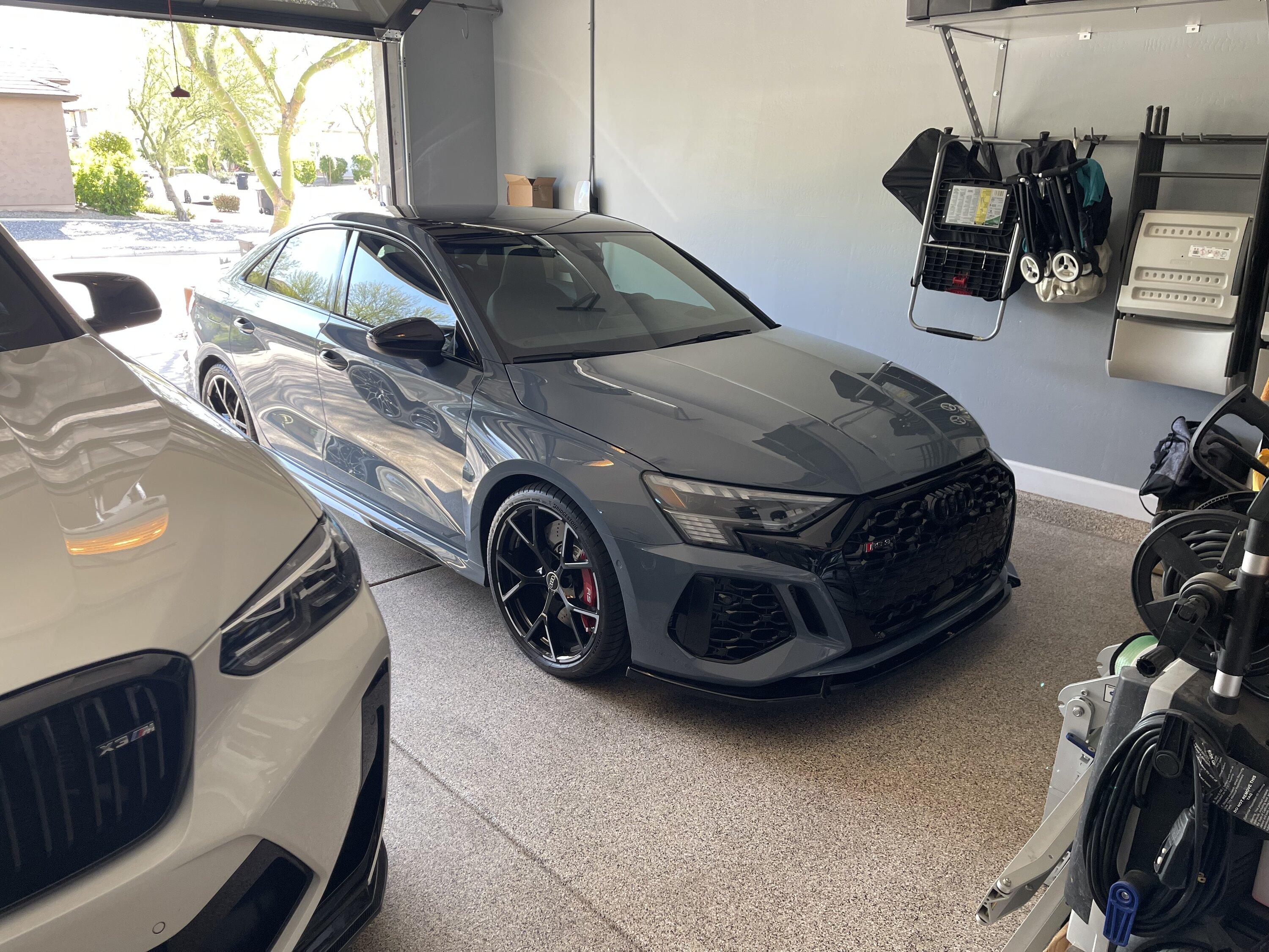

Lol. I love to rehash the old days.
I’ve owned over 100 cars at this point. I love all cars. Trying to own everything lol Some recent ones and an oldie.
No baseline dyno, I do have however dyno run with tune and everything previously stated EXCEPT with stock turbo instead of P700 and that was 373 hp @ 5.7k RPM on 93oct.
Regarding the technicalities of the tune, I unfortunately do not know them, it was all handled by Pepo at RedStar Motoring. I could ask him though.
I think I've seen out of the corner of my eye like 30 psi of boost. I'm doing a track day on October and will have the LogR fully enabled so will see more data by then.
Stock valvetrain and stock fuel system. There is some concern regarding valve float in the >7k RPM range but both my tuner (Pepo from Red Star Motoring) and mechanic (Jaime from DreamWorks Performance) whom have tons of experience with K20C1s (Type R culture and scene is very strong here in PR) were pretty confident that it's a non-issue and I trust them. Knock on wood.

Stock valvetrain will handle the rpms no problem. My main concern would be the high pressure fuel pump. When I do mine I will rev it to 7200rpms with a upgraded HPFP.

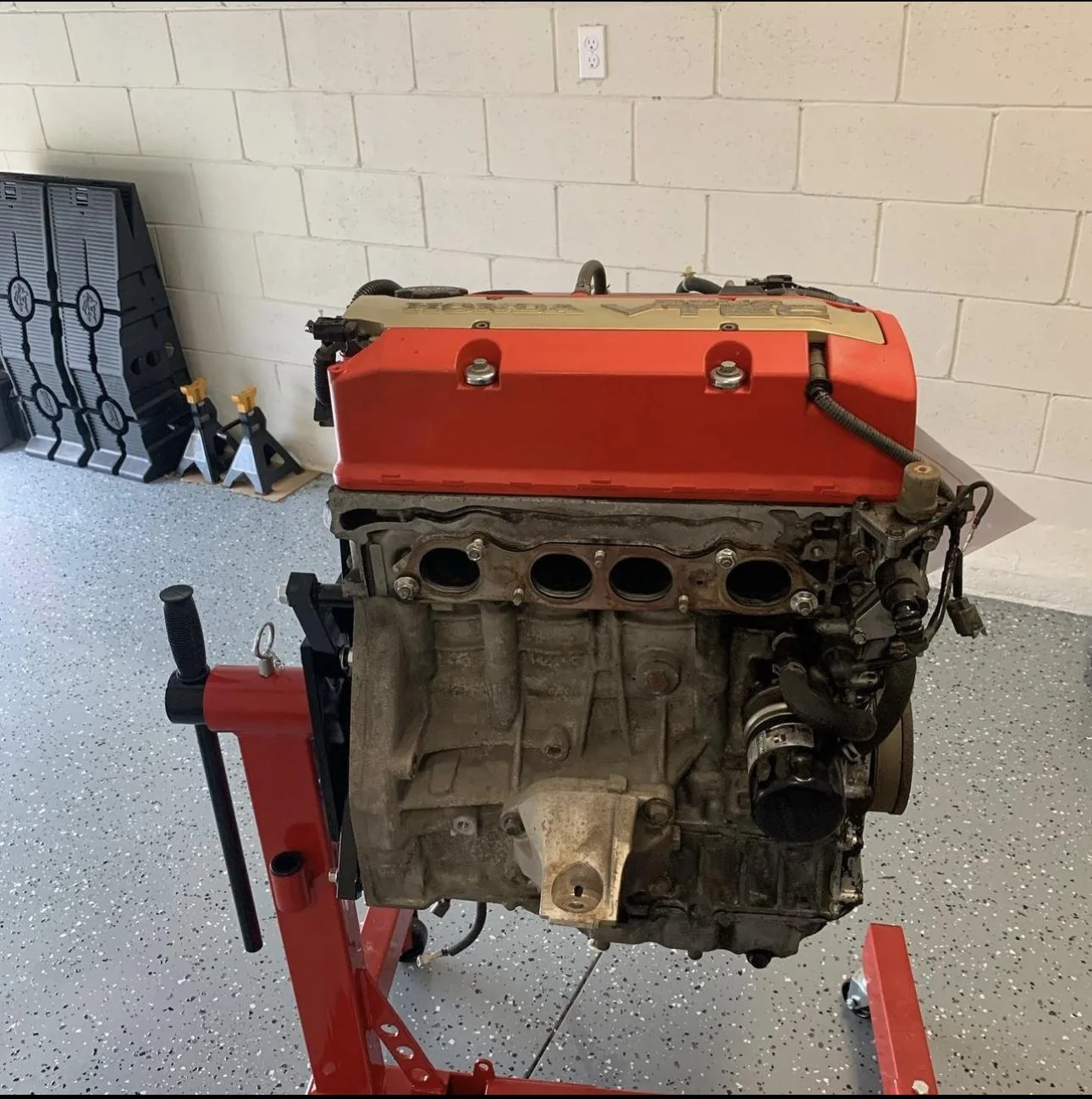

Cool dude! Reason I ask is that I was suspecting that when I saw the price lol. I will be sending my spare s2000 engine to them to build.

Haven’t gotten a quote for the shipping yet since I’m finishing other projects first. But the spare engine is already out and basically ready to go. But it should be a couple hundred dollars to ship it. I’m in Florida.

Thats not bad actually! I just want a mid level build but don’t have the skills To pull mine and don’t know any shops that Id trust to do it locally although I think there is a good shop in Wiscy. Ive heard that once its pulled the car is never really the same too. In your experience how much is it to pull one and put it back in?
