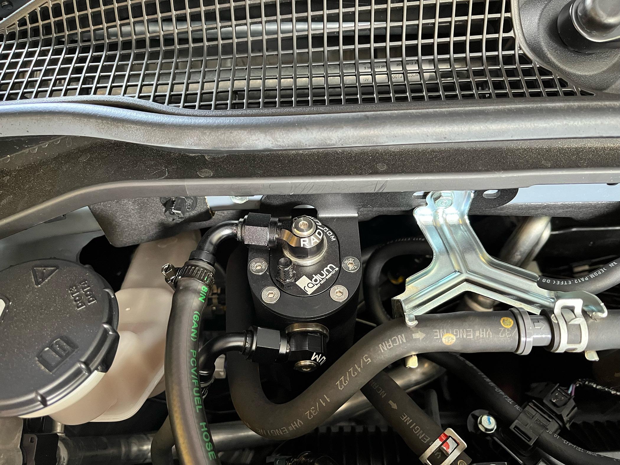

i installed a PCV Radium catch can shortly after purchasing my car. i periodically check the dip stick and there's definitely a small amount of oil in there.
