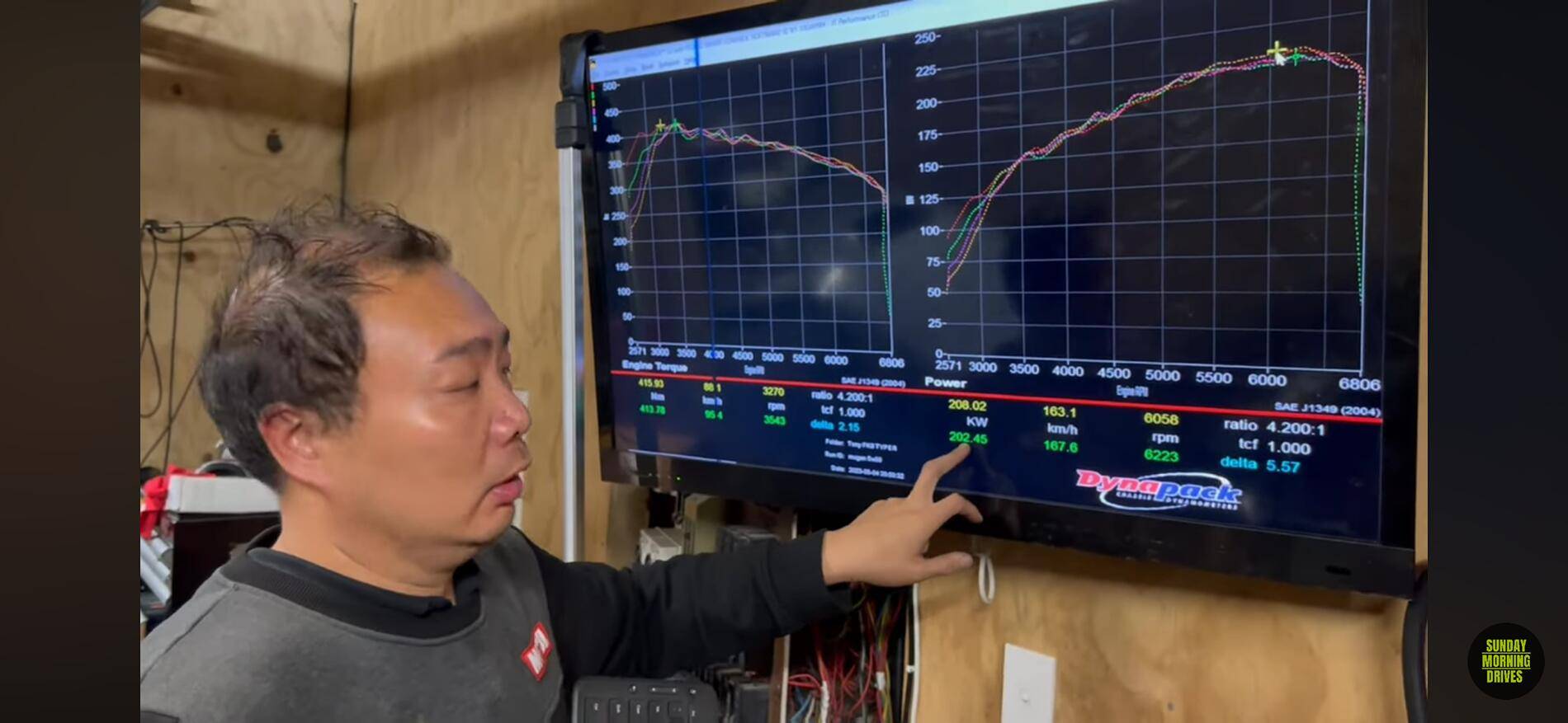

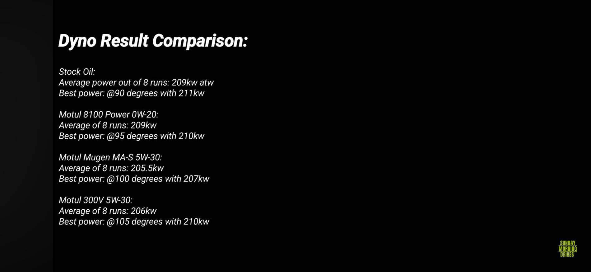

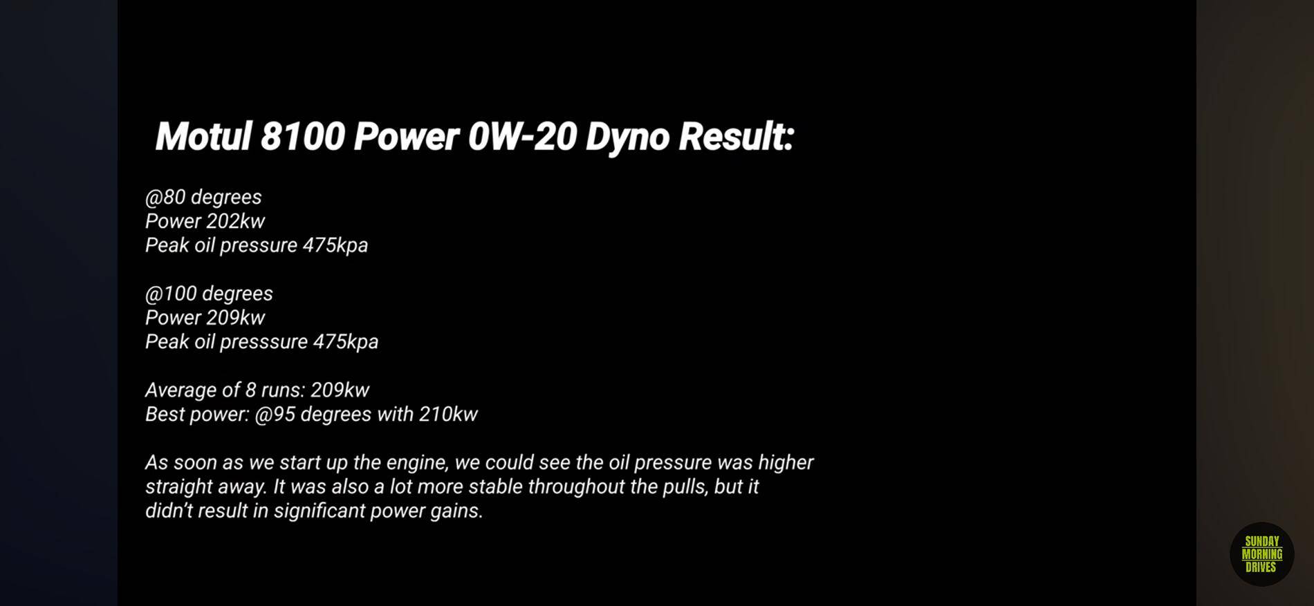

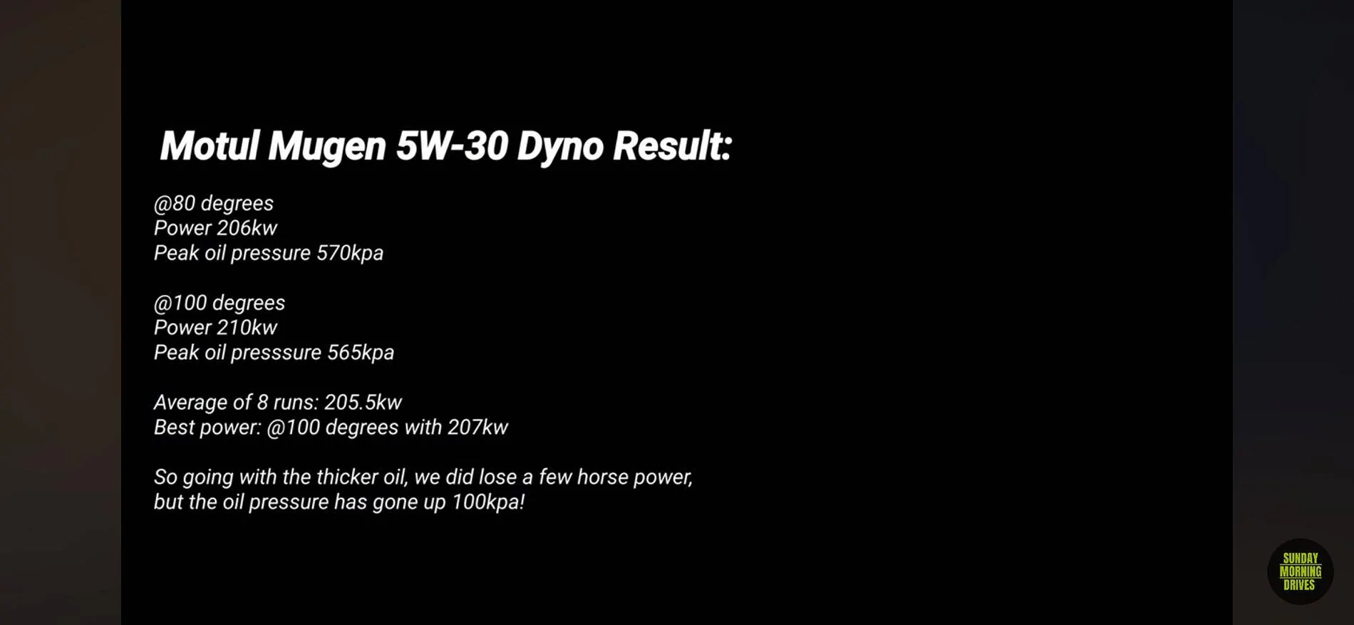

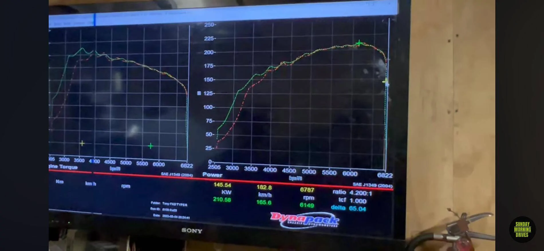

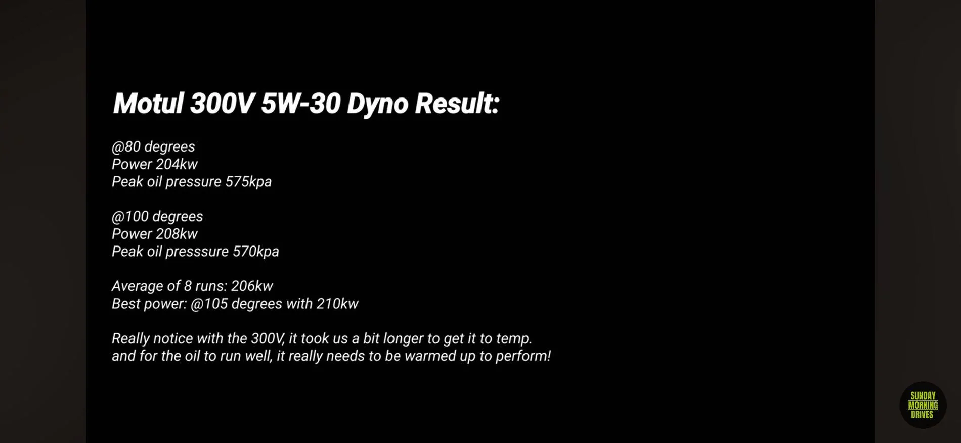

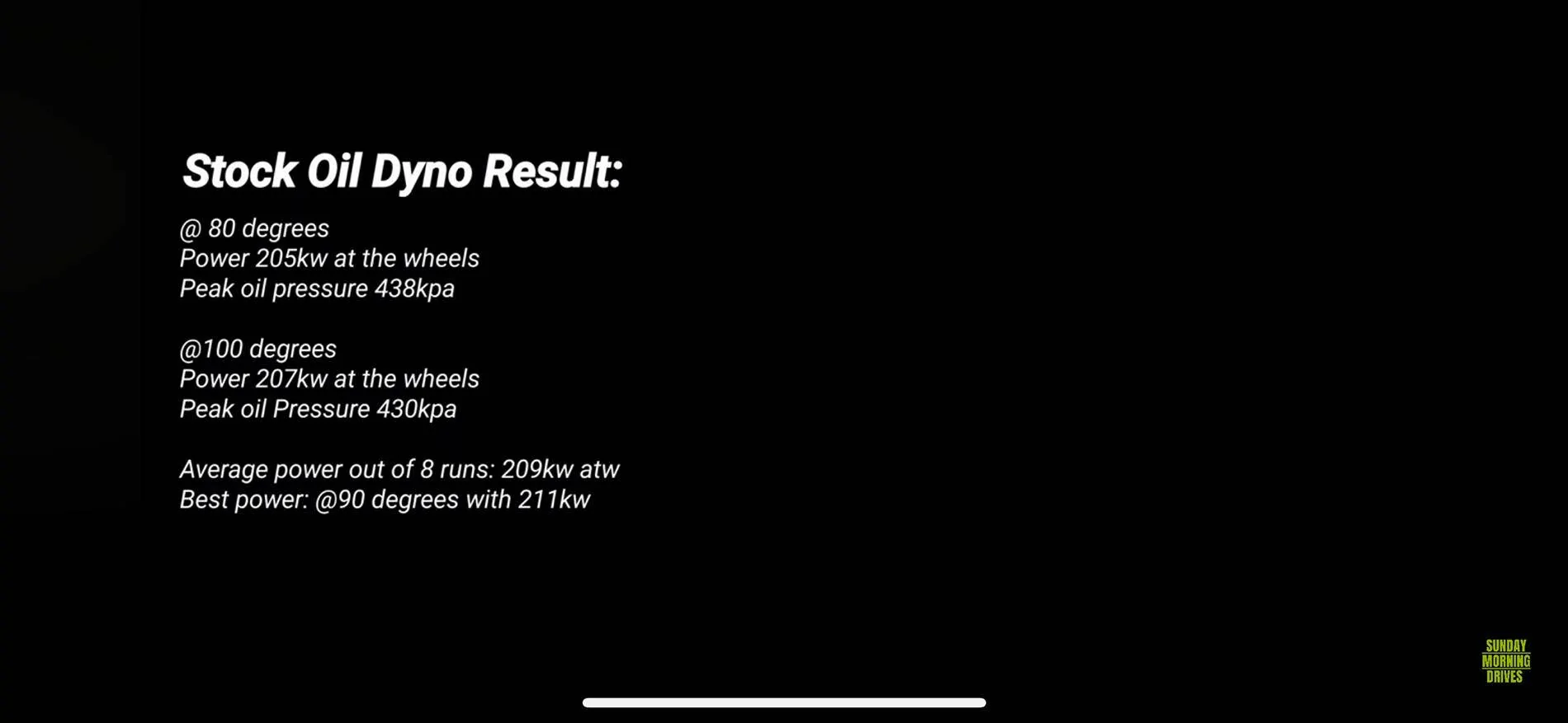

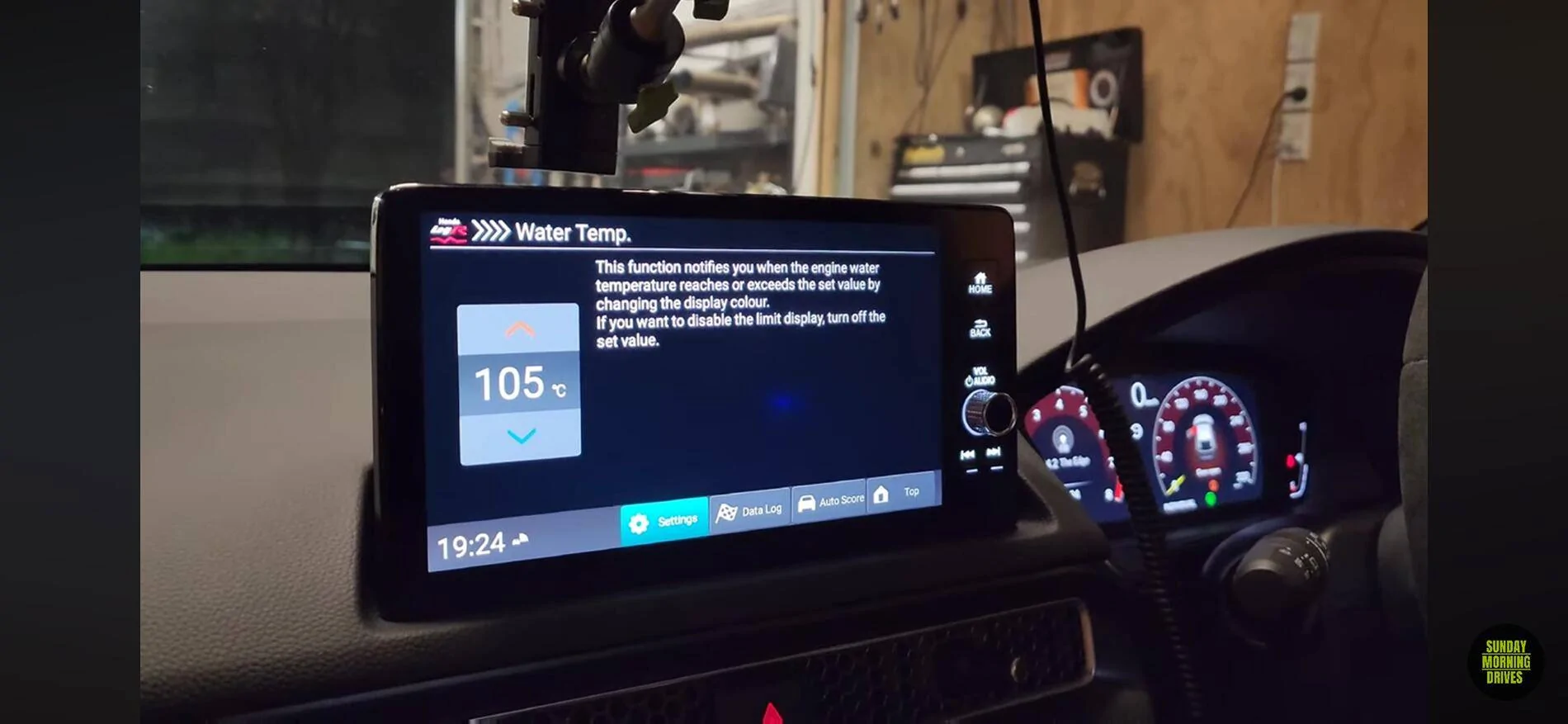

Found this very interesting test on Motor Oil for the FL5.. and didn't know you can set temp warning limits, which is great.
They tested the Honda OEM oil 0-20 vs 0-20 Motul Fully Synthetic ( which is the second highest quality oil Motul makes according to him) and the Motul 0-20 had more friction according to him.
The Mugen 5-30 was better. Very interesting results.
See below.
How much worse/or better is it that most all these oils were much higher in oil pressure, including the Motul 0-20?

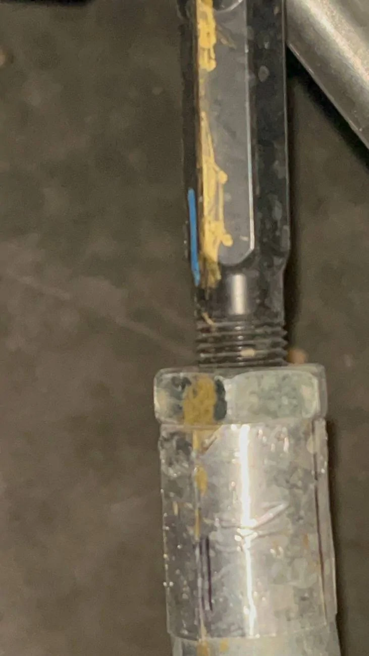

I can confirm that a half turn on each tire rod, to give the car toe out helped out a lot!
This is probably the best OEM Stock modification in combination with removing the pins for a touch more negative camber.
Will find out tomorrow on Laguna Seca

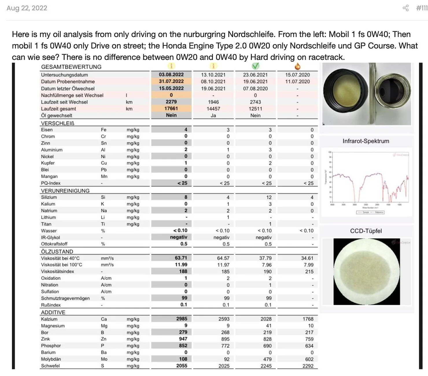

Also it's still debatable what engine oil is best:
Some have tested all kinds of oils and the Type 2.0 0W20 Honda oil OEM oil didn't have any issues on heavy track use. Some are saying the 0-20 stays cooler, circulating faster through the engine.
Would be great to get some conclusive scientific data on this.

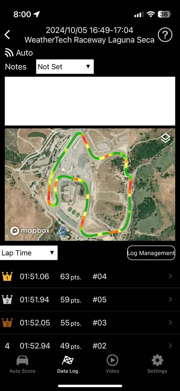

Here is what we learned about the Stock FL5 Type R on Laguna Seca on 4s's:
1) Remove the Pins and Adjust toe out!
The car was 8+ seconds faster 1.51 ( pins out & toe out ) vs a 1.59 ( factory ).
On average it was ~5 seconds faster. It was a clear difference. It just turned in much easier.

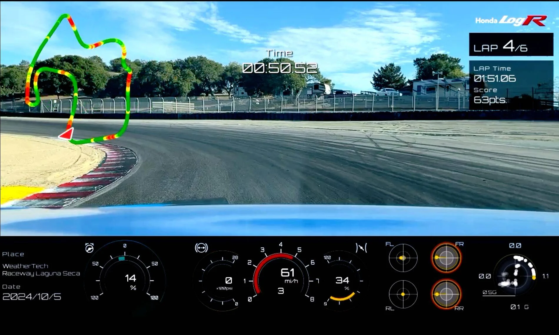

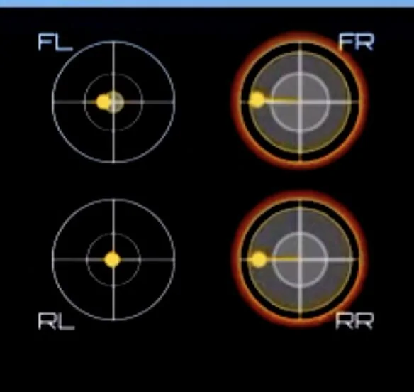

ps... anyone know what this means, when both circles are bright red - is that the torque vectoring kicking in at max?
11th Gen Honda Civic Racing the FL5 Type R with all OEM spec parts on Laguna Seca Screenshot 2024-10-06 at 6.49.34 PM
Here is the lap footage - I had really one session that was traffic free at the end of the day, which helped me get the 1.51

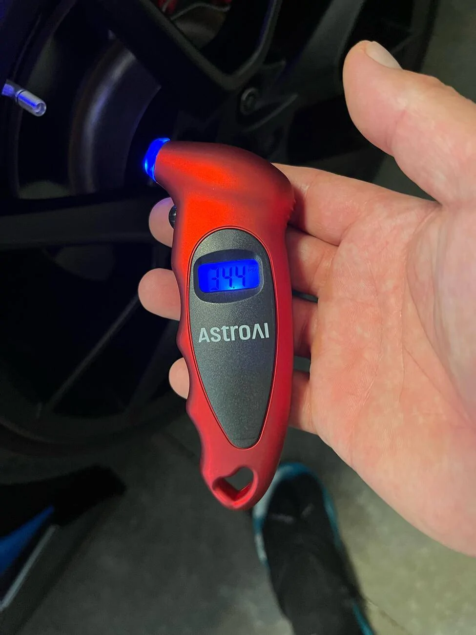

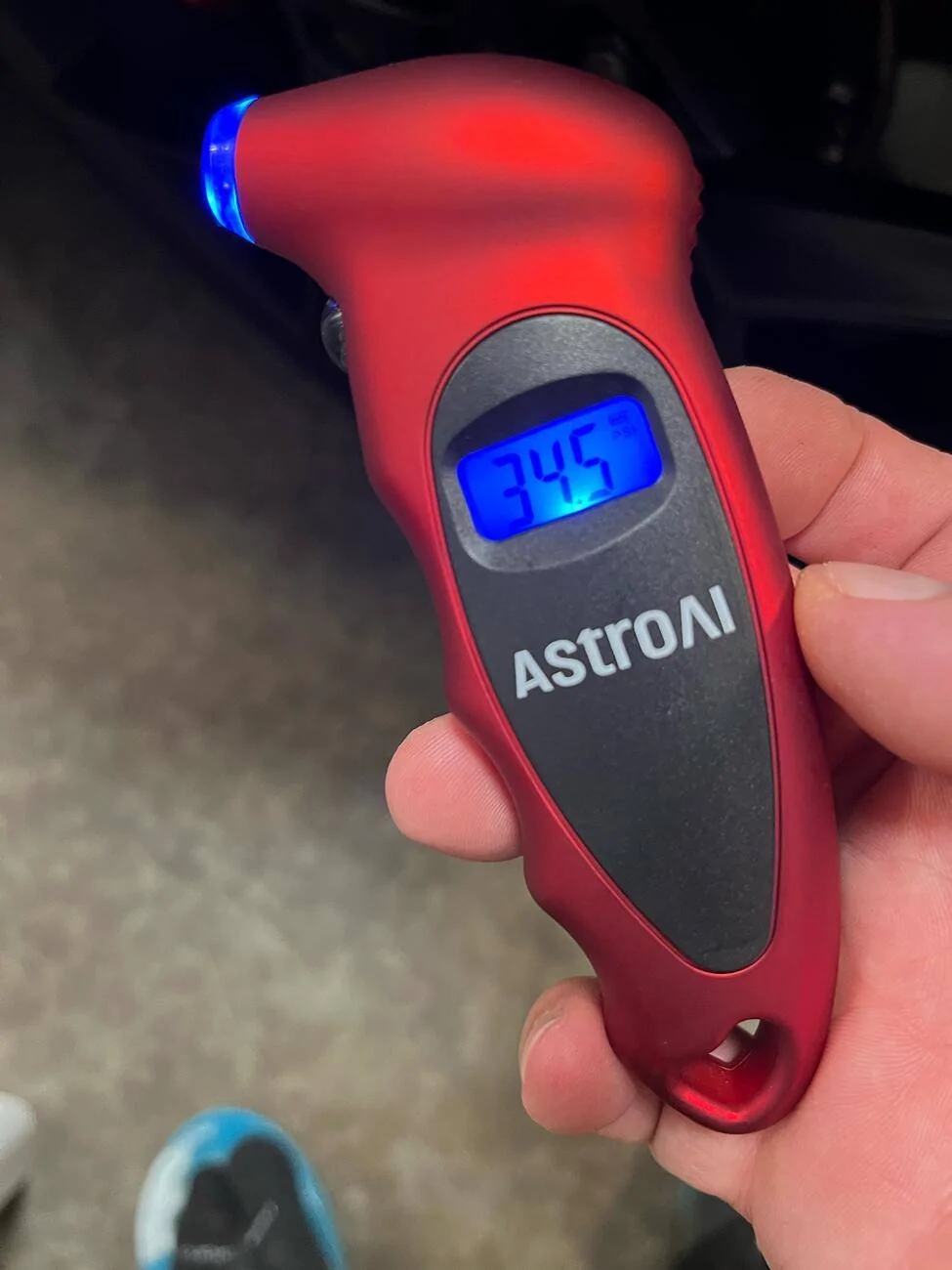

2) Tire pressures - Spoke to many instructors and there was a tire specialist on track, and he recommended I actually move up in PSI for the 4s.
So I moved up to 45 it was too high, and down to - 42 PSI hot tire pressure fronting 40 rear, which seamed to perform best. Easily got the 1.51 1.52 . You don't want to deform the tire wall on a soft side wall tire.
Checked after 24 hours, that's translated to 34.5 PSI cold front and 34.4PSI cold rear. Front tires seem to get about 2psi hotter than rears on the track.

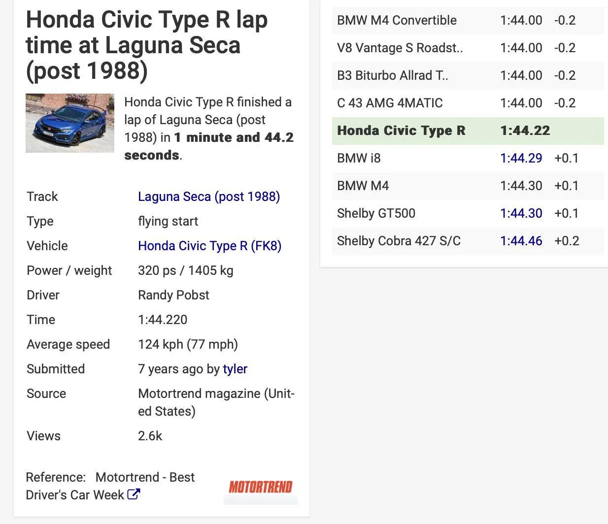

1) Does anyone know what the Laguna Seca Lap record for a Stock FL5 Type R on OEM 4s's
I think I heard, with the OEM 4s 1.47 for Laguna Seca? ( I'm 4 seconds away ? )
And Randy Pro Driver on the Fk8 with Cup 2's did a 1.44?

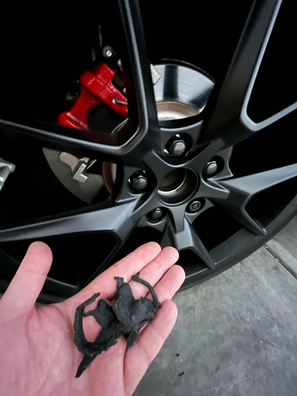

2) Does anyone know what this is?
It was melted onto the inner rear wheel mostly, some glued to the wheel weights. Felt my tires were out of balance, but it was this + all the extra rubber I picked up on track.
Is that the brake pads that melted do to hard brake vectoring on Laguna Seca?

The clumps of rubber are called "marbles" and they're the eraser crumb-like rolls of rubber that are shed from the tires of all the cars at the track. All that worn out tread has to go somewhere. You should walk a track after an F1 race. Marbles everywhere.

Switching subjects, I do have a question about how the LogR overlay works. I noticed in your footage that the lap timer that's centered on the screen seems to reset to around 5 seconds rather than zero when you start the next lap. Do you know why that happens?

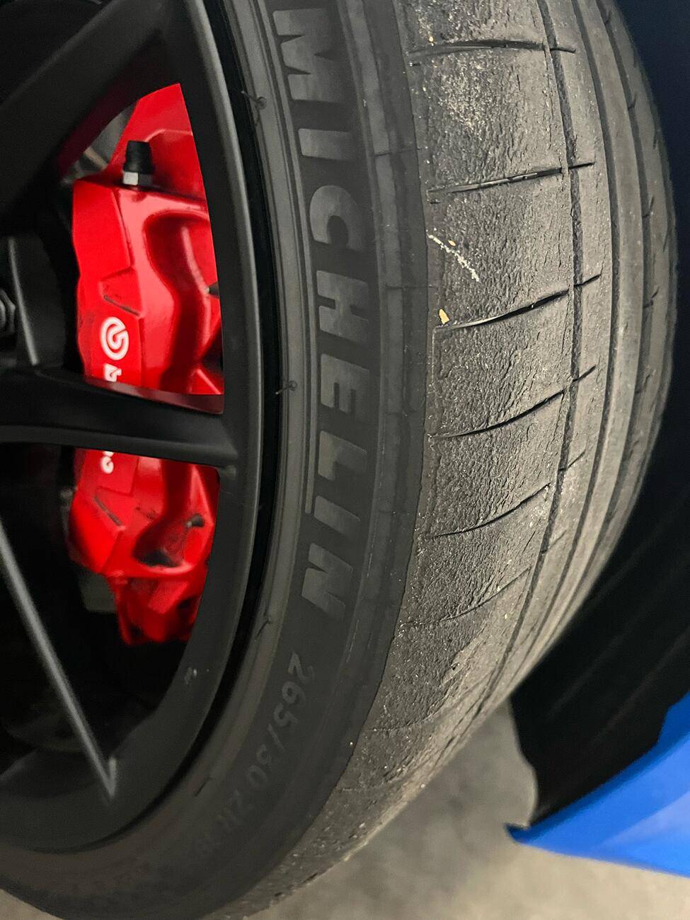

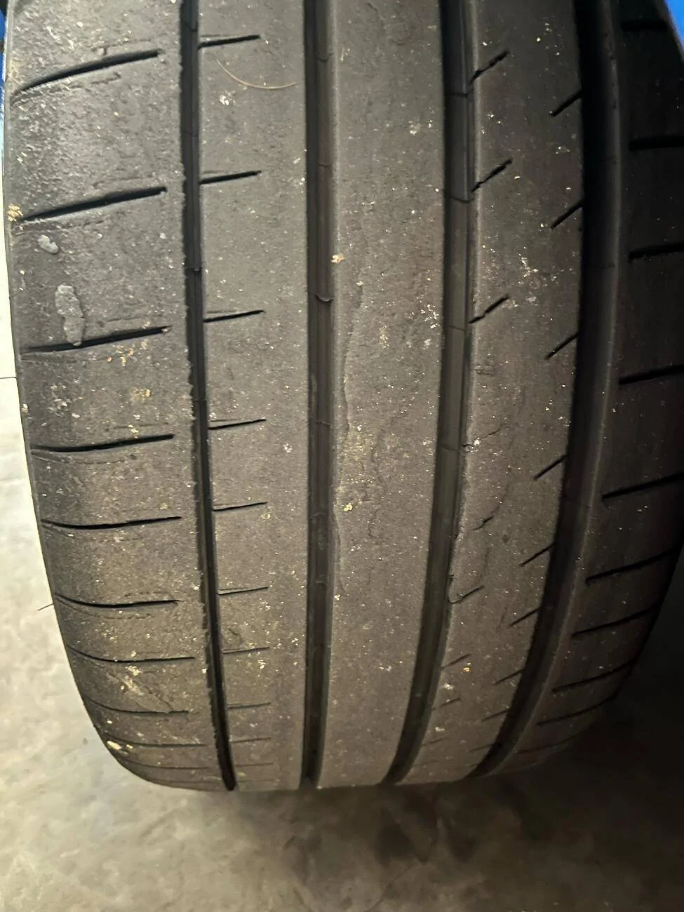

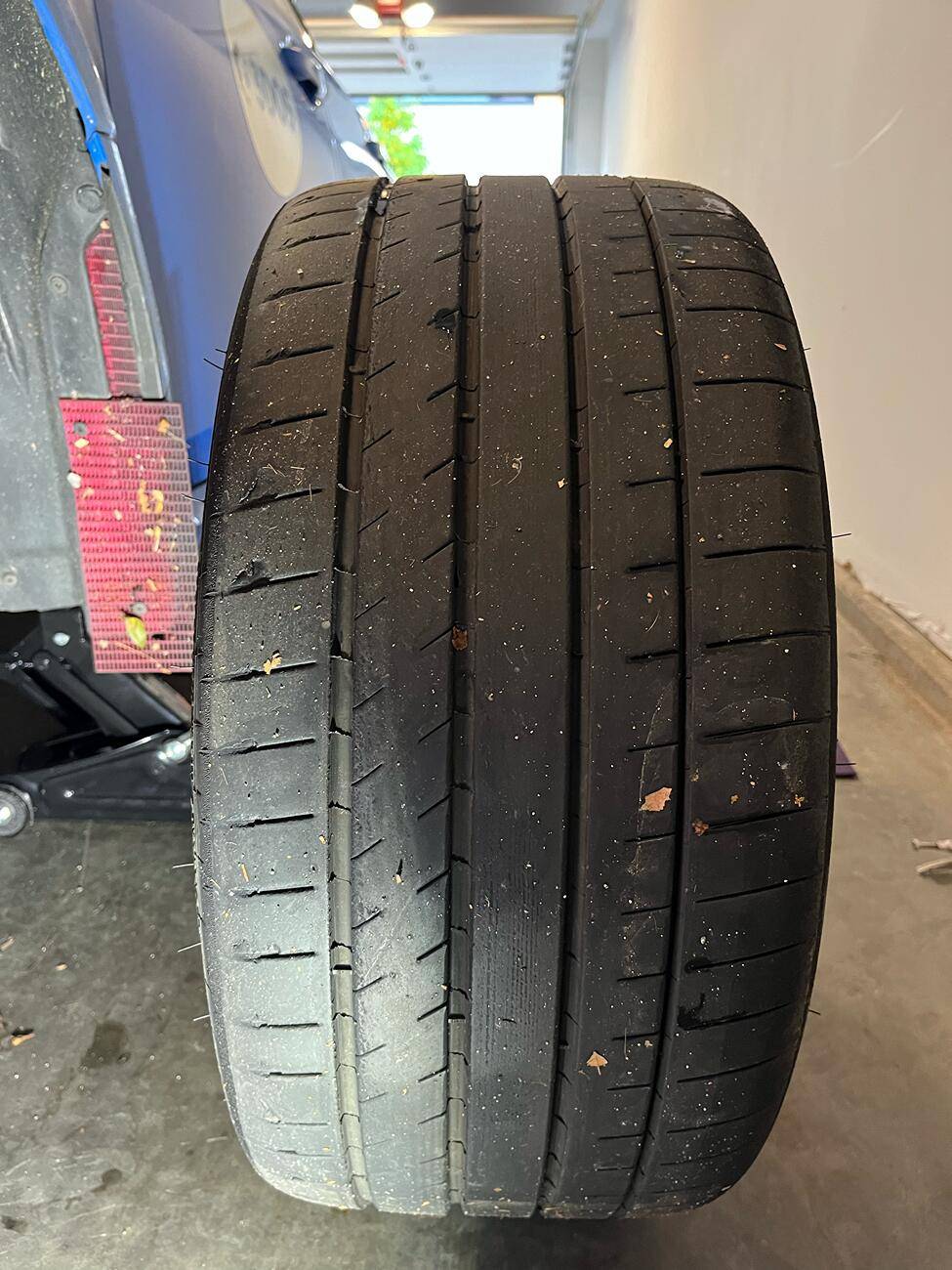

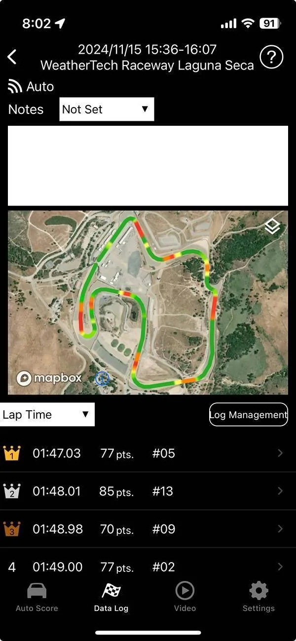

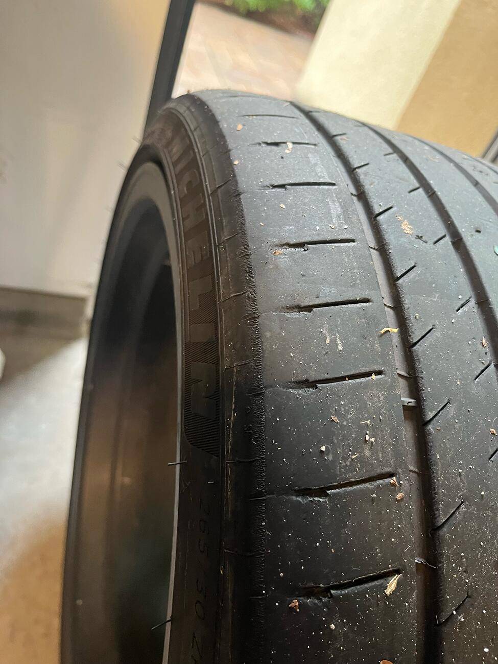

Quick up date, I did finally hit 1.47 and was on my way to a 1.45 twice - but hit traffic and spun it the other time - this car will do a 1.44-1.45 with a pro driver easy if not better - on Laguna Seca on the stock car, stock tires, stock brake pads, camber pins out and 5mm toe out with pedal dance, all traction controls off.
The only non OEM mod was Castrol SRF brake fluid, which is a MUST requirement on this car.
The good news is, yes I did feel that the toe out really help turn the car in easier vs zero toe, and .5 toe out total .
The bad news is, yes, the penalty for a lot of toe out in the front is I did cook my front inner tires.
I did also test using Nitrogen in the tires, and that did help, but you have to really cycle nitrogen maybe 5-10 times, deflate, inflate, over and over again to ensure you get as much of the humidity/water and get as close to pure nitrogen. This did stabilize my laps and I was able to get more laps without the psi going to 42 starting from 35 cold.
I also marked the PS4 side walls, and it seems if you go below 38-39psi, you start to really roll over the tire. It's a balance of having a soft side wall, and then having PSI to compensate for that tire side wall to remain stiff, and not come off the rim as many have experienced running lower psi 32-35.
Will dial back the toe out to 1-2MM and see how the tires do, and looks like I may have to start to long press type R traction control off, vs. full off, to help the car turn in. Someone else recommended 1MM max total out on the toe out - and it looks like that is looking like it's pretty good advice. I'll try that next.

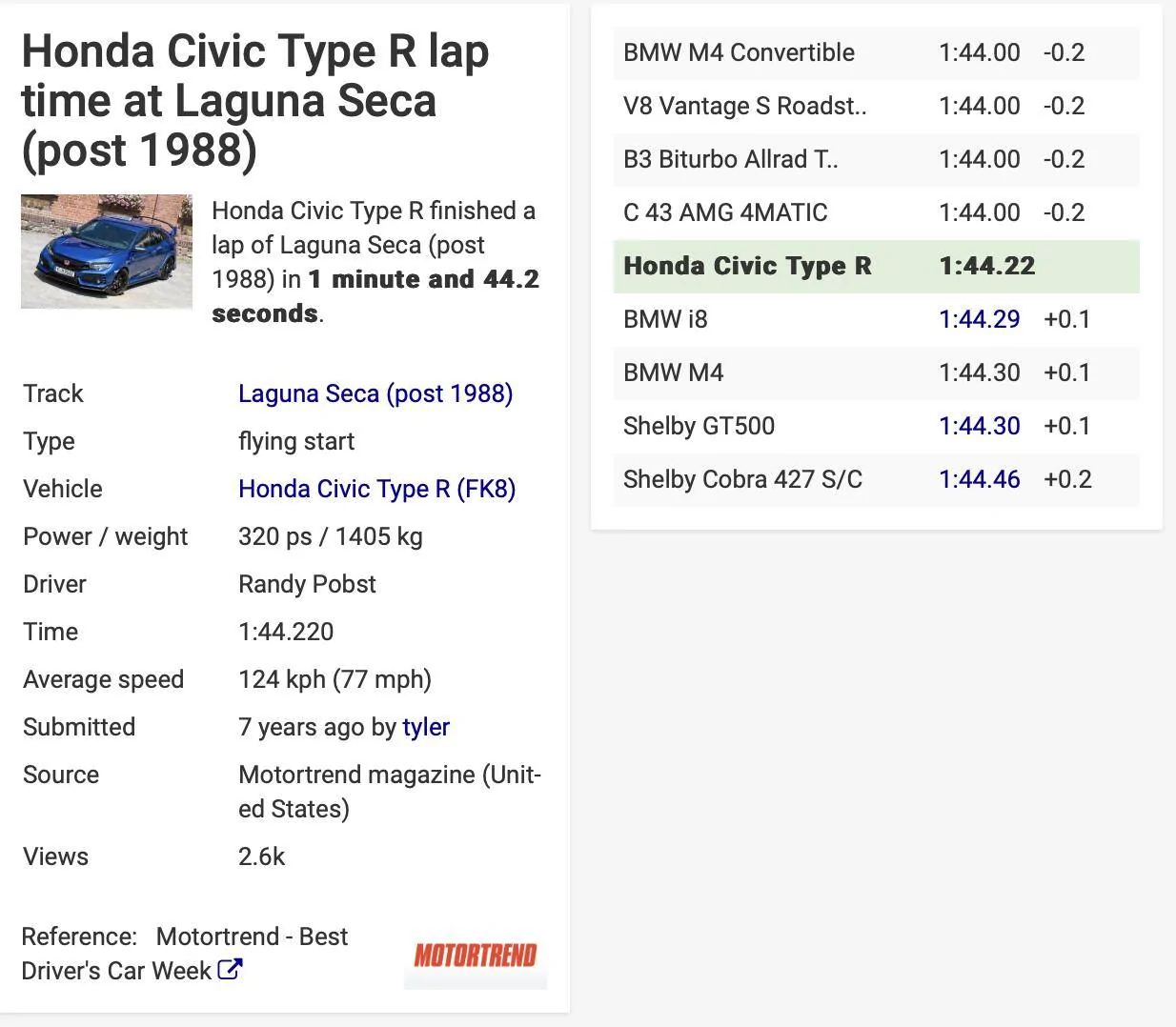

Here is Randy Posbst - American race car driver and journalist for Motor Trend magazine
I'm not sure if he was on PS4's or Cup 2 - need validate

Pro Driver in a Elantra N did a 1:44.1 in a fully stock car. FL5 is consistently faster than the EN.

@J1Avs That's not the same car - I provided real evidence.
You provide a headache mostly -- But do appreciate the candid responses. We even learn from critics.
I'm looking for data only - apples to apples.
You can see an Elantra's doing high 1.44's and and only Randy - Pro driver doing high 1.44's in an FK8- and one guy on an integra type S - touched a high 1.44 then - flew off track. Not repeatable. Difficult to due a fast lap in with the 1.44s before performance drops and the window to achieve a 1.44-1.45 is very very narrow. His tire came off. If you want to run a faster time, lower tire pressure, then you run the risk of the tire rolling over. Higher pressure 38-39 then you're going slower. Very very difficult to achieve a 1.44 consistently stock car stock tires, even for a pro.
I haven't found any stock FL5 Type R's or Fk8s' breaking the 1.44. And if I'm approaching 1.45.. that's pretty close to the only Pro driver - Randy Pobst - we have data and evidence on - and I still don't know if he was on 4s or cup 2's
Also - need to factor in my car is ~100lbs heavier than stock - It seems I have maybe the world's most sound deadened Type R FL5, floors all dampened sound proofed and doors trunk.
I do think we are approaching the limit of the stock FL5 on Laguna Seca according to the data.

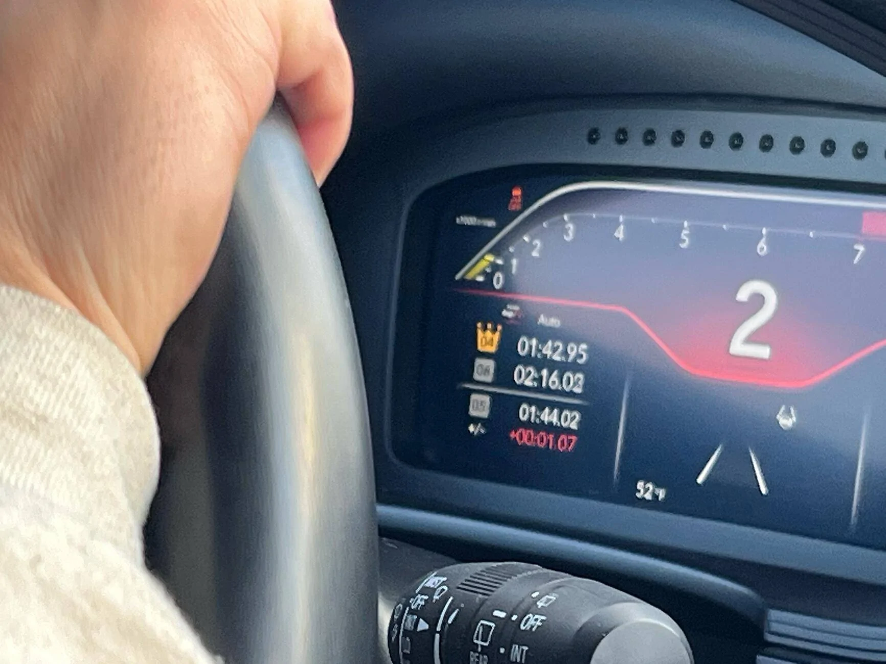

Here is my friend who is just broke into the 1.41 with many many mods( twin oil coolers, heavy suspension, brakes, bushings, -4 negative camber, engine mounts, etc.. running AHA long press, and as soon as I got into the car ( extra (220lbs), on the same day he broke into the 1.41's -- into some laps he was consistently slower he ran almost 2 seconds+ slower. with me in the car.. He could feel the extra weight.
Data Data Data
Red pill the noise
