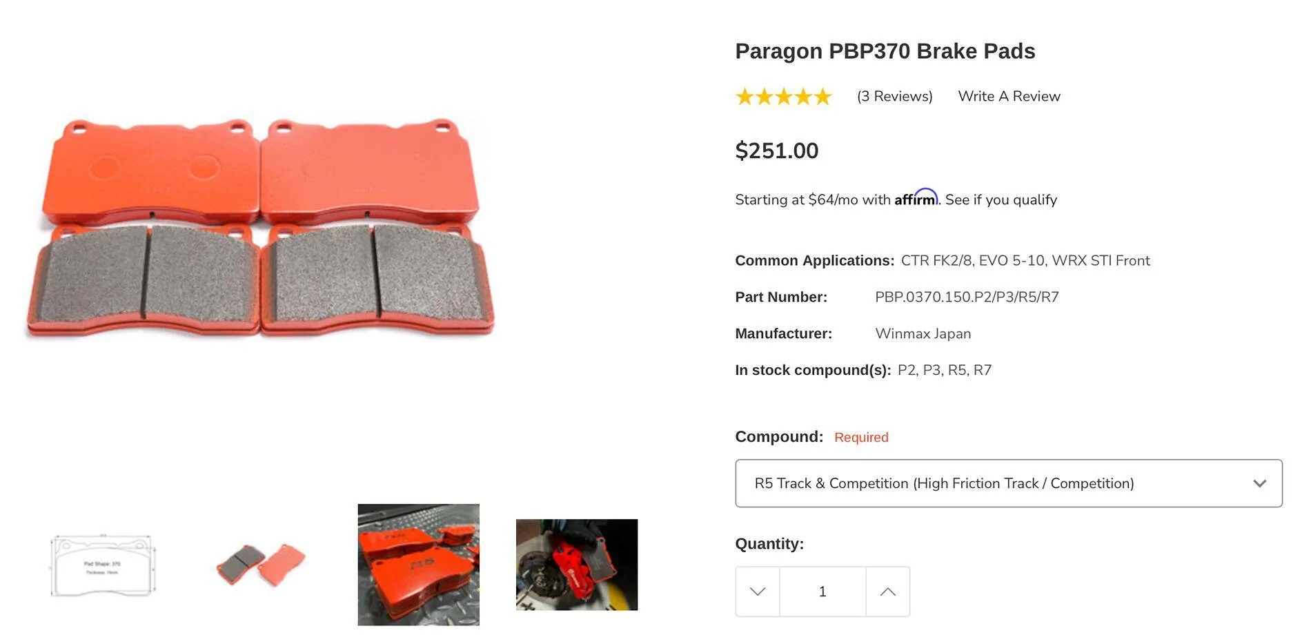

Thanks @J1Avs - will have to look into those brake pads - I was thinking of taking advantage of the FCP Euro infinite return brake pads and replace move - it seems they have front brake pads that fit the FL5 Type R - same as Volvo -
what's your view on the Brake Hawk DT-60's compared to the Paragon R5 or CSG C1X's ?

FL5 Pad is a super common shape — Brembo 1001. I wouldn’t be surprised if you found a few other options on FCP Euro for it — maybe some Pagids.
The Hawk DTC-60 is like the basic track pad — it works, but it’s LOUD, it’s dust is hyper corrosive (so don’t let it sit on your wheels), it’s basically an On/Off switch with very little room for modulation and control, and they get HOT. It really wouldn’t be my first choice, but if you are looking for a budget option with lifetime free replacements, then it’s worth a shot. You will definitely stop, but you’ll also get Brownbos pretty quick :)

Interesting, so they transfer a lot of heat, is that why they turn the Brembo's brown, or is it just the dust? I have noticed my friend that tracks very hard his FL5 at Laguna with the R5/R3 config, has his Brembos looking discolored. Not sure if he's using the Titanium shims and Wondering how much the Titanium shims help heat transfer if at all or why there are not some kind of ceramic shims to help with heat transfer.
I know you've done a lot of research on brake pads. just checked out your post. Looks pretty conclusive - seems like you've done a lot laps - and collected a lot of data.
Wow those are pretty pricy though - almost double the R5's

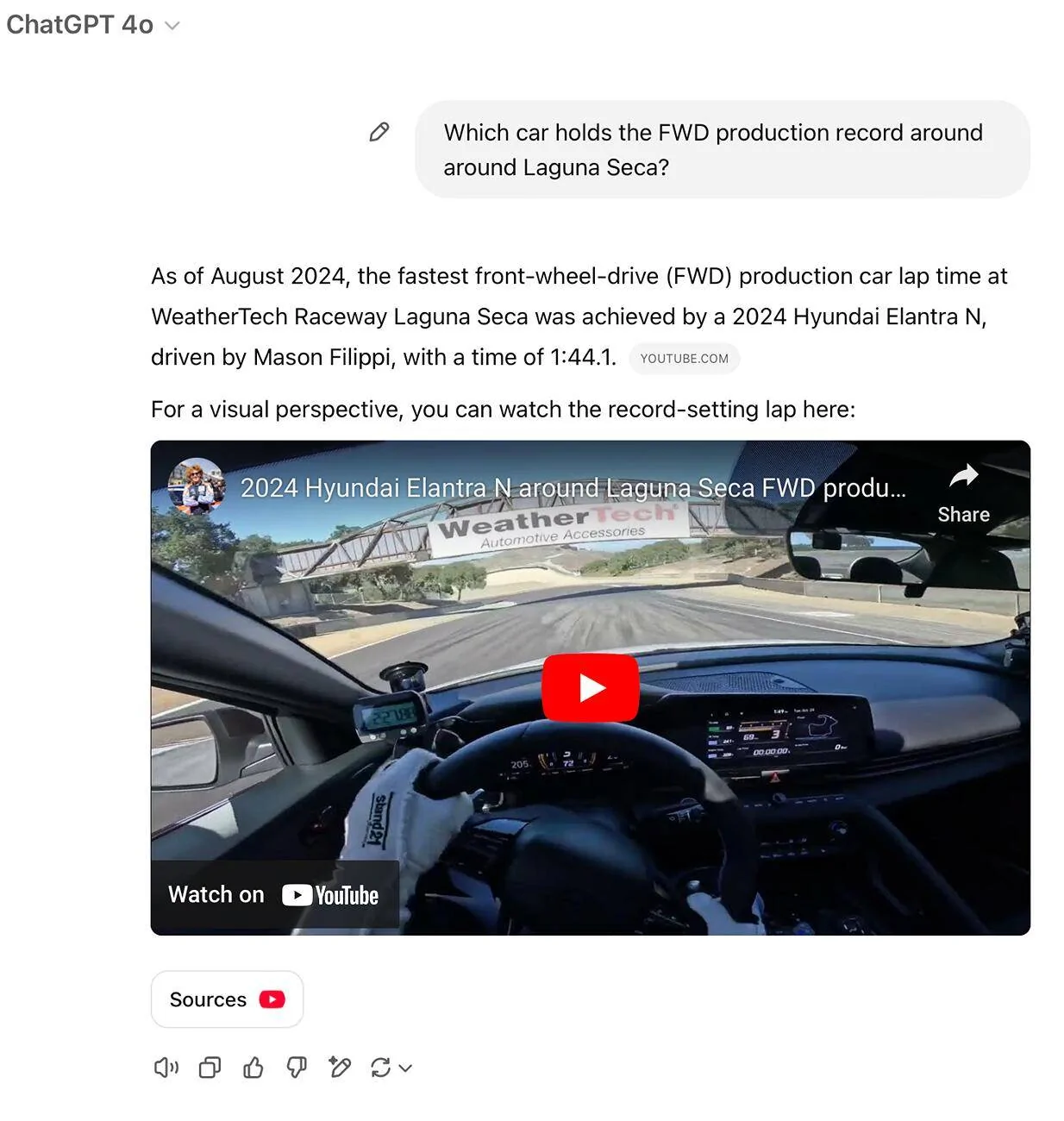

Very curious... what is the FL5 Type R's production lap record at Laguna Seca?
I just asked chat GPT which car holds the FWD production record at Laguna Seca -- and this automatic Elantra claims the record. 1:44.1 on stock PS4's but it does have a 8-speed wet dual-clutch transmission (8DCT).
I had one chance at a clear lap last time, and I got a 1.45.99, and I know I could have shaved off another second off easy with stock PS4's, ~1.44.5s, and I assume at least another 1-2 seconds off with the OE Spec Cup's should land me comfortably in the ~1.42-1.43 range.
When I upgrade to the OE Spec Cup 2's and a bit more practice -- I probably could beat this time, but will using different brake pads - does upgrading brake pads disqualify me from putting the FL5 back on top as the fastest FWD "production" record around Laguna Seca?
Jan 16, 2024 WEATHERTECH RACEWAY LAGUNA SECA
FWD production record around‪@WeatherTechRaceway_LagunaSeca‬ in the 2024 Hyundai Elantra N 1:44.1 Mason Filippi

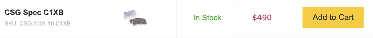

The heat begins to discolor them — shims help with pads that transfer the heat to the calipers — which is why many run the Paragon shims with Paragon (aka Winmax) pads. The CSG pads just have a better thermal capacity and don’t transfer as much heat to the calipers — the Girosdics help with this too.
The CSG’s are certainly double the price — but I bet last 2x as long, if not more. So the value is certainly there in just life alone. When you add in the strong thermal efficiencies, the modulation/control, the street manners, etc, it’s always an easy choice for me. FWIW, I’ve been running them for like 5 years on A90/GR86/FL5 and they have continue to impress, especially as they constantly innovate and improve of the compounds based on real world testing and input from drivers/customers. But, the sticker shock does take a second to overcome.

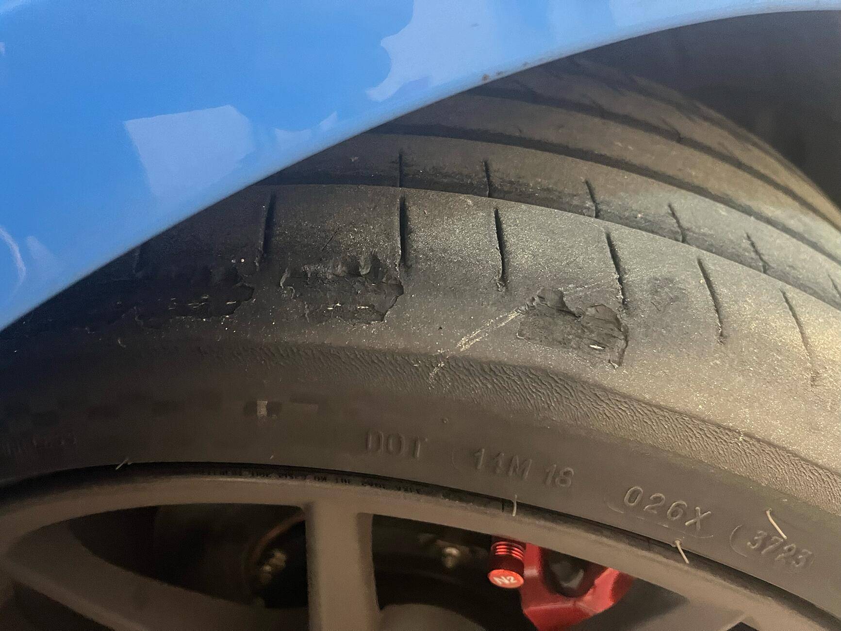

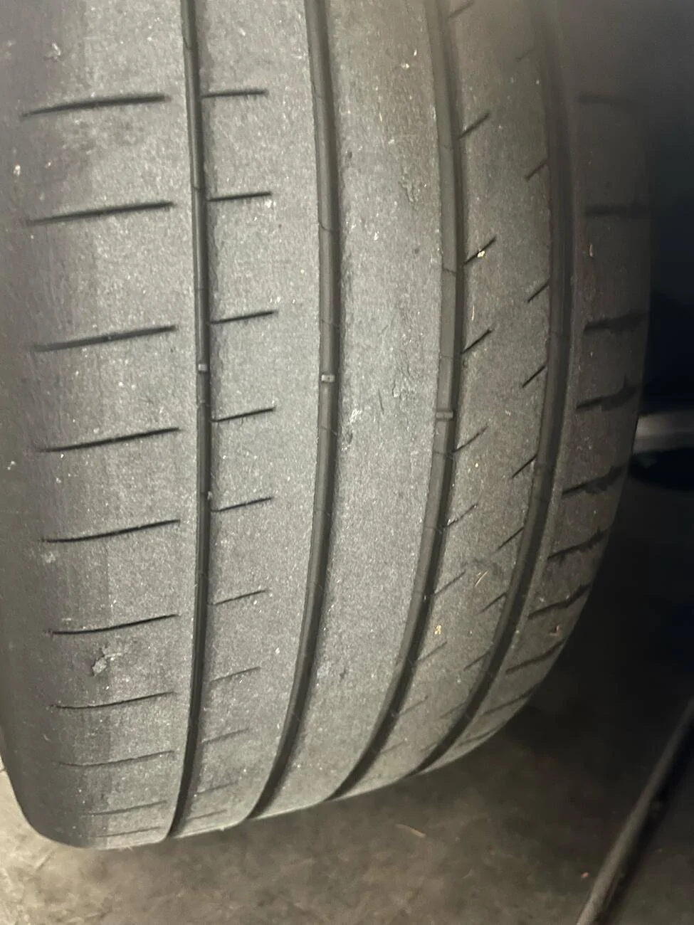

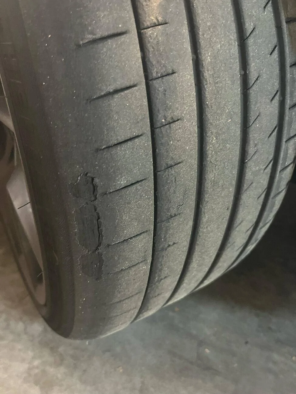

@J1Avs @tezzasaurusrex very curious on your input and experienced race alignment drivers.
1) When you tried the cup2's on your Type R were they the Honda HO spec? ( interesting insight in difference between cup2 vs Honda HO cup2's below - HO's spec have stiffer side walls than normal cup2's, but with softer outsides for quicker turn in )
2) On 4s's I was running 35 psi front and 32 psi cold rear, nitrogen filled, and when I chalked the tires, the front's were still rolling over a bit, the rears were perfect. When I ran 5-7MM toe out, it ate the inside of the tires pretty fast up front, then backed that down to 2mm which felt excellent, but after 8 track days, the right outside tire started to show the radial.
My goal is to optimize the stock FL5, and find the limits, with stock OE spec tires, and I know lower tire pressure does equate to faster times, but the trade off is, the tire's don't wear as evenly.
So Yes I probably could have shaved 1 sec off my ~1.45.5-7 times on Laguna Seca with the 4's going lower in tire pressure, but the consistency lap over lap would drop off and the risk was with the 4s -- debeading the tire. I wanted to see the most consistent times, and use as much of the tire over the most track days as possible. It ended up being about 8 track days. Also enabling light press on traction control really helped tire longevity, as it helped keep the wheels from spinning, and lighting up as I was experiencing with pedal dance.
I've been using AI below to track all my data, and fine tune what the next setup should be.
I would like to really dethrone the Hyundai Elantra N 8 speed dual clutchLaguna Seca FWD production Record 1.44.1 - I Hope to get the Type R with OE HO spec tires into the 1.43.
AI is saying I should do 2mm toe out which I have and 2MM toe out on 4s, on stock suspension, but go a bit higher on tire pressure. I also felt the car become more predictable with nitrogen 35 psi/32 psi rear cold.
I do understand that if you have non stock suspension - lowered with more camber, zero toe in front and maybe 1mm toe in on rear or zero is best. But I am running -1.8 stock pins out camber in front.
Should I start with 0 toe in front and stock 2mm toe in on the rear, or should I keep my 2mm toe out and 2mm toe in?
Would higher pressure solved this issue with the right front tire
- Laguna Seca is running counter clockwise and I assume the right front tire is taking more loads.
Open to everyone's scientific input.
Front right tire

Front left tire - no issues on side walls
11th Gen Honda Civic Racing the FL5 Type R with all OEM spec parts on Laguna Seca tempImage0q5jex
Or should I run 3MM toe out - will that put less stress on the outside front tires, or with the 4s this was simply an issue with side wall deformation, and a bit more pressure would have helped?
Other than that right tire outside tread - The tire looks pretty evenly worn at 2MM toe out, right?
Front right tire
