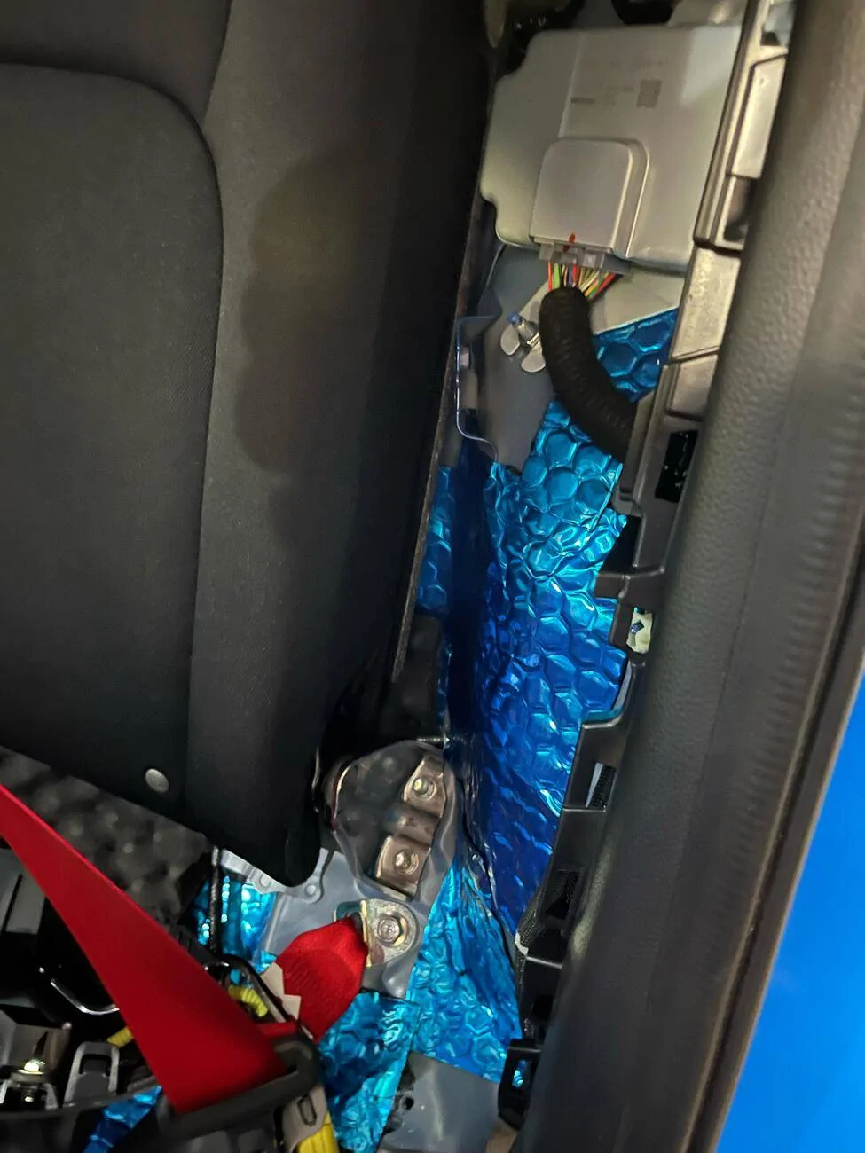

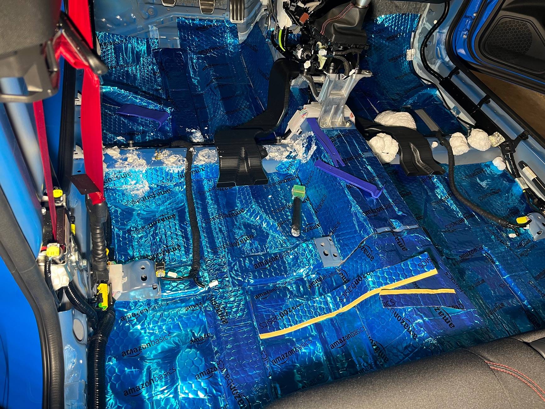

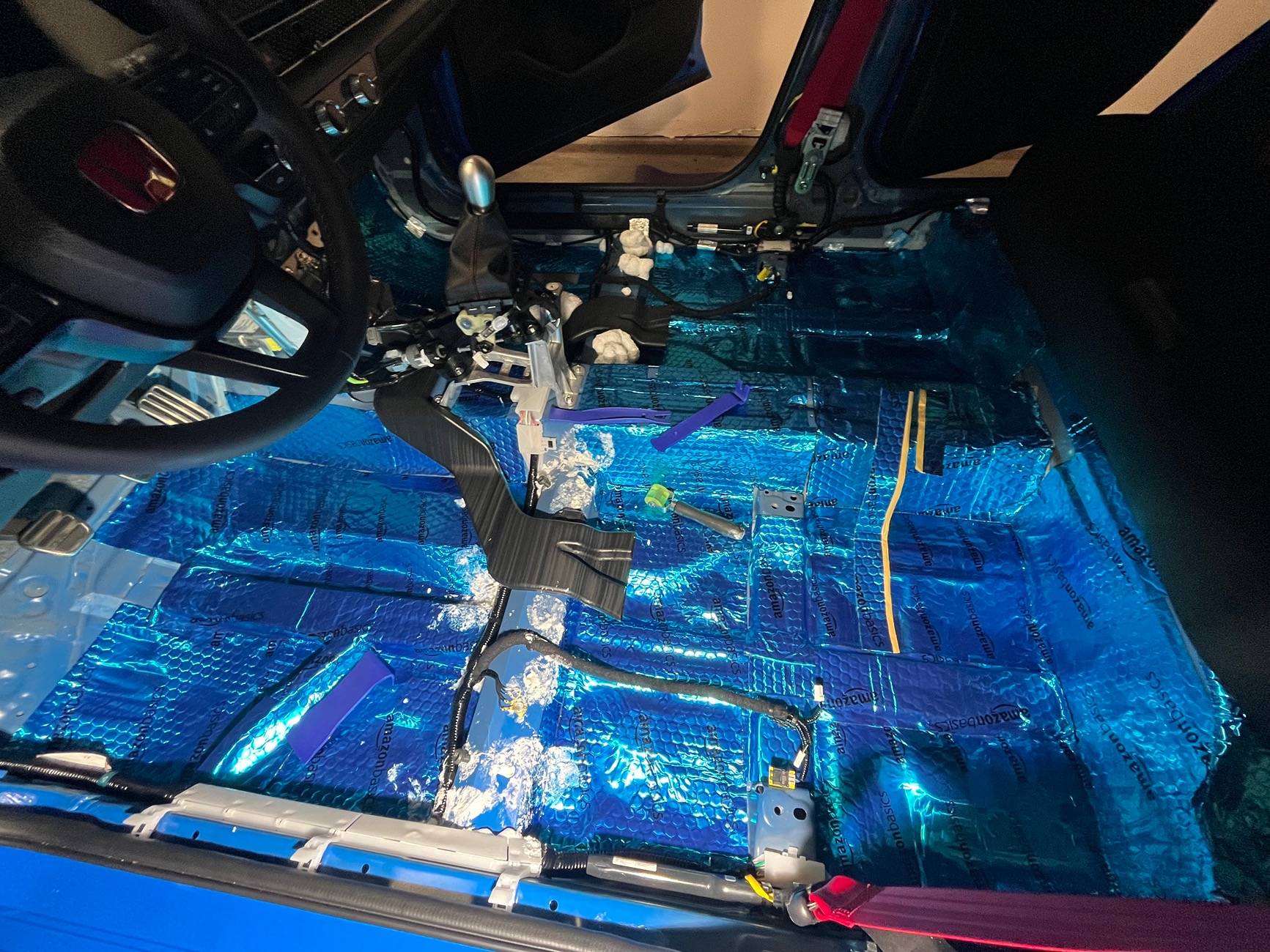

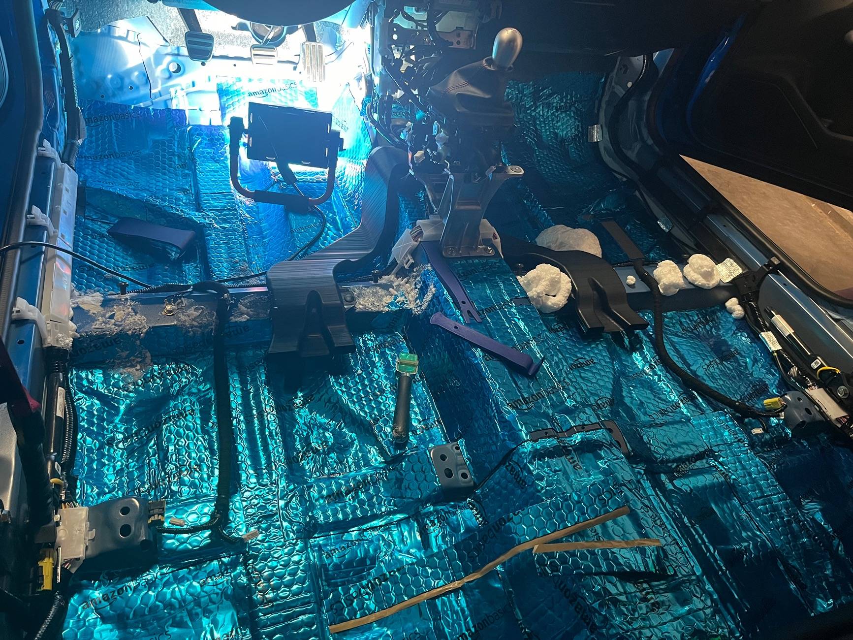

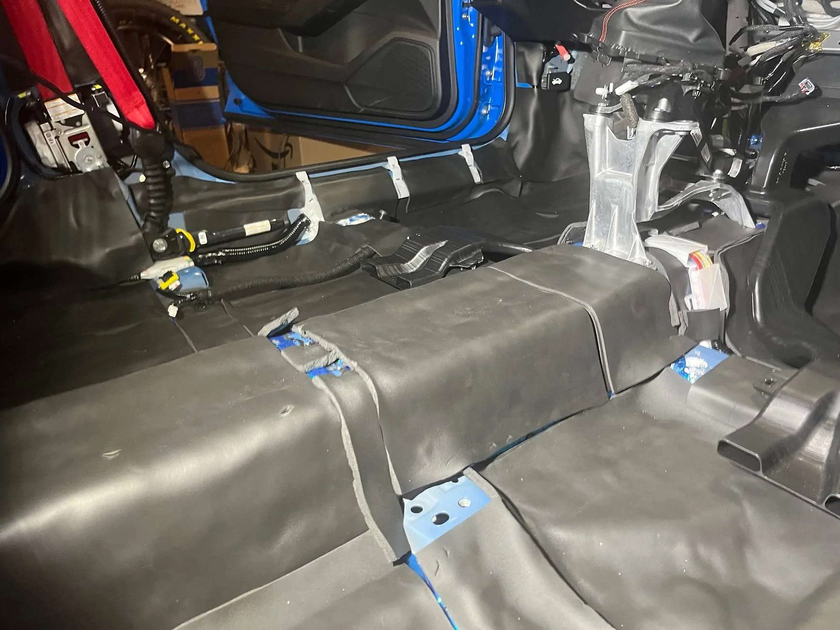

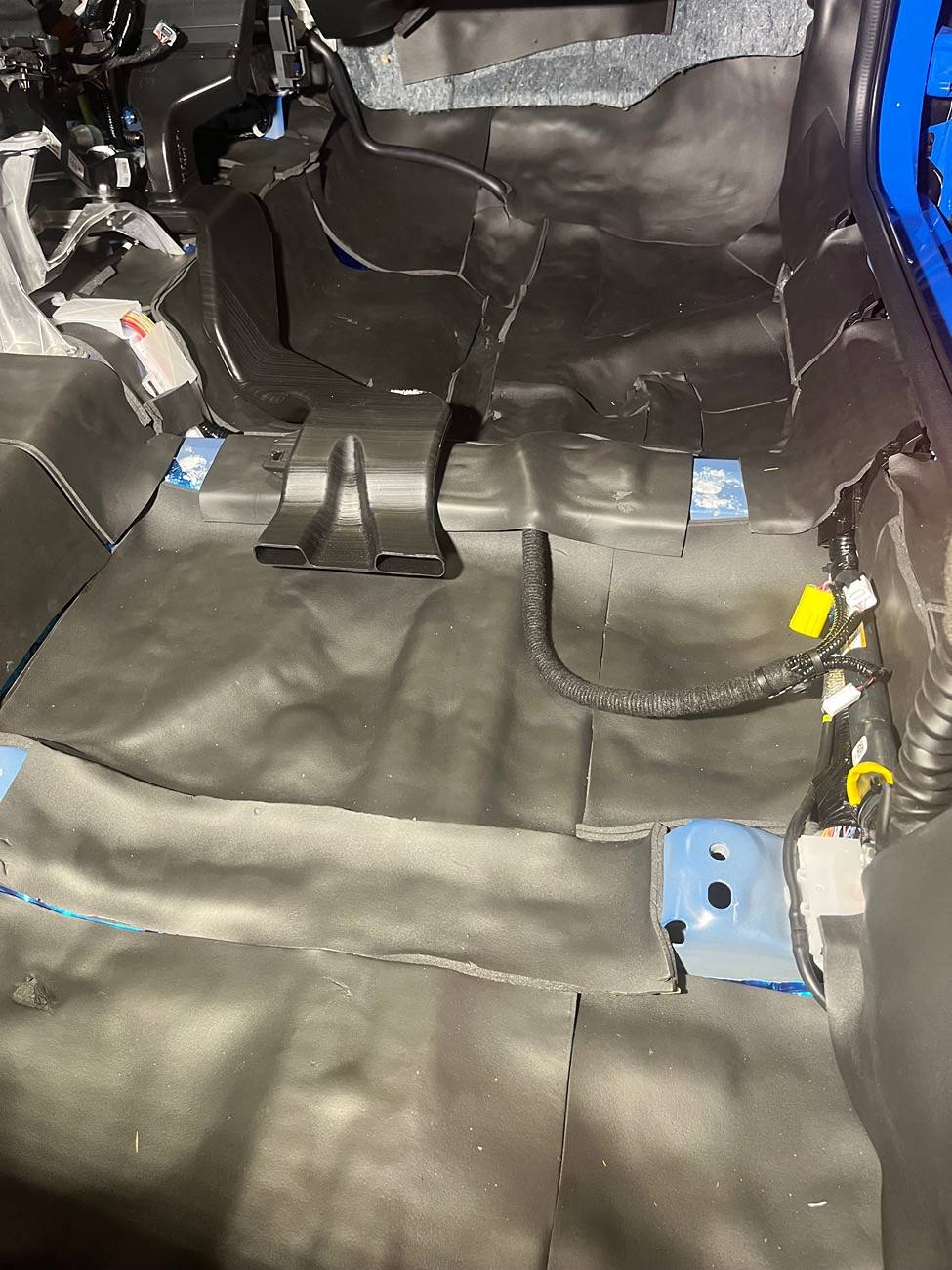

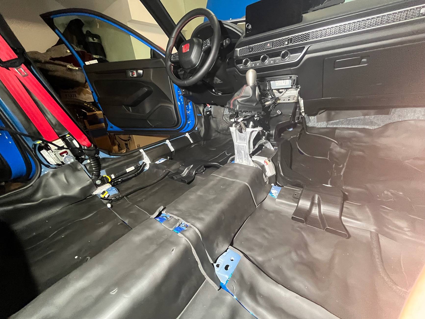

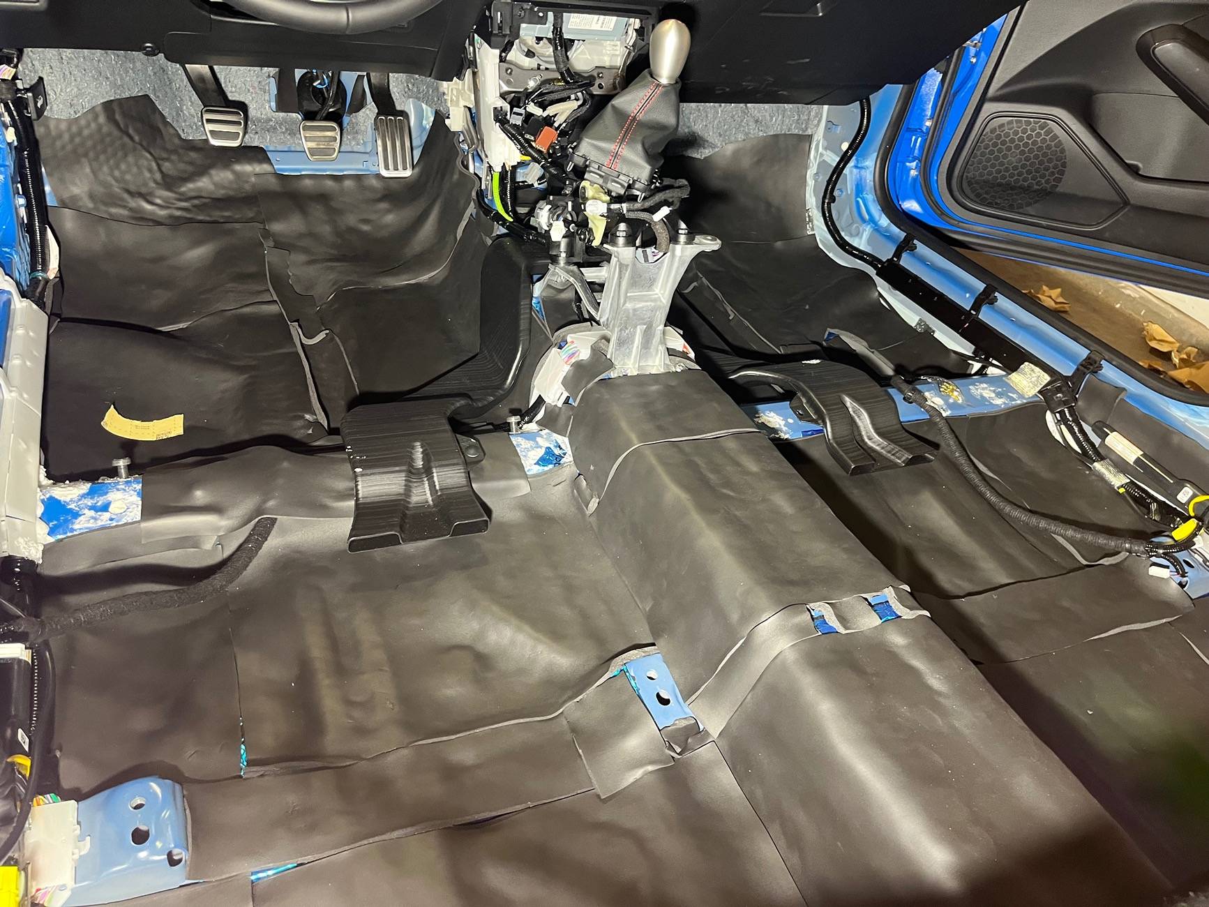

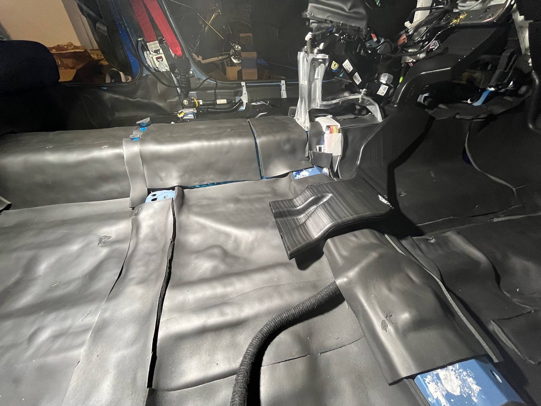

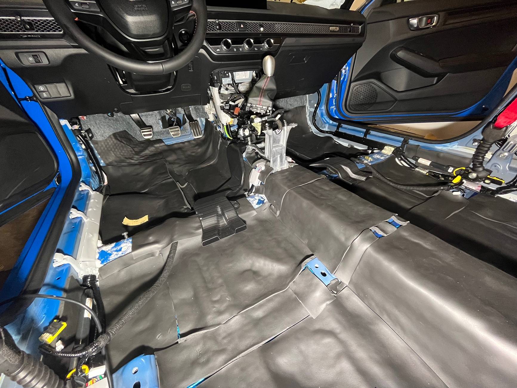

Update:

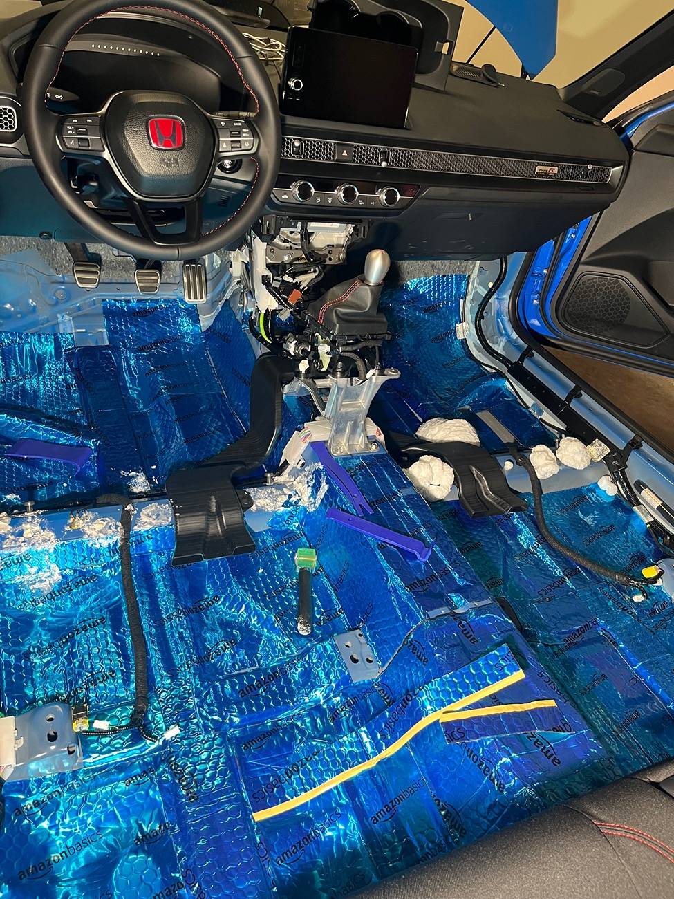

Most of the sound deadening is applied, also used expanding foam on the hollow metal structure on driver and passenger - where the front seats bolt in.
I went as far as I could by the fire wall behind the sound proof cloth on the passenger footwell, and will complete the drivers side as well.
~8-10lbs of sound deadening applied.
tomorrow this will be covered by a foam layer. I may double up. It’s going to be important to blanket seal the sound.
Also noticed the middle tunnel had the most hollow sound.
Ps.., this takes a lot of time… very tedious work, with the hands to get into every crevice and cut/mold all the sound dampening into every corner and edge.. it’s like doing Yoga for 8 hours - your body will hurt in a completely new way.
About to find out soon if this was a complete waste of time or worth it…

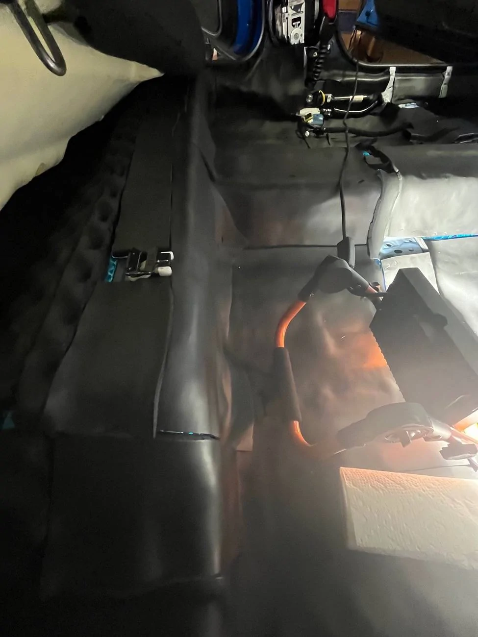

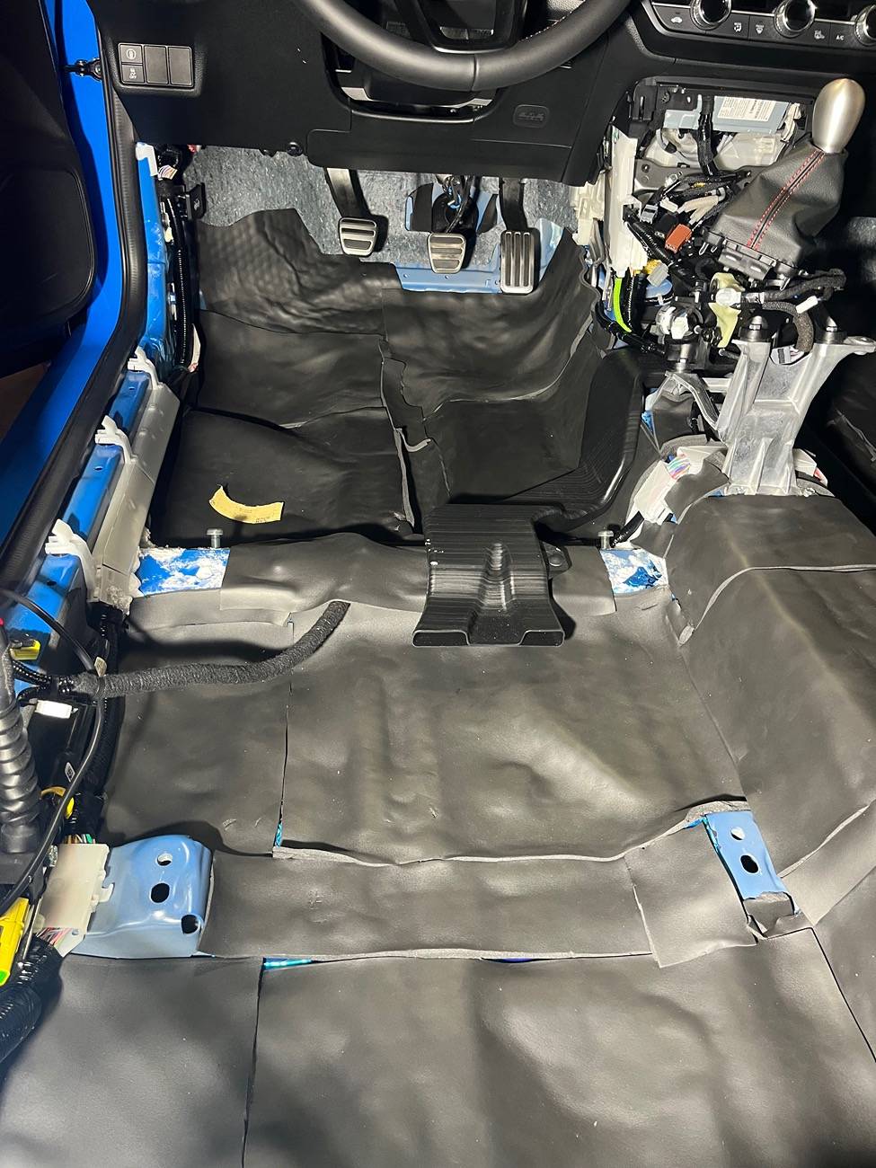

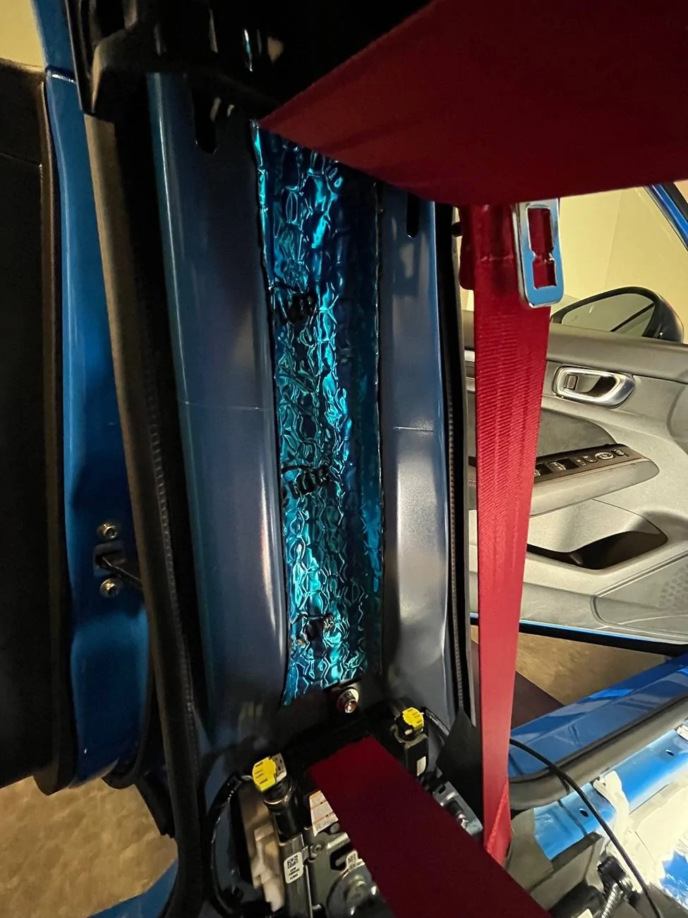

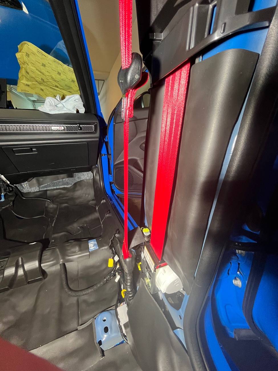

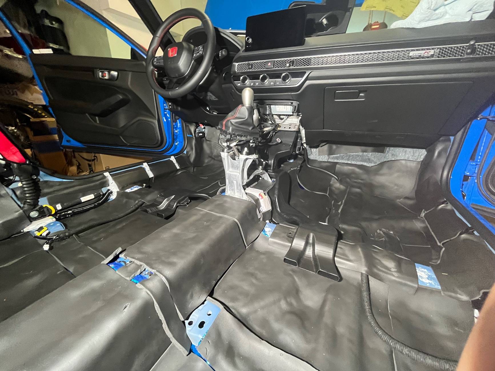

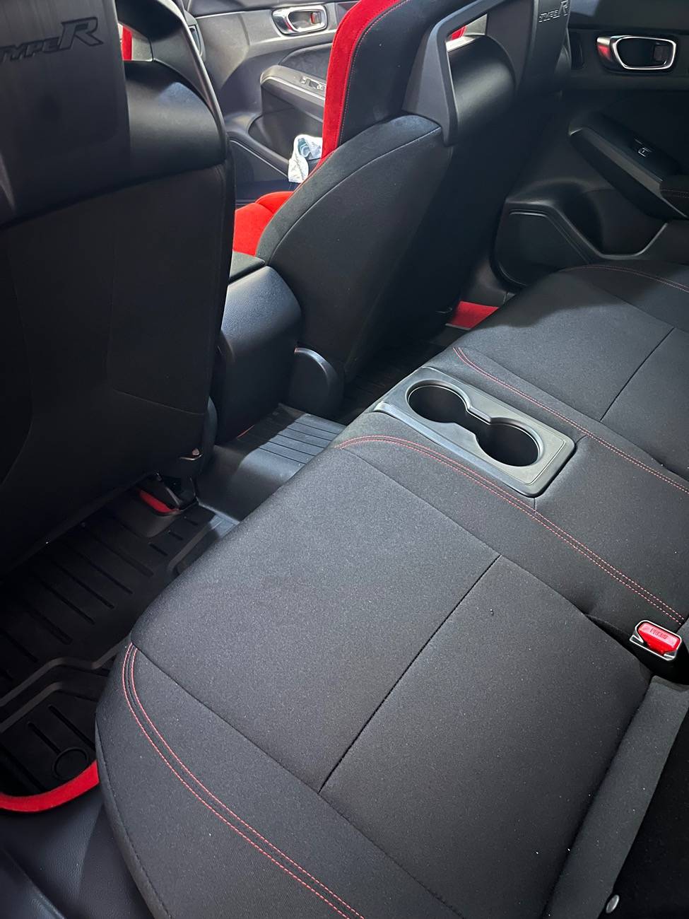

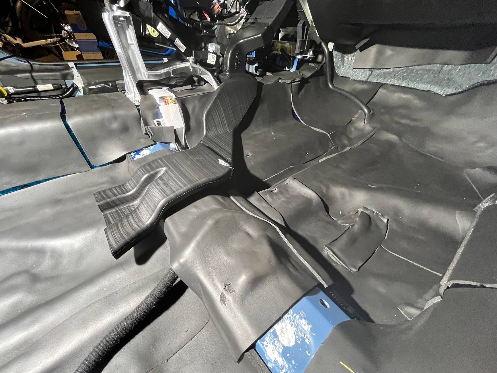

Ok fellas whew ? finally completed the job, forgot to plug in the center wireless charging and remote entry, but other than that what a success! Just took her for a quick drive and the floors really helped dampen road noise but also the over all feel of the car.

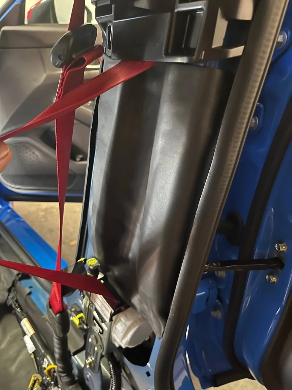

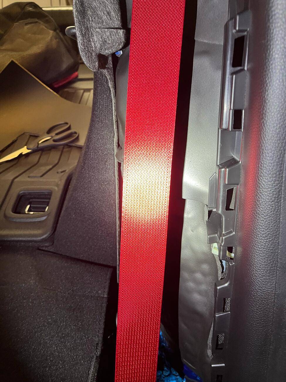

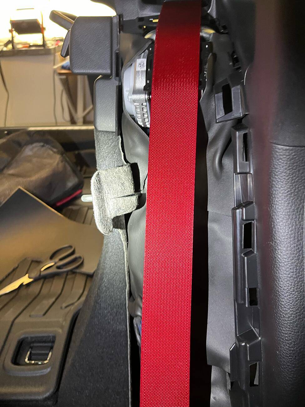

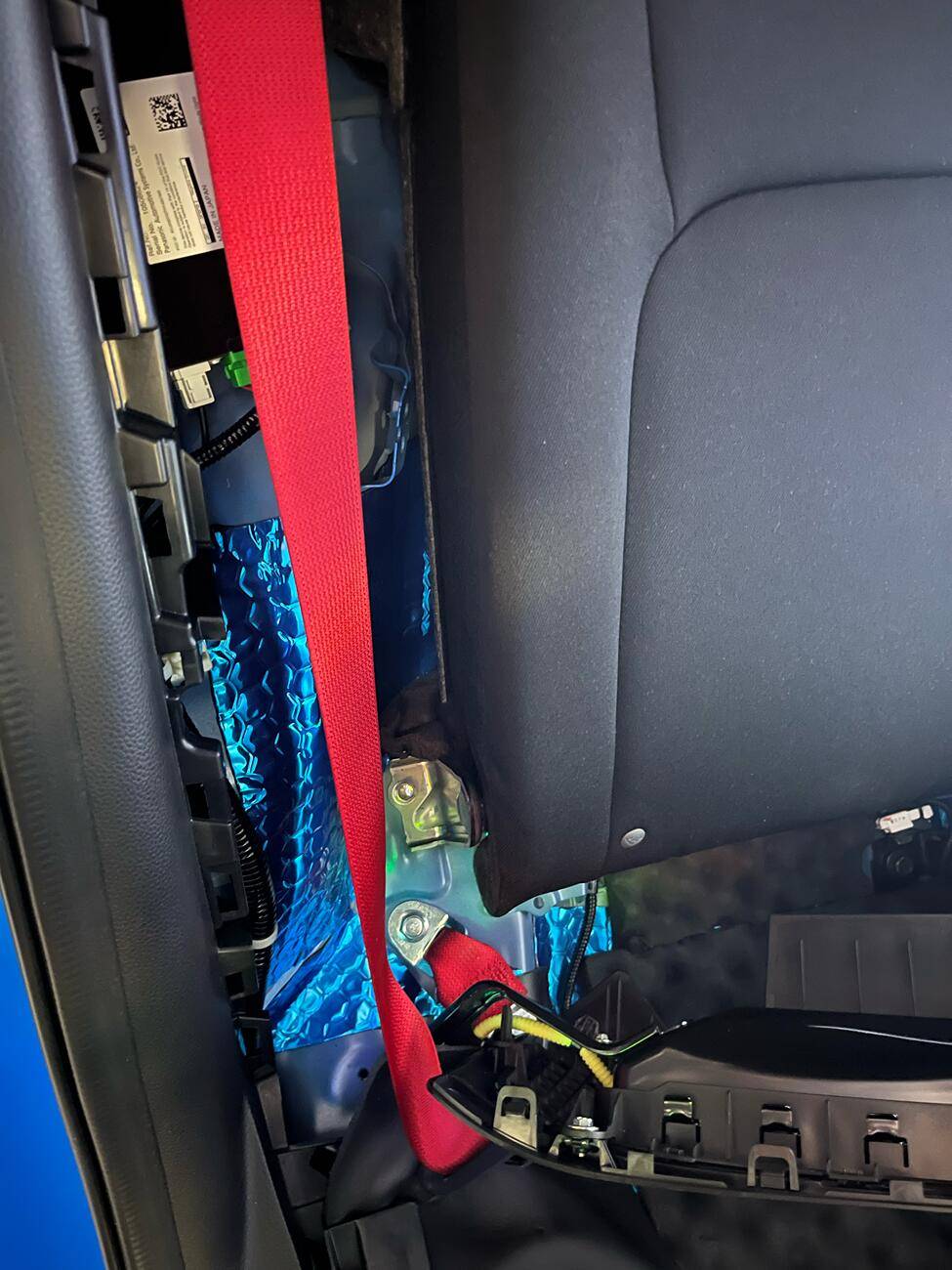

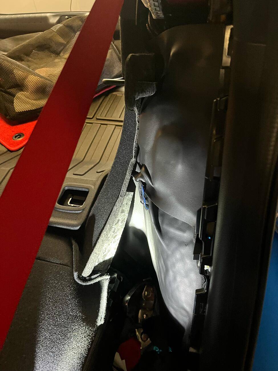

I also did the side pillars by the seat belt.
I have a lot of lessons learned and will share and do some extensive tests next.
Regarding the floor, yes it all fit! I used two layers, but you could just use one and it would fit easier within tolerance.
If I had to do it all over again, I would not use the egg crate foam I used in the trunk and doors, which was very difficult to stuff in. Also the egg crate foam had a built-in, butyl layer dampener which was extra weight that was not needed on top of the Amazon dampener. I would use this 157mm close seal foam and Amazon basic dampening. It’s very lightweight and sticks extremely well instantly.
The car became much more mature, still edgy, but like dampened a lot more in the way it feels. The front engine and mechanical sounds are more enhanced because you don’t hear the rest of the car and it’s clear there is a very thin firewall between you and the engine. That’s the only place I really couldn’t get to.
You can still hear the tire howl coming from those Michelin pilot 4s’s, but everything is muted more. We’ve turned down the tire noise while drastically reducing interior cabin noise. It feels like a vault inside.
So far, very happy with the results, but let’s see if all this insane tedious and meticulous work helped my hearing issue.

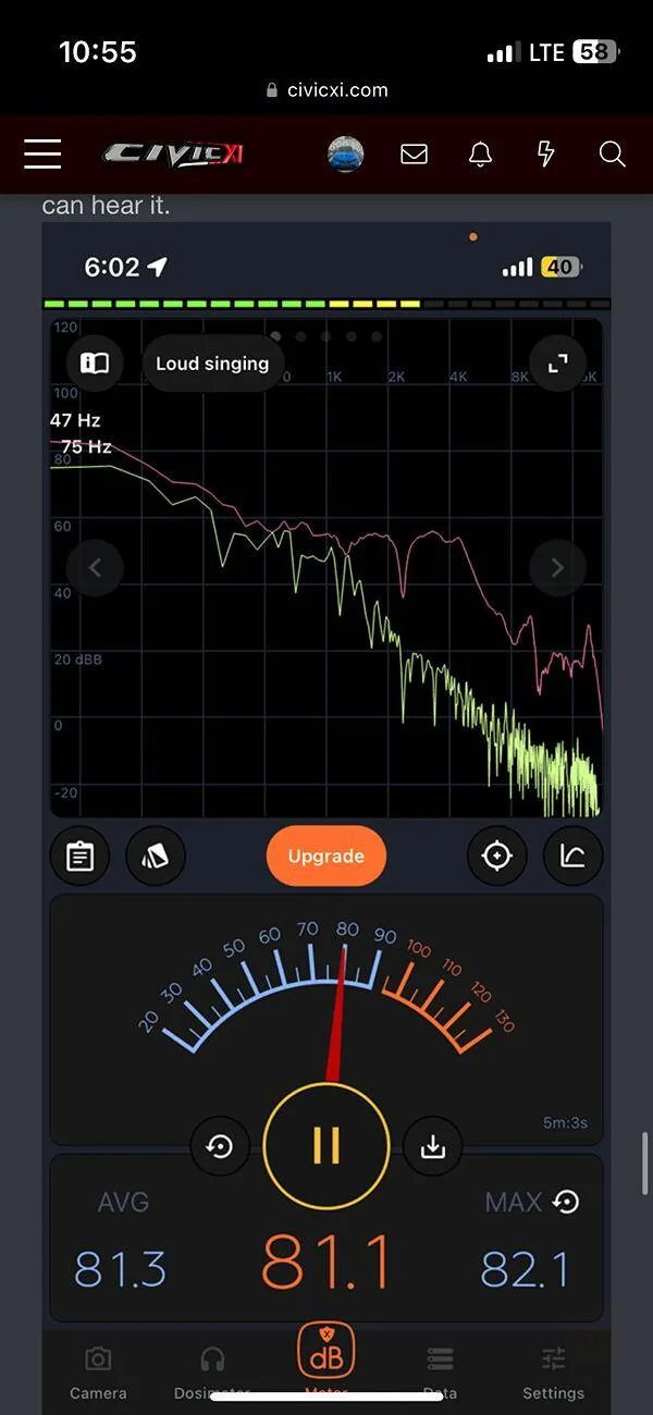

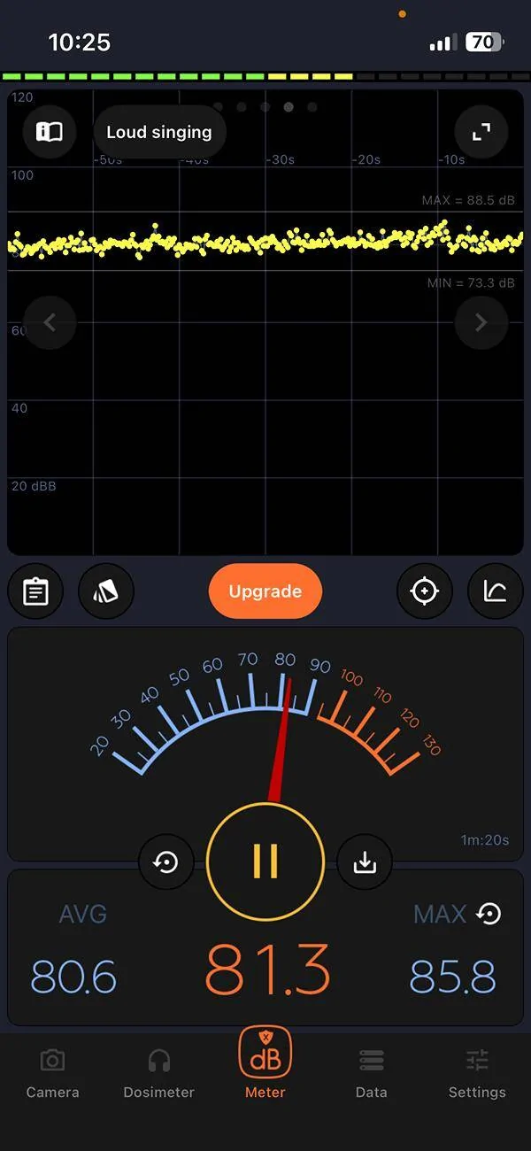

No rattles, seems like noise and sound energy doesn’t travel all the way through the car rattling it anymore.
I drove the same highway same as with trunk doors wheel arches rear seat floors done, and you can see we were able to knock down another ~2 db down which is a lot - according to the same app, but while my ears are telling me, it’s much better than than what the db app records when I go over bumps and it’s nowhere near as harsh and doesn’t rattle the car anymore. Those pilot 4S’s are real noise rascals. Still humming, but all the volume is turned down from the noise they produce, but the vibrations they produce through the chassis is like 95% eliminated.

It's wild to me that my app results are so much quieter than yours, with my car having DWS06+'s and minimal sound deadening (trunk only). Perhaps the road surface is accounting for some difference. If I put in the same amount of deadening work you have, my car would be in the low to mid 60's, which seems hard to believe.
johnloov
John
Jul 9, 2024
439
490
I agree, this is far apart in tests.
1) It seems the Pilot 4s Tires are the Biggest Sound Demon - Other journalist recently have noted the Type R is quite noisy.
Same tires on the 911 and 911s I found also to be very noisy, not matter wheel size. Other's that have Porsches and performance cars also switched to DWS06+'s and were very happy with the 7-9db improvement which is a lot! It proves that the tires are the worst culprit here with transmitting sound into the cabin. I also noticed the AMG Mercedes running 5S's, the journalist was also having a hard time with all the noise, and had to speak extremely loud. Mercedes are generally very good at sound dampening.
The industry needs to take the sound dampening technology they invented for EV tires and embed them into high performance tires. I'm sure... this is coming up next
2) Sound deadening and dampening really works!
For sure the car is much more manageable for me with my Tinnitus.
If I had to do it all over again, and if you're a person that's not that hearing sensitive, and cares about adding very negligible weight.
I would:
1) Place the Amazon Basics Sound deadener in key locations in large pieces. Don't need to blanket the entire surfaces. Maybe 30-50%max. Turn the metal from a gong sound to a dampened sound.
2) Then blanket seal all doors trunks floors wheel wells arches with a single layer of this 157mm or double - close cell foam, which feels like it weighs nothing. It's super lightweight, even if you double it up. The amazon deadner weight is very dense and weighs the most.
I don't have the total weight numbers yet, but I will - I'm overestimating.. Let's say I added a total of 100lbs max to the car weight ( I think it's more like 80 lbs ) ---
Then by using the technique described above you would have only added maybe 20-30lbs max. Which is really negligible and you would have gotten great results.

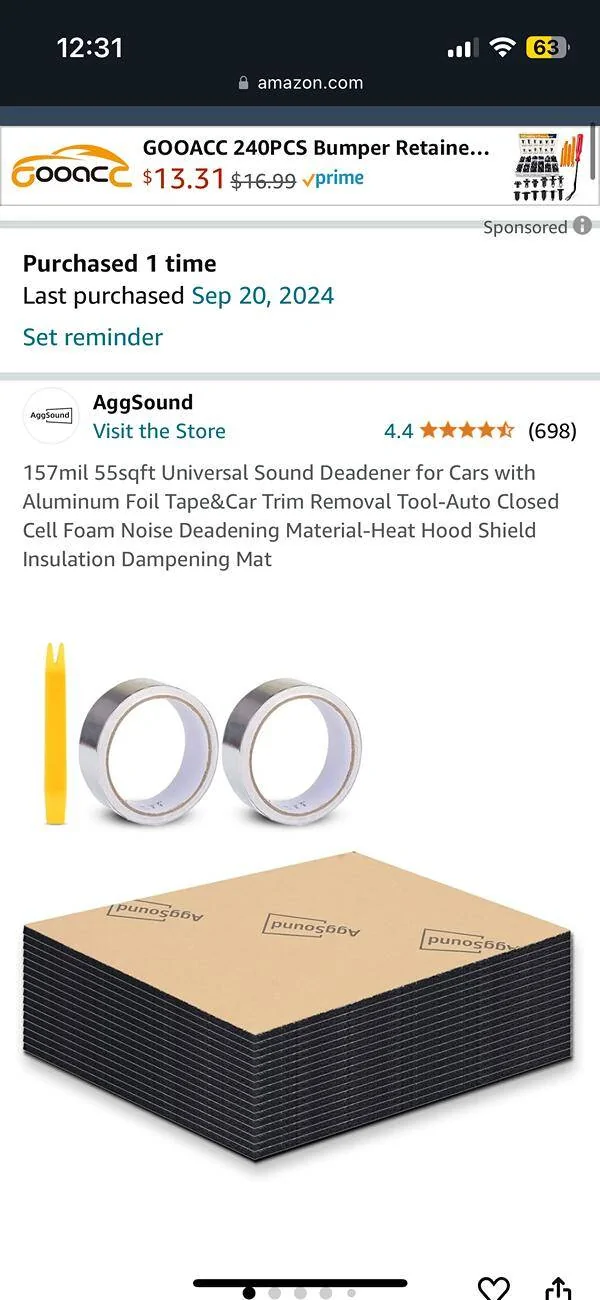

Lessons learned, I would simply use the Amazon deadening and 157mm closed seal foam doubled up where ever you can. That’s the only ingredients you would need to be successful.

When I had used the egg carton foam, it didn't really fit where the rear passenger airbags are close to the doors, over the rear wheel wells.
I just went back and used the 157mil/4mm close seal foam, and now the rear wheel wells interior are mostly totally sealed.

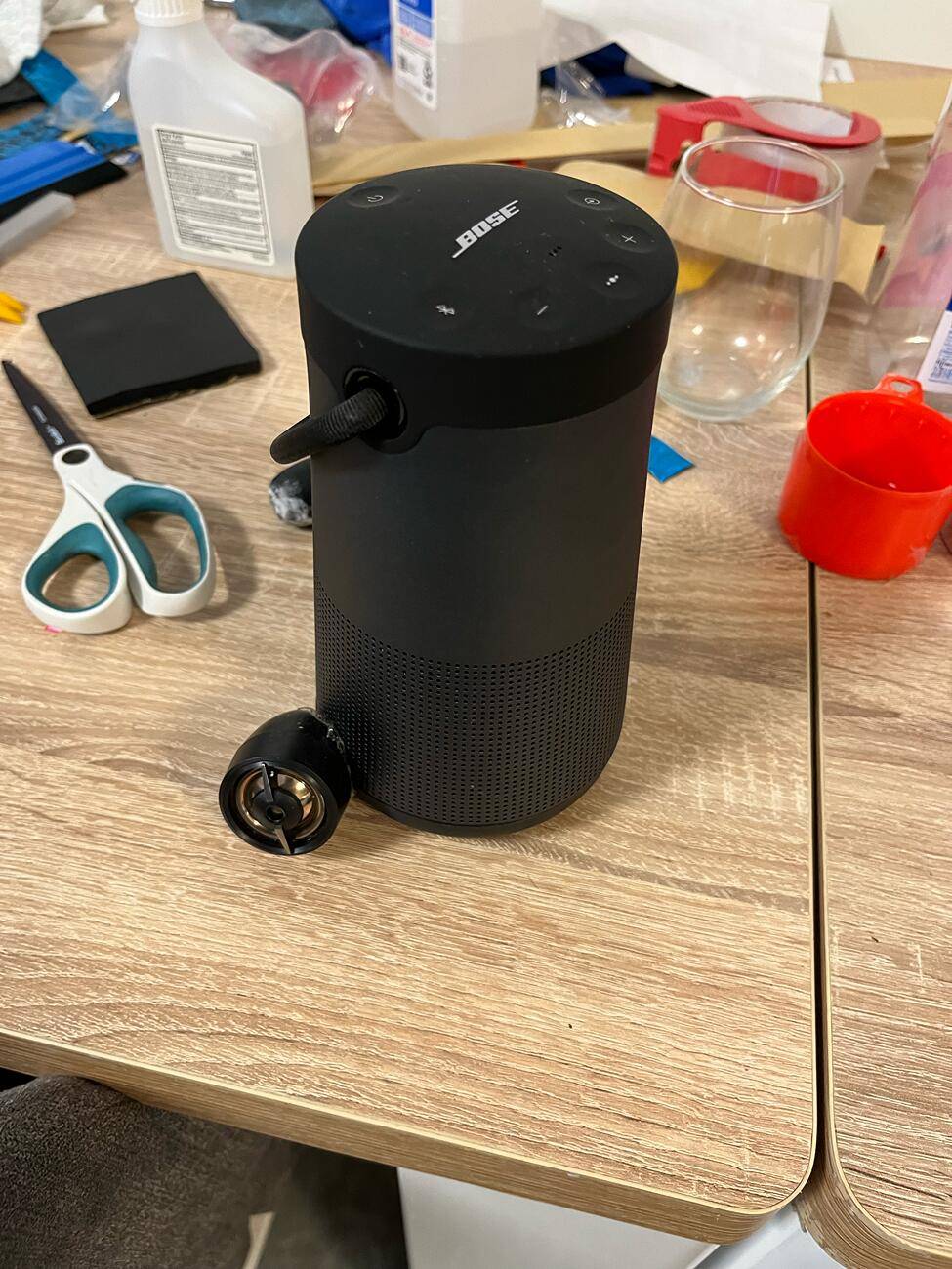

I had done some experiments with my portable speaker, covering it, with different materials and thickness, and the most important thing is to seal the sound after dampening it, and that's what is so great about this 157mil/4mm close seal foam. It's very easy to work with, sticky, and closes off the sound. I could double it up or use one layer where tolerances are tighter.
Let me do some more tests tomorrow and next, then I can come back with a conclusive results and give you advice where to start.
