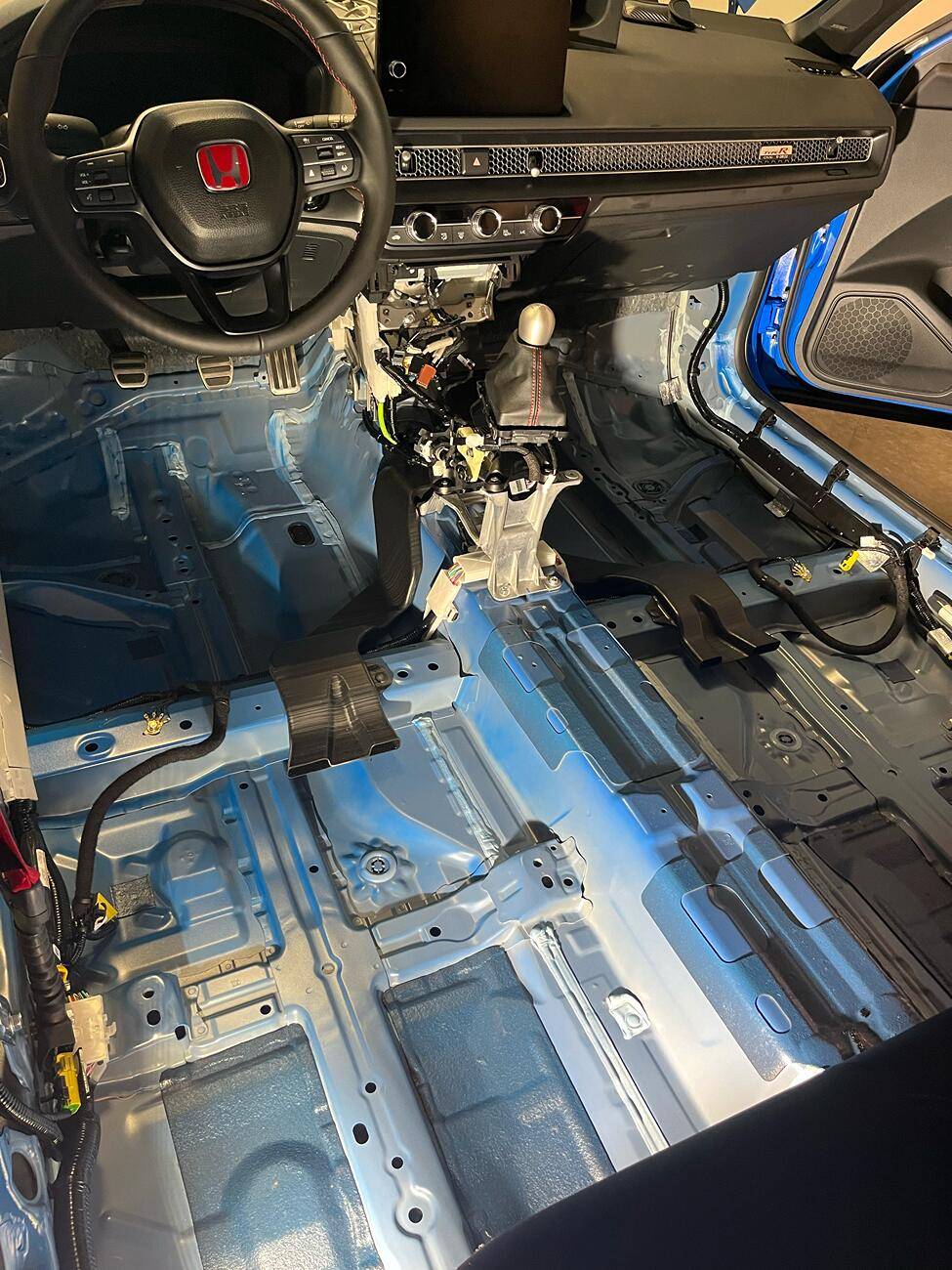

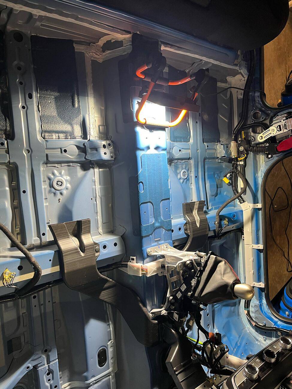

I agree on most your points, but unfortunately, I have Tinnitus, and once this car triggers my tinnitus, my ears ring for like 2-3 weeks straight. I drove the M2, and agree, it was not as engaging. My Alfa 4c was extremely engaging.. but it blew out a certain frequency, and once you loose those frequencies - damage your hearing, there is no way to get it back. I don't wish that torture on anyone, even my worst enemy. Having a loud consistent gunshot sound in your head and migraines all day, was the absolute worst event of my life. Had to sell the Alfa, and it took 2 years to somewhat heal, and settle down.
That said, after all the sound proofing in the doors, trunk and wheel wells.
The CTR now feels much better for me and it was a blast at Laguna Seca in Type R mode.
What I did notice, is I can drive it in Type R mode now, and it's not as bouncy, and I can't figure out, if it's the added weight 60-70lbs or something with the chassis dampening
I've started the floor project, stay tuned fellas.
Will it get even better in sound dampening, or be a waste of time/money?
Let's find out..

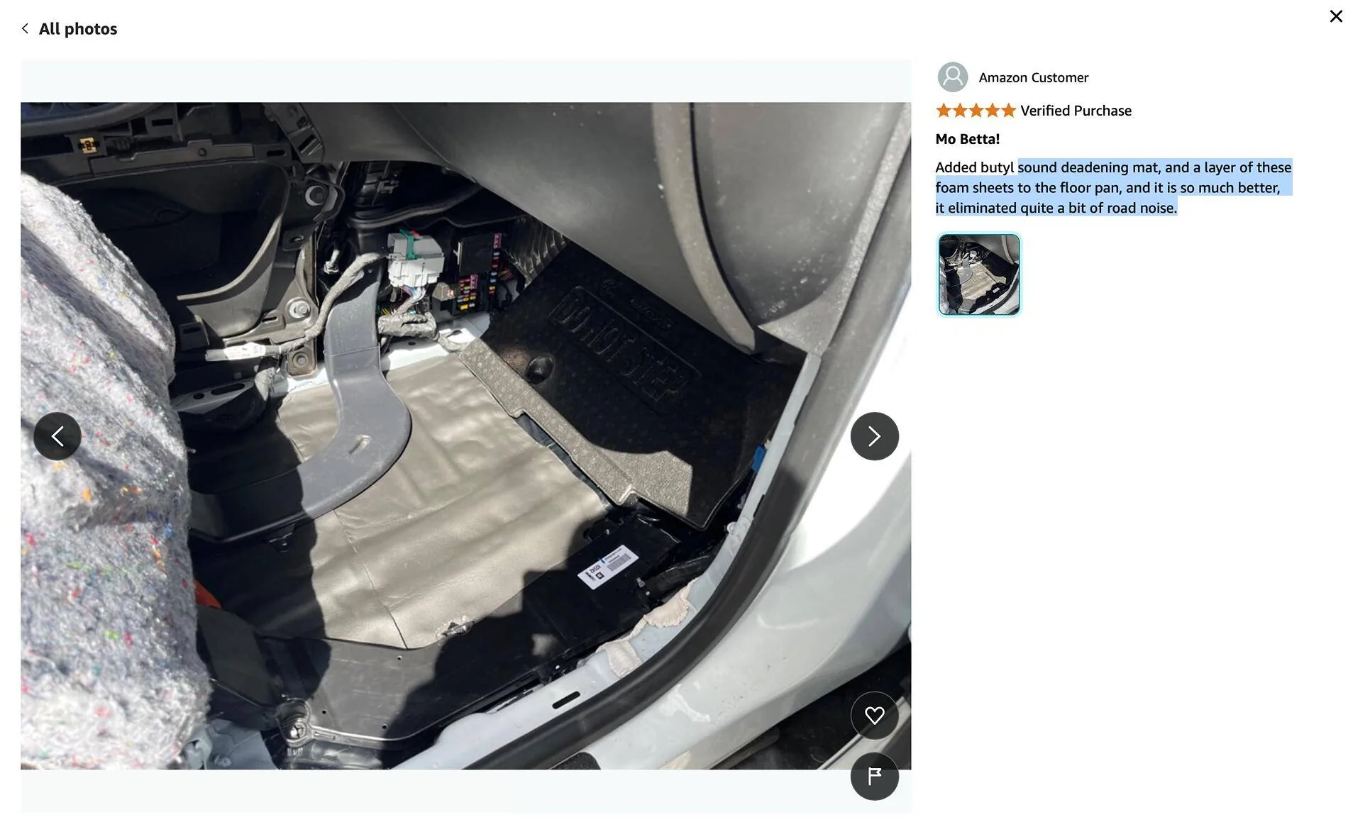

11th Gen Honda Civic Sound Deadening Project tempImagemPza3M
11th Gen Honda Civic Sound Deadening Project tempImageRtG6Z6
Here's a guy that did his entire floor, and didn't get much in results. He hasn't done the doors and wheel wells.

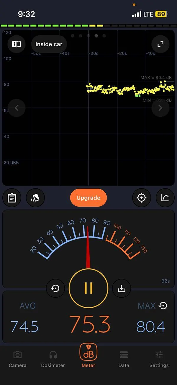

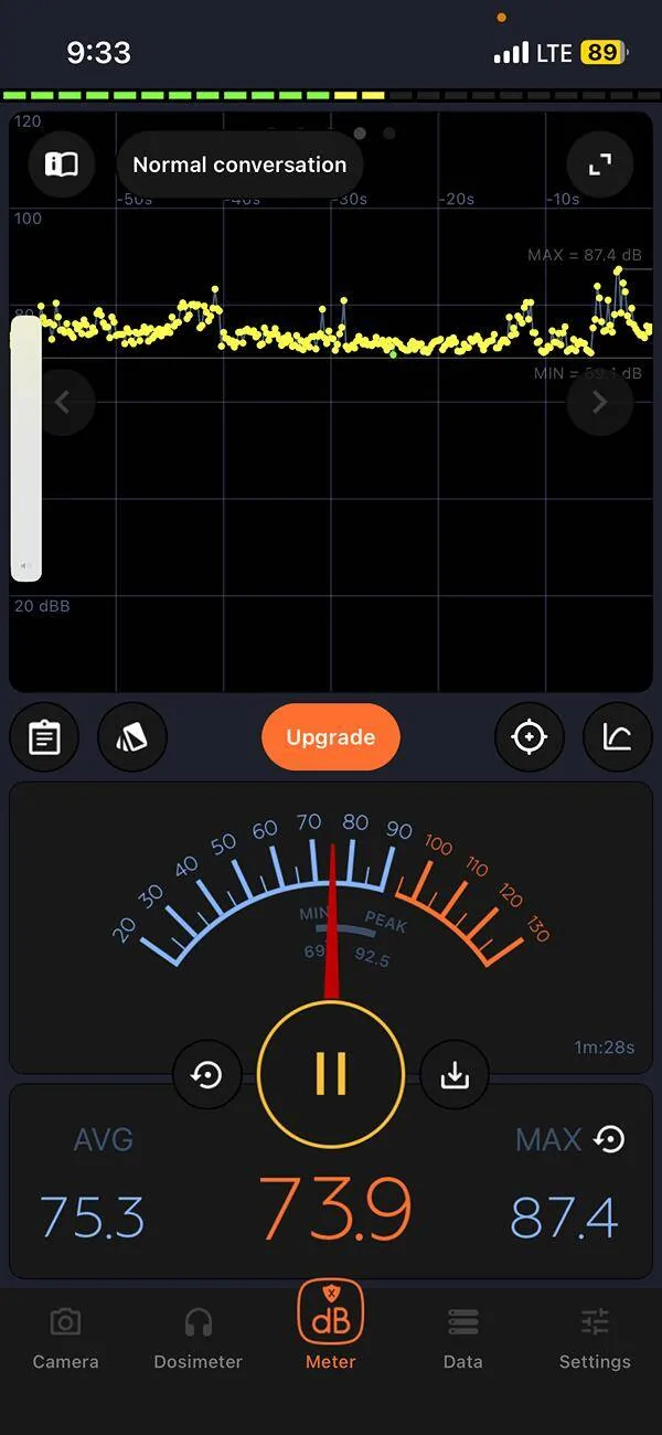

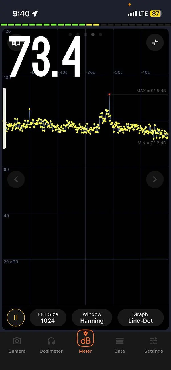

Just took an Uber to the airport, 2024 Tesla model 3 very quiet, very little tire noise, driving on a newly paved like glass road at 65mph — and as a baseline on my drive these are on my same iPhone 13mini—
11th Gen Honda Civic Sound Deadening Project IMG_1755
11th Gen Honda Civic Sound Deadening Project IMG_1754
11th Gen Honda Civic Sound Deadening Project IMG_1758
I’m getting these results.

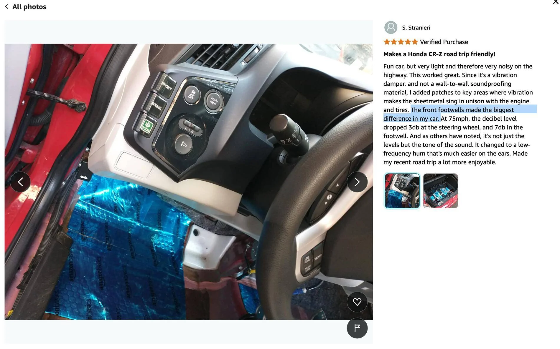

Looks like someone else in a honda CR-Z deadened front foot wells and got excellent results. 7 DB in the foot well is a lot!
