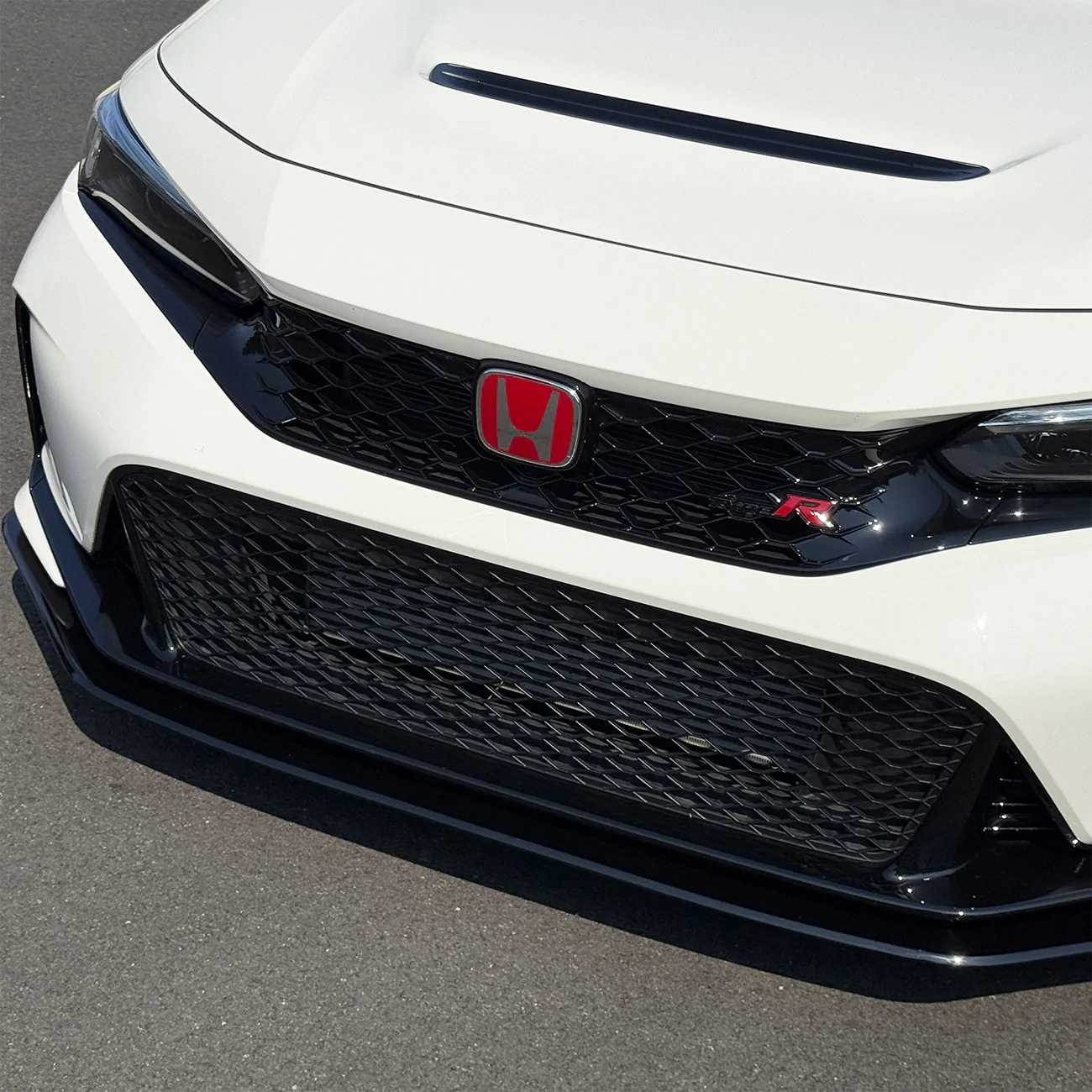

Just want to give a shout out to CTR for sending the STRIX kit a while back.
I was finally able to install my project aero lip and it went fairly easily with the help of this upgraded hardware kit.
Highly recommend both the product and the service I received. Top notch.

Can confirm. Used this kit and it not only made the install easy, but the hardware is much higher quality than the stuff that came from Project Aero.

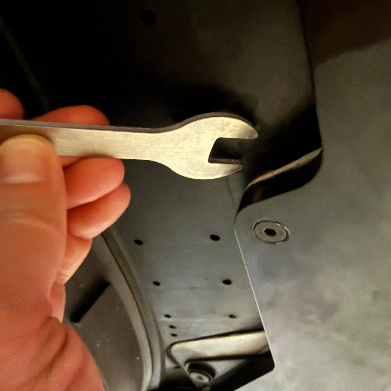

okay today I got the Strix hardware kit. Very fast shipping. Got lucky and kit came a day earlier than expected via USPS. I see now why people would have a hard time installing with the original hardware from Project Aero. Some areas can get pretty tight to fit your arm in. It's still a little tight for the bolt by the washer fluid tank but doable through the fender well. The Strix kit made life easier for sure. I can see why the Track hardware some people would want for a more stiff attachment but then it's pretty much same hard install as the original PA hardware. From what I can tell not going with the track hardware and using the flat wide washer/nut the splitter felt plenty stiff with a little flex/give for my daily/canyon use.
I now also recommend people get the Strix hardware kit along with their Project Aero splitter.
I also recommend have a friend help you to make things even easier.
