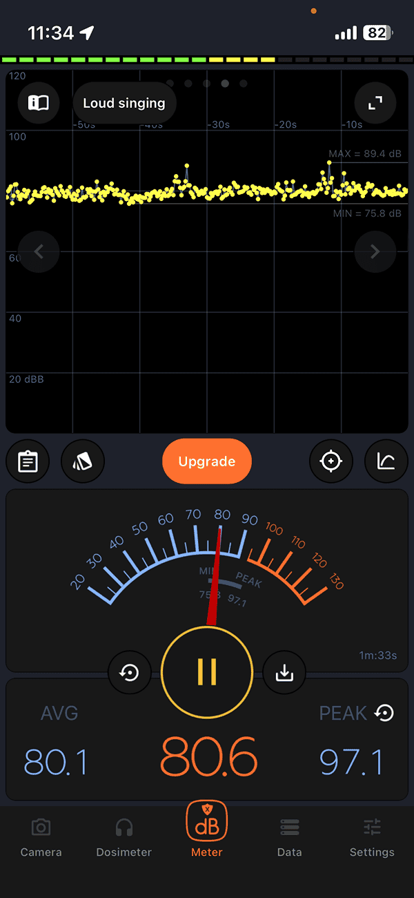

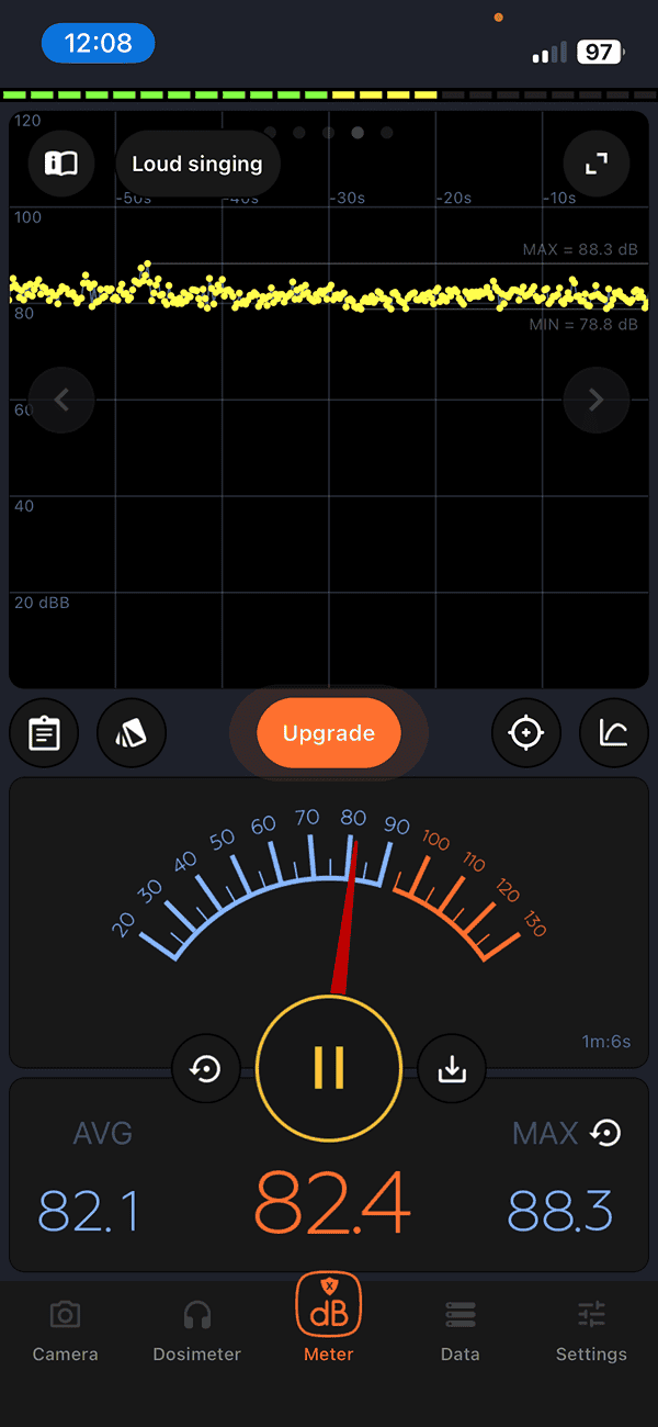

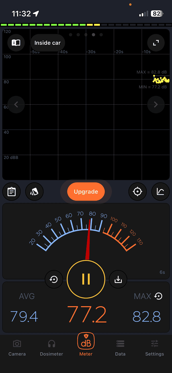

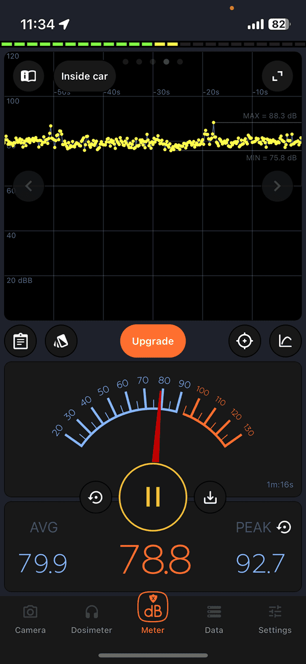

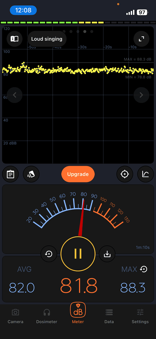

Here is some more data I collected on the way to Laguna Seca.
1) Driving at 75mph on a good road surface.
11th Gen Honda Civic Sound Deadening Project IMG_1511
2) Driving at 75mph on an excellent road surface like glass.
11th Gen Honda Civic Sound Deadening Project IMG_1508
Attached few more data points all at 75
11th Gen Honda Civic Sound Deadening Project IMG_1510
11th Gen Honda Civic Sound Deadening Project IMG_1509
11th Gen Honda Civic Sound Deadening Project IMG_1507
johnloov
John
Jul 9, 2024
383
391
I’m not very sure how accurate the iPhone decibel meter is in how much of the real story it is portraying. When my wife got in the car, she said it was much quieter and now she can only hear noise from under our feet.
Also Harry’s garage when he does Car reviews he takes decibel meter readings and you can hear the car inside is very loud but his meter shows 75 dB. Remarks how the interior is very noisy.
Conclusion is the car is much quieter and the decimeter seems not to show a true representation of noise on the iPhone application.
I may do the floors next…. Why not…. The car is feeling more solid to drive.

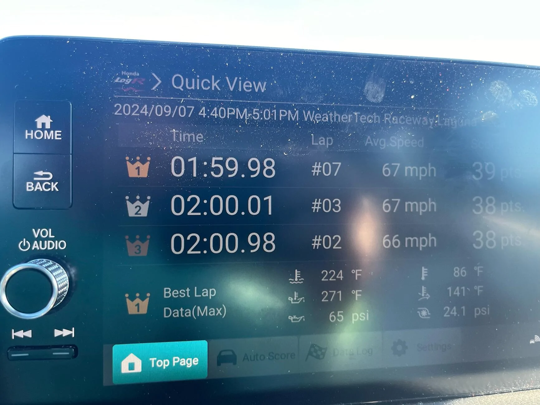

Had a fantastic day on Laguna Seca. The car was extremely stable. I ran in the Type R mode, nannies on, but for sure the car was not bouncing around at all like it used to in Type R mode.
Ran a 1 min 59, which was my fastest time, without cooking the brakes ( could have shaved at least 5 seconds easy with harder braking ) and the helmet does dampen noises quite a bit. Stock Type R brakes, suspension. One of the instructors told me, if I add like 100 lbs to the car, I'm only going to loose 1/10th of a second. So... I'm thinking of also dampening the floors next.

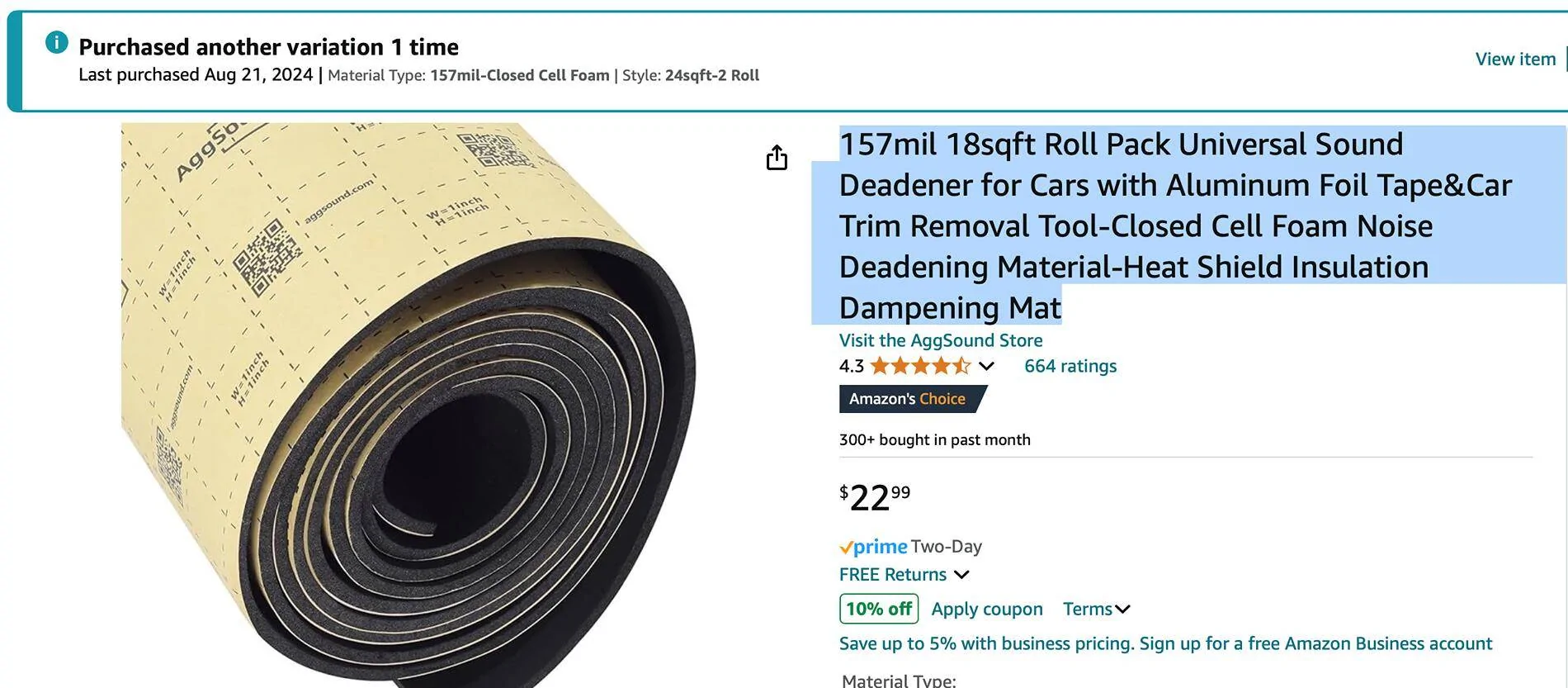

2) AuggSound 157 Mil Close Cell Foam - I used this over the wheel wells, and it was excellent and sticks very well and is very light/thin enough to fit in close tolerance sections.
I'll add this layer on top of the Amazon basics.
157mil 18sqft Roll Pack Universal Sound Deadener for Cars with Aluminum Foil Tape&Car Trim Removal Tool-Closed Cell Foam Noise Deadening Material-Heat Shield Insulation Dampening Mat

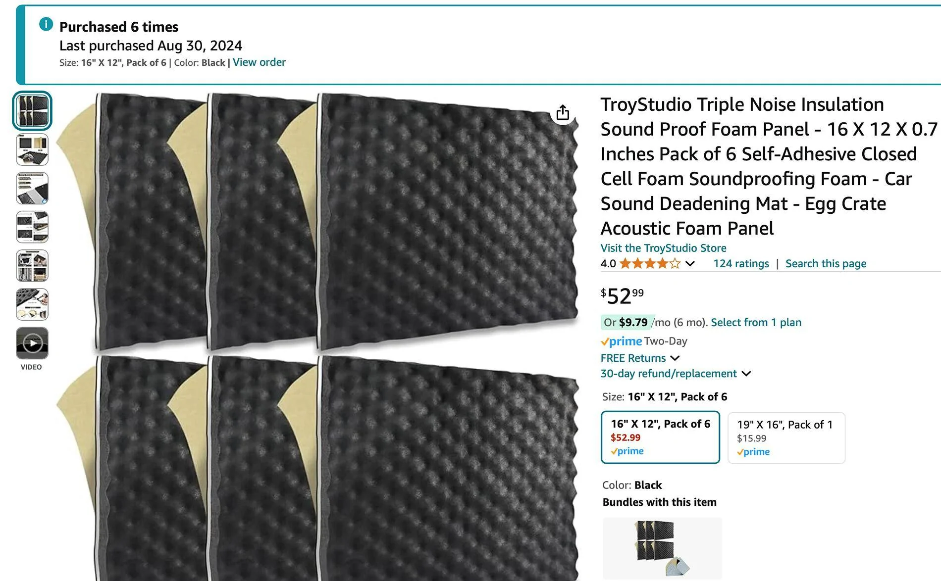

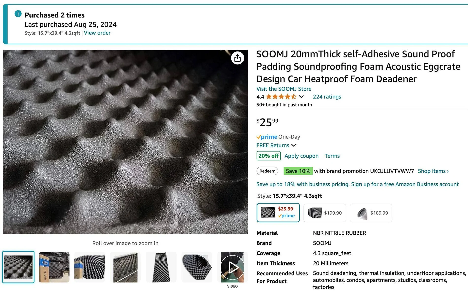

3) In Sections I have more space, I'll use Acoustic foam, with dampener built in and without. If possible stuff the one with dampener closer to the firewall.
11th Gen Honda Civic Sound Deadening Project Screenshot 2024-09-09 at 3.35.53 PM
11th Gen Honda Civic Sound Deadening Project Screenshot 2024-09-09 at 3.35.23 PM

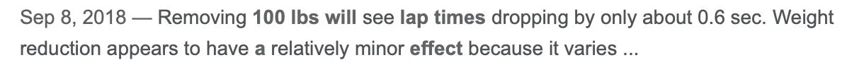

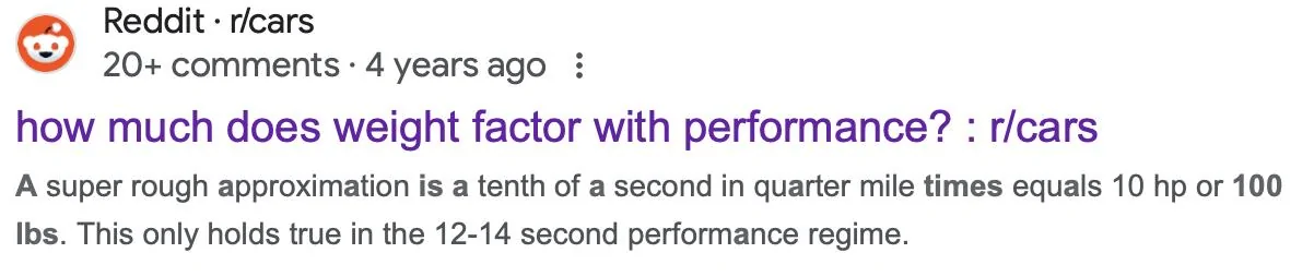

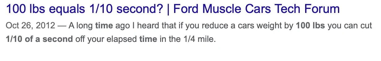

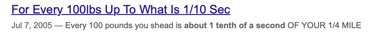

Supposedly 100 lbs of extra weight is about 1/10 of second around Laguna Seca according to my instructor. Not too worried :)
11th Gen Honda Civic Sound Deadening Project Screenshot 2024-09-09 at 4.20.52 PM
11th Gen Honda Civic Sound Deadening Project Screenshot 2024-09-09 at 4.20.41 PM
11th Gen Honda Civic Sound Deadening Project Screenshot 2024-09-09 at 4.19.48 PM
11th Gen Honda Civic Sound Deadening Project Screenshot 2024-09-09 at 4.19.33 PM

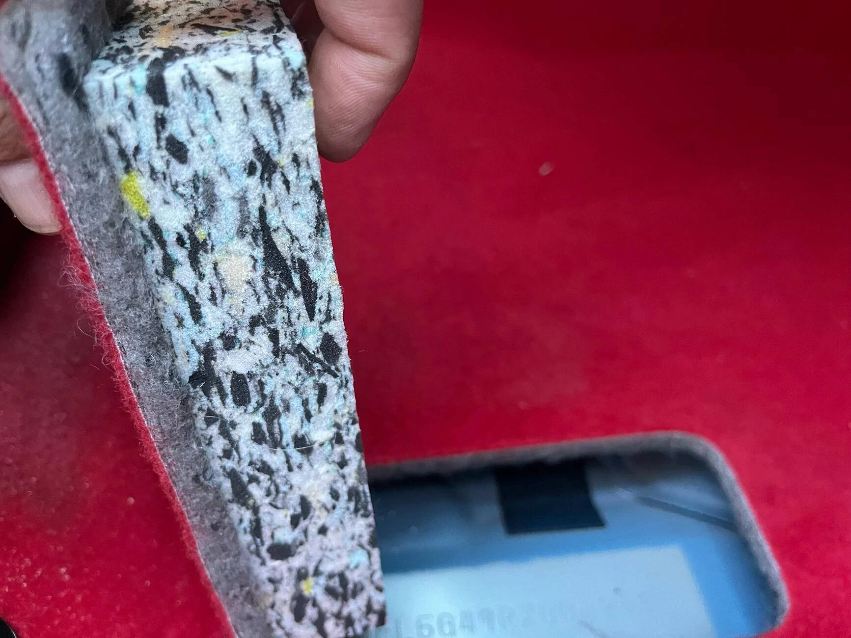

Looks like my wife was right.

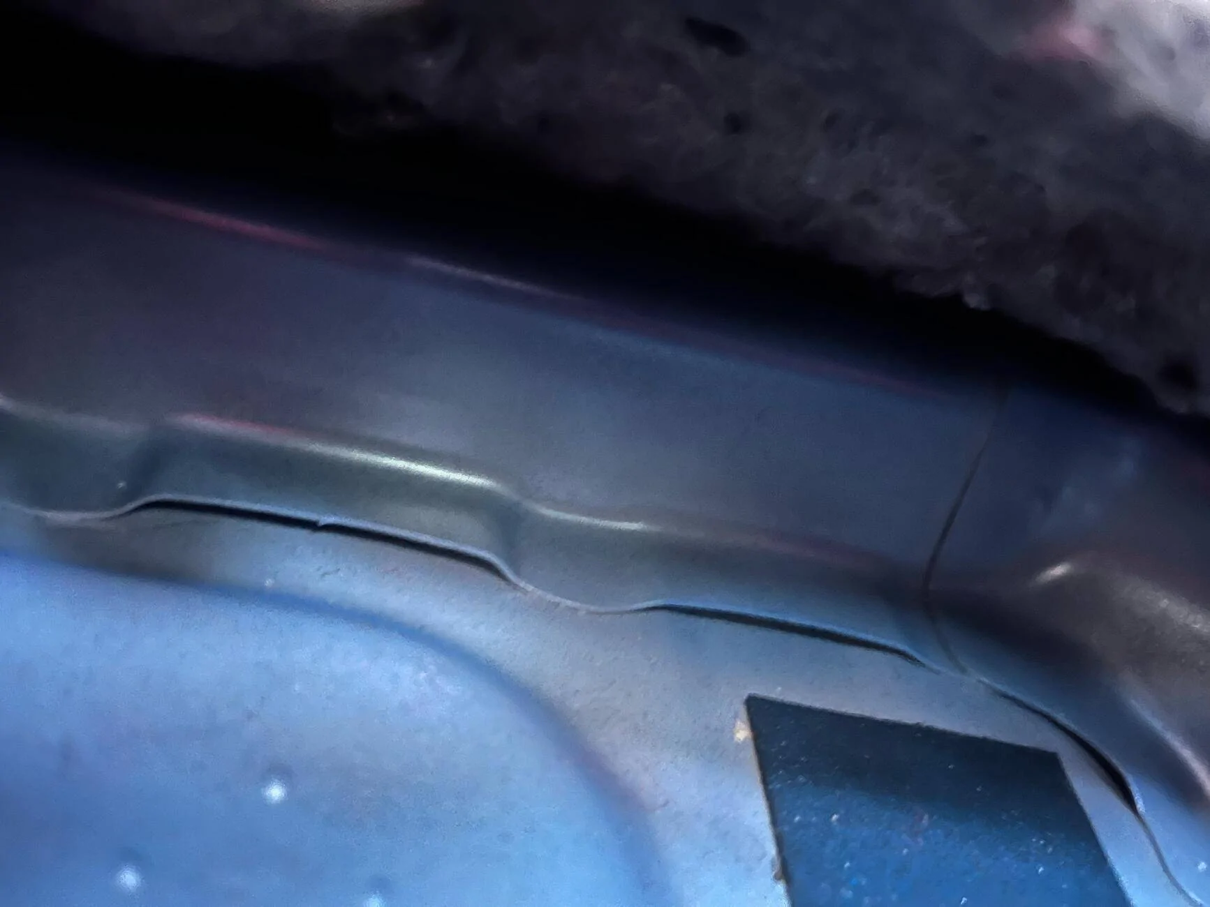

There is quite a bit of road noise coming from the floor, and it seems Honda did put sound absorption material attached to the underside of the carpet. They put even way more in this rectangle door/hatch which reveals the chassis VIN number.
I removed the passenger side cut away, just to see while on the highway the amount of road noise under the floor carpet, and yes it's louder.
As soon as I removed this rectangle cut out, it got louder in the cabin.
When you knock on this metal, it also sounds like a tin can.
I think amazon dampening + a layer of acoustic
11th Gen Honda Civic Sound Deadening Project tempImager7fzx7
11th Gen Honda Civic Sound Deadening Project tempImagebyAD9t
foam will do the trick.

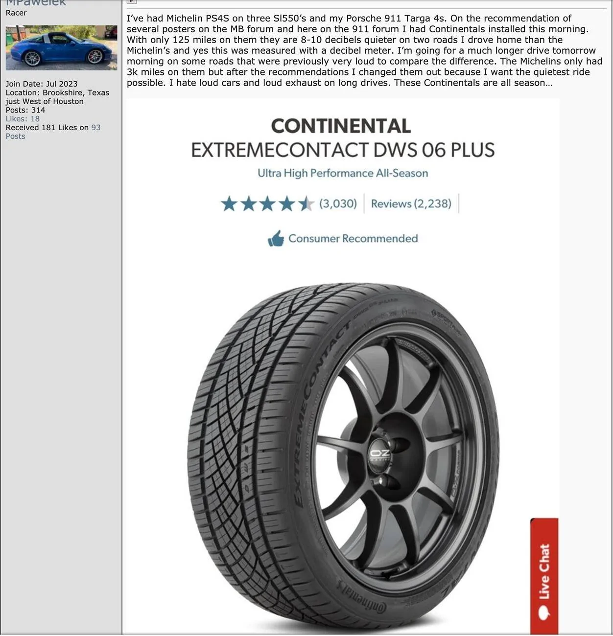

I have driven both the new 992 Carrera/ Carrera S and Cayman S, all equipped with the same Michelin Pilot 4s's we have, and they were also extremely loud inside. Actually much louder than the type R.... I couldn't take it..
I was registering 86-89+ decibels on my test drives of those cars. ... Same as Harry's Garage and he tested both the 992 Carrera and Carrera S.
He thought the smaller wheels would help with road noise on the base Carrera, but still those Michelin P4s's create a crazy amount of road noise into the cabin.
Looks like other's have also experienced this in other cars..
11th Gen Honda Civic Sound Deadening Project Screenshot 2024-09-09 at 9.28.50 PM
After deadening the floors,
This maybe the next....
