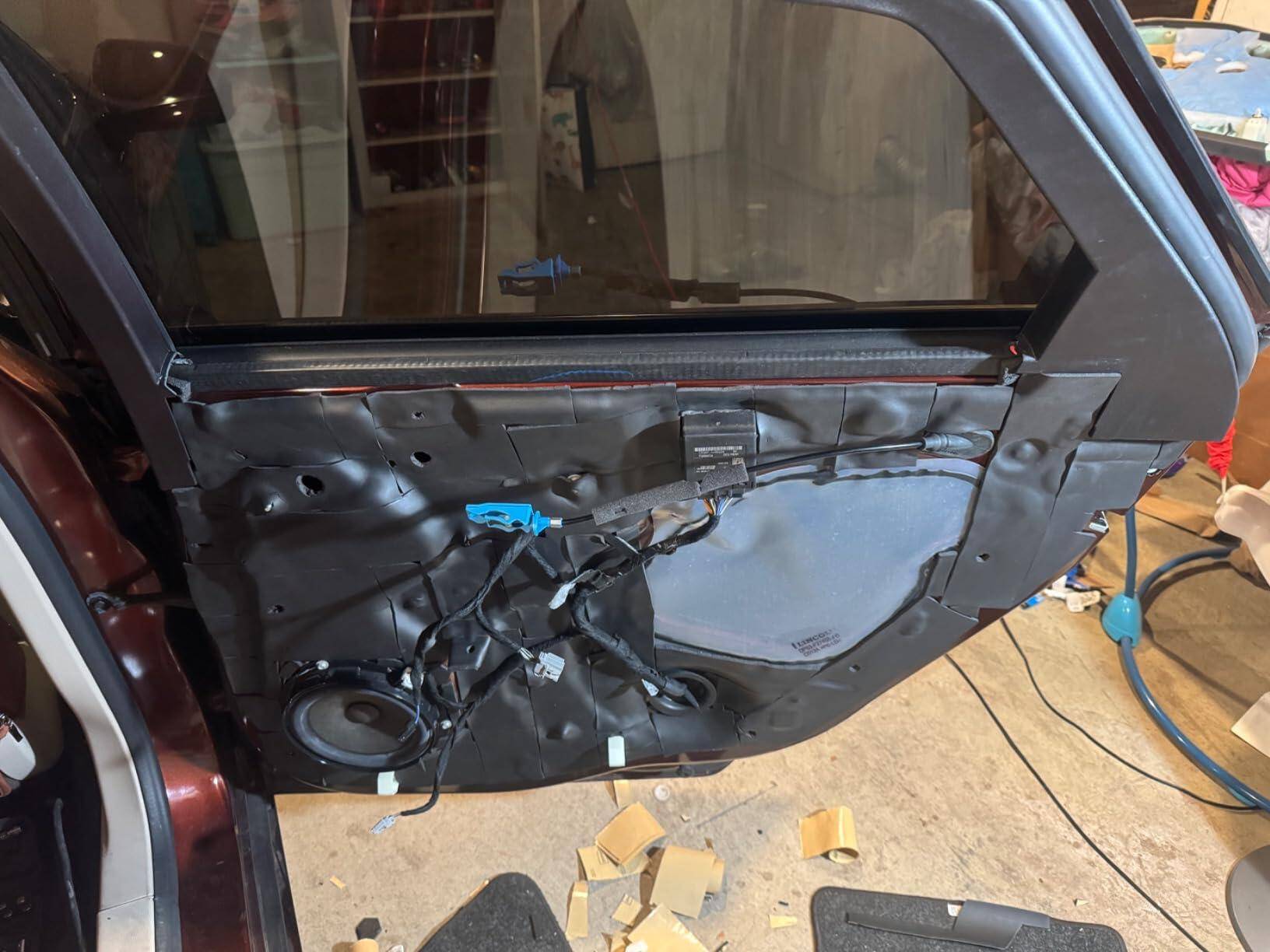

2nd) Do the doors. Next easiest, but maybe you can simply get away with closing off the inner doors with this 4mm close cell foam.
This is probably worth a shot, if you can simply seal this sound off on the inside of the door, you'll save yourself a lot of time and really no weight will be added to the door. This 4mm stuff is very thin and effective. I would apply it over the entire inside of the door, and over the water membrane.
This is very fast to do, maybe 1 hour, and you can always go back, if it's not enough sound dampening and spend 10x more time/effort to do everything inside the door. I have a feeling, it will perform well if you do something similar to this picture below but cover the entire inside of the door. This material also compresses easy, so you can easily get the door on. Even if you cover the holes, the door will pop on right over it, and the pins will go straight through. Again, I wish I used this instead of the egg crate foam. It was much easier to work with. You can use a single layer on the inside doors, and if you do want to amazon deaden and dampen the body panel, then cover it with 2 layers of this 4mm, but again I think it's worth just trying to get away with a single layer, like this photo below... And use amazon deadener and a double layer of this 4mm closed cell foam, 8mm, on the trunk, wheel wells 4mm 1 layer, 8mm every where else you can.

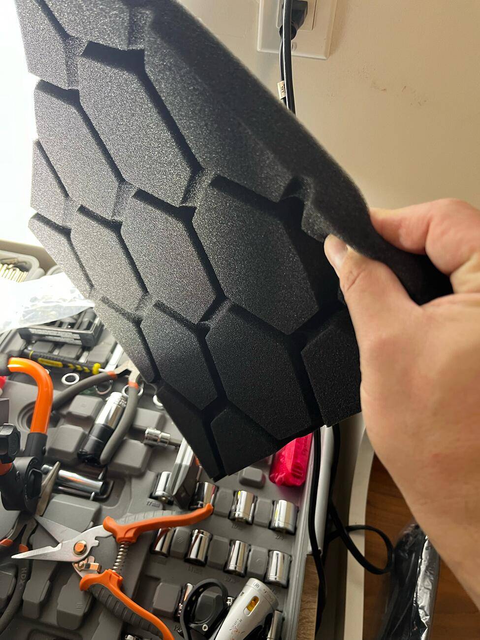

Something like this -

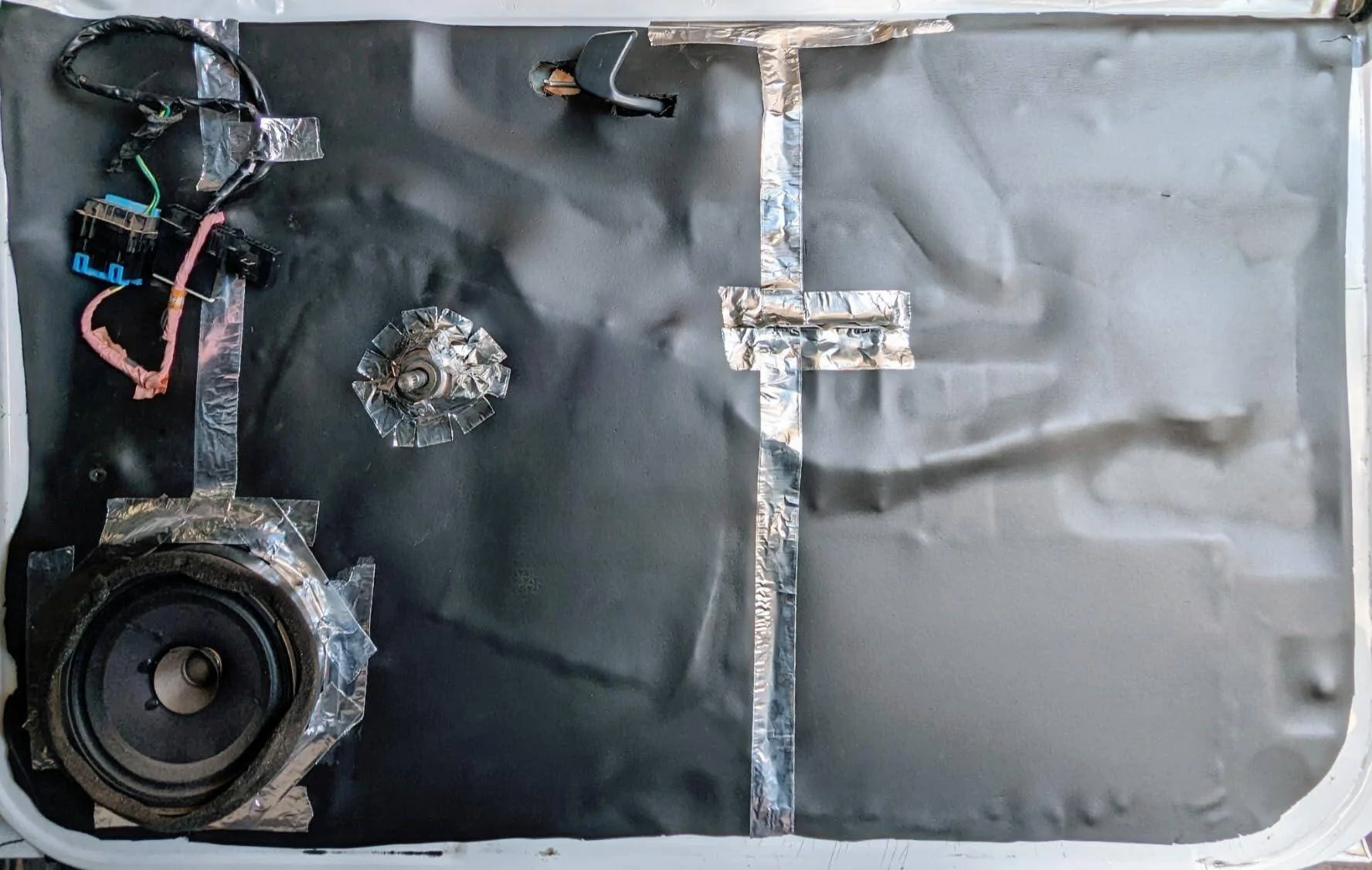

I did the inside of the doors, as I recommended it, and it also helped, and it maybe all you need.
I had done the body panel of doors, which took a lot of work, and really went all out with the Amazon deadener and Egg Crate foam on the outside facing door panel, but I went back and since I had more of this 4mm material I put in on the inside of the door -- it helped additional reduce road noise. My doors are now over over kill.
I did notice now after putting this 4mm foam on the inside, my base response from door speakers improved as well. The stereo sounded amazing before I just did this, but now it's at another level. I disabled speed volume increase as the sound is so well insulated, on the highway, I don't need to turn up the volume at al.
If you're looking for the fastest hack, and don't want to add any weight. I would simply just pop off the doors, and cover the inside like this, then do the trunk and wheel wells.

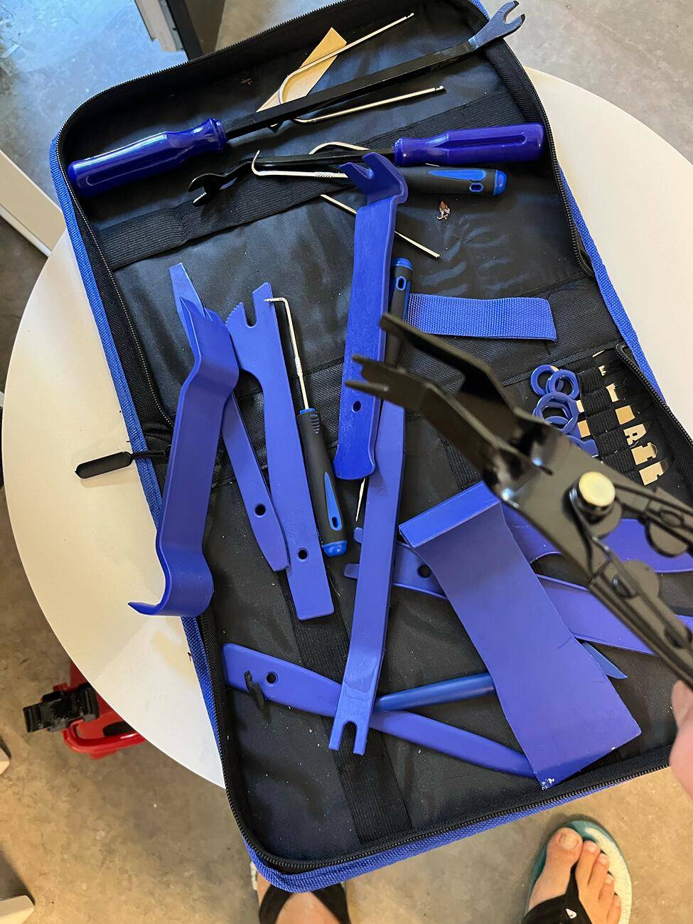

1) For sure get the amazon panel removal kit. I used many of the tools there and it helped tremendously
2) Just do the inside of the doors first with this 4mm foam, takes 1 hour total for all doors. It will seal off a lot of the sound. Now I'm thinking, maybe I didn't need to dampen or sound proof the body panel, if you can cut off the sound entering from the door.
3) Trunk and interior rear wheel wheel. Again seal it.

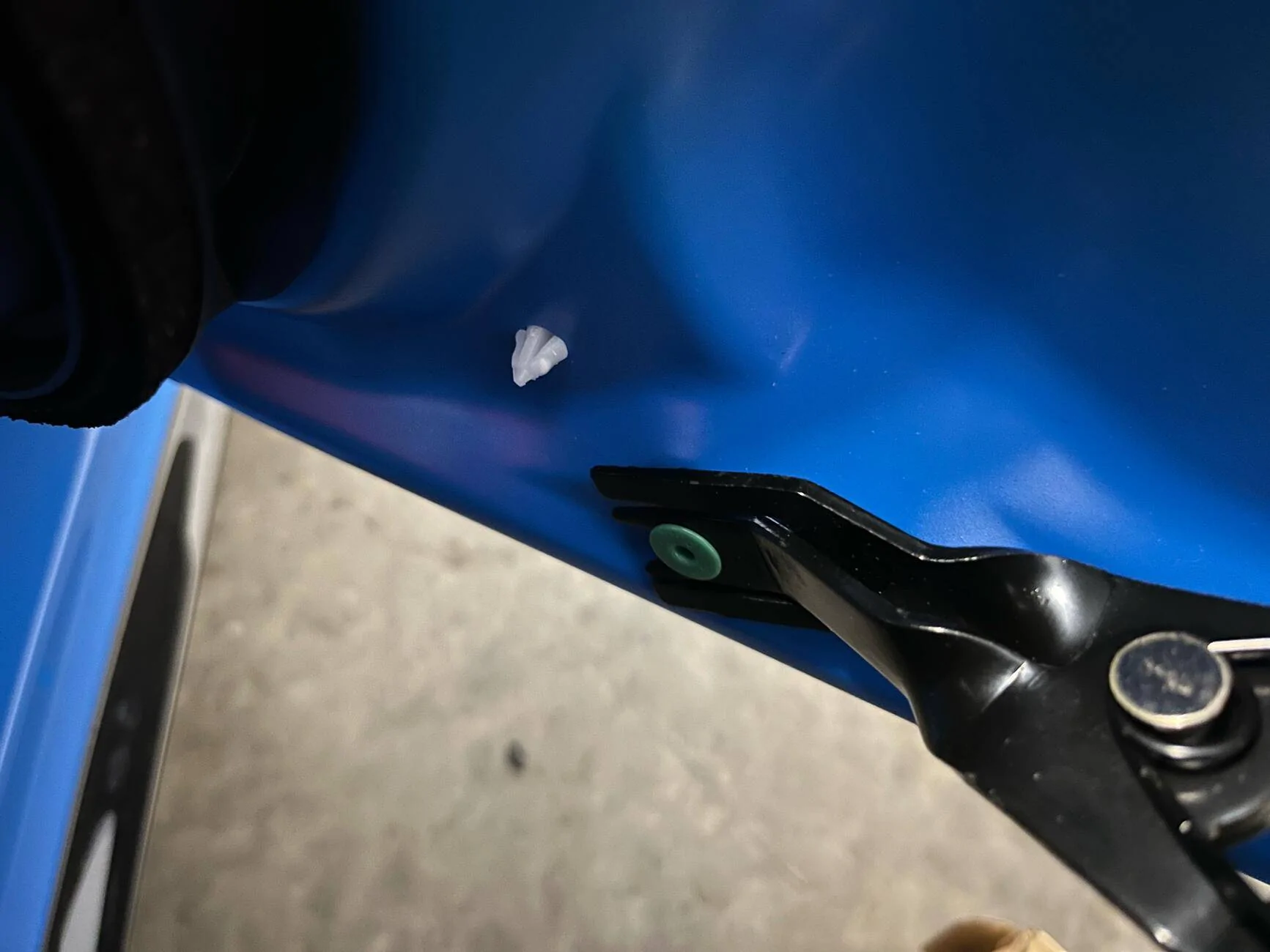

Panel Kit Tools are important makes life easy when clips don't come off

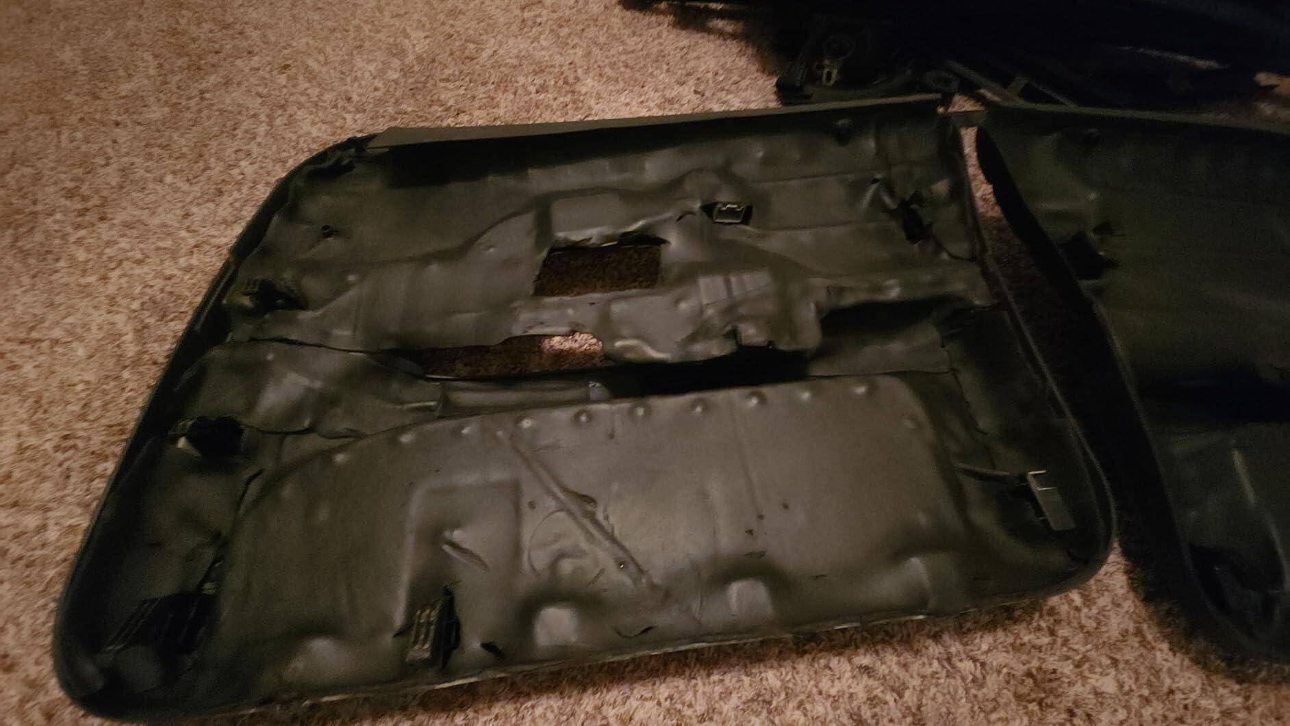

11th Gen Honda Civic Sound Deadening Project tempImagebJKdwt
This is open cell foam. I under every window controller and I used it in the rear trunk by the air pressure release. This captures sound.
11th Gen Honda Civic Sound Deadening Project tempImagefo28IH
This worked very very well. I just did it, Maybe it was over kill to do the body panel under here.

Tools are very helpful. A must.
11th Gen Honda Civic Sound Deadening Project tempImaget4BYRZ

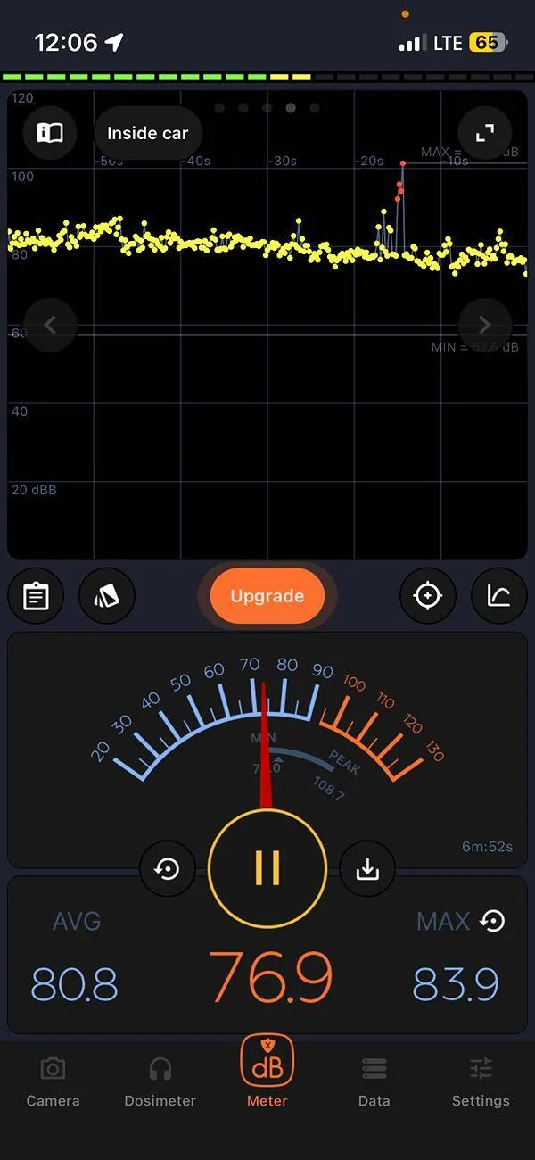

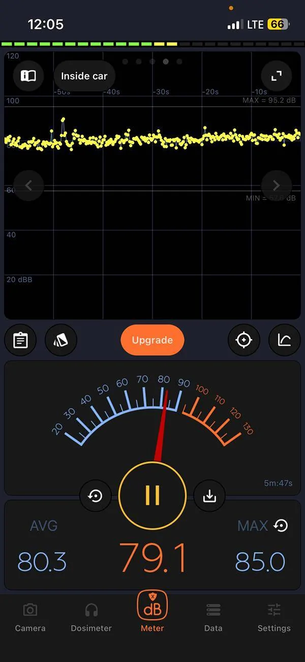

This is at 55mph.
11th Gen Honda Civic Sound Deadening Project IMG_2129
This is at 65mph on 8/10 road highway.
11th Gen Honda Civic Sound Deadening Project IMG_2128
Open Cell Foam.
11th Gen Honda Civic Sound Deadening Project tempImageG1meHV

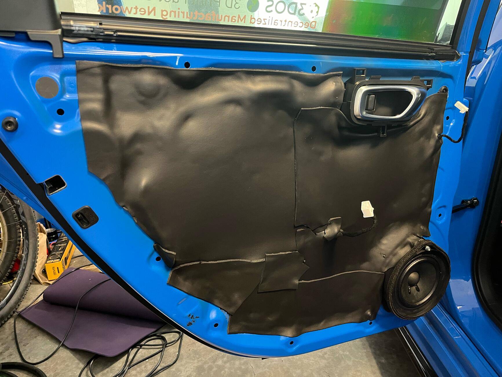

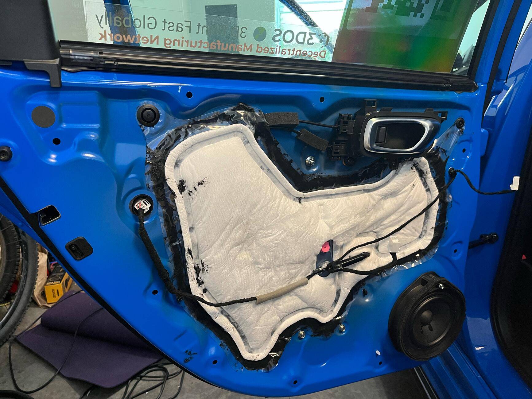

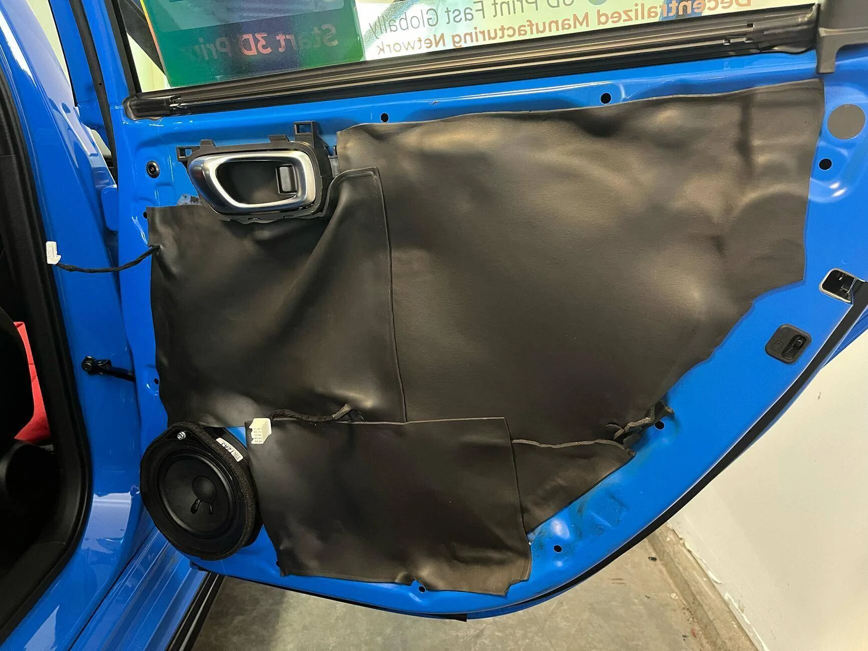

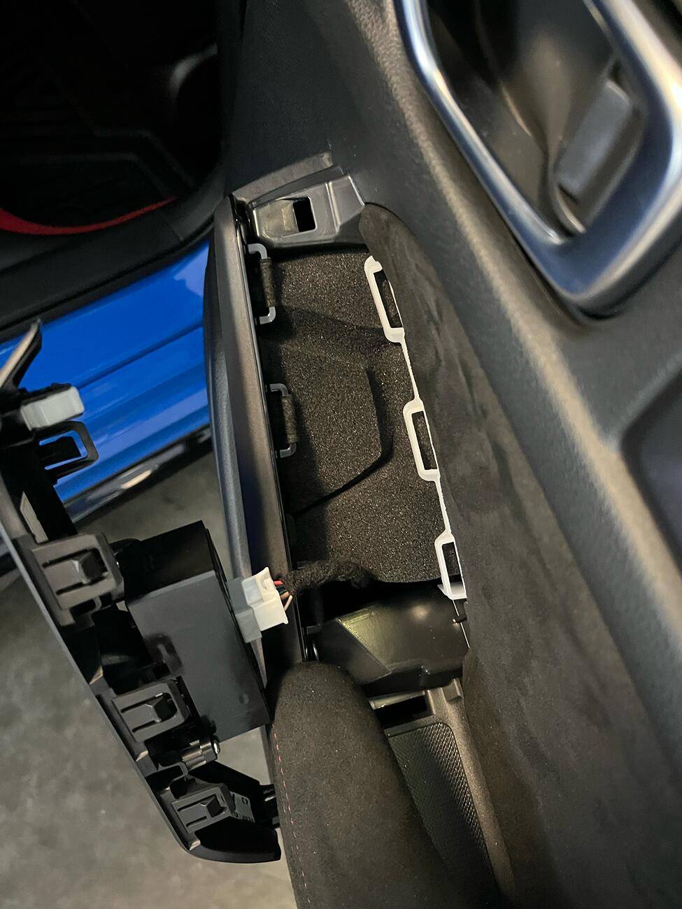

4mm foam sealed door
11th Gen Honda Civic Sound Deadening Project tempImagerIK5nU
I had kept this stock, because behind here is the entire outside door panel Amazon Deadened and Egg Crate foam sound insulation. I did notice this did help when I covered it. I would do this first, and maybe that's all you need for the doors.

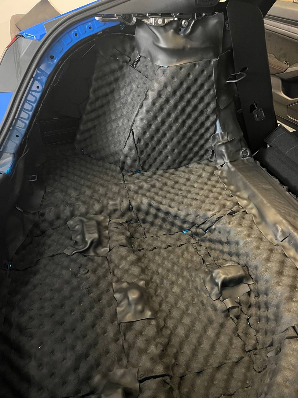

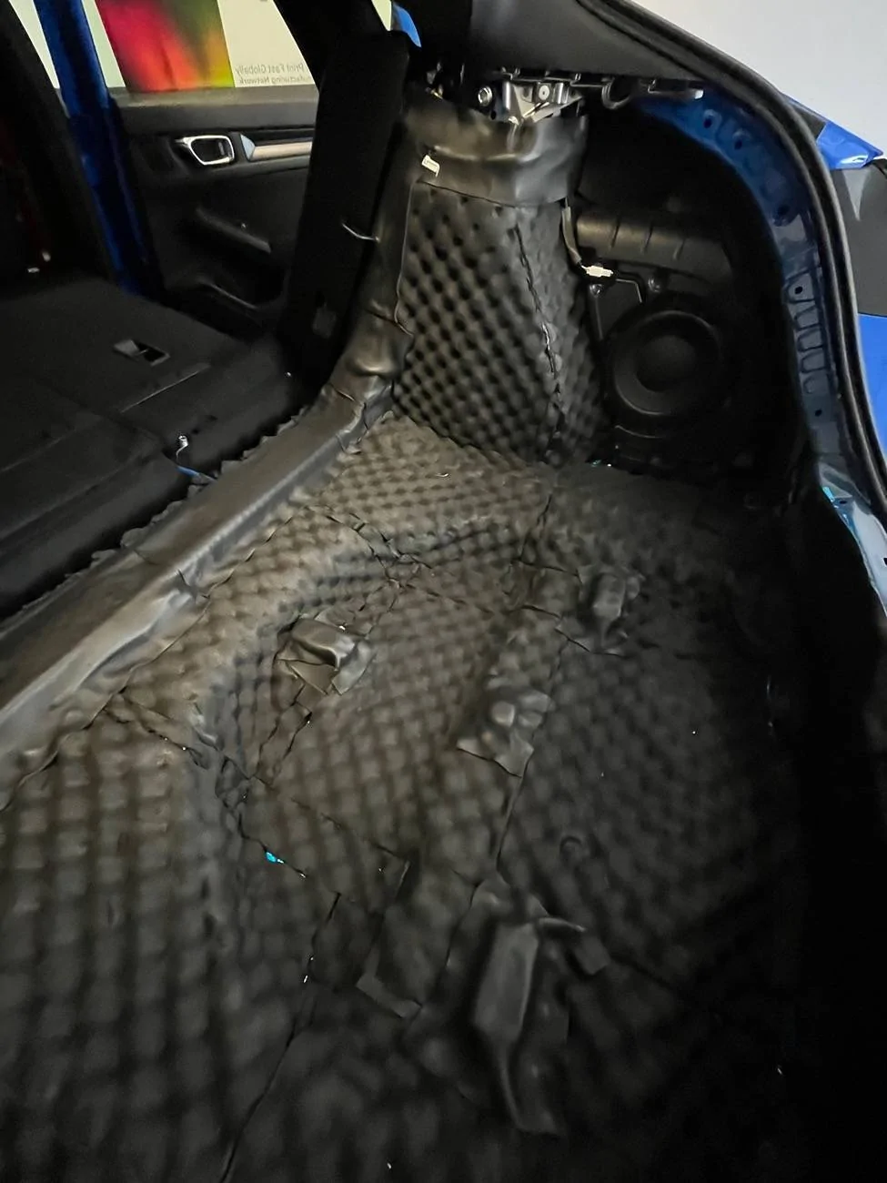

Went back and completed blanketed areas in trunk with the 4mm in areas I had missed the egg crate foam didn’t fit.
project is probably done - maybe will try to find a type s stock hood sound insulation see if it fits

When I went into the Trunk, I realized FULL BLANKETCOVERAGE is key. Even the trunk area that has some metal showing, just transmitted sound, and today I noticed again it's even better.
BLANKET THE SOUND! Seal the sound out! That's the goal ;) This stuff is super light. If you get more expensive stuff, and can't fully blanket the sound, sound will just travel right around it, and now your project is close to useless.
