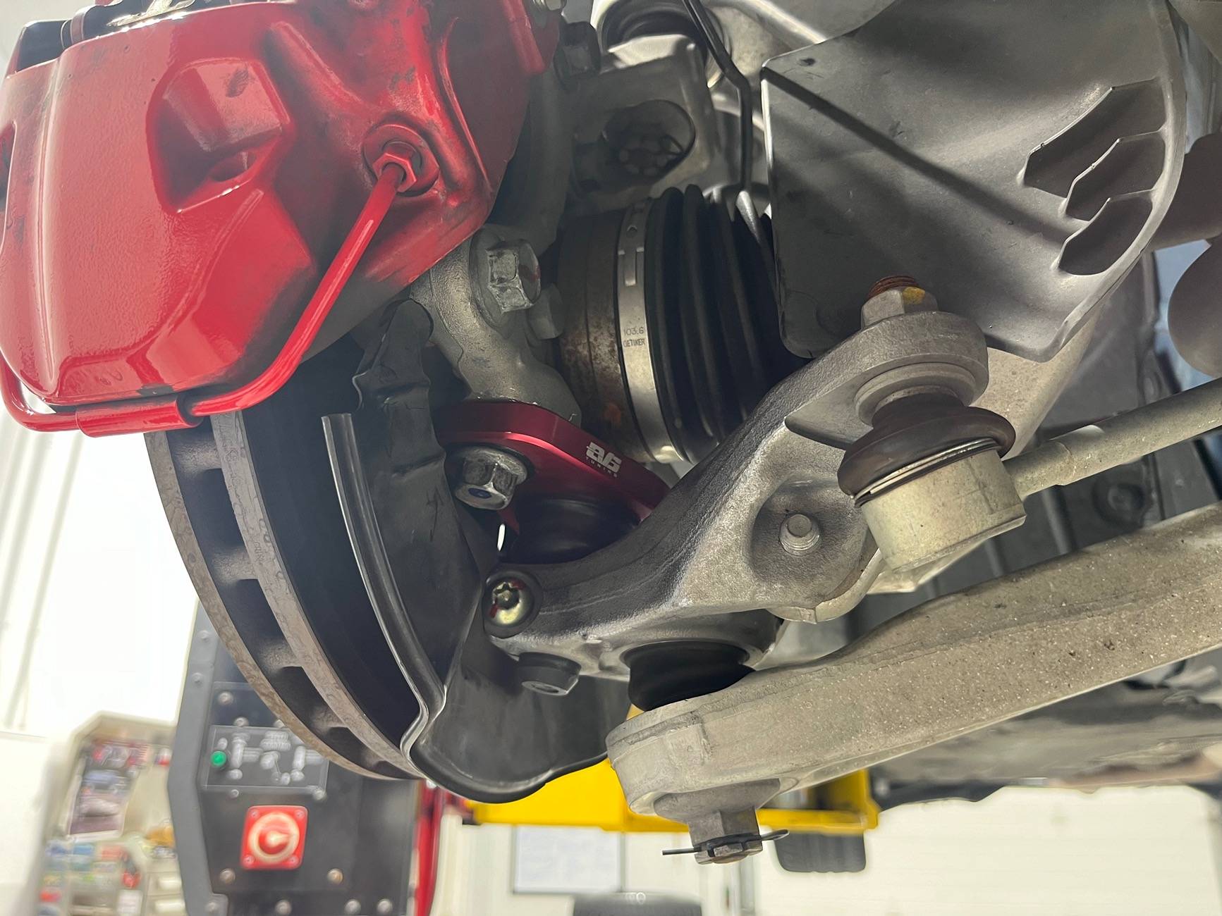

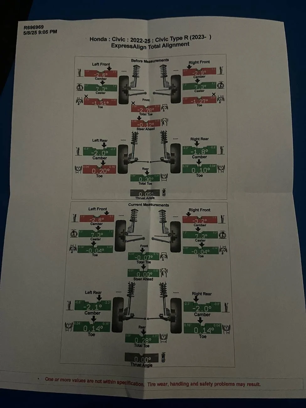

Quick update, drove from Dallas to Austin maybe longest road trip I’ve ever had, on cup 2s and zero tinnitus. The roads are much rougher here and I thought for sure it was gonna be too too much but actually the sound insulation worked really well.
another massive bonus was that the car seems to stay cooler in the hot sun because the doors are so insulated.
Also, I’m not really seeing any weight penalty. The only production cars that did a lot better at COTA circuit of the America, were the GT3 RS and GT4 RS. Type R did insanely well.
I thought these camber plates - ball joints to help camber would increase road noise, but luckily they did not.
enjoy your sound
insulation deadening without any regret of weight penalty.

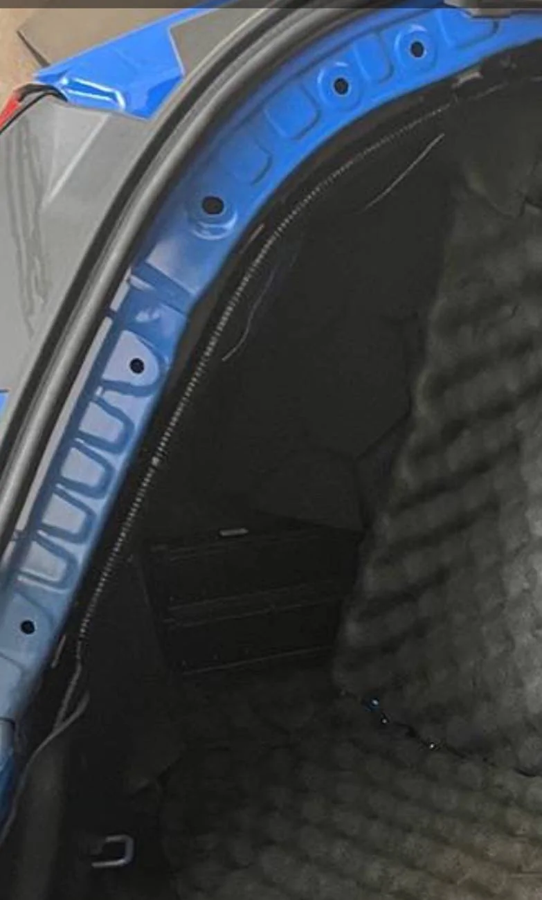

Not sure if I shared this, but you may find it helpful, I deployed similar strategies. The civic also has a flap to allow air pressure to equalize.
I put open cell foam around that flap
