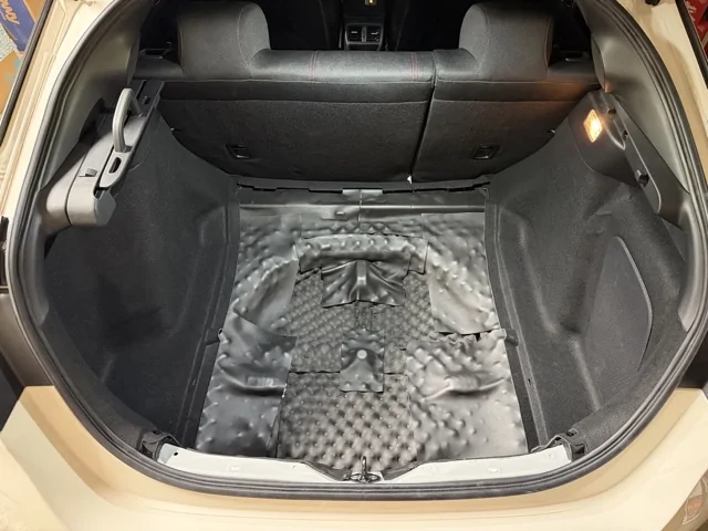

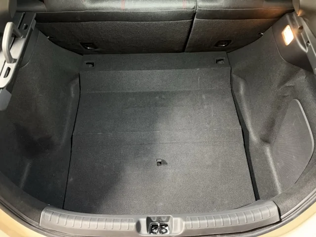

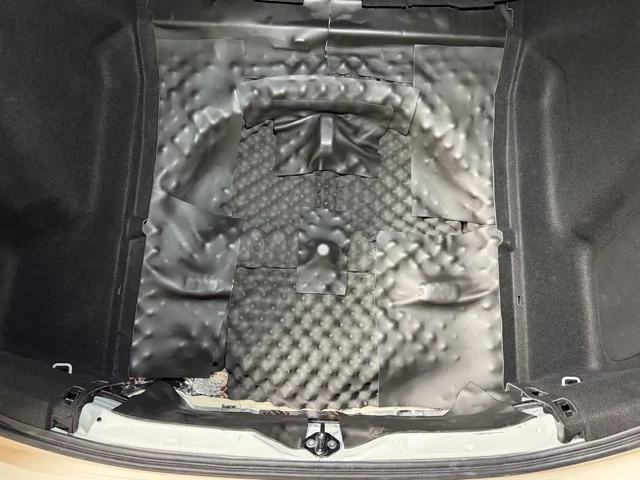

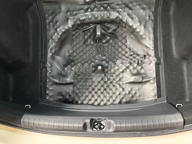

I just did this same project over the weekend. Have only done the trunk area, rear wheel wells inside the cabin, and rear bench. Butyl rubber 80mill killmat nearly everywhere, roughly 90% coverage. Used the eggshell butyl foam layer on top of that, only for trunk and wheel wells. To finish I covered any remaining gaps and the seams of lower foam layers with the 4mm foam layer. Making about 75% coverage with the 4mm foam.
TLDR
Rear Bench seat
  • Killmat - 85% coverage
  • 4mm foam - 100%
Trunk / Wheel arches
  • Killmat - 90%
  • Butyl + Eggshell foam layer 90%
  • 4mm foam - 75%
Incredible results already, and I have not done the doors yet. Super excited to experience what that will be like.
My question to you John-
How did you manage fitment for the plastic cover that goes over the hatch latch?
Also, were you able to maintain fitment for your folding trunk floor to lay within the groves of the trunk?
If you look at my photos, the wheel arch panels are pushed towards the inside, so it is messing with fitment. I believe I used the exact materials you used, aside from the initial butyl layer. I have thought of cutting out some material where the floor level shifts for the trunk floor insert, to let everything rest closer to stock.
Thanks
