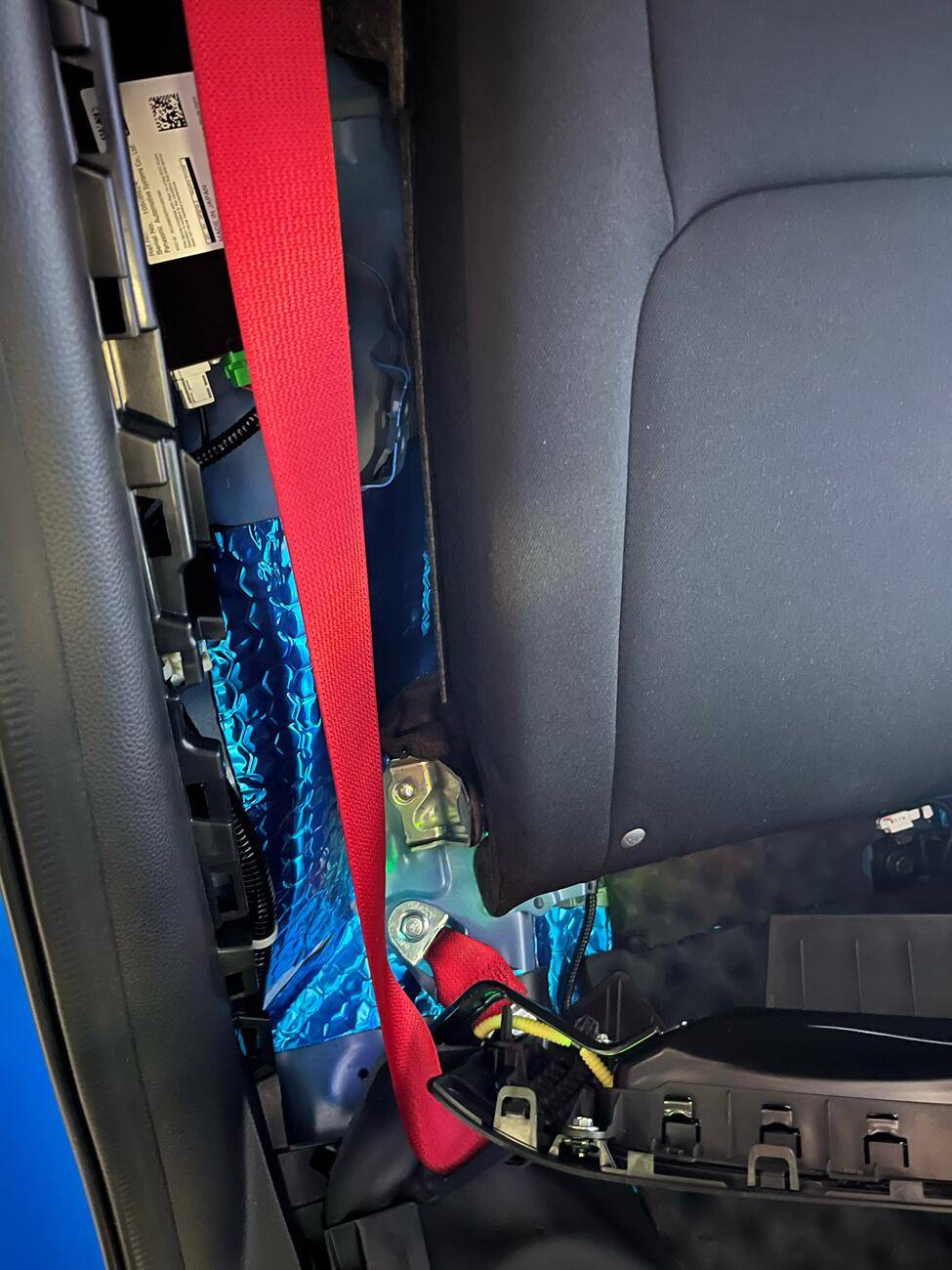

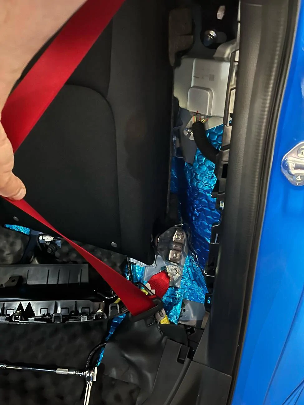

Everything I did was on the inside of the car.
I removed the rear seat bottom (10mm bolt and 2 little from squeeze clips) both side cover/airbags (10mm bolt on each and disconnect the airbag wires) the ”spare tire” well cover (2 Philips screws under the tie down rings [plastic cover folds from front to back]) removed privacy cover unit With the release button. There’s a little tab that uncovers/unclips front to back using a guitar pick. under there‘s (Little Philips) on each side. Then just pushed the hatch seal off a little bit.
removed the plastic hatch latch cover. Just clips. And then the wheel arch/well covers. Super easy. All the clips are all very intuitive feeling. Nothing feels forced or like it’s going to break. Everything had positive and reassuring clicks and pops.
2 hrs total: interior pieces removal, sound deadening material application and reassembly.
Hope this helps.

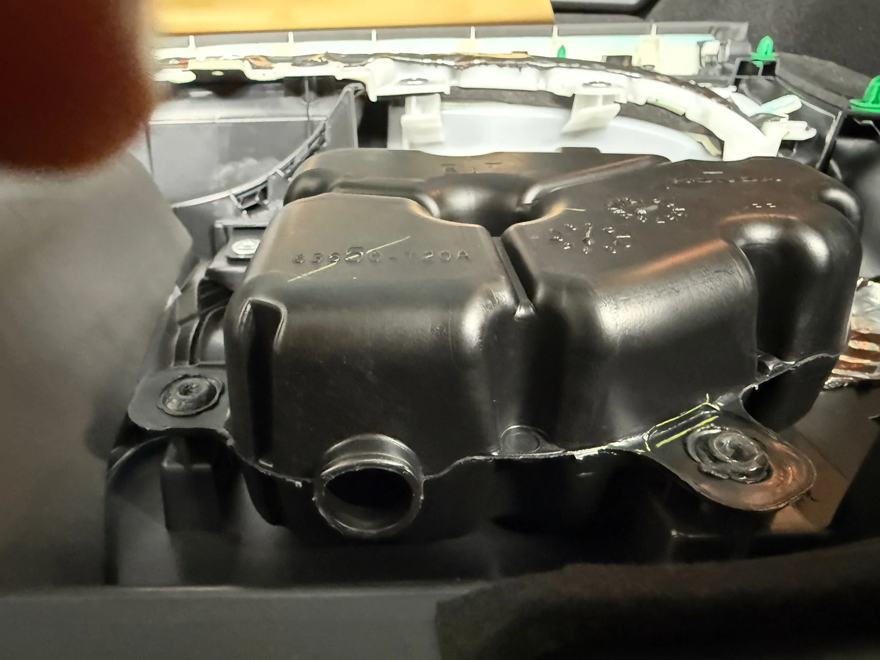

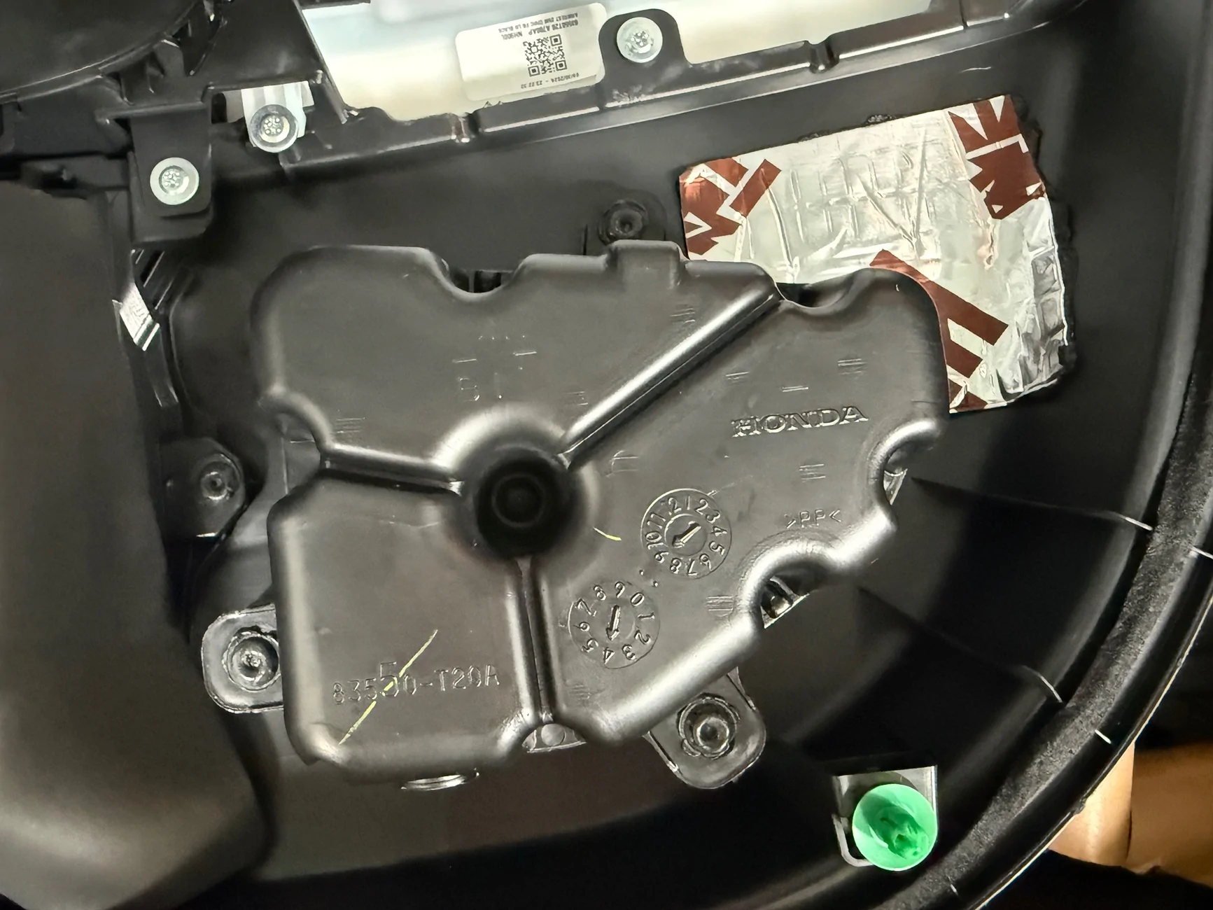

Currently doing this for my ‘25 sport touring hybrid hatch and noticed this peculiar object on my drivers door panel that isn’t there on the type rs! Looks like some type of simple sound control device maybe?

Anyone know what that plastic "tube box" (???) thing is?

Some googling tells me it’s a resonator type device that helps with the sound of the door closing! Now I’m curious is the type r and sport touring hybrid doors sound different when closing!
