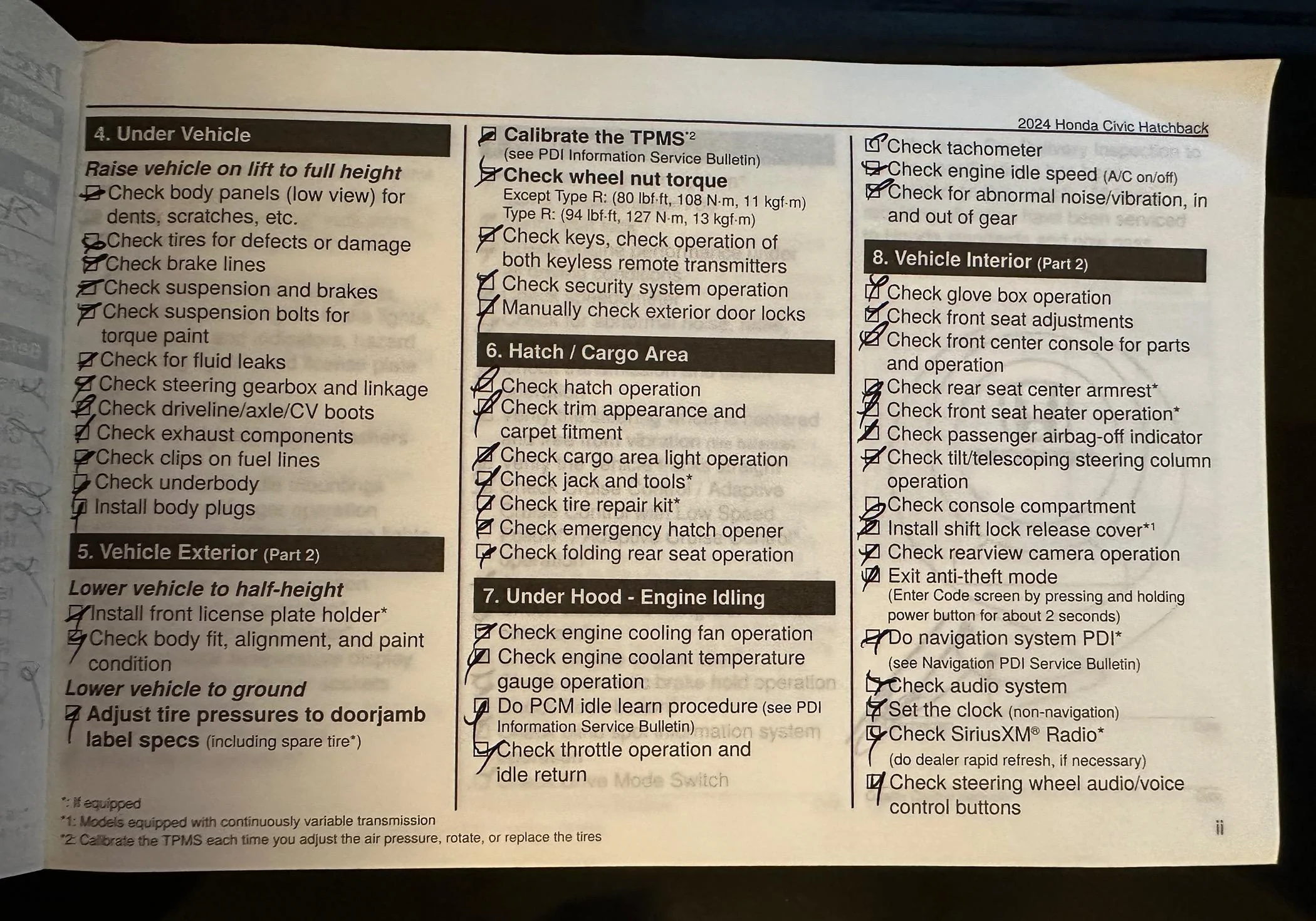

fredzy, I just checked the PDI sheet, and 'Install Body Plugs' was checked off, but then so was 'Set Tire Pressures to Door Recommendation,' and that wasn't done, so who knows? I do know that there were no loose plugs in the glove box, or anywhere else inside the car. Not sure where they would have stashed them if they didn't install them. I don't have access to a lift to get beneath the car and look for them, so I guess I'll have them checked when I bring the car in to get the infotainment/seatbelt buzzing fixed.

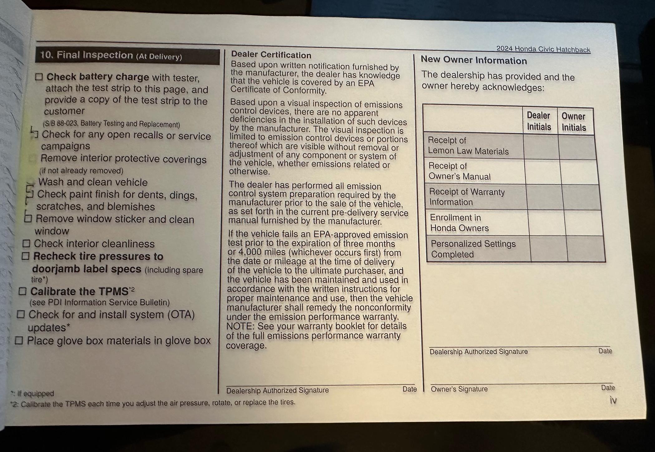

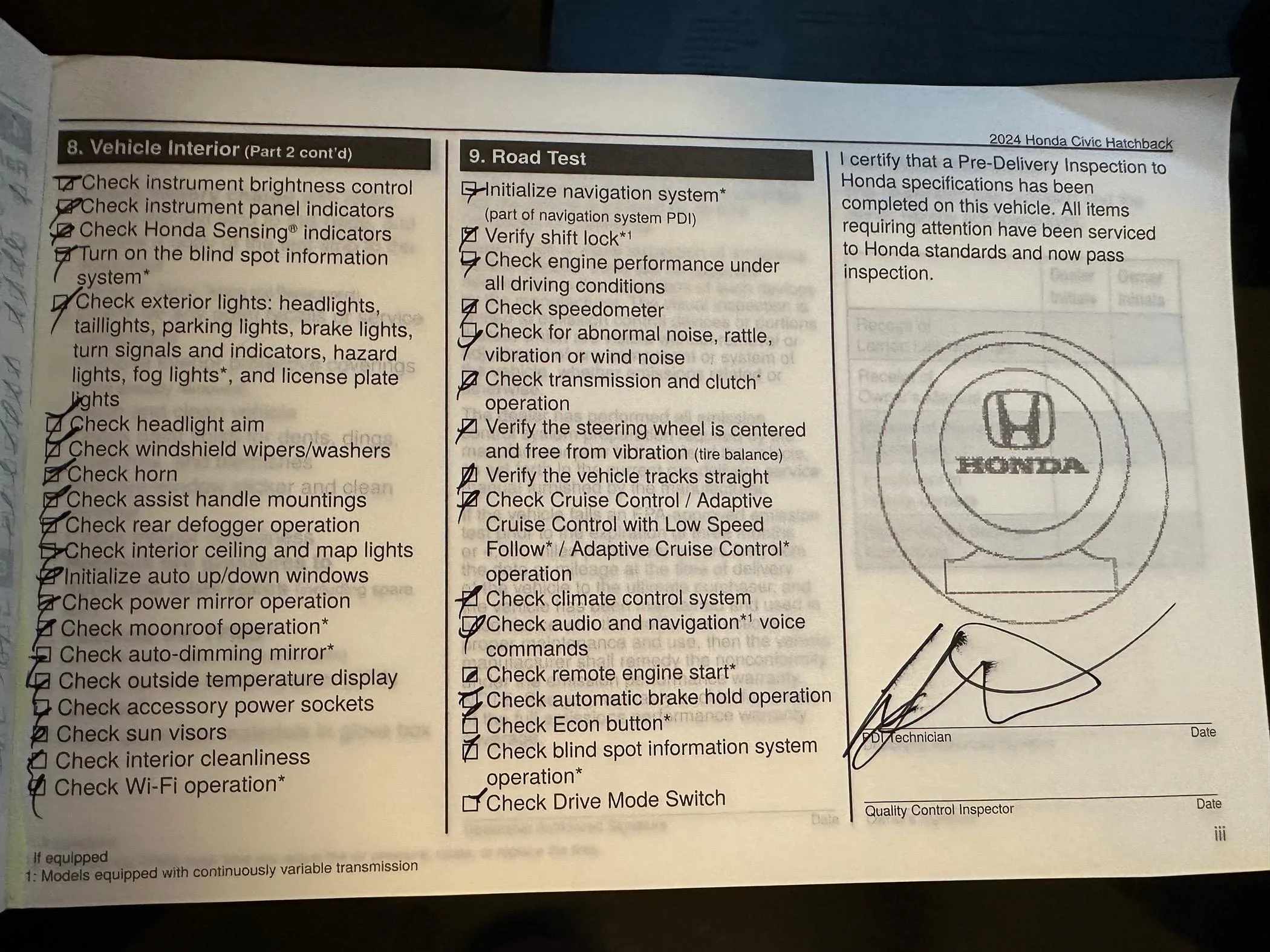

Would you by chance be able to share a copy of this PDI sheet? My car is coming in next week and I would like to verify the list of items.
It’s four pages…

awesome! thank you!! i was planning on going through the entire list myself when my car arrives.
for anyone interested, I've converted this into a text list:
Pre-Delivery Inspection
Before Starting PDI
  • Install the under-hood backup and audio fuses
  • Check fuel door and fill up fuel tank, check gauge
  • Take out of maintenance mode
  • Check battery cables and terminal tightness
  • Check battery state of charge with tester, attach the test strip to the Repair Order
  • Remove protective films and wash vehicle
Vehicle Interior (Part 1)
  • Remove all protective films, tags, and items from the rear cargo area
  • Install and anchor floor mat
  • Check childproof locks and seat belt operation
  • Check brake pedal operation
  • Check clutch pedal operation*
Vehicle Exterior (Part 1)
  • Walk-around
  • Check body fit and alignment
  • Check paint finish for dents, dings, scratches, and blemishes
  • Check hinges, locks, and latches
Under Hood - Engine Cold
  • Check condition of wiring, hose clamps, and belt tension indicator
  • Check brake/clutch* fluid level
  • Check coolant fluid level and concentration
  • Check engine oil level
  • Check washer fluid level and concentration
  • Check transmission fluid level*
  • Check for fluid leaks
Under Vehicle
  • Raise vehicle on lift to full height
  • Check body panels (low view) for dents, scratches, etc.
  • Check tires for defects or damage
  • Check brake lines
  • Check suspension and brakes
  • Check suspension bolts for torque paint
  • Check steering gearbox and linkage
  • Check driveline/axle/CV boots
  • Check exhaust components
  • Check clips on fuel lines
  • Check underbody
  • Install body plugs
Vehicle Exterior (Part 2)
  • Lower vehicle to half-height
  • Install front license plate holder*
  • Check body fit, alignment, and paint condition
  • Lower vehicle to ground
  • Adjust tire pressures to doorjamb label specs (including spare tire*)
Calibrate the TPMS
Hatch / Cargo Area
  • Check hatch operation
  • Check trim appearance and carpet fitment
  • Check cargo area light operation
  • Check jack and tools*
  • Check tire repair kit*
  • Check emergency hatch opener
  • Check folding rear seat operation
Under Hood - Engine Idling
  • Check engine cooling fan operation
  • Check engine coolant temperature gauge operation
  • Do PCM idle learn procedure
  • Check throttle operation and idle return
Vehicle Interior (Part 2)
  • Check tachometer
  • Check engine idle speed (A/C on/off)
  • Check for abnormal noise/vibration, in and out of gear
  • Check glove box operation
  • Check front seat adjustments
  • Check front center console for parts and operation
  • Check rear seat center armrest*
  • Check front seat heater operation*
  • Check passenger airbag-off indicator
  • Check tilt/telescoping steering column operation
  • Check console compartment
  • Install shift lock release cover*
  • Check rearview camera operation
  • Exit anti-theft mode
  • Do navigation system PDI*
  • Set the clock (non-navigation)
  • Check SiriusXM® Radio*
  • Check steering wheel audio/voice control buttons
Road Test
  • Initialize navigation system*
  • Verify shift lock*!
  • Check engine performance under all driving conditions
  • Check speedometer
  • Check for abnormal noise, rattle, vibration or wind noise
  • Check transmission and clutch operation
  • Verify the steering wheel is centered and free from vibration (tire balance)
  • Verify the vehicle tracks straight
  • Check Cruise Control / Adaptive Cruise Control with Low Speed Follow* / Adaptive Cruise Control* operation
  • Check climate control system
  • Check audio and navigation* voice commands
  • Check remote engine start*
  • Check automatic brake hold operation
  • Check Econ button*
  • Check blind spot information system operation*
  • Check Drive Mode Switch
Final Inspection (At Delivery)
  • Check battery charge with tester, attach the test strip to this page, and provide a copy of the test strip to the customer
  • Check for any open recalls or service campaigns
  • Remove interior protective coverings if not already removed
  • Wash and clean vehicle
  • Remove window sticker and clean window
  • Check interior cleanliness
  • Recheck tire pressures to doorjamb label specs (including spare tire*)
  • Calibrate the TPMS
  • Check for and install system (OTA) updates*
  • Place glove box materials in glove box
Dealer Certification and New Owner Information
(* if equipped)

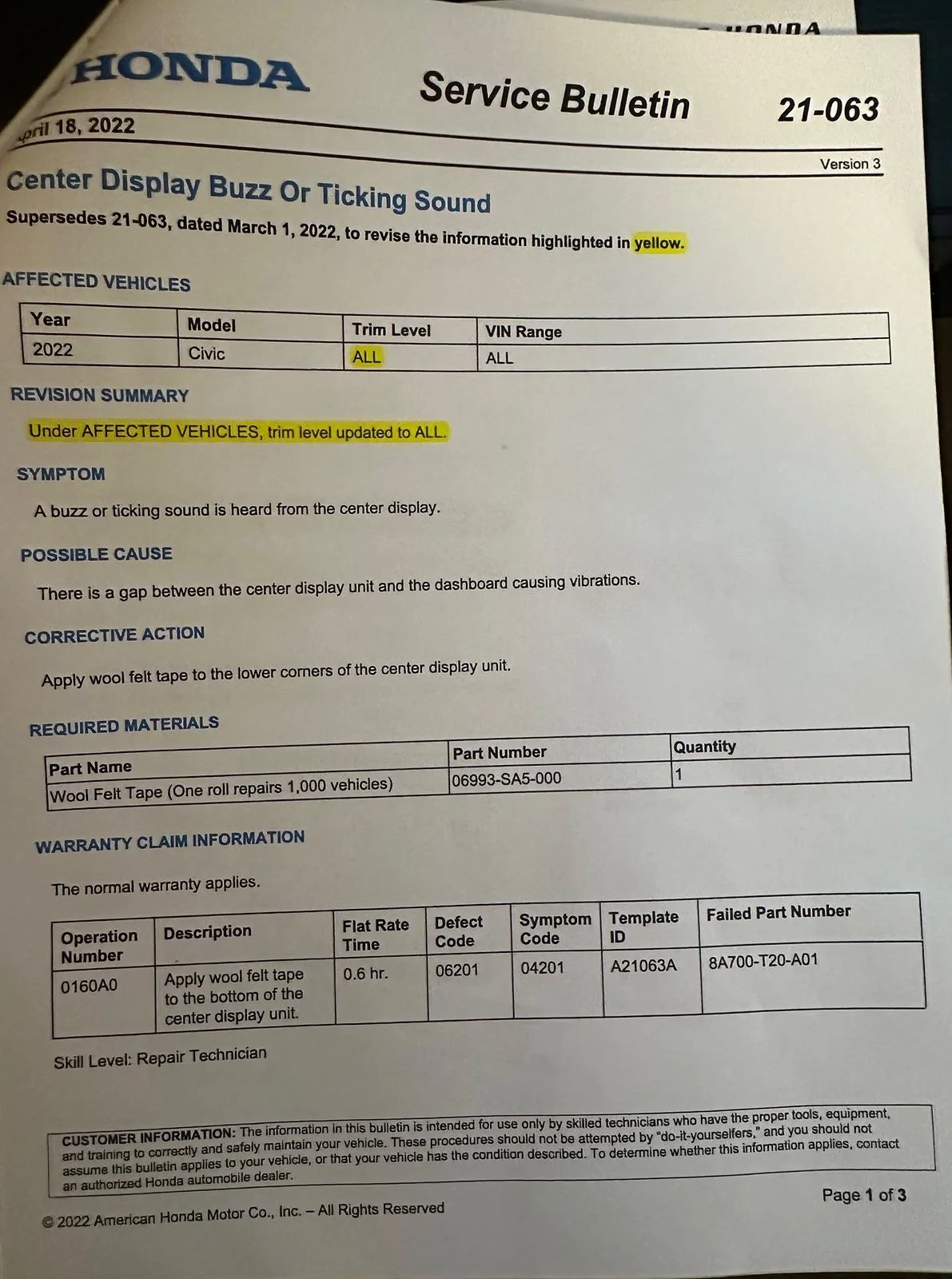

Speaking of the new windshield, something absolutely bizarre seems to have occured as a result of its installation...
The car has always had a really bad dashboard buzz in the area around the infotainment screen. It's been there since the initial test drive, and while it was reduced a decent bit once I lowered the tire pressures from the dealer's 53 cold PSI to 35/33 cold PSI, it never went away. It remained somewhat intermittent, but probably 80-90% of the time it at least buzzed whenever I hit 4,500 RPM. It sometimes started at 3,800 RPM, and it might do it any time I was anywhere between 3,800-4,500, but it always did it precisely at 4,500. It never did it above 4,500, however, no matter how high I went, nor did it ever do it below 3,800.
4,500 RPM on the dot, though, like clockwork. Buzzed like crazy.
Not anymore. The moment I drove out of the windshield place, I accelerated up to 5,000 to avoid getting clobbered by a 370Z that was coming up on me fast.
Hmmm. Nothing. No buzz.
Once I was in the clear, I slowed down and dropped a gear, bringing it into the 4,500 range. I hung right there, moving the car back and forth through 4,500, and...nothing. No sound at all from the dash.
I then took her up onto the freeway, where she always buzzes at 4,500, every time I merge into traffic, or speed up to pass someone.
Again...nothing.
I spent the rest of yesterday and quite a bit of today driving her on all sorts of roads, ripping up and down the tach, and all the buzzing is simply gone. I can't make it buzz now, no matter what I do. Even the seatbelt height adjuster stopped buzzing, once I raised it to its highest position. Driving on the freeway now, all I get is a ton of tire roar and wind noise, but no buzzes anywhere.
No clue what happened. Somehow, simply replacing the windshield seems to have eliminated the constant buzzing from the dashboard. I don't see how the two could be directly related, but it sure seems to be the case.
I also sure hope it stays gone, because it's awfully nice now to have an FL5 that is just...normal. No giant crack in the windshield right in my line of sight, no buzzing from the dashboard every time I leave a stoplight. It's just a normal car now, that happens to be unusually fast when I want it to be.
The other cool thing the service writer did for me today was he listened to my story about what I read here concerning the dahsboard buzzing. I told him that someone here posted a picture of Honda's TSB concerning this same issue on the '22 Civic, and we spent the next ten minutes surfing this site looking for that thread/post. Eventually we went on Youtube and looked for it that way, until we stumbled upon the perfect video, in which the dude posted the TSB notice.
The service writer copied down the number, looked it up, and voilà, there it was in his system. He printed up a copy of it for me in case the buzzing returns, telling me it will be no problem getting it fixed under warranty with that TSB in hand.
For those who are interested, here it is...

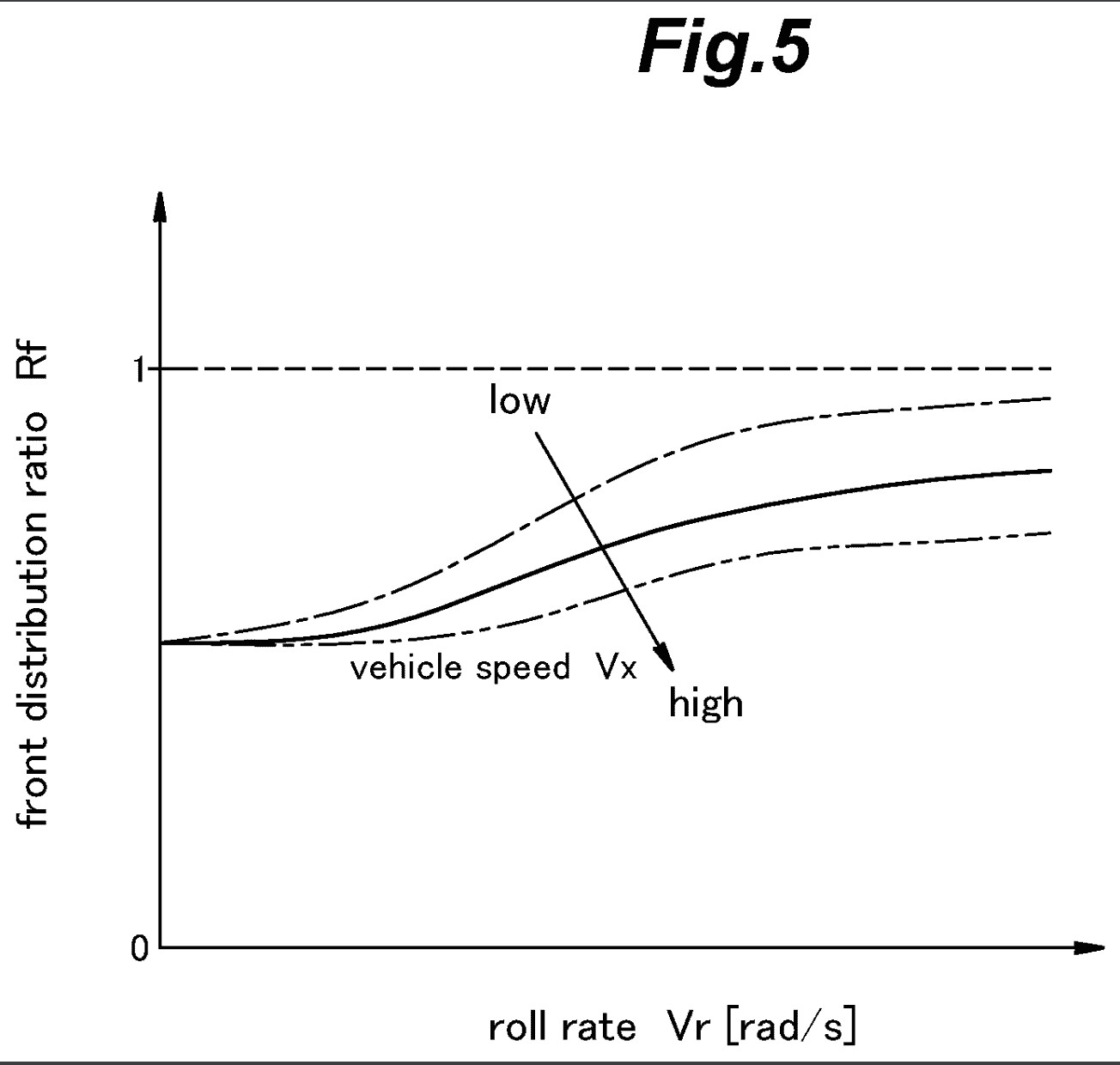

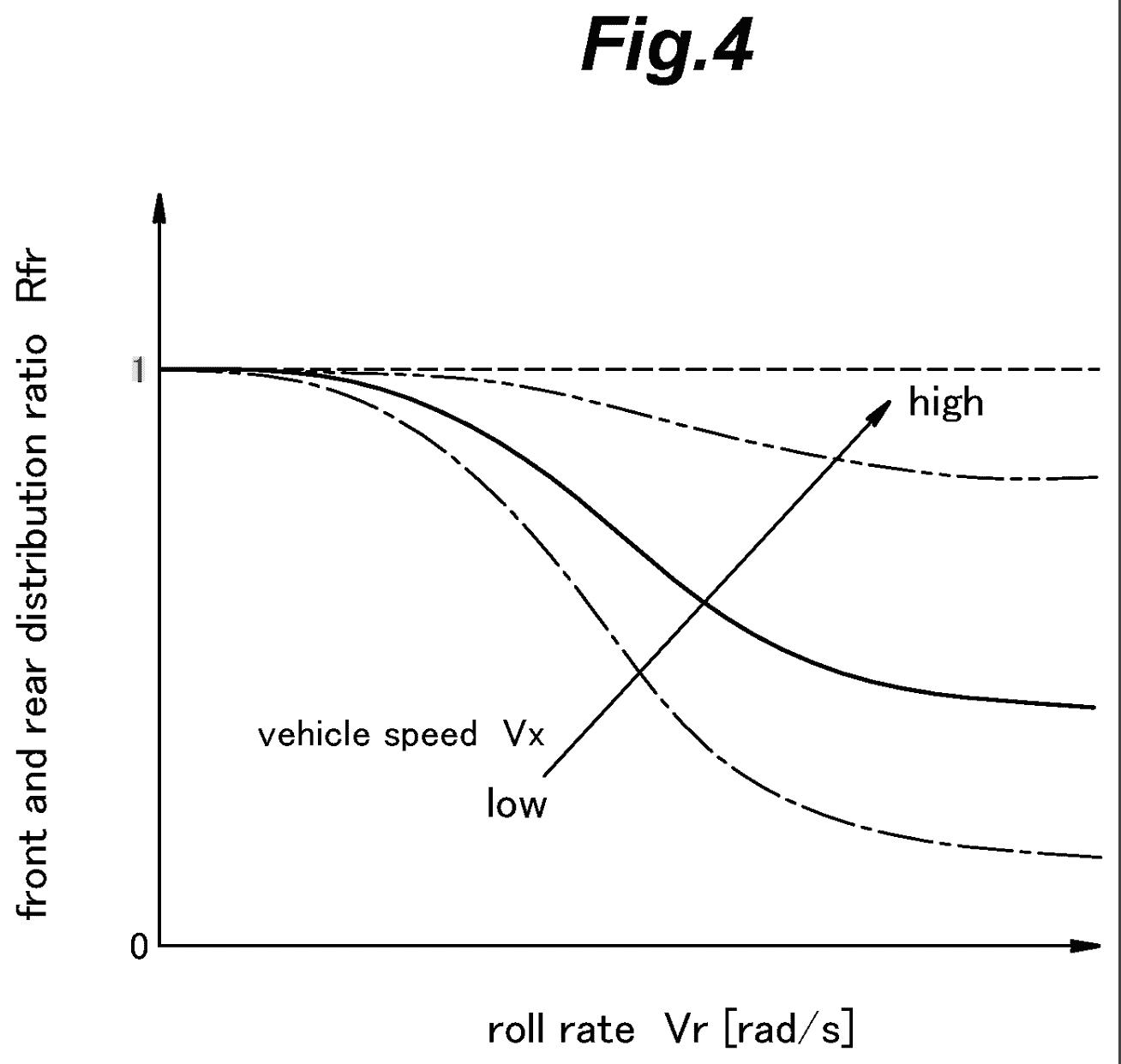

Taking her back to my favorite bumpy test "track" to check the suspension yet again, it was a tale of two roads. The twisty road leading to the very bumpy road had me thinking that Sport mode was completely fine, and definitely the mode to use. Once I hit that bumpier road, however, holy hell, did the pogoing go crazy. It was really bad. Being a glutton for punishment, I then tried switching to +R mode, which actually was slightly better, somehow. It still wasn't good, but it was bouncing me around less than Sport mode did. Then I switched to Comfort, and everything calmed down quite a bit, although there was still too much vertical movement, especially in the back.
It was a confusing test. The majority of the time, I was becoming convinced that the stock CTR module is fine. It was firm, edgy, sharp, fun, all those good things. Then, though, it all unraveled on that one road with the stutter bumps. That road was at least acceptable in Comfort mode, but it was clear that it could and should be better.
Topher stated in one of the roundtable discussions that the CTR suspension learns and adapts to one's personal driving habits. I don't know whether that's true, or whether this means that it learns to smooth itself out when pushed hard on bumpy roads, but he piqued my curiosity there. Now I'm wondering whether the car will get "better" the more I drive it.
Is that even possible? Can the car change its suspension behavior over time to smooth itself out, based on learning the driver's habits?
Sounds mighty implausible to me, but I'm no suspension engineer. Maybe the game really has advanced to that degree, and I'm just ignorant as hell.
In the meantime, I'm thinking the ITS module is probably still the way to go for me. If Sport and +R mode are both made more usable, while not becoming too soft and floaty, and Comfort mode becomes sort of genuinely "comfortable," then why not, right?

It doesn't exactly "learn" from your habits. What's happening is the damper behaviors are software-defined, updated many times per second. There are accelerometers monitoring G-forces, position sensors that know what the wheels are doing, steering wheel input, and all that goes into an tunable algorithm. If you corner, the outside dampers stiffen up. Apply hard braking and the front dampers stiffen, moment by moment. That's what he's talking about. The result is if you are driving hard, you get a very different result than calmly going down the same road and same bumps.
Edit: This patent, which I'm hoping is related to this,
https://patents.google.com/patent/US11090996B2/en
shows that the suspension behaviors (in this case, roll rate) they are targeting are at least partially based on vehicle speed Vx. I interpret the roll rate as meaning the rate at which the car body leans over as you put in steering input.
11th Gen Honda Civic Random first-day impressions... Screenshot 2024-03-28 at 2.12.39 PM
11th Gen Honda Civic Random first-day impressions... Screenshot 2024-03-28 at 2.12.29 PM
You can see that roll rate is less as vehicle speed is higher, which means it's stiffer and cornering flatter. I might be wrong and if so someone can correct me.
Edit 2: Ah here's a relevant paragraph.
The front and rear distribution ratio computation part 61 sets the front and rear distribution ratio Rfr such that the target damping forces Dfl, Dfr of the dampers 6 fl, 6 fr corresponding to the front wheels 2 fl, 2 fr become greater as the vehicle speed Vx becomes higher. Thereby, the dampers 6 fl, 6 fr corresponding to the front wheels 2 fl, 2 fr become less easy to retract, and therefore, a front-down pitch behavior (nose dive) of the vehicle 100 is suppressed. As a result, the center of gravity of the vehicle 100 becomes less likely to move forward in an operating condition where the vehicle speed Vx is high, and therefore, the travel stability of the vehicle 100 is improved. On the other hand, the front and rear distribution ratio computation part 61 sets the front and rear distribution ratio Rfr such that the target damping forces Dfl, Dfr of the dampers 6 fl, 6 fr corresponding to the front wheels 2 fl, 2 fr become smaller as the vehicle speed Vx becomes lower. Thereby, the dampers 6 fl, 6 fr corresponding to the front wheels 2 fl, 2 fr become easier to retract, and therefore, the front-down pitch behavior of the vehicle 100 is promoted. As a result, the center of gravity of the vehicle 100becomes more likely to move forward, and therefore, the turning performance of the vehicle 100 is improved when the vehicle speed Vx is low.
They state that as vehicle speed is higher, the target damping goes up: " the target damping forces Dfl, Dfr of the dampers 6 fl, 6 fr corresponding to the front wheels 2 fl, 2 fr become greater as the vehicle speed Vx becomes higher"
