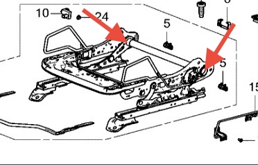

I’m speculating that the problem weld is where a round cross bar is welded to the two side plates on the seat.
Here is a picture of a fillet weld on the inner side of my drivers seat. This is the inside left side of the seat looking from the front. These welds are near the front of the seat
Here is a picture of the same area on my passengers seat (right side of seat).
So the passenger seat weld is on the outer part of the side plate and this picture shows the heat affected area. I couldn’t easily take a picture of the outer side bc of the seat trim.
My car is 1105 and NOT recalled. My thoughts are that both the passenger seat and drivers seat welds are on the outer side of the side plates and that the fillet weld visible on the inner side of the drivers seat is the “fix” that was made hastily during production.
Will someone with a sub 630 car post a picture of their drivers side inner weld area? I’m wondering if it has the inner fillet weld or not?

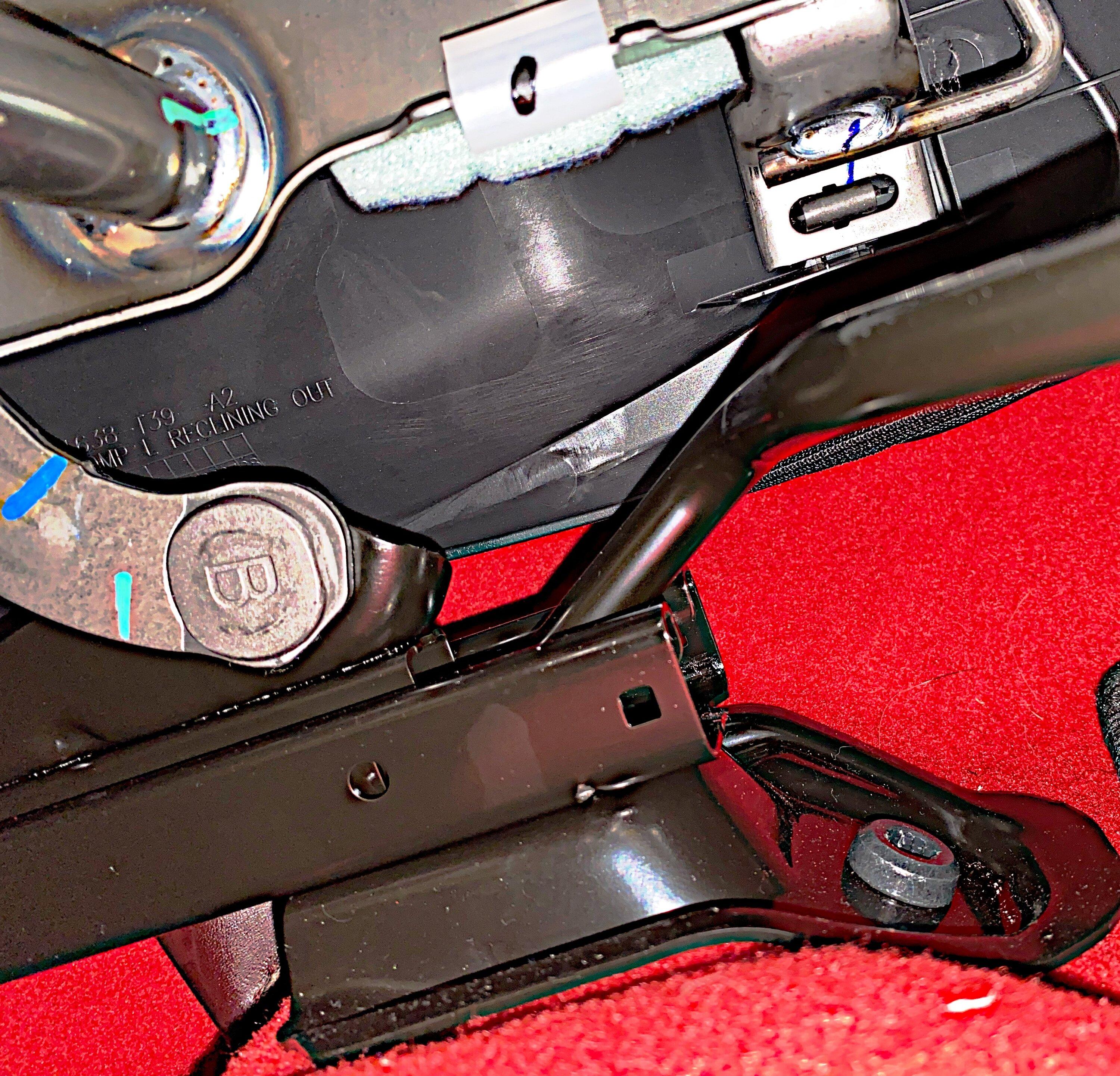

Okay thanks. So yours hasn’t been repaired I assume. It’s a littl hard to tell from the picture angle, but I don’t see an inner fillet weld. It looks like just haz From the weld on the outer side of the seat. Hopefully I can get one or two more pictures from others 630 and under w/o repair. I’m just curious as to what the difference is between bad frames and good frames. Also thinking that the passenger side is going to need repaired as well, but we’ll see.
Mine hasn’t been repaired. I tried to capture in one photo the cross bar weld as well as the anchor bolt. Judging from previous posts (descriptive, audio, and/or video), it seems the squeaking most often occurs during lateral (side-to-side) changes in load. If so, the cross bar’s tension should not shear as much as it would during a vertical shift. I have no evidence, but suspect the squeaks originate from binding in the upper frame rails. I would be most concerned if the anchor bolts were faulty. Time will tell. I just hope that those recalled get it done quickly and without further complications.
