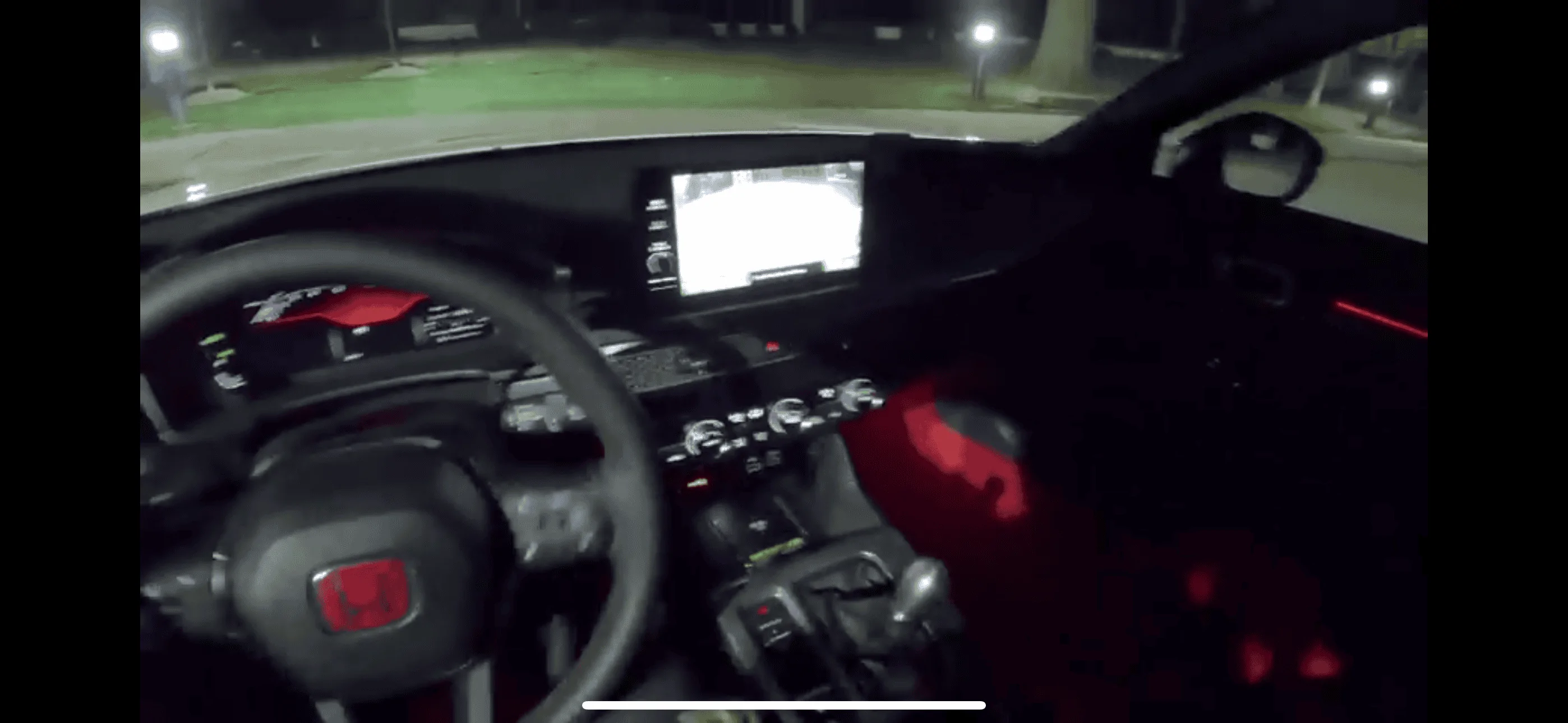

It does after you start to move in reverse.
Interesting, I saw a video from TheTopher and when he went in reverse. No R, showed up on his cluster either
11th Gen Honda Civic Reverse Gear not showing Back-up camera IMG_3079

Interesting I was wondering if I was tripping or not that I ever had an R reverse symbol on the cluster lmao… Dealer unfortunately said they’re unable to replicate it/find it on other Type R models according to the Tech’s note… ? The fuse was the problem for the back up camera

saw this (old) thread linked on a Facebook post. So for anyone else searching, no, the gear indicator does NOT show an R while moving in reverse unless a bunch of us on Facebook have defective cars.
