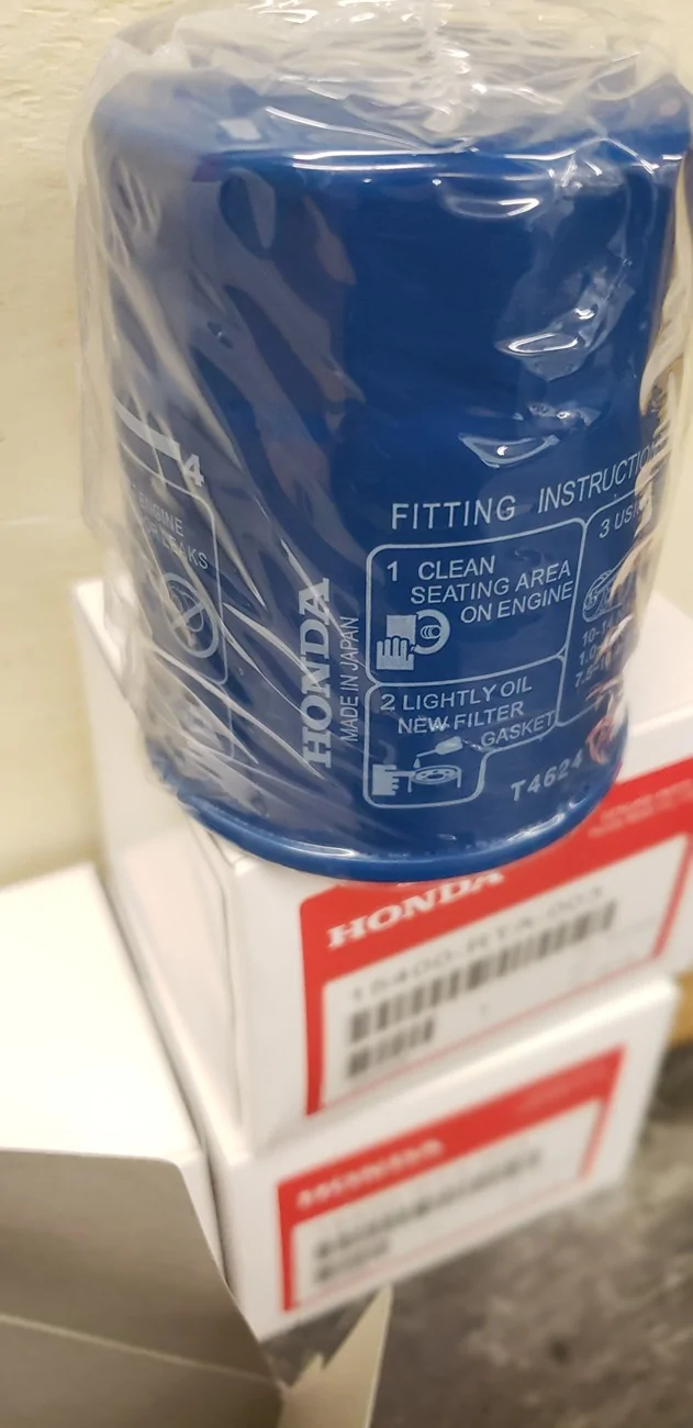

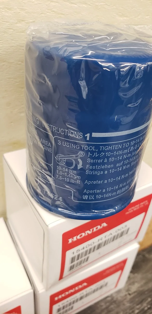

Not bad advice.
Torque spec on a rubber surface isn't accurate. Gasket crush is very temperature dependent. Lubrication also matters. Twisting 3/4's of a turn is better advice.
3/4 of a turn from what?
This is the issue with relying on that. The instructions generally state "x turn from gasket contact"
Okay, is the gasket fully seated in the filter groove? With a lot of filters that have flat gaskets, that might not be the case.
Is the gasket even an OEM one? The OEM o-ring gaskets on Hondas (and my Toyota) lend themselves to this because they're very consistent. If you get a Wix or a Mobil 1 or whatever, the 3/4 turn may be bad advice.
And then there's the matter of the judgement call of when the gasket makes contact.
Is there oil on the o-ring like the instructions tend to suggest? That makes determining when contact is made trickier.
Ask five different guys and you'll get five different answers. Some of them will be well into the 3/4 turn part of the equation when they start.
Tightening to torque removes many of these variables. It introduces new ones as you mentioned with temperature, but not an issue for me since I don't do oil changes in an unheated garage.

If only he realized the variances, conditions, and consequences accounted for in producing a torque spec... On a filter that is used by nearly the entire manufacturer product line for decades.
3/8 turn is likely ok, 1 full turn is also going to be ok. Most will require some sort of significant grip to get off due to heat cycling and grease. You can use a socket tool, pliers tool, strap tool, or a screwdriver tool as you please.

The torque spec is printed on the OEM filter for a reason and if you care about your car, follow it.
If you don't care about your car, do whatever the hell you want. But I question the value of having a tool with a 3/8" socket if you aren't going to bother.
