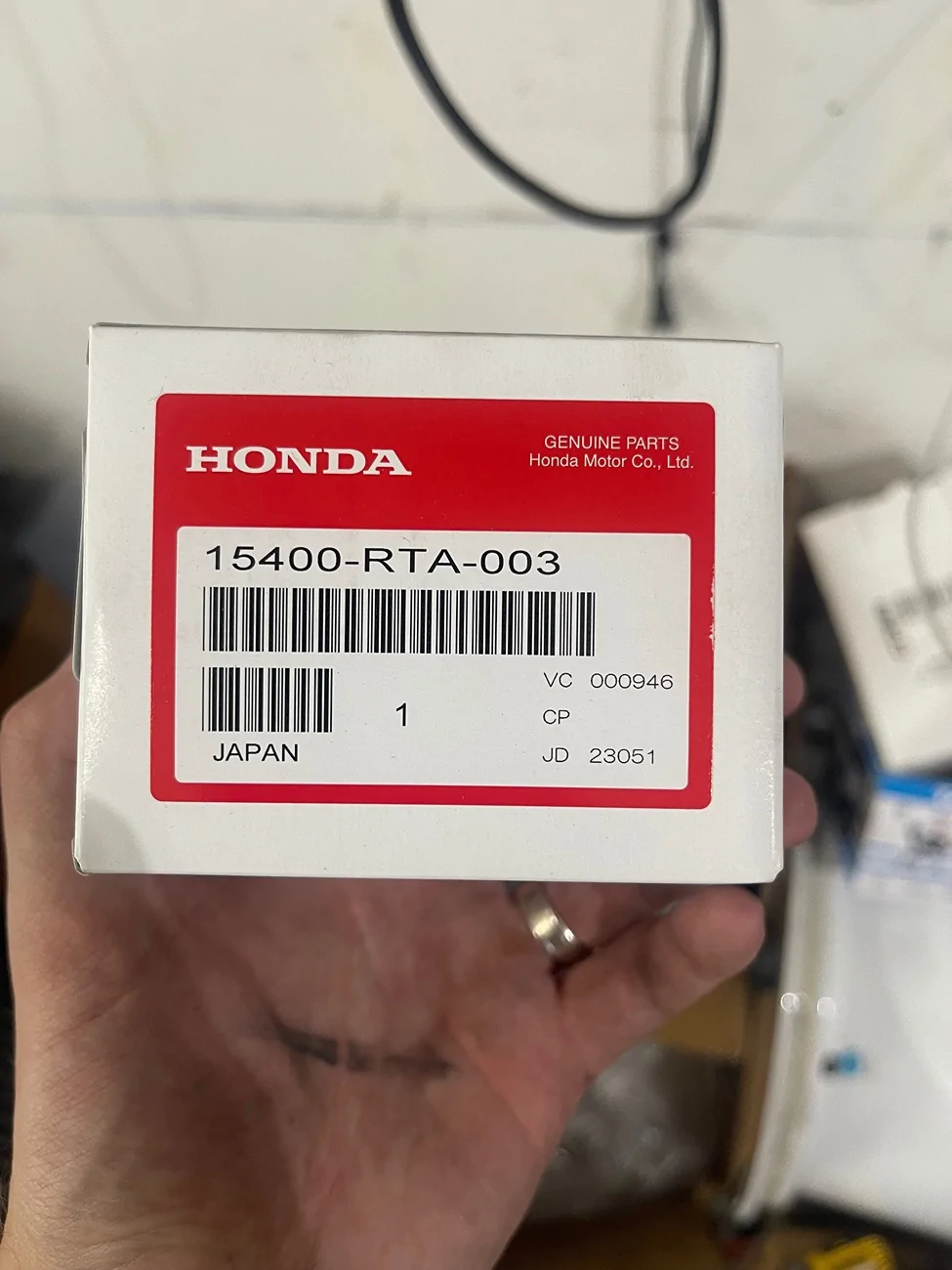

Sorry for the delay, here is the box
This looks more or less identical to the one that @HorizonsEdge posted. His came from Amazon as well.
I'm not sure that it's counterfeit, but they seem a little sus.
Things that make me think they could be legit:
  • The "JD" in the label probably stands for "Julian Date" and seems to be in the format where the first two digits are the year, and the next three digits are the day of the year. On counterfeits, they often get this wrong by just copying the same date codes over and over. Yours differs from his, but everything else on the label is the same.
  • Honda had to scramble to replace the Fram filter supply, and these might be among those that were imported temporarily with deliberately relabeled boxes, which would explain why these look nothing like the boxes for filters that are sold in Japan.
I posted the things that make me think it could be counterfeit already here:
Okay so coming back to this one specifically:
Again I am not saying that I'm sure they're fake.
This style of label does not seem to be used on the made-in-Japan filters that are sold in Japan.
The one thing that gives me pause is that Honda's US supplier Fram went through Chapter 11 this year, and Honda USA started sourcing filters from wherever they could. Exigent circumstances. Could that have meant they were required to relabel or repackage Mahle-made Japanese filters? Not a clue!

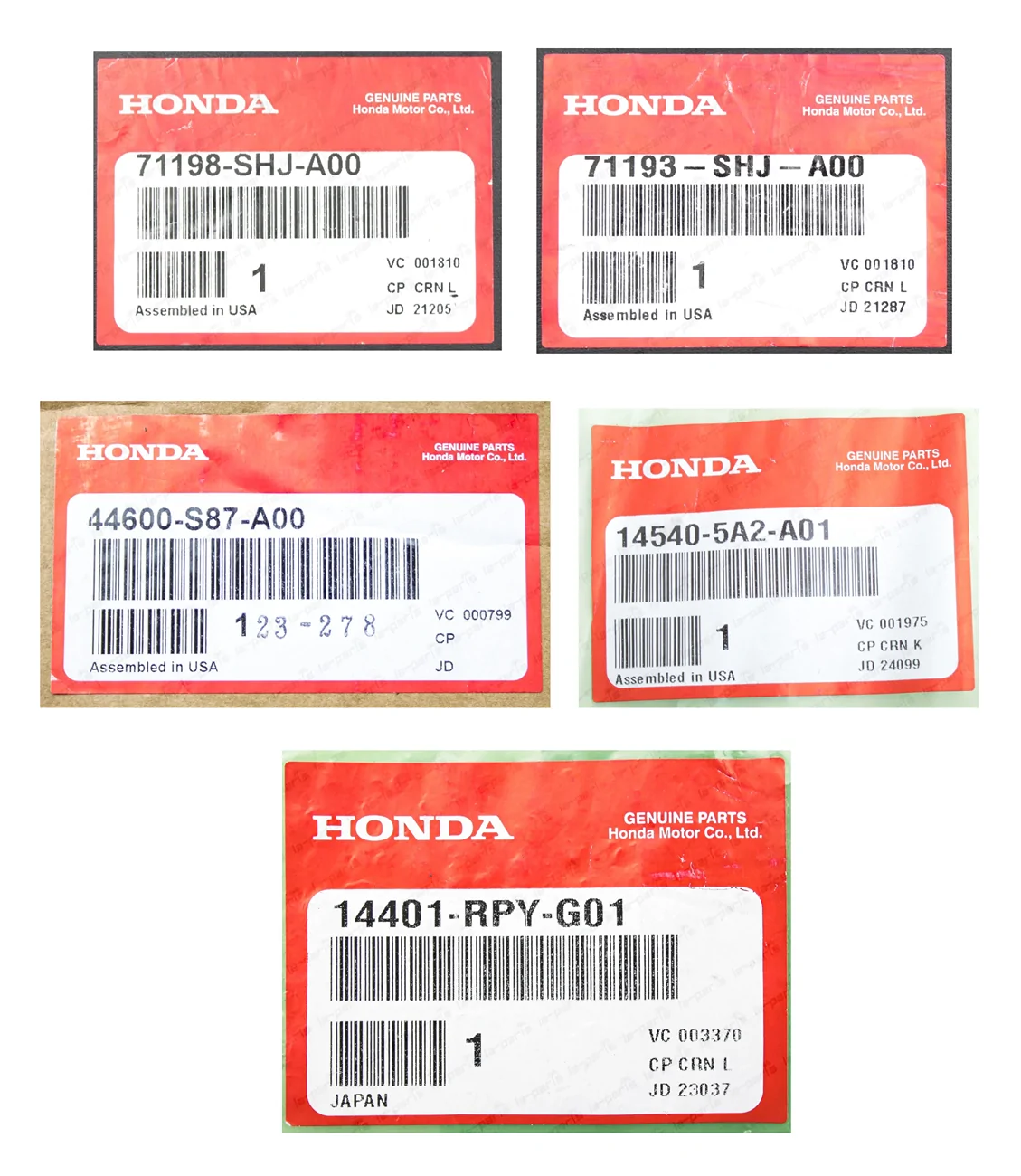

For reference, here are some legit Honda stickers using that style of barcode layout etc:
Here's what I notice being different about the oil filters you posted:
  • The radius of the corner of the sticker seems wrong. Honda's labels almost look rectangular and then you look close and there's a small radius on the corners. On that oil filter box sticker, the radius is much more pronounced.
  • The "GENUINE PARTS" and "Honda Motor Co., Ltd." are a much bolder font in the known-genuine Honda labels. On that oil filter box, it doesn't even look bold at all.
  • The fonts in the white area are all different from what you see on the known-genuine Honda labels.
  • In particular, the "1" (this represents the quantity) is much smaller and placed oddly.
Now, it bears pointing out that Honda doesn't maintain perfect consistency of this stuff. If I had to guess, across all of their manufacturing facilities and partners, there are different brands of label printers and software being used. The red part of the label is pre-printed on every sticker, the part inside the white box is likely printed on-demand and on-site. So that leads to natural variation when there's one single machine doing the printing.
But this stuff in combination with the loose shrink wrap makes me lean towards these being counterfeit.

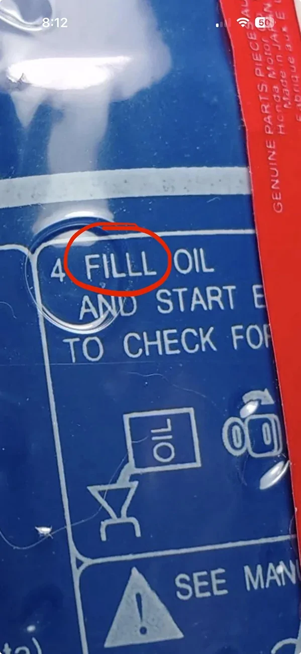

bought a pack of 3 off Amazon https://www.amazon.com/dp/B0CWG8JYDS a while back. 3 filters and 3 washers. Washers were not packaged with the filter; just rolling around the shipping box. seems legit but take a look, thx
I bought the exact same ones from Amazon. Haven't tried it yet. After my little research the counterfeit has some spelling errors such as "FILL" spelled "FILLL" on the counterfeit and other small details from what I researched online. The ones I got from Amazon I checked and couldn't find the errors.
Picture below I got from reddit where someone shows the misspelling. Also someone mentioned another version of counterfeit has the French mispelled.
11th Gen Honda Civic Beware 15400-RTA-003 1791786697575-o3
11th Gen Honda Civic Beware 15400-RTA-003 1791786801335-au

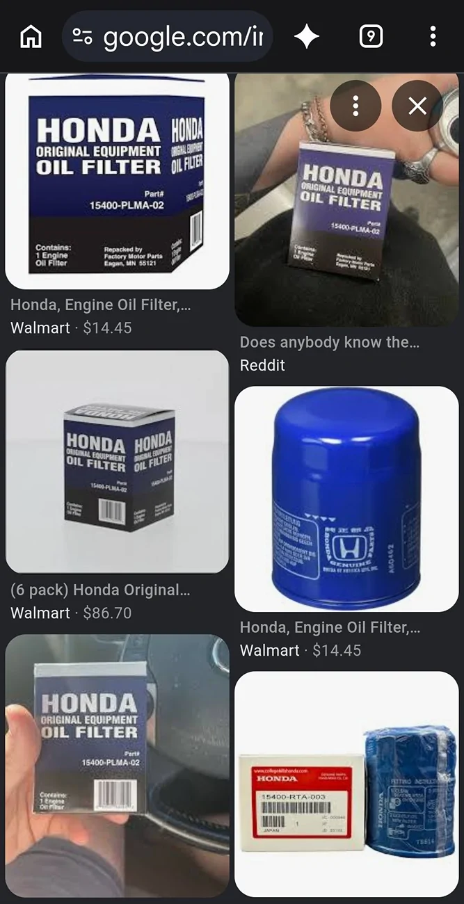

Walmart sells honda part numbered filters. It's in a black purple box https://share.google/JjPSoJT5rMDbJuv9x
Walmart the brick and mortar store or Walmart the website?
Walmart the website is just another marketplace where scammers run amok, no better than scAmazon or eBay.
I wouldn't trust anything I didn't buy from a brick and mortar Walmart.
