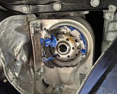

Go straight caveman unga-bunga and stab the filter with a long screwdriver completely through = instant T-handle.
Works until it doesn't.
11th Gen Honda Civic RTA Filter tool? 1787097051767-dk
Torque it correctly in the first place and you can avoid situations like these.
