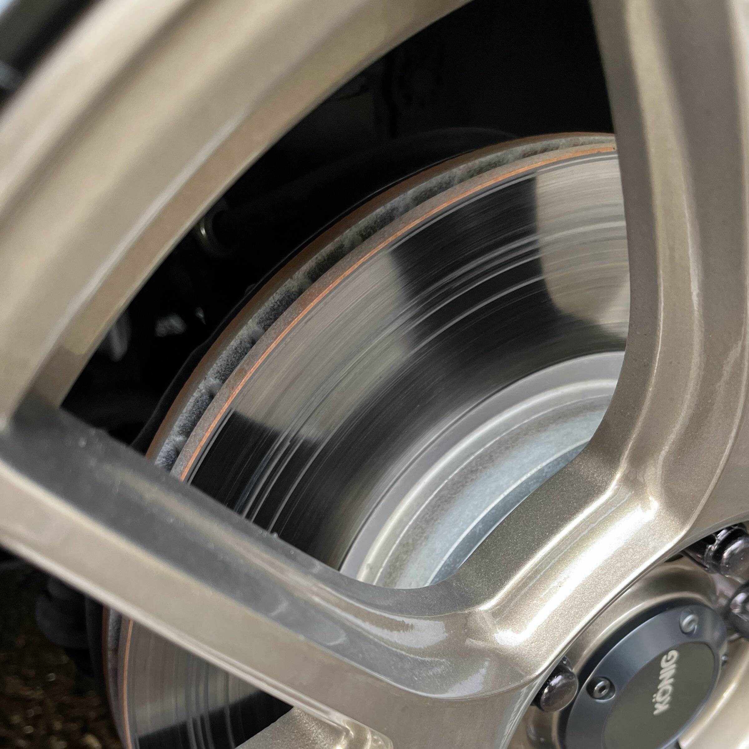

Well, absolutely destroyed the stock pads after just a couple track laps, so I ordered a set of XP10 front/ XP8 rear per Carbotech's recommendation.
Yikes, $1000 on brake pads in just a couple weeks. Should have street and track use covered for a a good while now though. Motul 600 fluid going in soon as well.

Yeah, that doesn't look normal...
