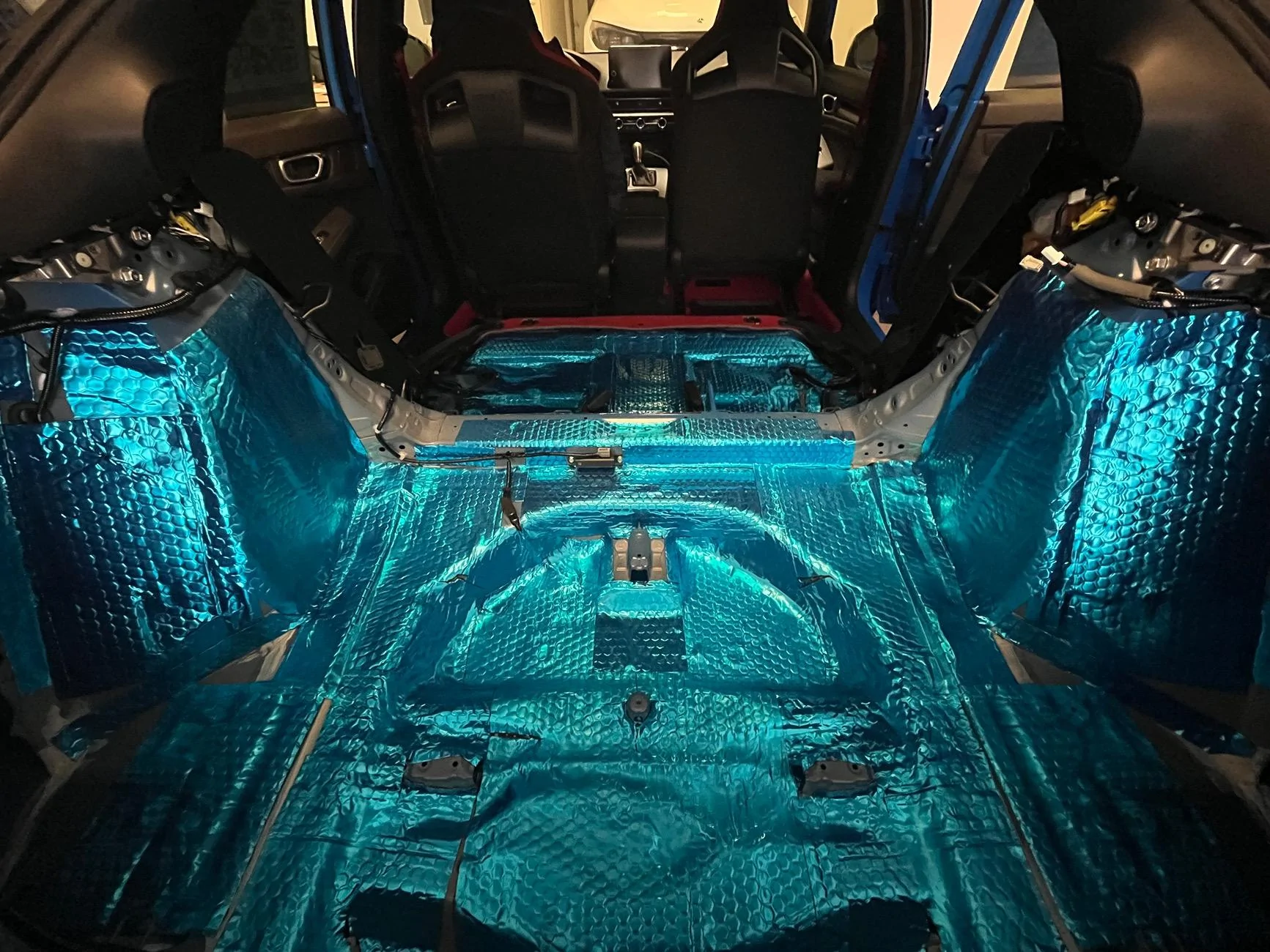

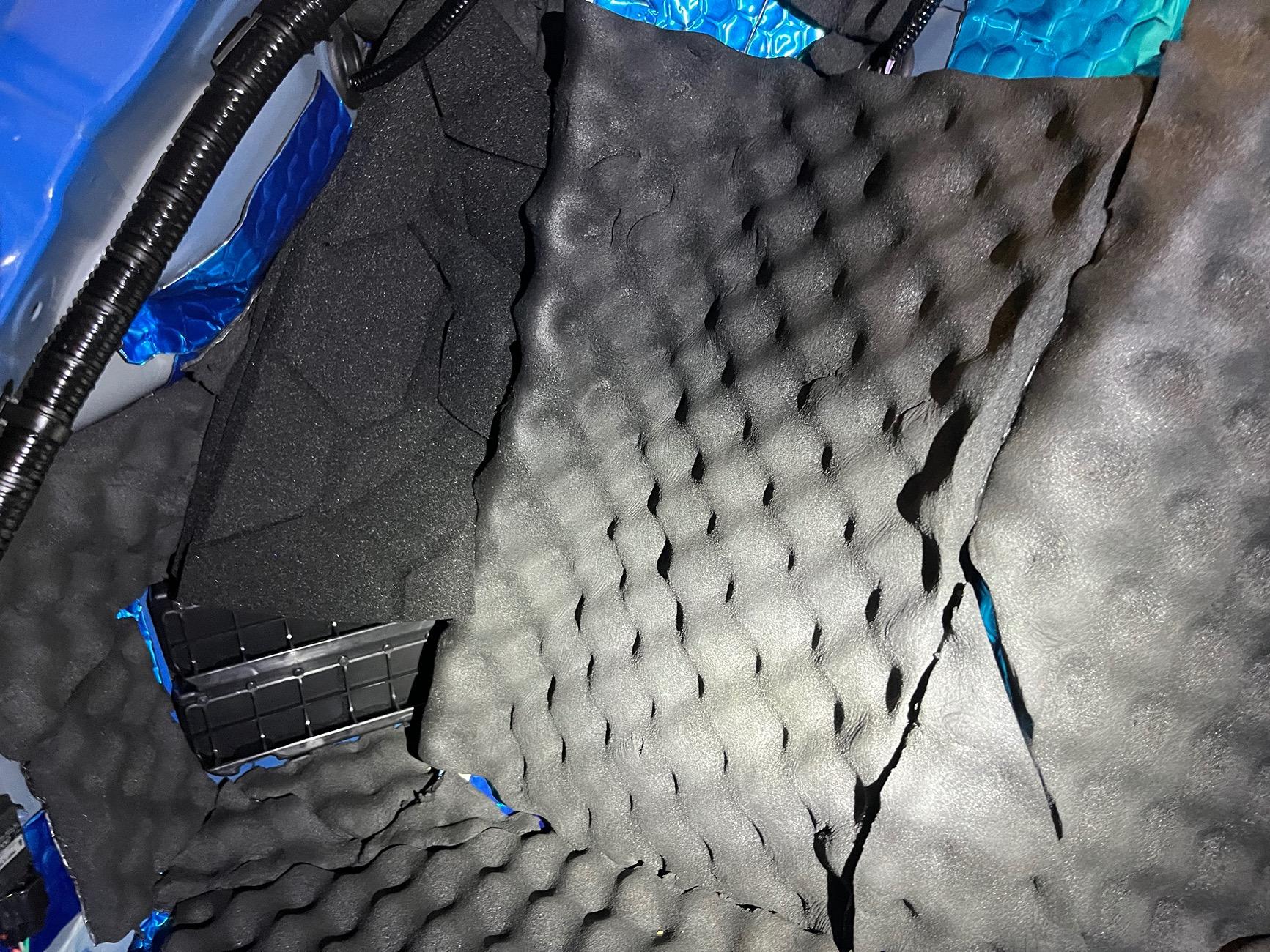

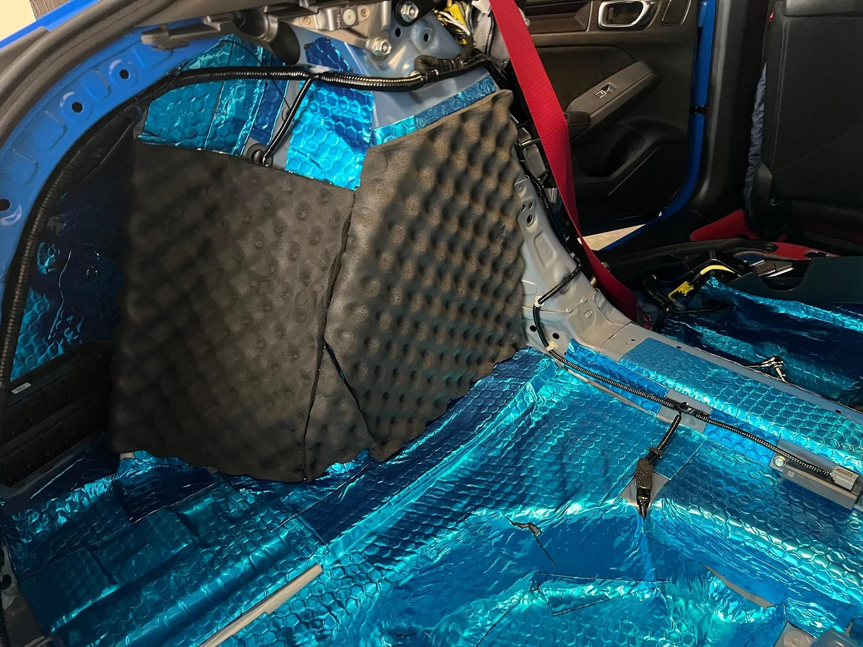

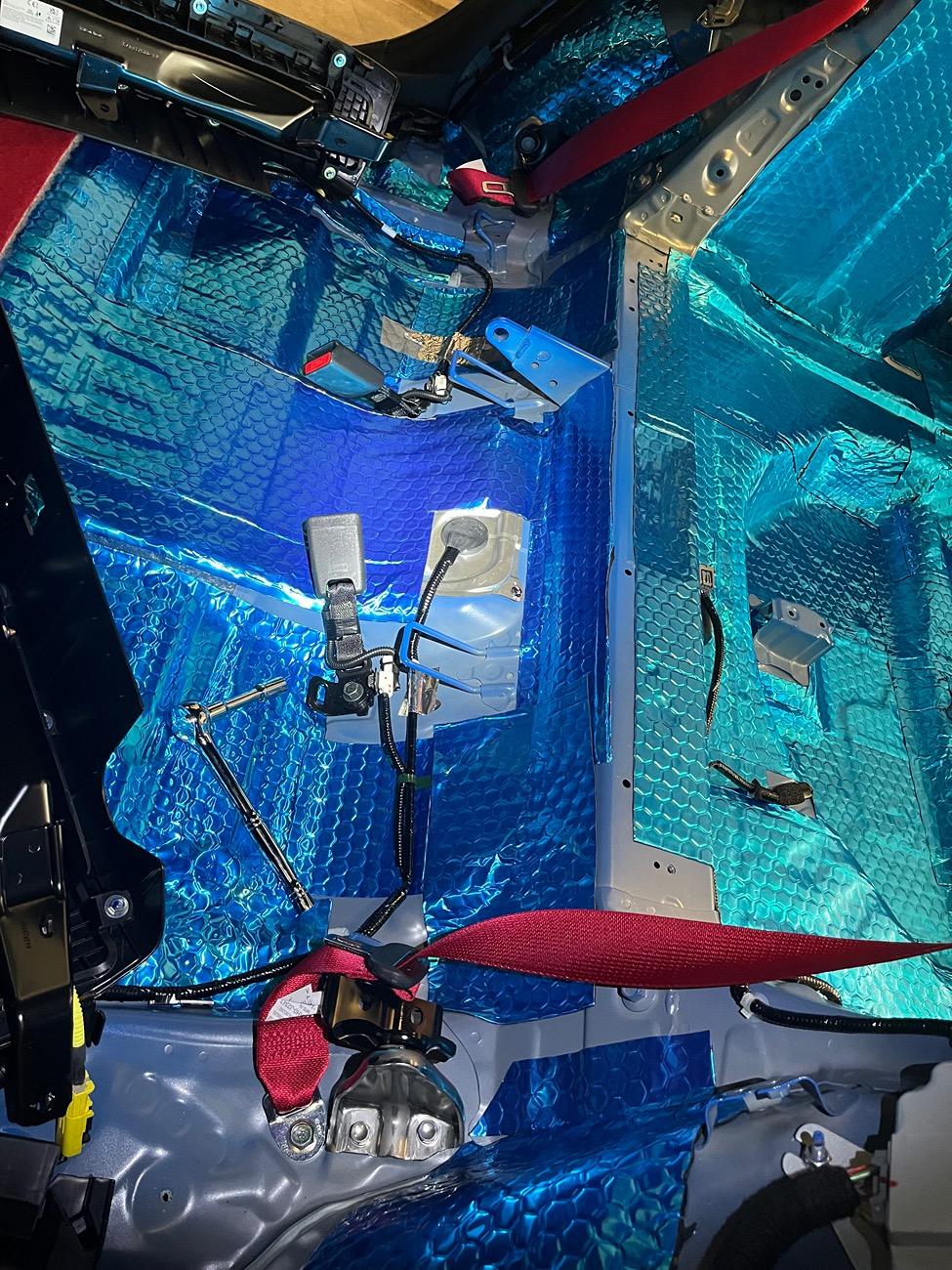

Quick update on progress.
so far I’ve used 40lbs of Amazon dampening 2 packs https://www.amazon.com/gp/aw/d/B07XMF3KK5?psc=1&ref=ppx_pop_mob_b_asin_title
and 28lbs of acoustic dampening and foam https://www.amazon.com/gp/aw/d/B0CCRF9MGW?psc=1&ref=ppx_pop_mob_b_asin_title 4 packs
and 1 pack of https://www.amazon.com/gp/aw/d/B07782F7S6?psc=1&ref=ppx_pop_mob_b_asin_title
foam without acoustic dampening, https://www.amazon.com/gp/aw/d/B07782F7S6?psc=1&ref=ppx_pop_mob_b_asin_title and few open cell foam, weight is nothing https://www.amazon.com/gp/aw/d/B0CQYJVBL4?psc=1&ref=ppx_pop_mob_b_asin_title
~68-70lbs total weight added.
lets see how it drives and sounds tomorrow. If it solves the problem, great, if not then the inside of the wheel wells are next.
The goal is to be able to drive hours without getting a headache run lapse all day at Laguna Seca and come home without a migraine.

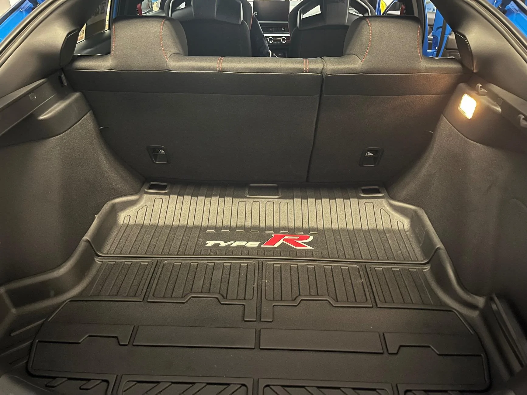

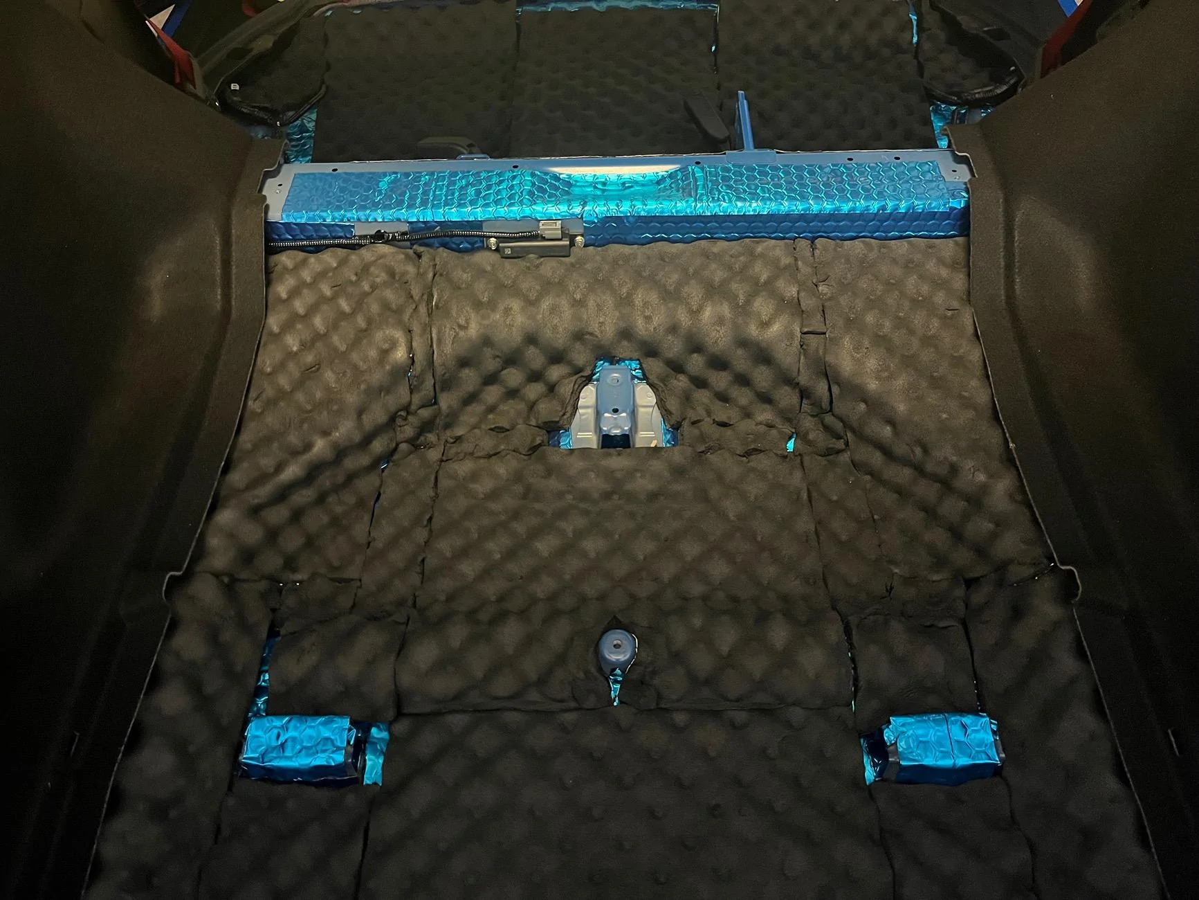

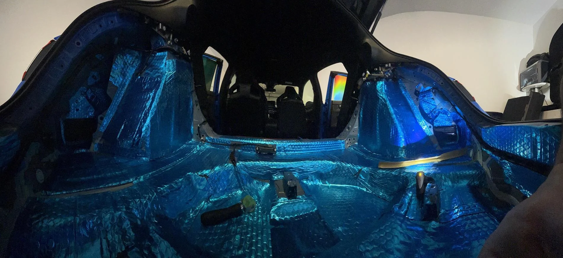

Just finally finished, car looks stock now, it was an insane amount of work, my body hurts from covering every surface, hand massaging every piece into place, maybe 50 hours of work, will take it for a drive tomorrow. Fingers crossed

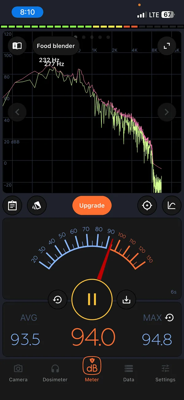

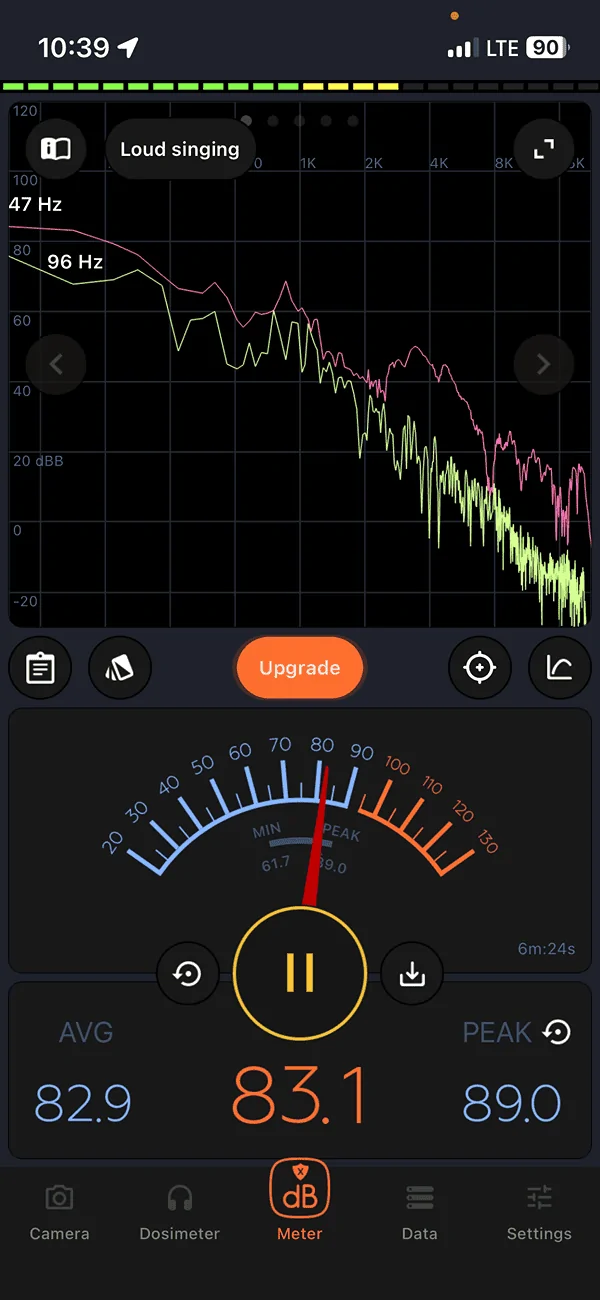

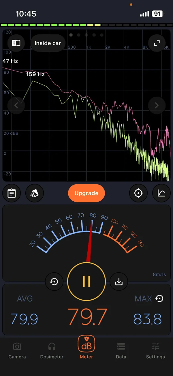

Before After!!!! Massive difference!!! Now all I hear is the engine. What I realize is we have a very loud car with lots of different noises your reticular activating system, which is your brain tries to filter out and adjust for different tones and sounds. I don’t wanna hear tires. I’d rather hear engine but now the engine sounds very thrash. Something I never heard before. I know this not scientific, and the db meter doesn’t capture most of the story and frequencies, but for 100 sure, the difference it’s day and night
Look at the difference !!!!!! CTR feels very tight.

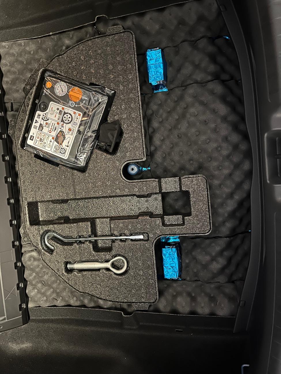

Today overkill on doors + trunk:
11th Gen Honda Civic Sound Deadening Project IMG_1326

Before any dampening !! It was in the redline !!! Driving a food blender loud!!!:
11th Gen Honda Civic Sound Deadening Project IMG_0467

Also, one thing I learned is, if you are using a decibel meter app on the iPhone, make sure you turn off bluetooth and wifi so it doesn't connect to your car's microphone, as that will throw off the decibel reading by 9-10dbs or so. Use you iPhones mic.
