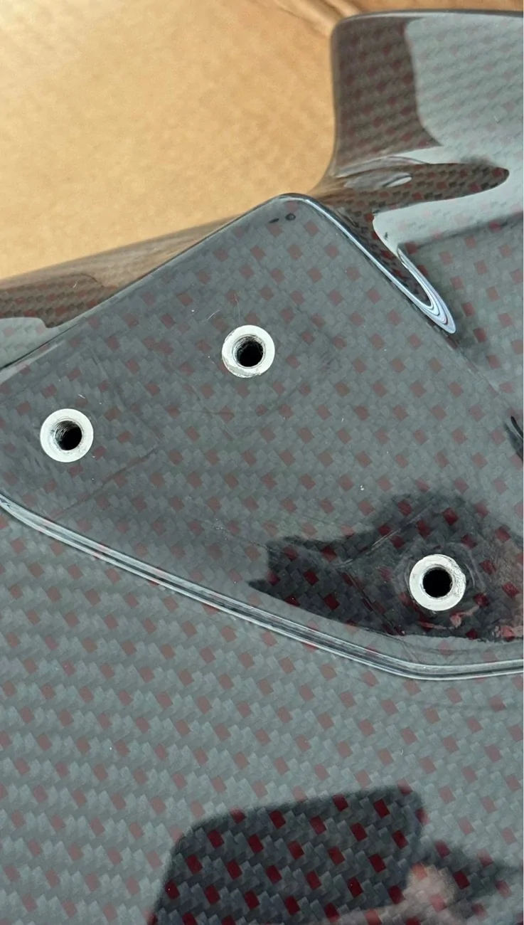

On the OEM CF pieces the red weave is smaller and closer to a square, all the knockoffs I've seen have longer rectangular weave.

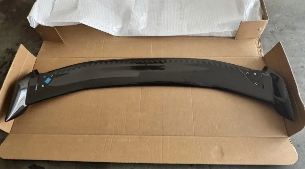

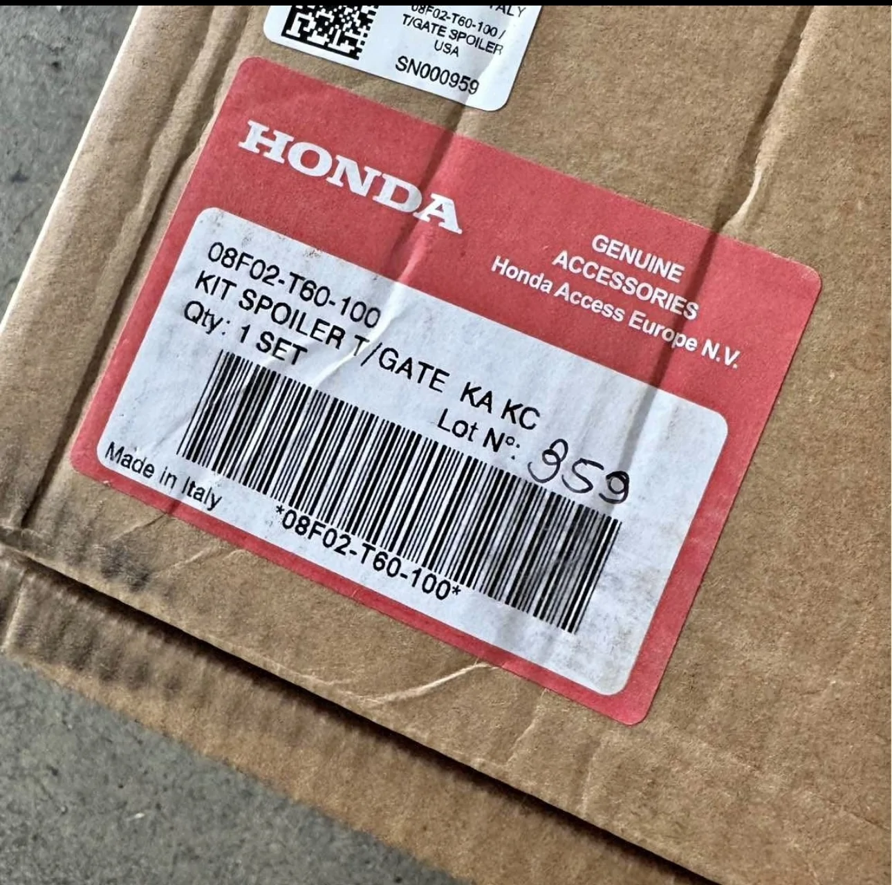

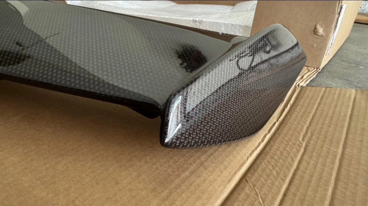

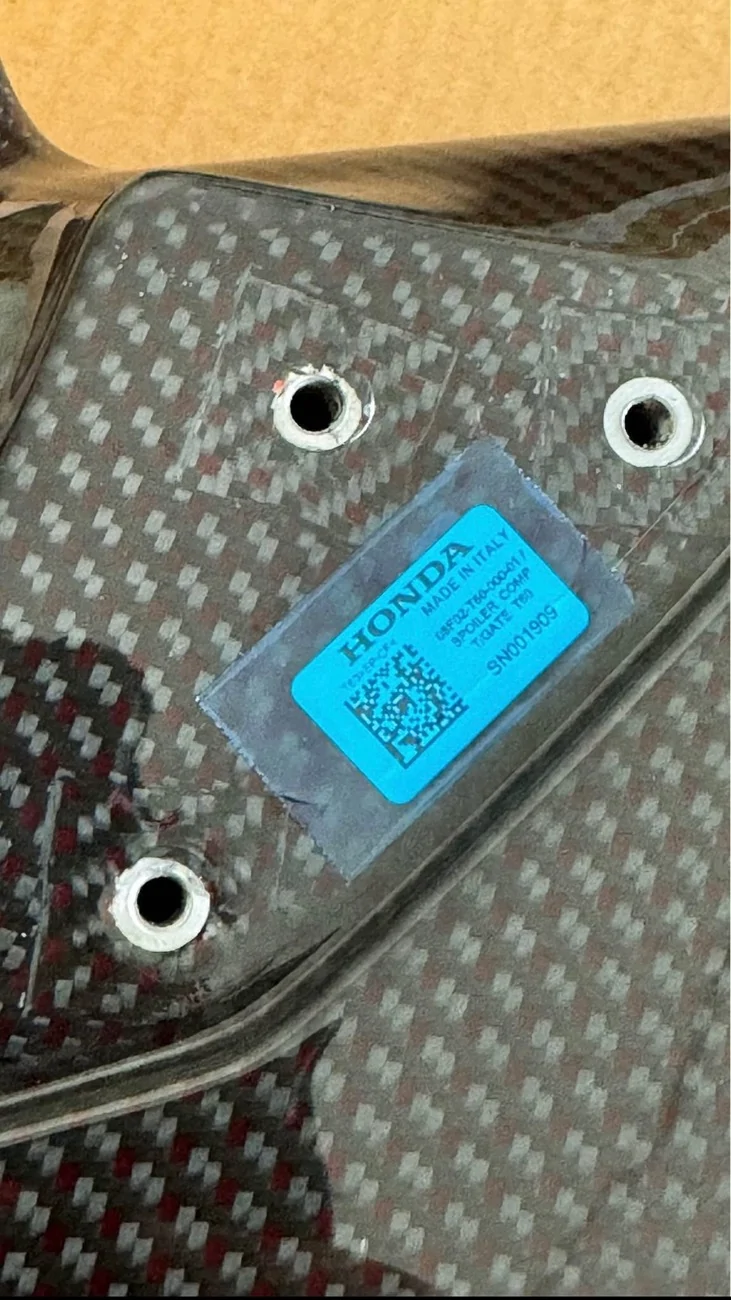

Can you guys verify that this wing is legit. Someone posted a page back confirming the new labeling and wanted to make sure this is all good. The SN on the wing doesn’t match the number on the box. Not sure if they’re supposed to match up.
Not sure about the numbers but Is there a seam when you look under the wing going from one side to another ? Or is the seem on the back edge side to side closest to the rear window , also the fitment should be perfect and line up perfectly .
11th Gen Honda Civic Thoughts on the carbon fibre wing? IMG_1907
Should be smooth with no seam
11th Gen Honda Civic Thoughts on the carbon fibre wing? IMG_1908
11th Gen Honda Civic Thoughts on the carbon fibre wing? IMG_1909
Seam should be on the back edge but barely visible and smooth to the touch. There should be no seam under the wing just on the rear edge as pictured. Also on the replica the cf pattern will be slightly different although still have the red flash in it.

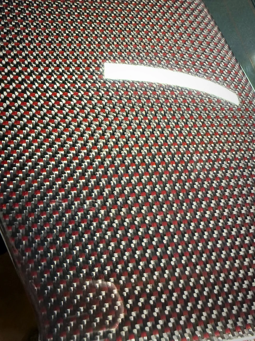

Here is a close up of the CF pattern and it also is made in Italy and a OEM + wing. I’ve noticed the replicas have a slightly wider pattern and not as uniform. Here’s mine and what it should look like .
