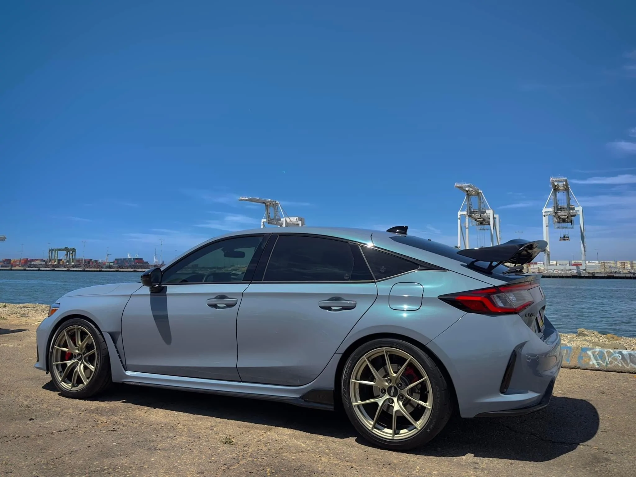

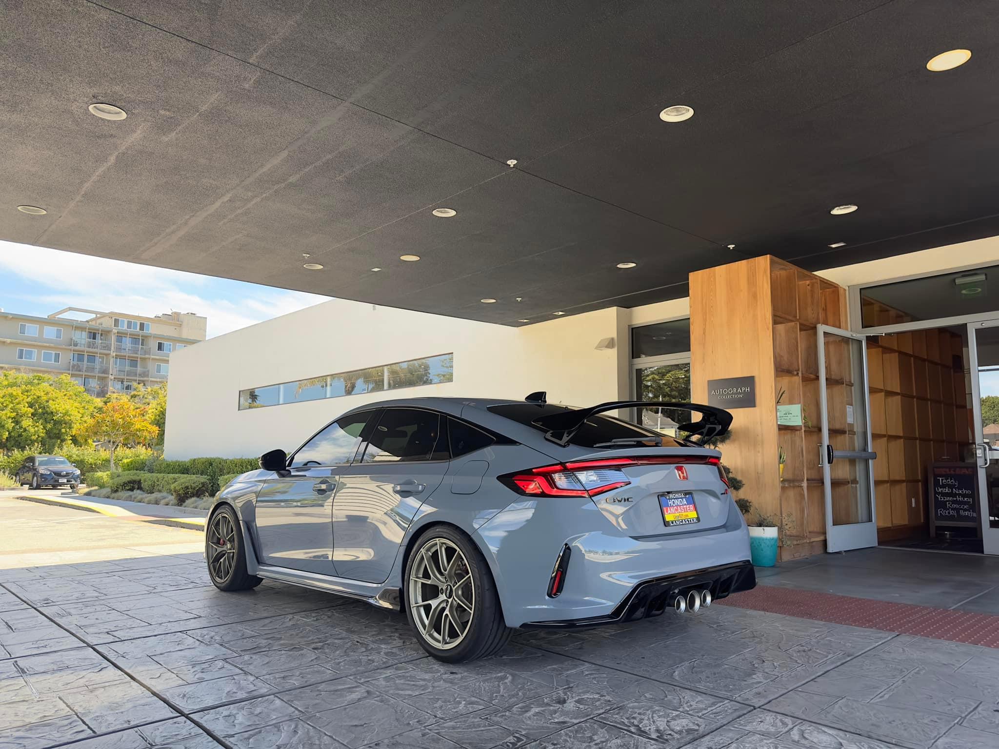

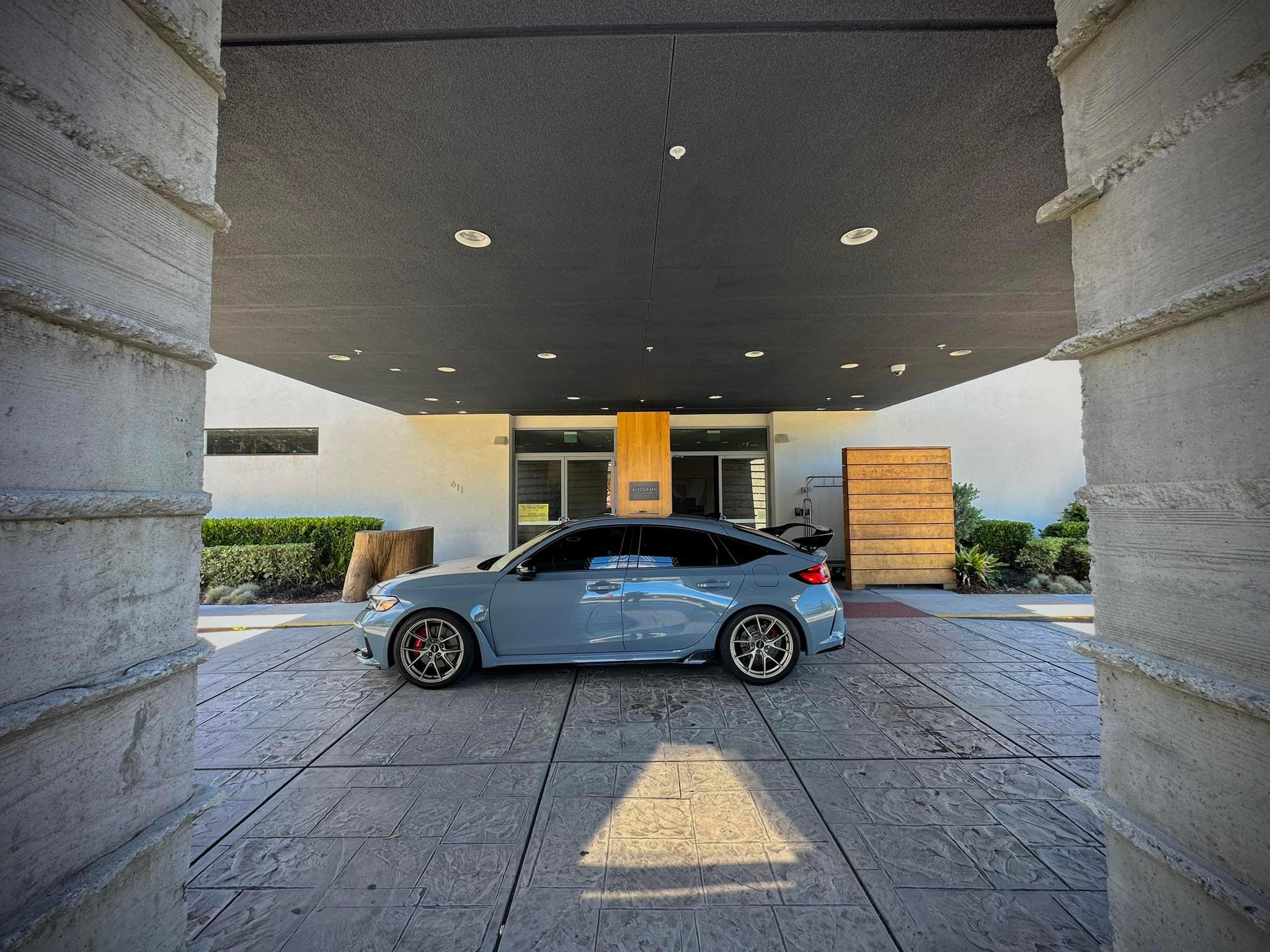

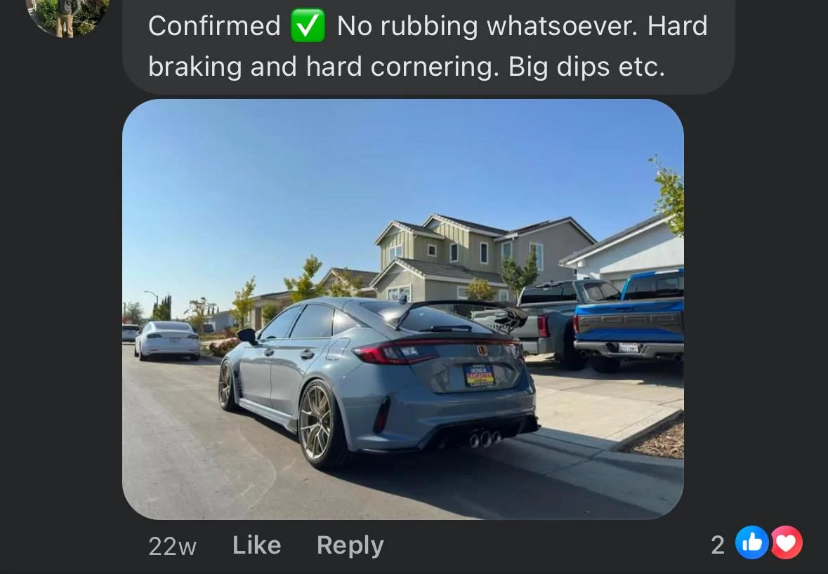

Hey @katch922, How about upgrade your tires to 275/35/19? It looks good and will raise your front a little bit + will give a look that it is lowered as it closes the wheel gap.
“Decided to give APEX VS-5RS 19x9.5 +45 (Motorsports Gold) with 275/35/19 a try.
No rubs whatsoever on this setup. the car is not lowered yet. “
Here’s a pic for reference:
Hope it helps.
Please check the thread itself I also posted pics with it being lowered.
PS: as per his last post no concern with it being lowered.

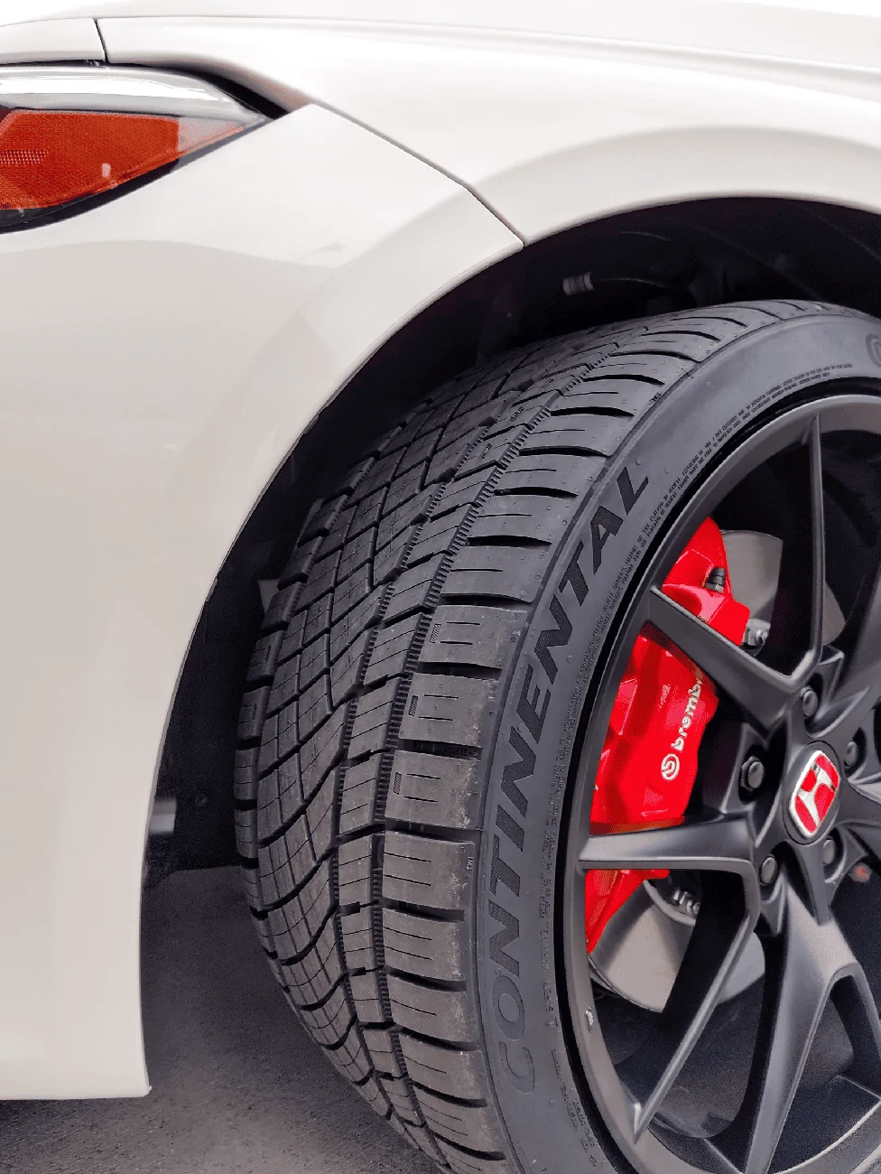

I have been running 275/30/19 contis for 8k miles no issues.
